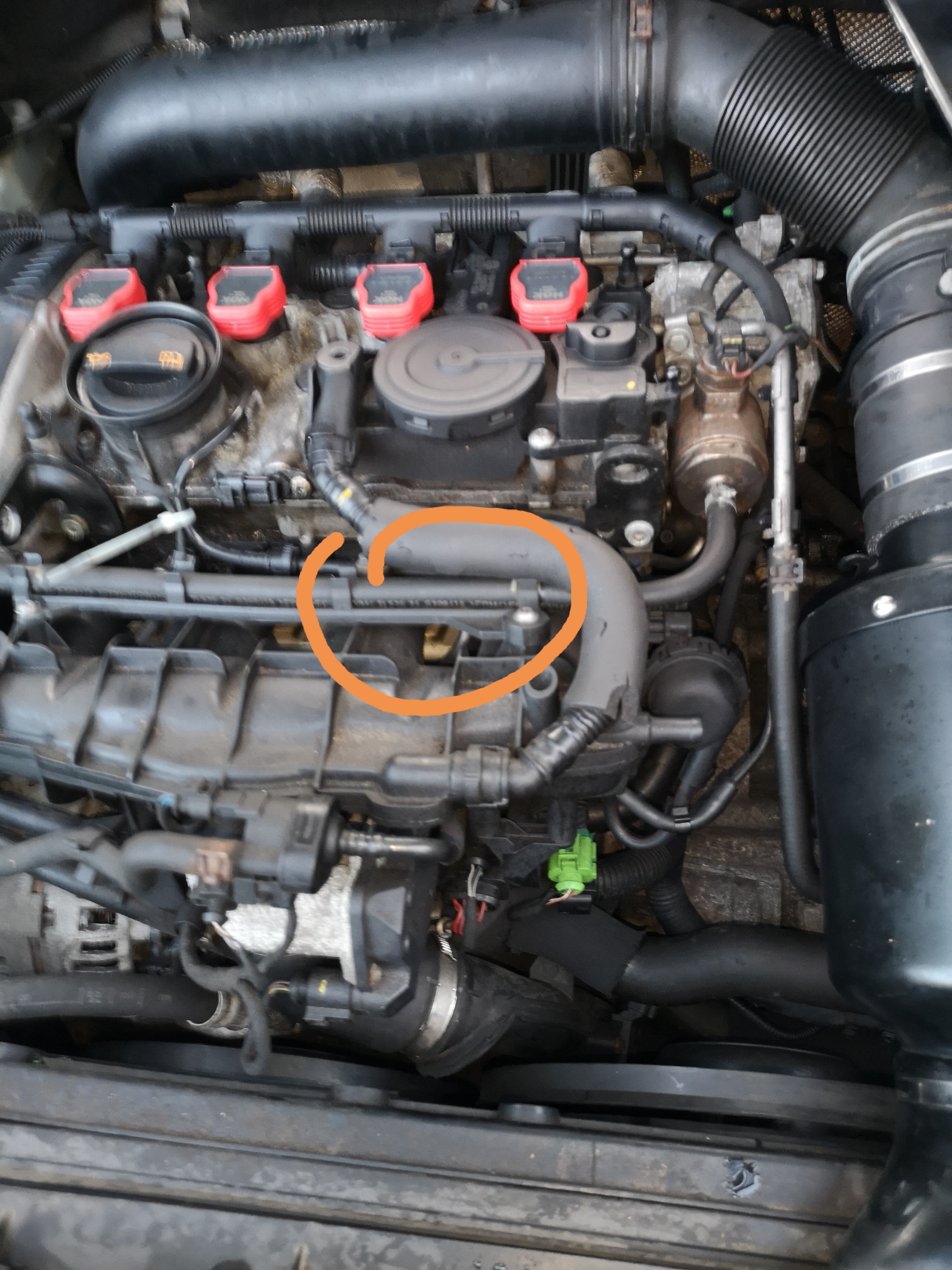

I've no idea about that. Where is located and how would I check it?

It's underneath/behind the fuel rail.
