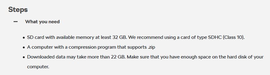

We might be going round in circles here.  What your update portal also says under STEPS is:
Which is obviously wrong for MIB3.  Sounds like you'll have to contact Skoda as their information is wrong.

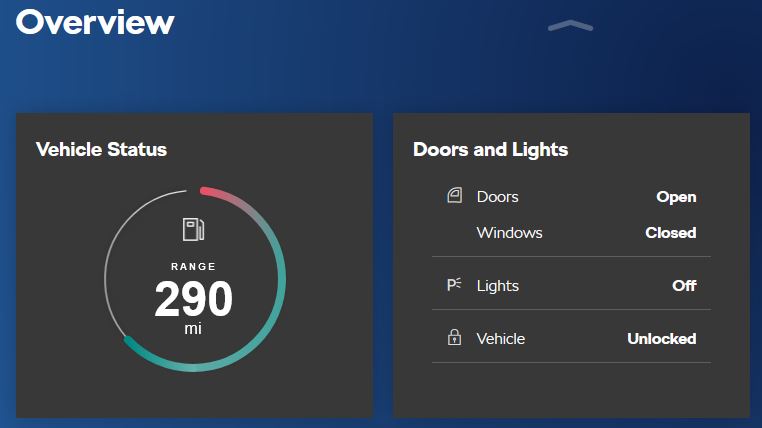

I'll tell you something else that's wrong and that's Skoda Connect - it's having teething troubles too with MY21 year cars.
My car is currently locked with all windows closed and the alarm set.  Last night Skoda Connect was saying the doors were closed but the windows open, tonight it's telling me the doors are open and windows are closed  :wall:.     No such problems with our MY20 Karoq but our MY21 Kodiaq? The software is crap.

My connect app seems to be fine. Always shows the correct info when I look at it.
