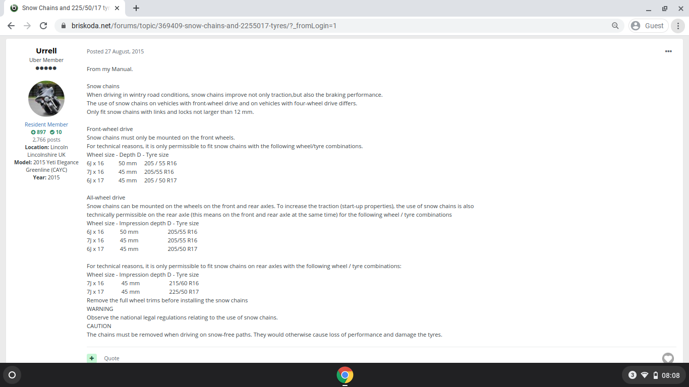

Snow chains
The snow chains improve driving in wintry road conditions. Before fitting the snow chains, remove the full wheel trims. Snow chains must only be fitted on the front wheels and are applicable only to the following tyre/rim combinations.
Octavia MK3 Scout
(a) 205/55R16 6Jx16 ET48
(a) 205/55R16 6Jx16 ET50
(b) 205/60R16 6Jx16 ET48
(a) 205/50R17 6Jx17 ET45
(a) 205/50R17  6Jx17 ET48
(b) 205/55R17 6Jx17 ET48
Notes:
(a) Only fit snow chains with links and locks no larger than 12 mm
(b) Only fit snow chains with links and locks no larger than 9 mm.
The above information about tyre and rim combinations for snow chains is in the owner's manual on page 282.
https://ws.skoda-auto.com/OwnersManualService/Data/en/Octavia_5E/07-2019/Manual/Octavia/A7_Octavia_OwnersManual.pdf?_ga=2.107158530.1213152461.1608930222-dfe66703-8989-42cc-99fc-86d69f1fa428
Edited by Carlston
Snow chains certainly do not have to be fitted only to the front of a vehicle with Haldex.  Read the owners manual.   It is a font of knowledge.   Beware of duff advice that might be on social media from people you do not know.
Beware of advice given that is just from an Owners Manual.
 See page 282.
Also read about TC off when snow chains fitted where that might be in an owners manual.   *Especially VW group owners manuals.*
Best sometimes to question what is in the owners manuals.  Especially Re snow chains fitted to AWD vehicles. 4x4,s.
If you have ever had to drive in serious conditions with snow chains just on the front of a part time AWD vehicle you might well know to ignore Skoda / VW advice / recommendations.
Yeti.
http://briskoda.net/forums/topic/369409-snow-chains-2255017-tyres
http://briskoda.net/forums/topic/411975-snow-chains
http://briskoda.net/forums/topic/368011-snow-chains-front-only
