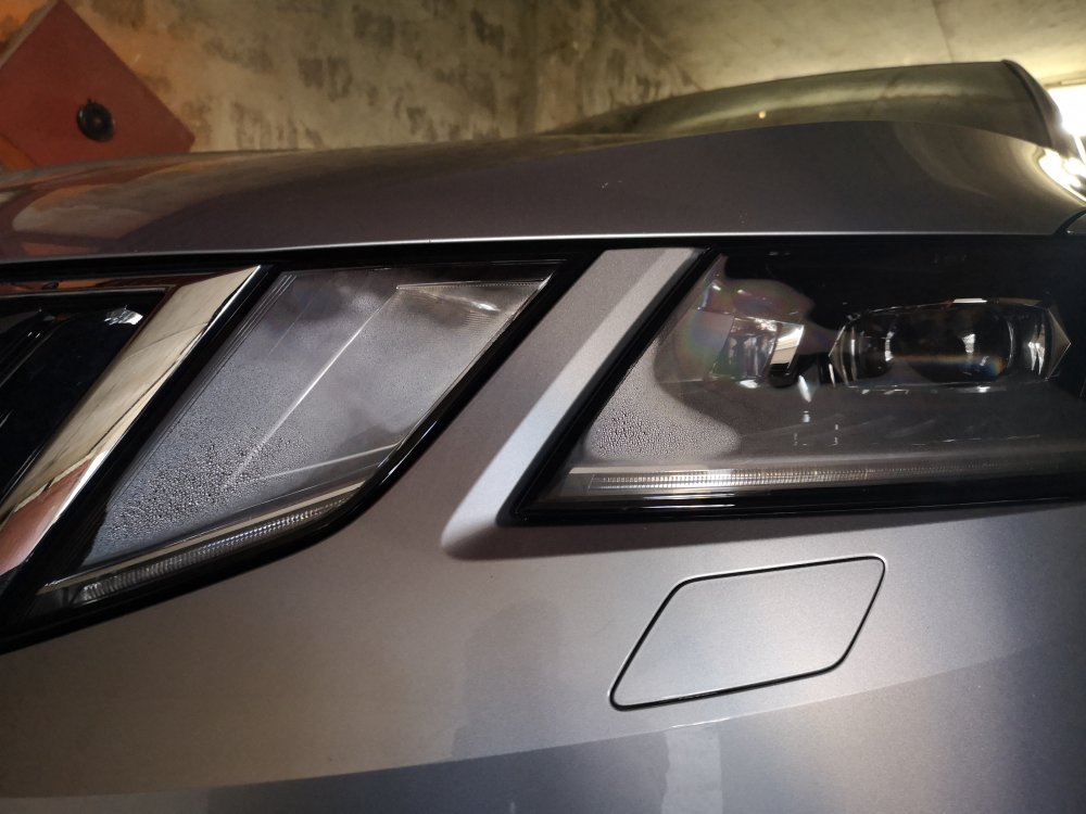

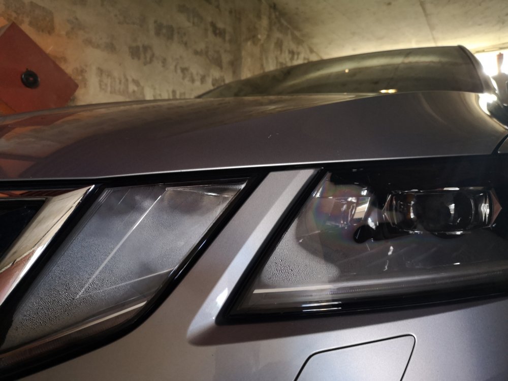

I own Skoda Octavia mk3 facelift with led headlights. I have noticed, when I wash my car I get a little bit of moisture in both headlights butnig goes away after driving it 10 to 15 min. Last week that got worse in my left headlight as I can see the water drops that wont go away inany case. It is winter now and it has been raining couple of days. Also my car is in garage a lot of time where there is no water that can evaporate.

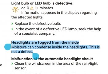

There will be a  statement similar to this in your owners manual.
The problem seems to be that LED lamps do not generate the same amount of heat that halogen or Xenon lamps produced that helped drive out the moisture inside the lamp unit.
Those water drops are there for like 10 days. There is no way I can remove them. I drove the car for 3 hours and they are still there. Also corner light in my left headlight, does not work properly because of this condensation.
Does the user manual explain how to get rid of those water drops?
Its all normal. My Scout does that. Best take the car for a long fast run and utilise the headlights as much as possible.
