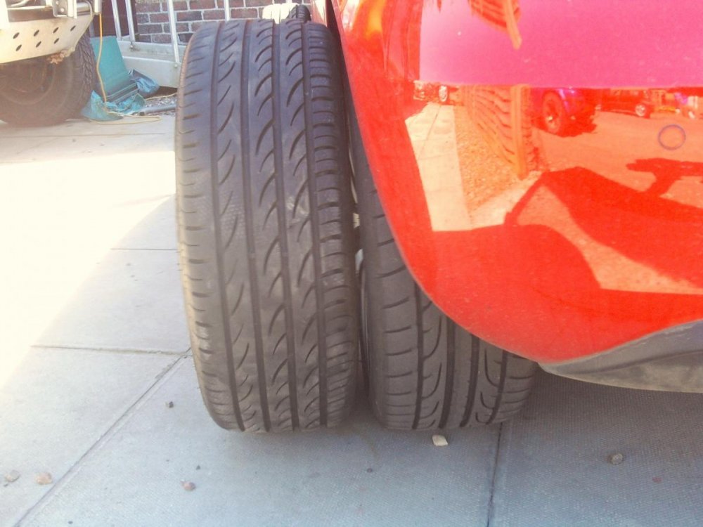

These are tyres from 205,215 and 225 tall on 17" x 7.5 rims that were tried and compared on the same or different cars, tyres with Speed & Load ratings appropriate to the vehicles being used on.
One big difference in the handling, feel, involvement  on the different tyres could come from adjusting the steering assist to suit the tyres & rims fitted & the season. Also adjusting tyre pressures.
There is a lot to be said for actually trying different tyres and set up on your favourite roads that you drive on and then making decisions or giving comparisons on what does what and where.
A 215 tyres with rim protection can be wider than a 205 with no rim protection, but there might be no more tread on the road with the 215.
Then there are XL on not XL sidewalls to take into account.
