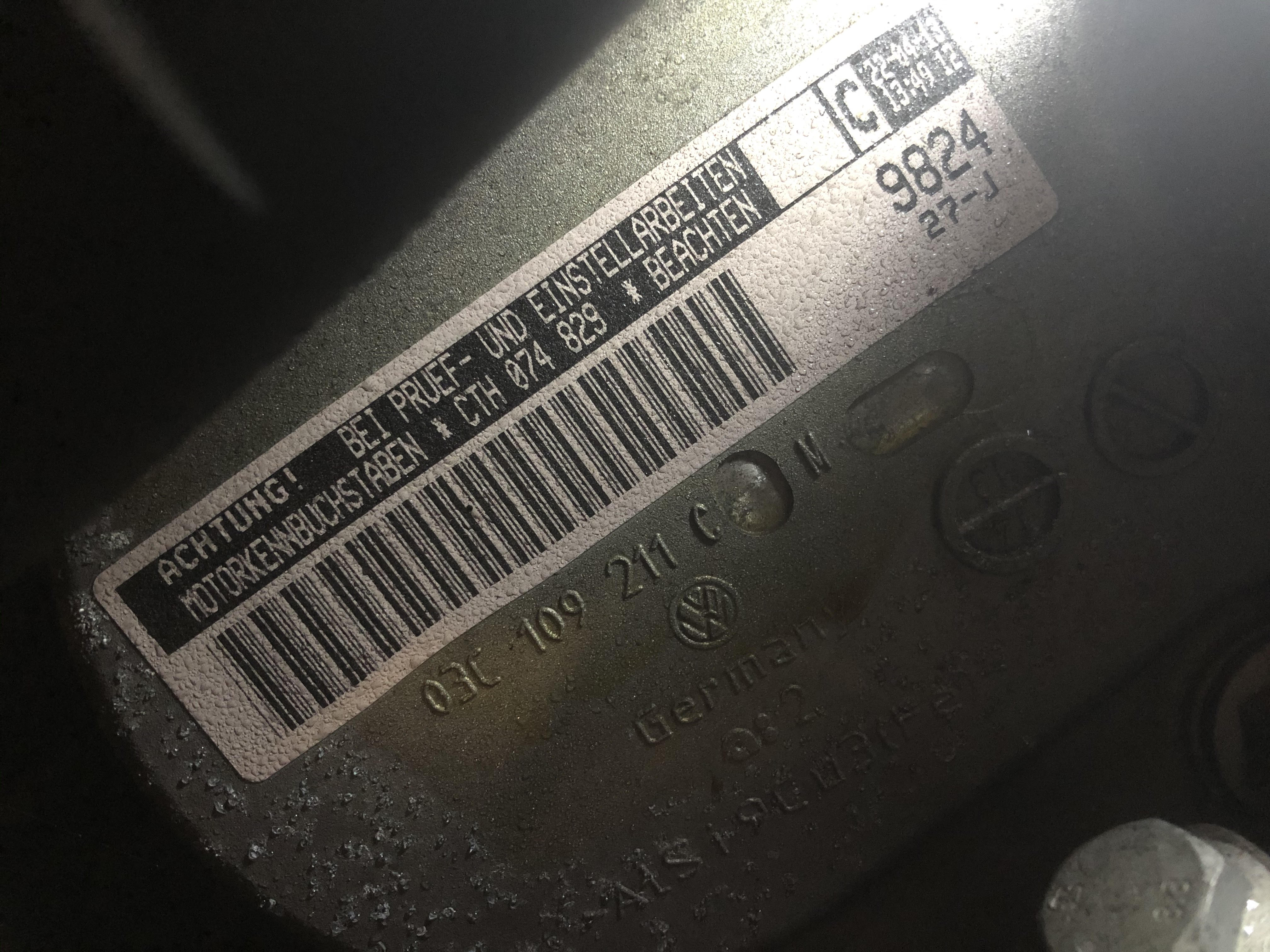

How do i know it's also a CTHE code?

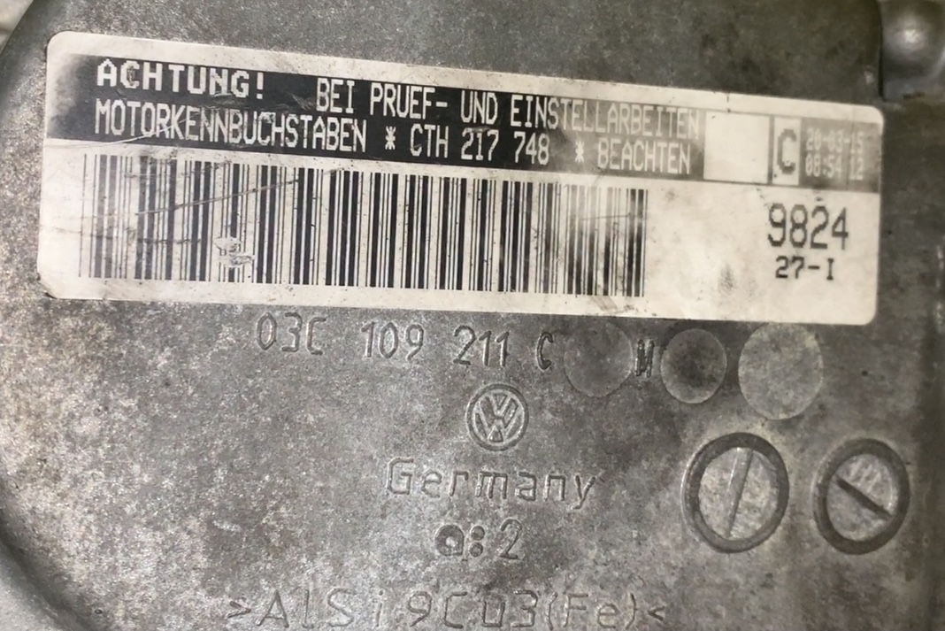

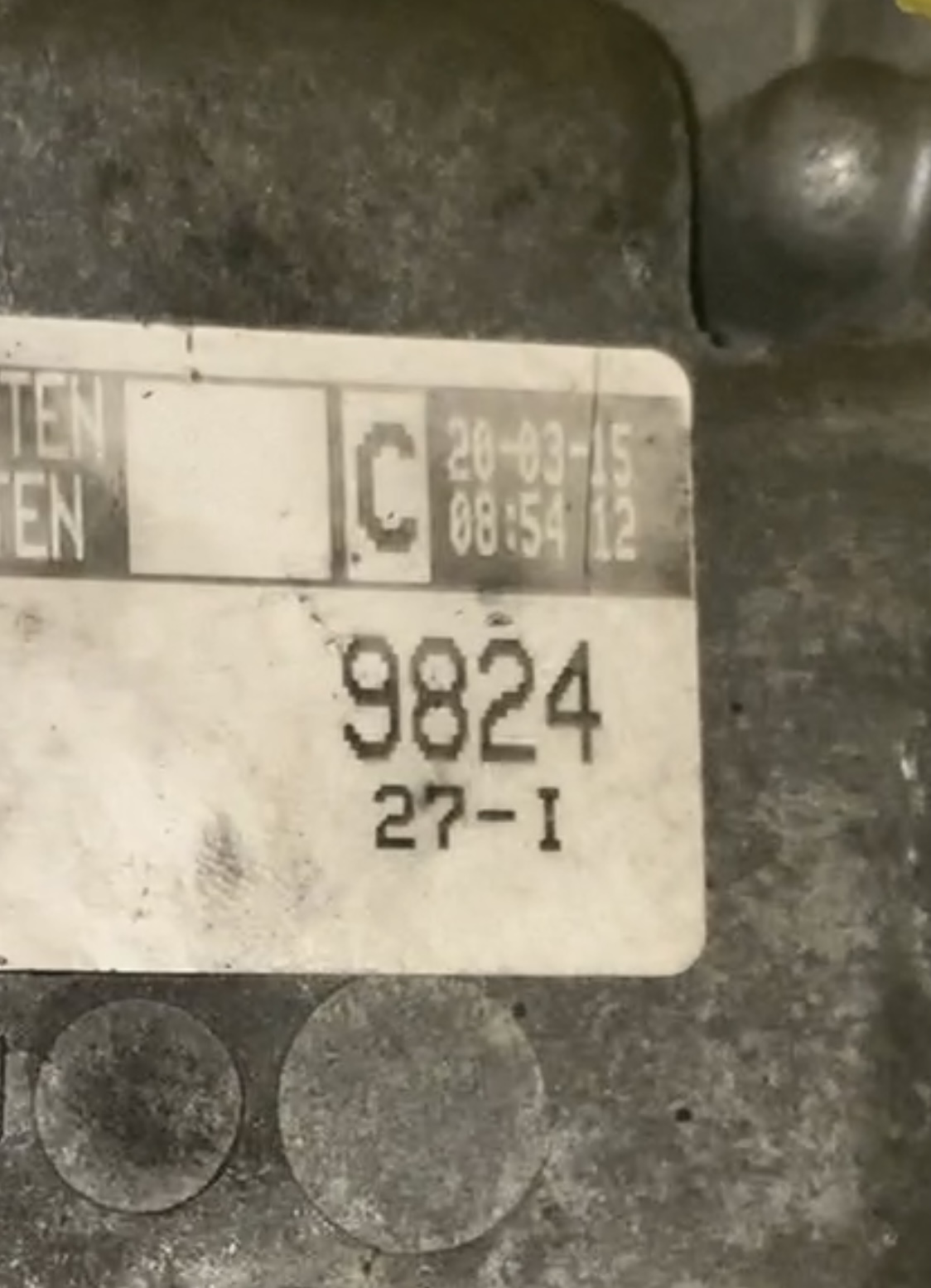

I found on timming chain cover this label, it says CTH, date: 20-3-15
But fabia 2 rs was produced until 2014

the seller claimed that is from fabia rs, on the label is CTH date of production 20-3-2015, on the internet it is written that fabia 2 was manufactured until 2014, and CTHE engine was manufactured until 2014, is that true? that would mean my engine is not from fabia rs,Polo gti, ibiza cupra

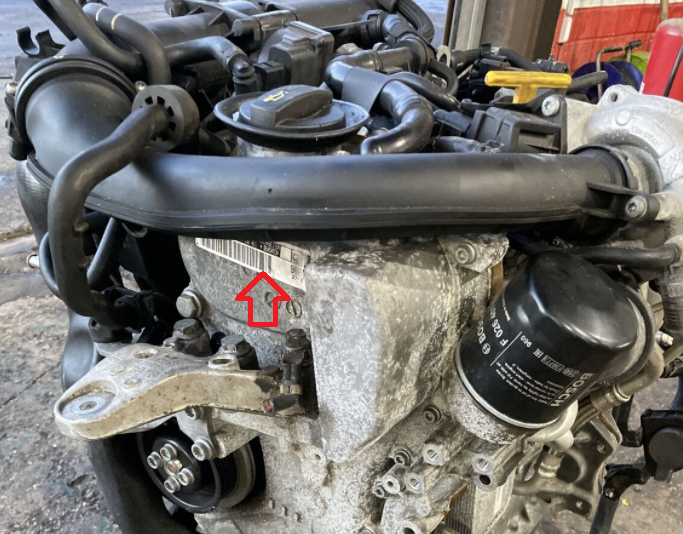

Where on the engine is that sticker ?? If i can see mine will go have a look
  • Sponsor
Here I think:
Ok will go and check, I have a feeling it will show CTH as above but an E where the C is..........could be wrong tho

heres my sticker, very similar and no obvious ref to CTHE  has a C in the same place as yours.....so how you would def determine the diff I am not sure. Im sure a scan of the barcode would help though !! :giggle:
  • Sponsor
Are there definitely physical component differences, not just software/mapping?  If there were physical differences, you'd kinda expect that sticker to be specific and include the fourth letter of the code?

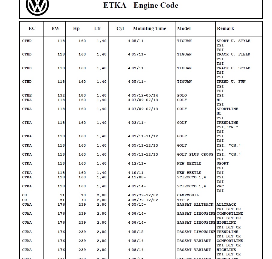

According to this from ETKA, the CTHE only ever went in the Polo GTi, no other VW's ever had it.

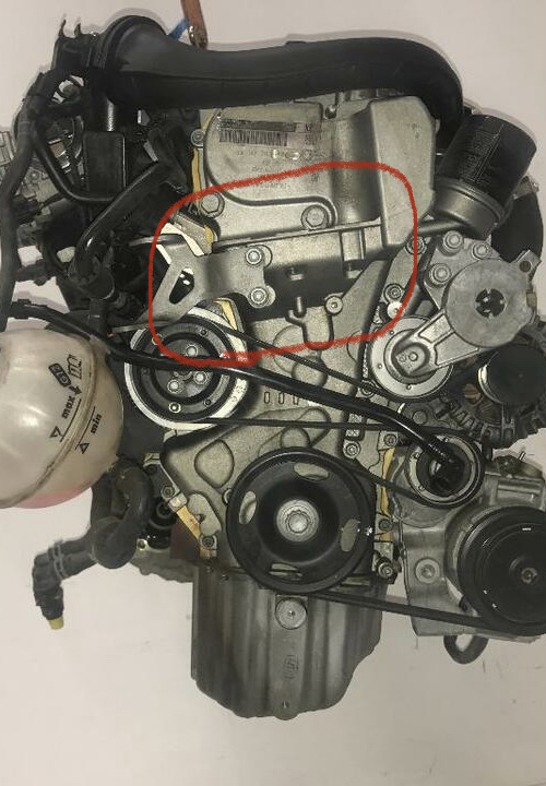

So still dont know it 😬 the only thing i know is that my engine was built in 2015, so as you write, CTHE 132kw was made until 2014, so maybe my engine  i have from weaker parts for 140hp, 150hp etc. I read that only for 132kw modification was replaced better and stronger pistons, stronger camshafts, forged crankshaft and stronger connecting rods, that sucks 😌 i know that 140,150,160hp version have problem with Piston crack,

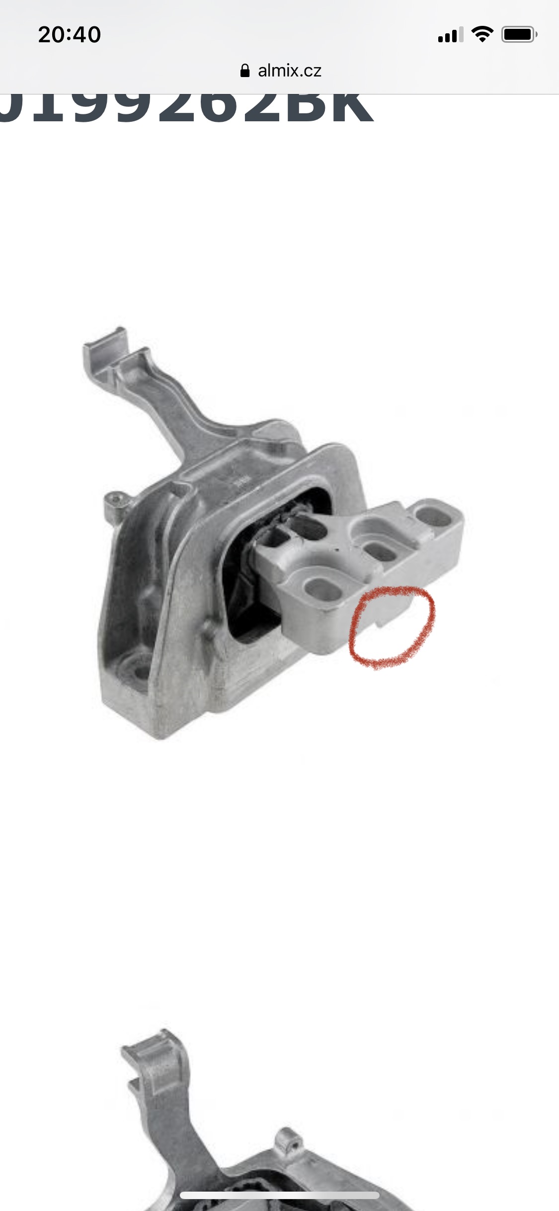

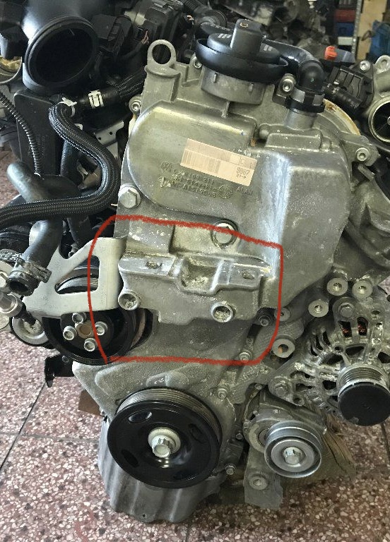

MAYBE i have one think, for golf 5, golf6, touran, scirocco etc. They have 2 bolts on engine mounting and it have this cutout, on (poli gti, fabia rs, Ibiza Cupra) are 3 bolts and this flat, i have 3 bolts and flat. + I know for 100% that flat tipe of mountig have  larger screw pitch than with cutout (I tried it myself)
So what do u think guys?😌😌

First is from 2 bold and cutout engine mount
And lower is 3 bolt, flat, from gti rs Cupra

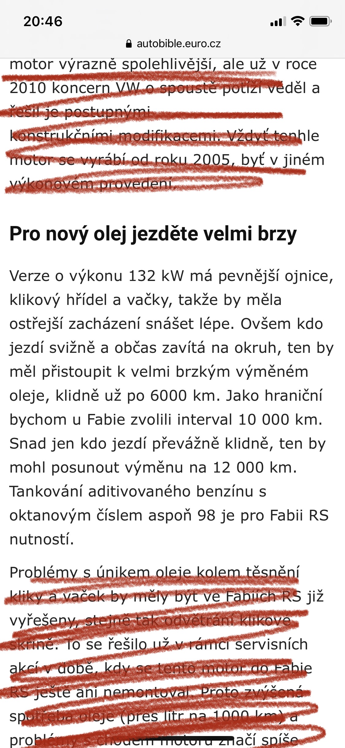

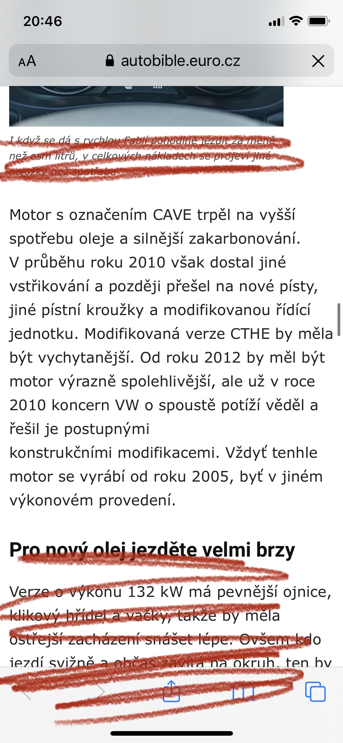

Im from CZECH, I asking here because se dont have more guys with fabia 2 rs etc. I will translate it for you
  • Sponsor
If I look up CTHD for Golf and CTHE for Fabia I see the same part number for crankshaft (well, from Feb 2011 onwards in Fabia). Haven't checked any other parts, but someone else may be kind enough?
crankshaft; conrod; bearings - Golf/Variant/4Motion(GOLF) [EUROPA 2013 year] (7zap.com)
crankshaft; conrod; bearings - Fabia(FAB) [EUROPA 2014 year] (7zap.com)
My Czech reading skills are poor, but are you sure that isn't talking about differences between CAVE and CTHE engines?
The 132 kW version has stronger connecting rods, crankshafts and cams, so it should tolerate sharper handling better.  However, those who drive fast and occasionally visit the circuit should change the oil very soon, after 6000 km.  We would choose an interval of 10,000 km for Fabia as a border.  Perhaps only those who drive mostly calmly could move the interchange to 12,000 km.  Refueling of additive gasoline with an octane number of at least 98 is a must for the Fabia RS.
The CAVE engine suffered from higher oil consumption and stronger carbonation.  During 2010, however, he received a different injection and later switched to new pistons, different piston rings and a modified control unit.  The modified version of CTHE should be smarter.  From 2012, the engine should be significantly more reliable, but already in 2010 the VW Group knew about a lot of problems and solved them with gradual design modifications.  After all, this engine has been manufactured since 2005, albeit in a different power design.

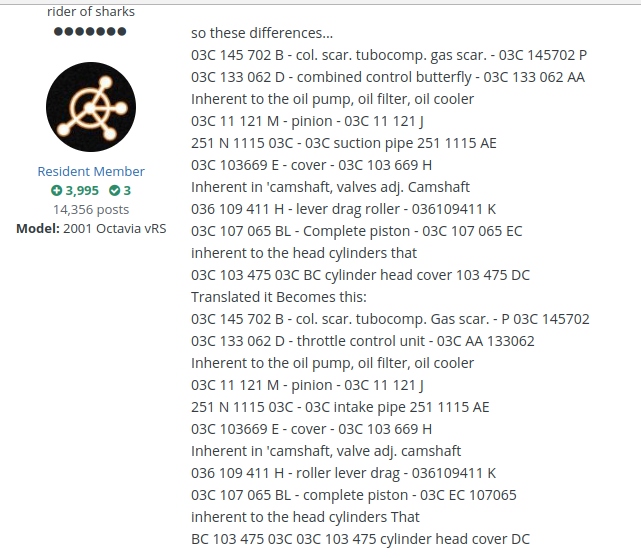

On those same two pages I linked above, the connecting rods are shown as the same part numbers too. So the same items.
I did find an exhaust camshaft part number difference though, between CTHD and CTHE.
I think what you've quoted there is talking about CAVE/CTHE differences.  I think there should be a comma where the word 'of' is.
" The modified version, CTHE "

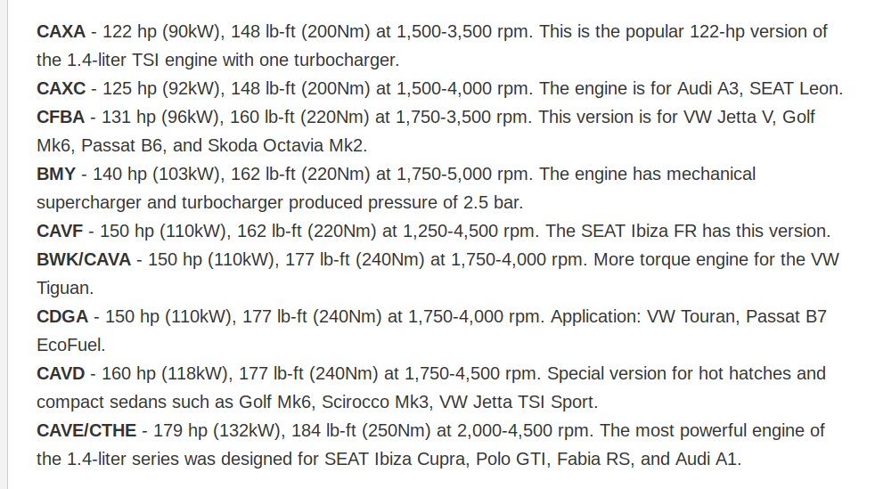

If you want some reading on the Euro 5 1.4 TSI  180 ps as in the SEAT from 2009, VW & Skoda from 2010 ( & the TFSI 1.4 185 ps in Audi A1) then here it is.
http://briskoda.net/forums/topic/421365-links-to-lucifers-ultimate-guide-to-14-tsi-twincharger-engines
Thank you

If you don't believe ETKA information about crankshafts and conrods being the same between CTHD and CTHE engines, I can't help you.

If that ETKA says that i will believe her, so u think that CTHE and CAVE (132kw) have same parts like ctha, bmy blg etc?
