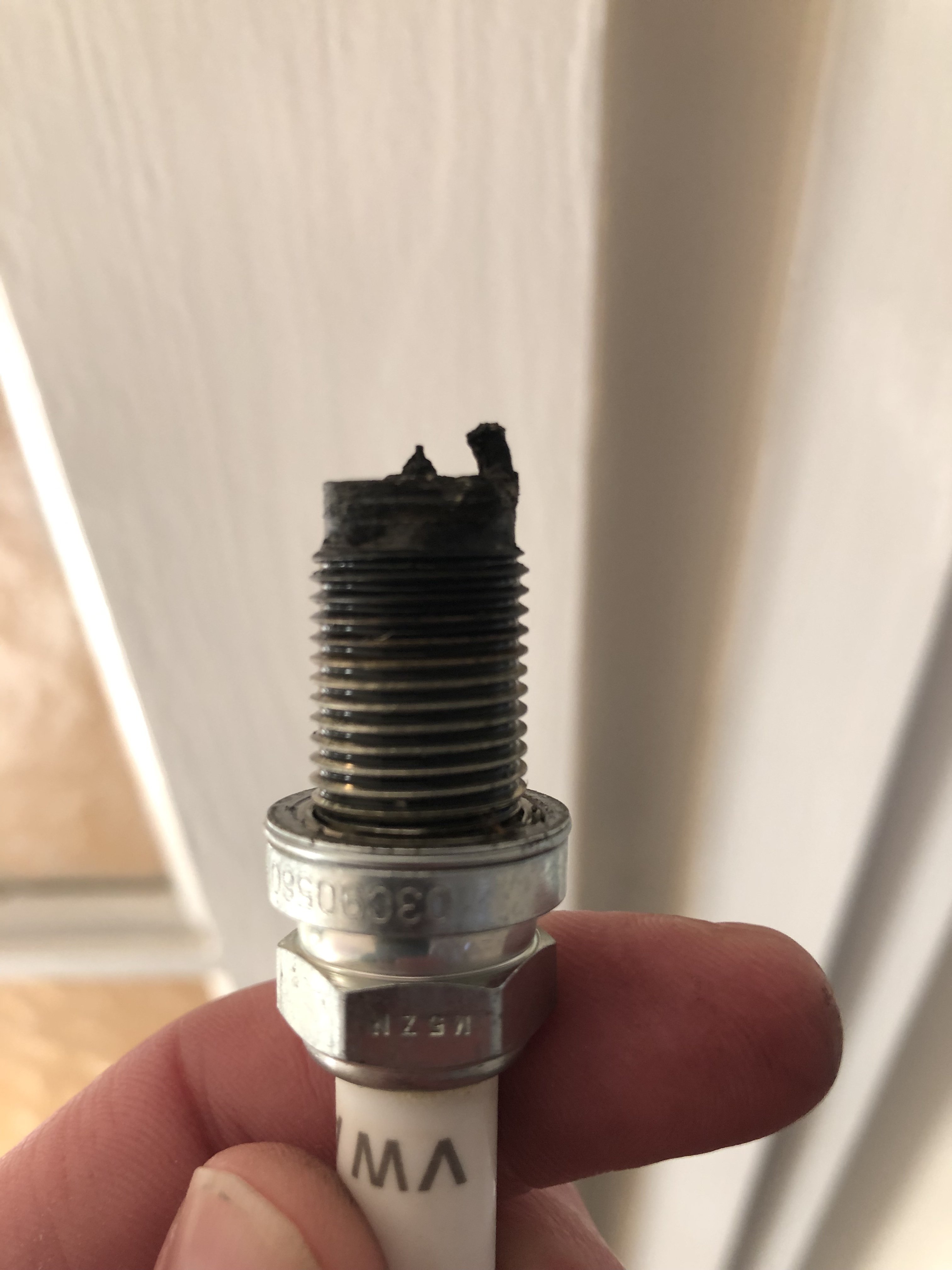

My previous engine gone because, peace of spark plug fall into cylinder, and valve broke, Now my new engine have 20 000km, its like brend new, my previous have stage 1 too
In my experience it's far more common for a dropped valve head to break off and damage the sparkplug than the other way around!
A dropped valve generally happens if the engine is over-revved, usually during an accidental down shift.
it happened to me when I was going uphill, 3000rpm+- piece of spark plug stuck under valve and then valve broke, engine goes on 3 cyl

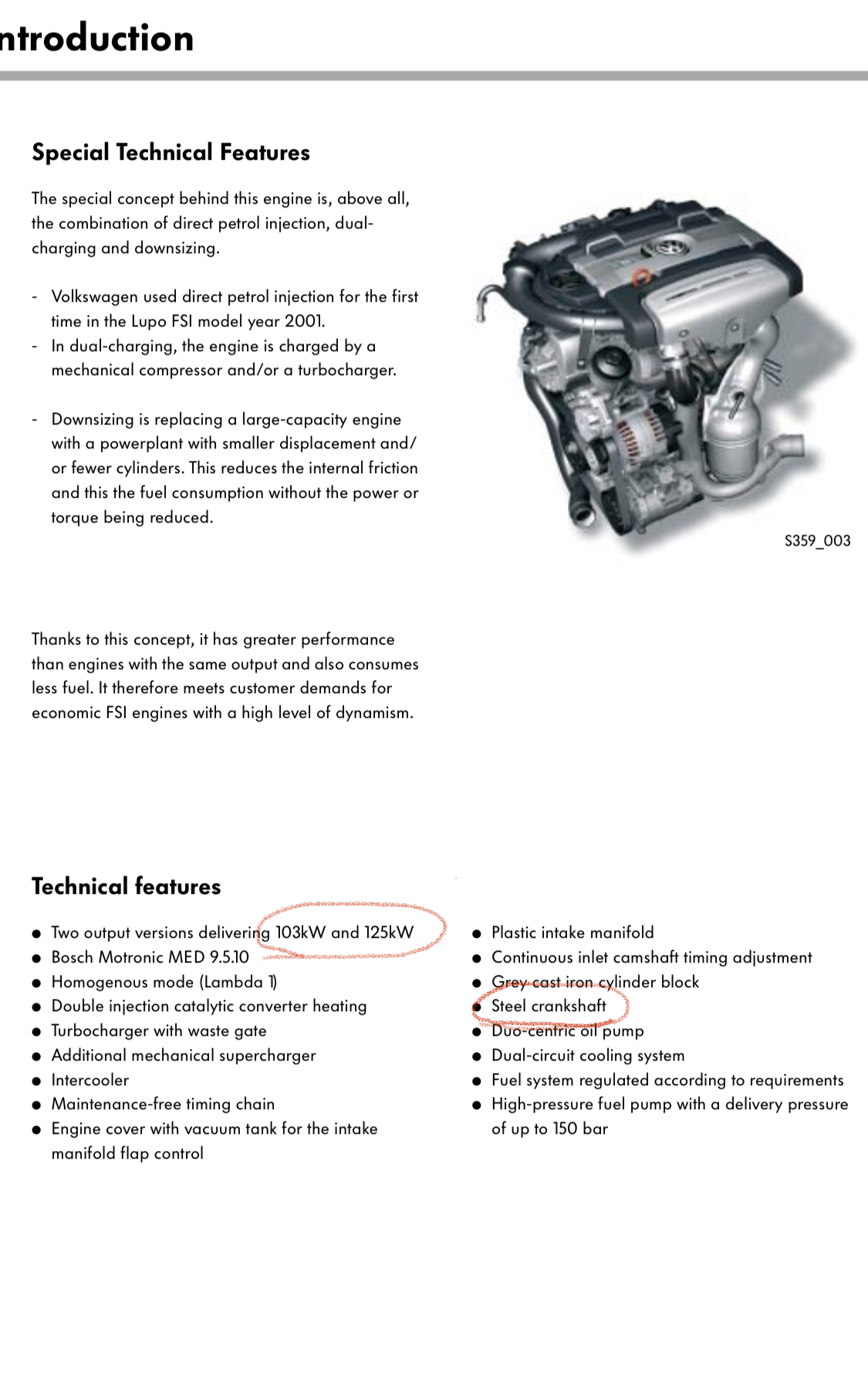

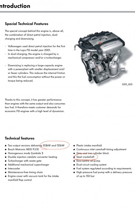

I think you may be traumatised by the expense of the engine failure but as wino says the same part numbers should convince you.
Here is just steel crankshaft, not forged, so mine can be just forged too
I really don't think we can take this much further.
In the old days cranks were often cast, nowadays they're all forged, these are the only two ways of making a crank.
You seem to be having a lockdown meltdown, go and have a lie down and stop thinking these pointless negative thoughts.
