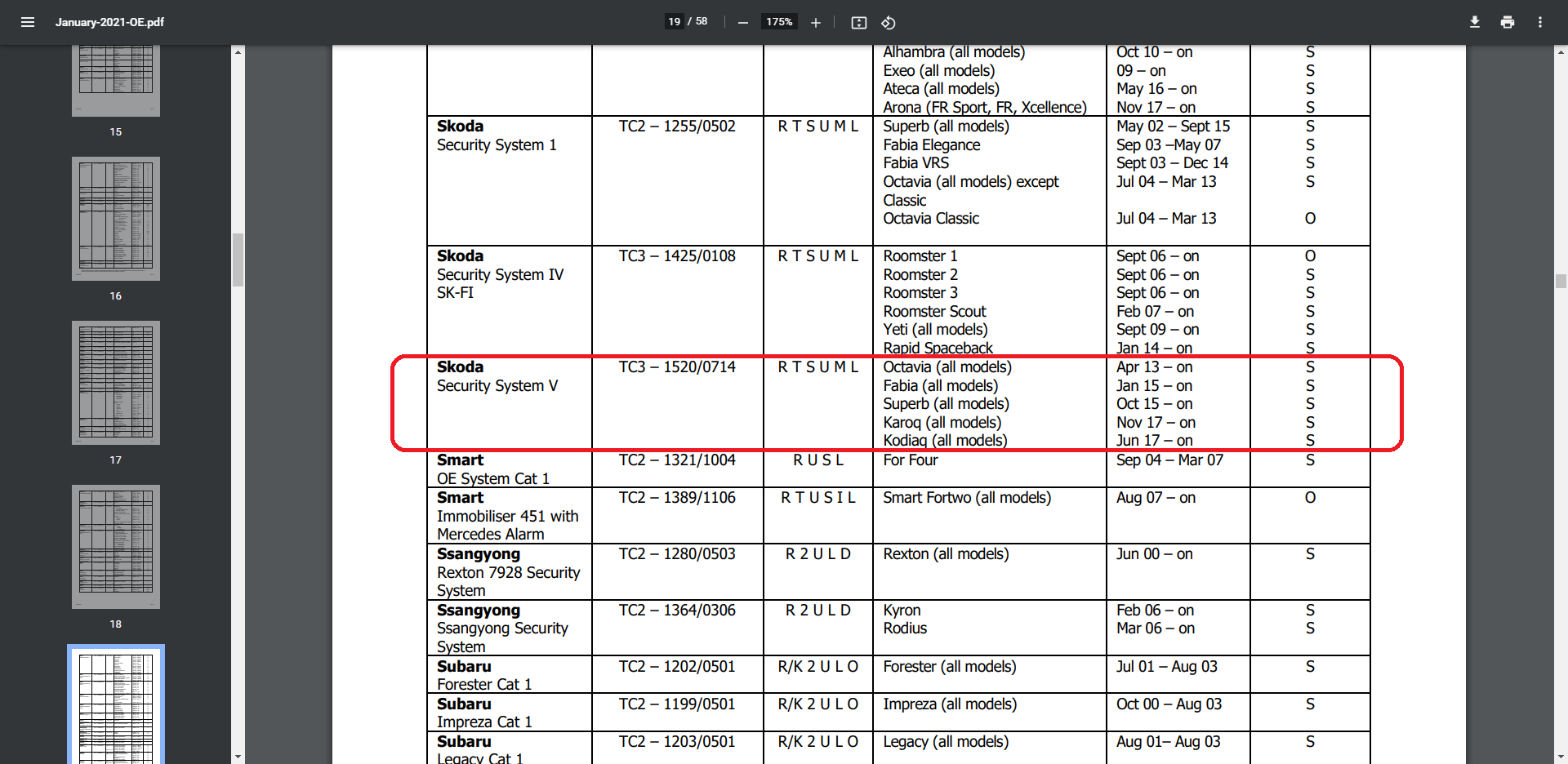

Taken from https://www.thatcham.org/wp-content/uploads/2021/01/January-2021-OE.pdf
It's in the Category 1 section:
So that would be:
  R - Remote
  T - Transponder
  S - Software Lock
  U - Ultrasonic
  M - Microwave
  L - Central Locking
Anti-tilt motion/jacking up the car? Probably not, easy to check with a jack...
Exterior proximity sensor/protection? Probably not, try kicking it or quickly dropping it off the jack ;)
Door, Boot, Bonnet, Trunk protection? Yup
Battery Back-up siren? Yup (should last ~6 years and will create a fault code when flat).
Thatcham category 1 or 2? Cat 1

Useful information, I just checked in obd eleven & I have ticked "anti theft system inclination sensor" so I'm assuming this is the anti-jack feature & (M=microwave above what you posted) again I'm assuming this must be exterior protection or interior protection with or for the ultrasonic sensors? I will definitely try kicking, jacking & bashing the vehicle, glass (windscreen) (drivers) body-work/wheels & see what happens B) Will report my findings...
So the factory alarm does have the following:
Anti-tilt motion/jacking up the car? (if you jack up the car off of the ground slightly) the siren will sound.
Door, Boot, Bonnet, Trunk protection? (open any of these & the siren will sound)
Interior ultrasonic/microwave (move around inside & the siren will sound)
Battery Back-up siren (does the siren have a built in battery backup)
Thatcham category 1 (for insurance purposes)
