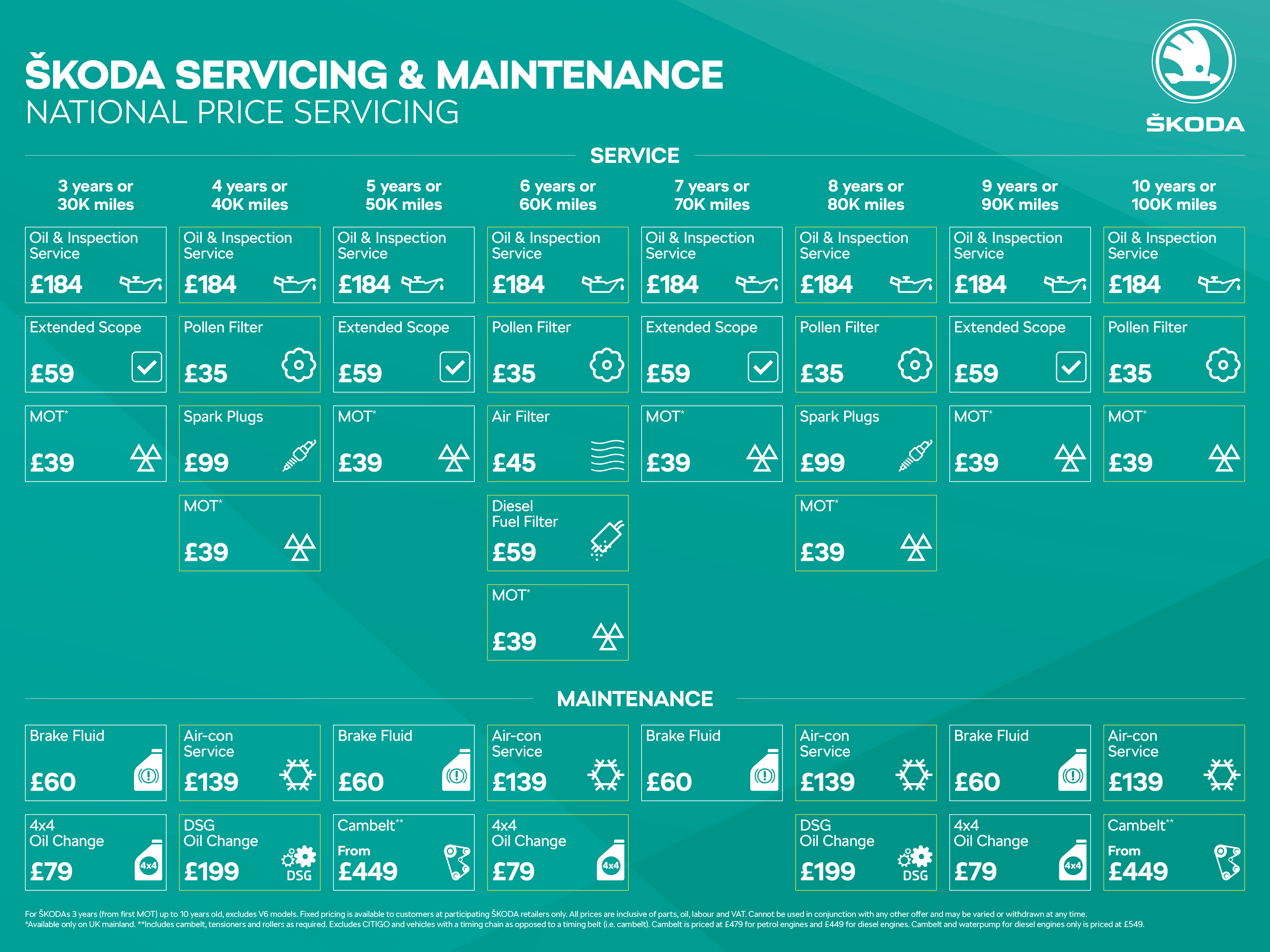

Have a look at the small writing at the bottom, says petrol & diesel but petrol has a timing chain? Me personally would not change the cambelt at 140,000 miles but rather much sooner especially as this official Skoda document says at 50,000 miles & wouldn't it be better to be safe than sorry :blink: I would change it between the 50,000 - 70,000 mile range or every 5-6 years.
Hmmm, cambelt at 50k??? Without sounding like a broken record on this thread I called Skoda and they told me that it was 140k or 5 years for cambelt changes on the 1.6 and 2.0 tdi engines. I changed mine at 133k but will do it again at 200k. That is pretty much par for the course for most cars.
£184 for an oil change is obscene. It doesn’t even cost me £120 for a FULL service at my local independent garage. They must be charging about £100 in labour.
I agree the price for an oil change service is very high, but type of the oil used is also important.
