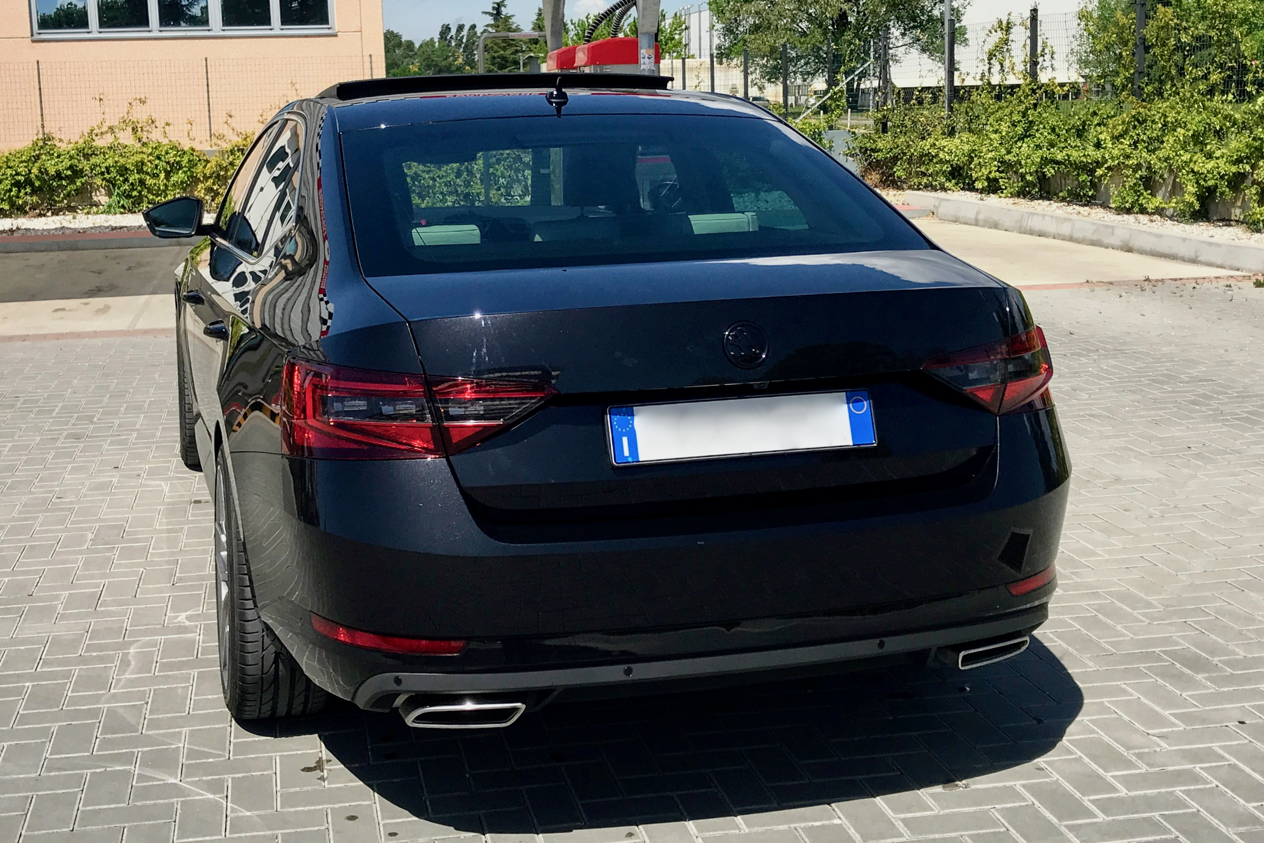

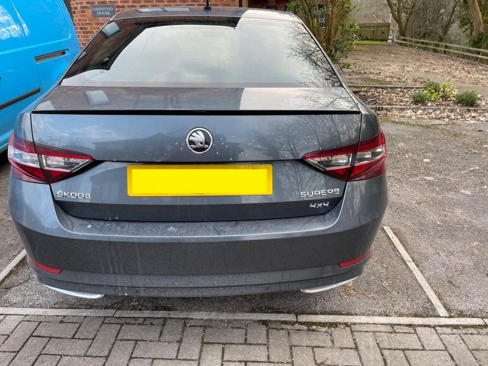

Has anyone found / fitted black badging to their Superb?
I've got the earlier Superb III Sportline with the black Spoiler, I'd to replace the emblem, Skoda, Superb and 4x4 badge with good quality black ones. Has anyone done it, where did you gets yours from?

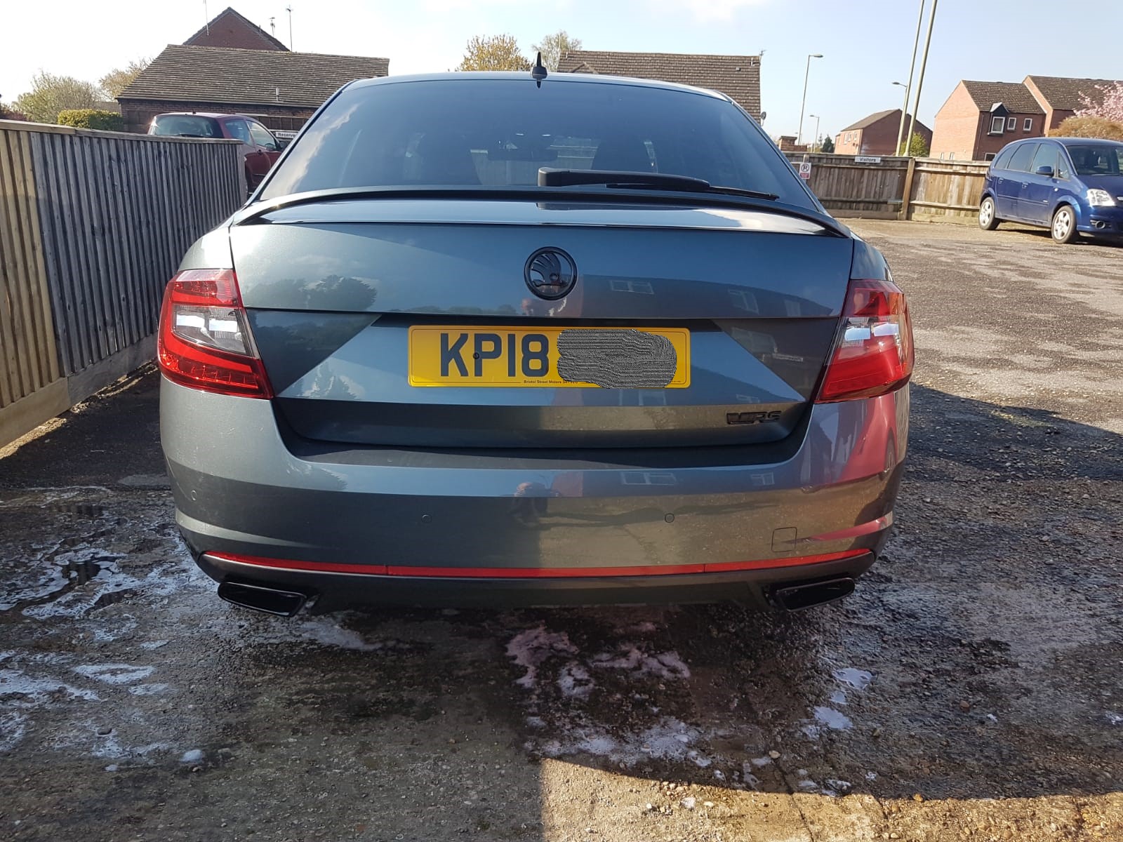

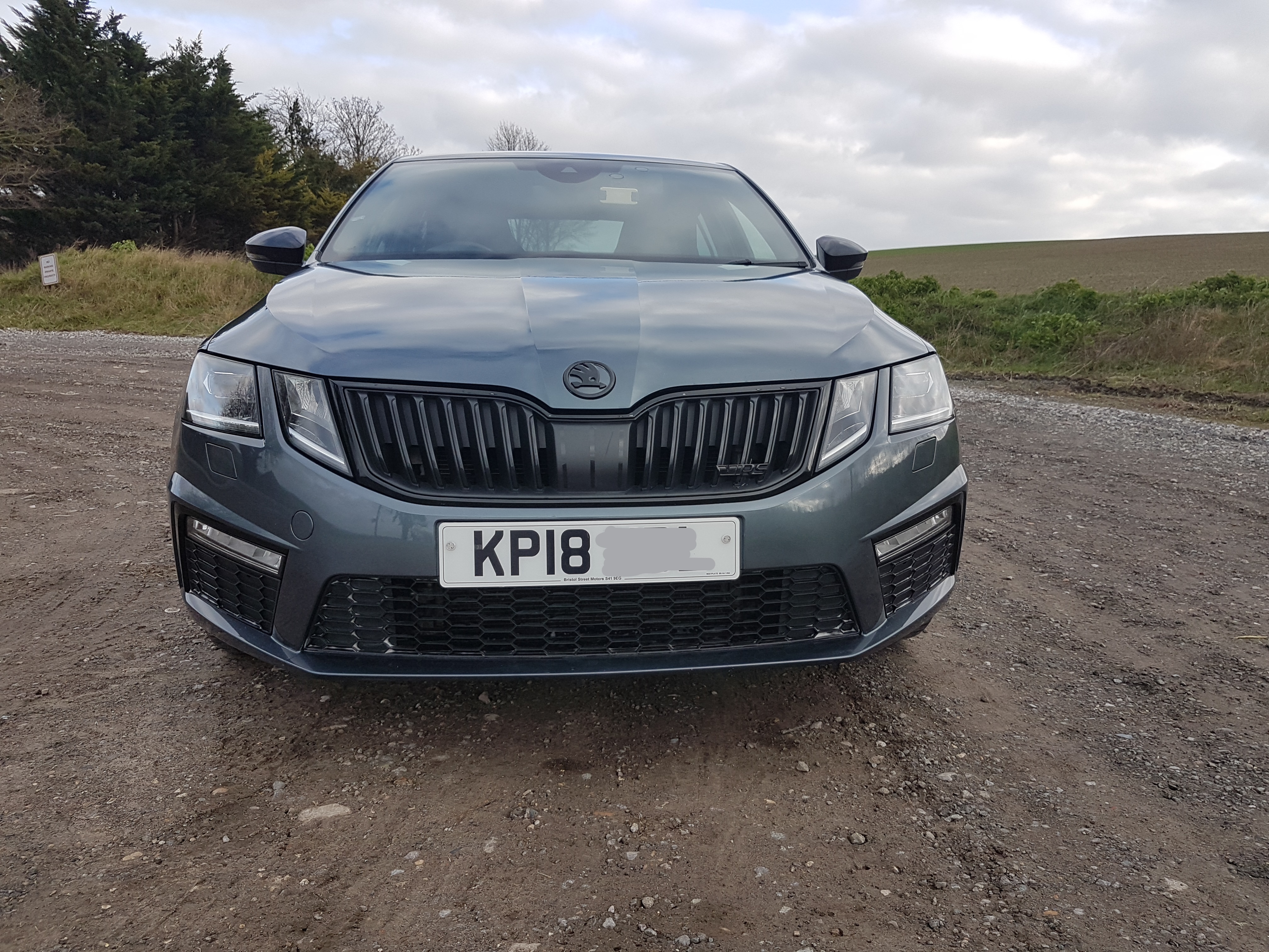

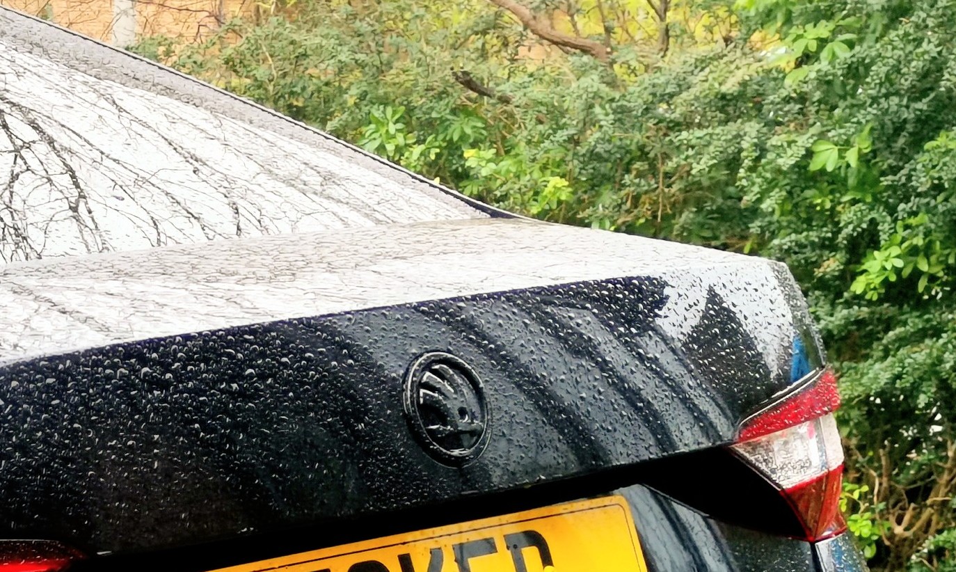

I have an Octavia, not a Superb, but I replaced some badges with colour matched ones and with the VRS ones, I replaced them with black badges. The rest I just left off for good. I just do not like chrome. I bought mine from Superskoda, a bit expensive, but I wanted quality ones not cheap ones made in China.

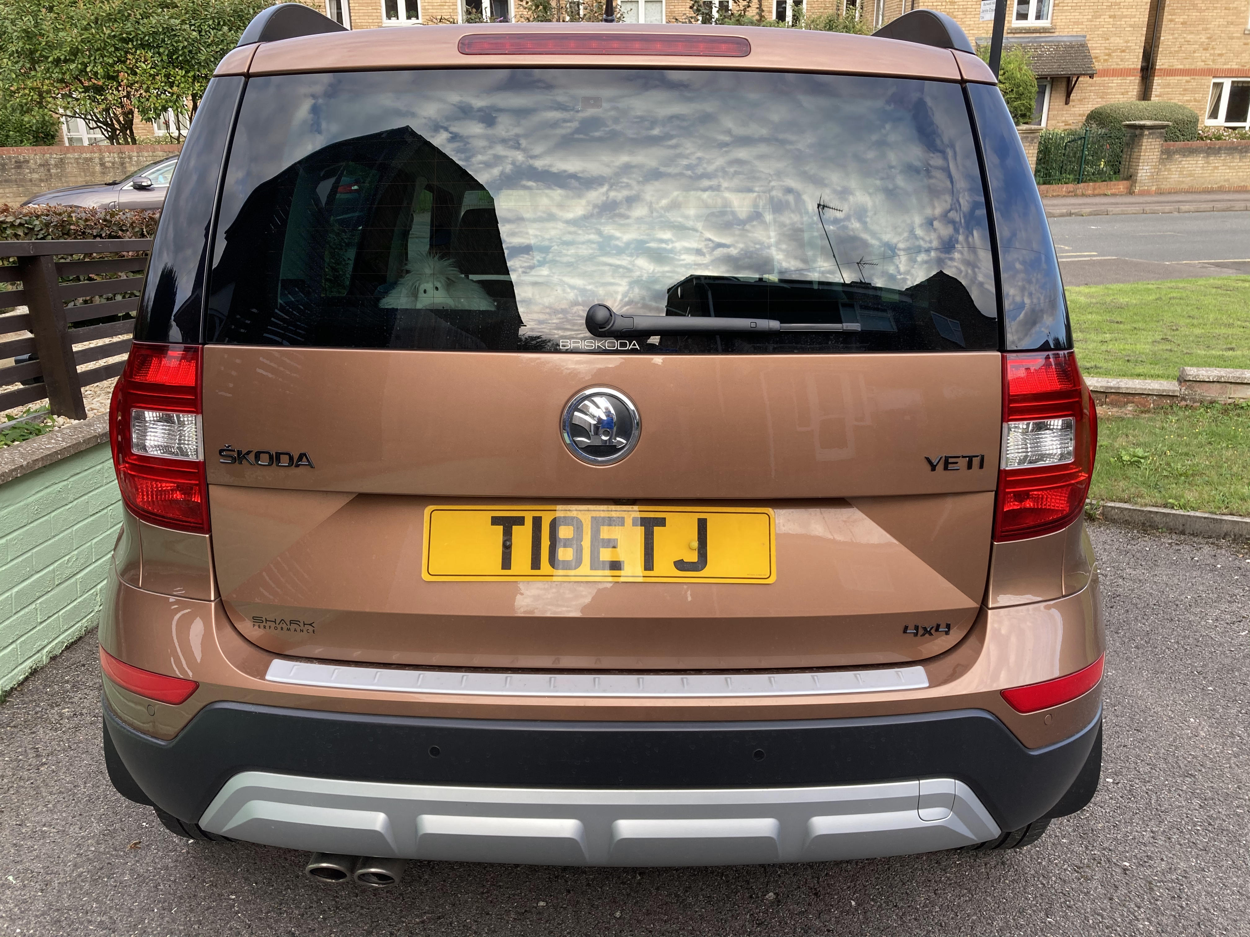

I bought the Skoda and 4x4 badges for my Yeti from Superskoda. I had to buy and spray the Yeti badge black as it was never produced in black. It looks like the Skoda Superb 4x4 are all available.
Emblems : kopacek.com is now KOPACEK.COM
To get them off, I gave up with dental floss and very carefully used 0.025" stainless locking wire to 'saw' through the adhesive pads. No marks left in the paint.

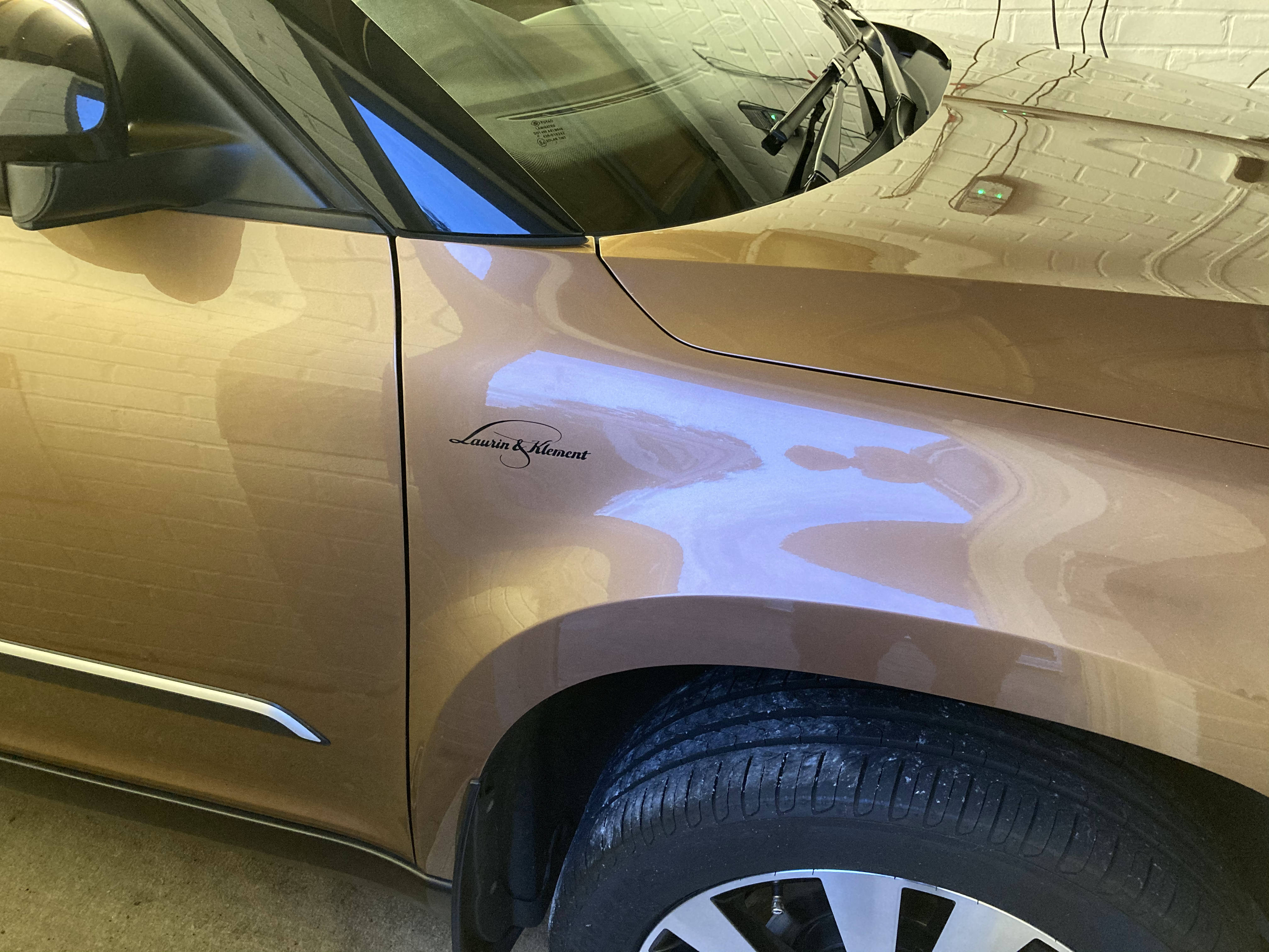

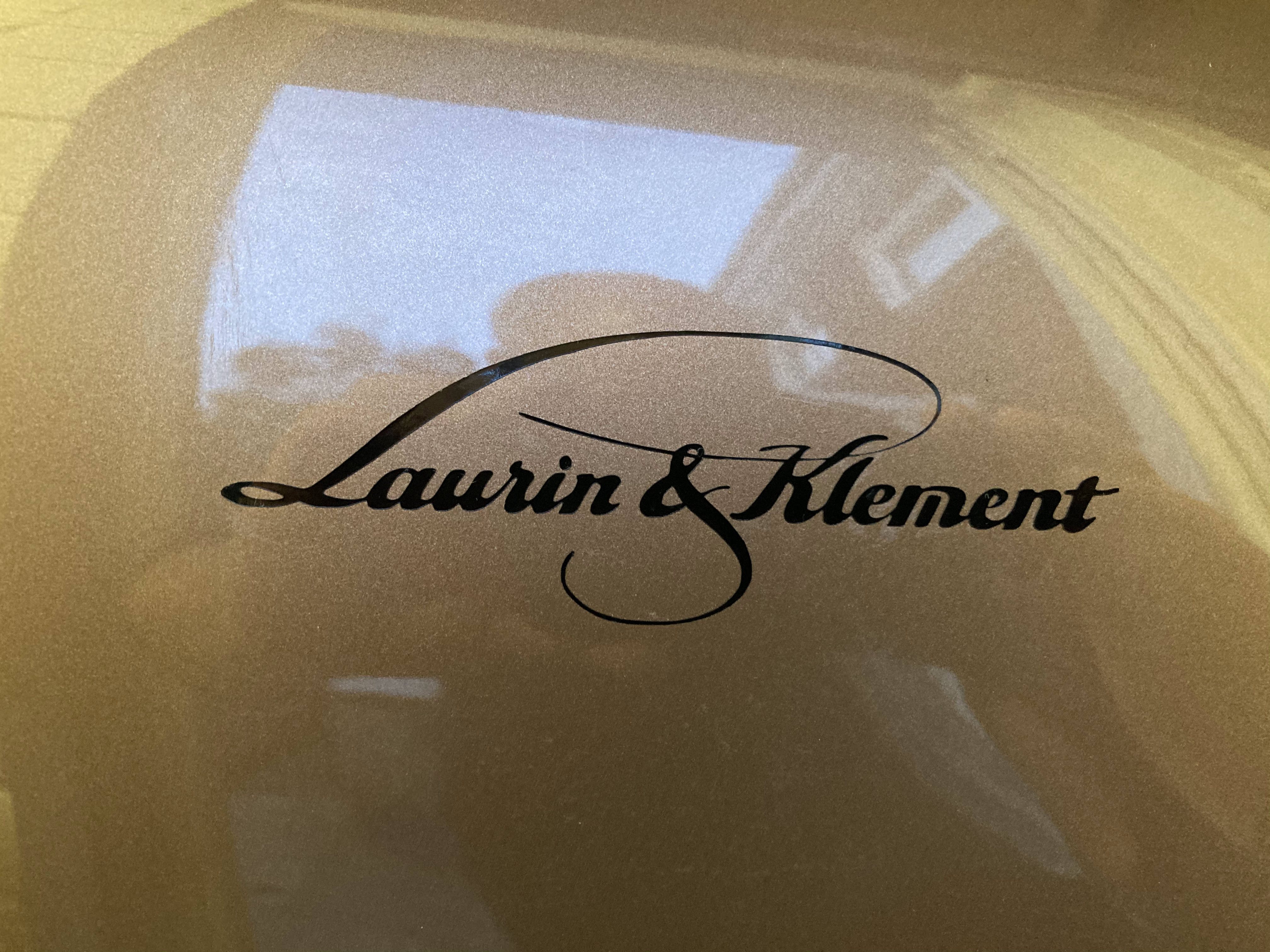

 L&K badges done on a vinyl cutter....

Incidentally, I did try using 'Plasti Dip'  initially on a new OEM chrome Yeti badge but that wasn't very successful so just sprayed them in standard primer and gloss black paint and it's fine.

They look gorgeous.
I'd like to do the same, mine is also a VRS 230, but it's black, so I'd go for black.

Hi Noms. From my experience I had no major problems with my order. I ordered the badges around August last year. They took about 2 weeks to arrive. There were no additional costs, as I paid the quoted price on their website. However, the badges from Superskoda are fairly expensive, but they do look quality, not rubbish Chinese knockoffs.  They did make one mistake with the order, giving me a bolt on front VRS badge instead of the glue on one I ordered. This they exchanged once I sent the bolt on one back. When you take your own front glued on badge off, make sure you warm the badge up first. Soften the glue and then you have to give the badge a fairly good pull to get the thing off. I then used araldite glue to put the new one on after I roughened up the plastic surface first. Just get the badge straight mate!

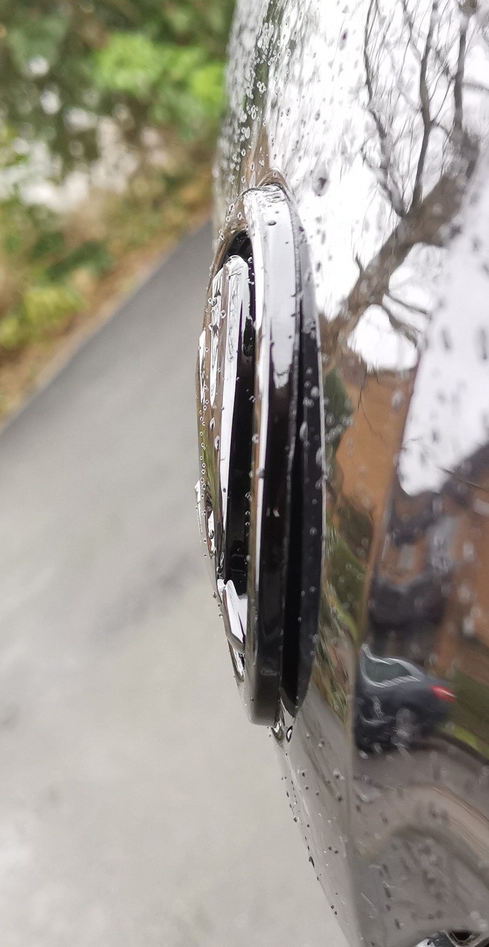

I bought some cheap black ones off ebay, looked good, but the curvature on them was wrong and didn't properly fit the contour of the car. I thought the kopacek (superskoda) price on the badges was crazy, but in retrospect, I'd have said pay more for the kopacek ones, as people here have said they're excellent even if costly.

If anyone wants my ebay black ones send me a stamped addressed envelope, although I've removed the adhesive from them. See from a distance they looked fine, but up close you can see how the curvature isnt quite right, I think most of the 90mm ones out on the market are probably intended for a different skoda with different curves than the superb. I also noticed Superskoda site stating the wrong size somewhere. Superb 3 is 90mm front and back.

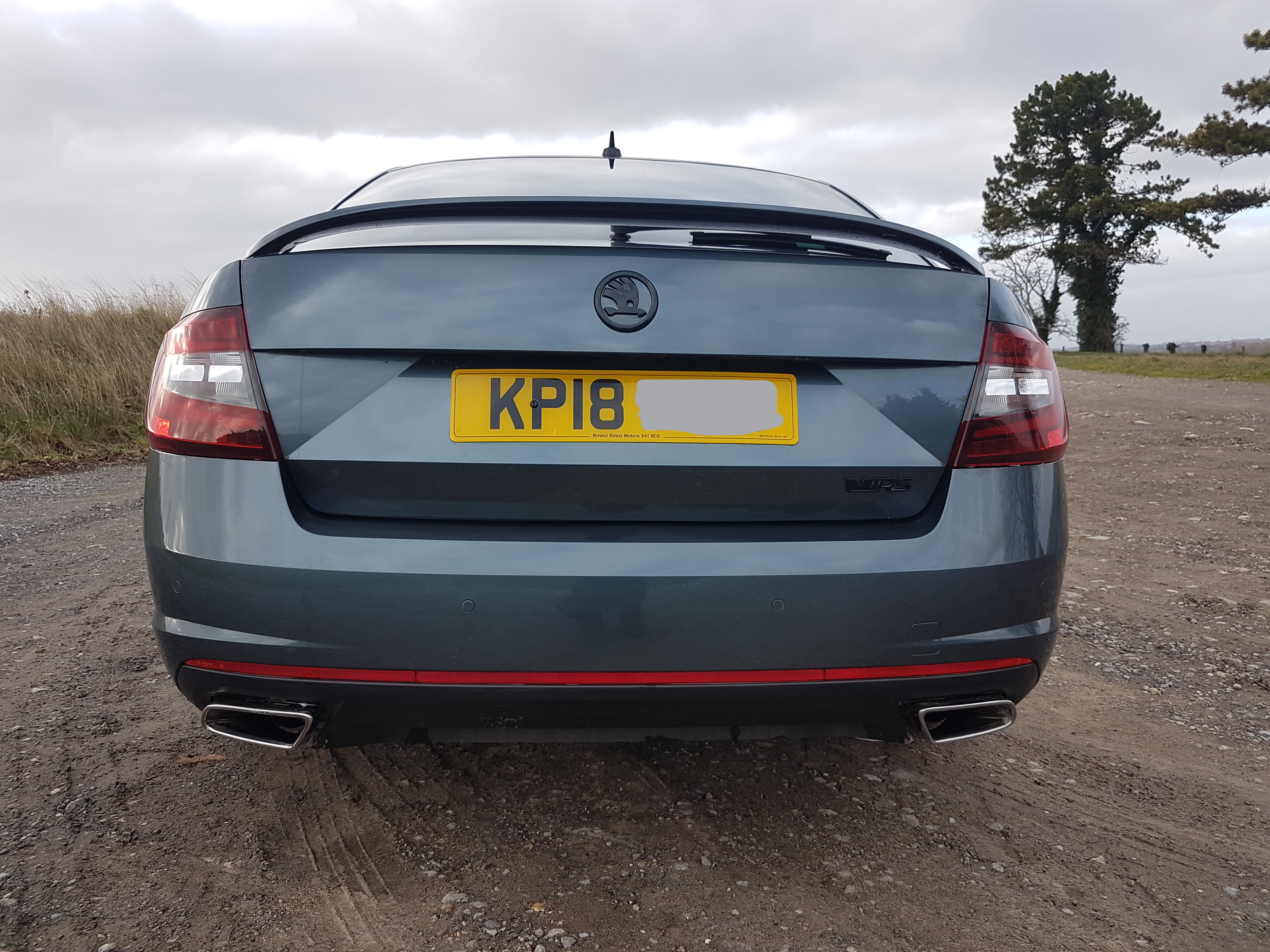

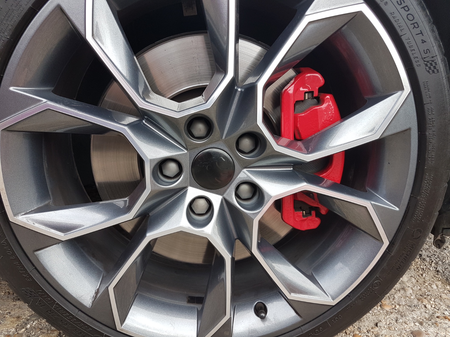

As stated above, I just do not like chrome, so I have now painted the exhaust tips gloss black. Even replaced the chrome wheel centre caps with black ones.
Looks great. Can we see the centre caps too please? Where did you source them from?
I sourced the centre caps from ebay, just fairly cheap ones that look like the original ones but certainly not as good quality. Rubbed them down and then sprayed them black, the same black paint I used on the exhaust tips. I saved the original ones which are in great condition, just in case I did not like them black on the car. The black ones are staying on the car.

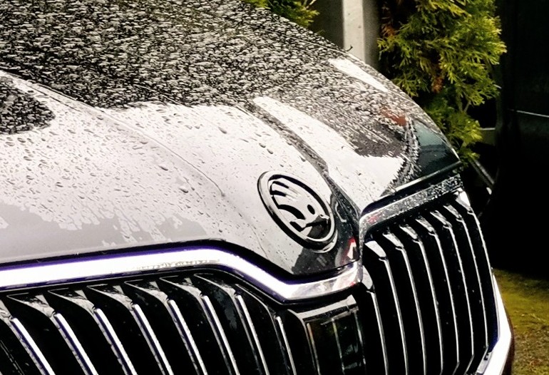

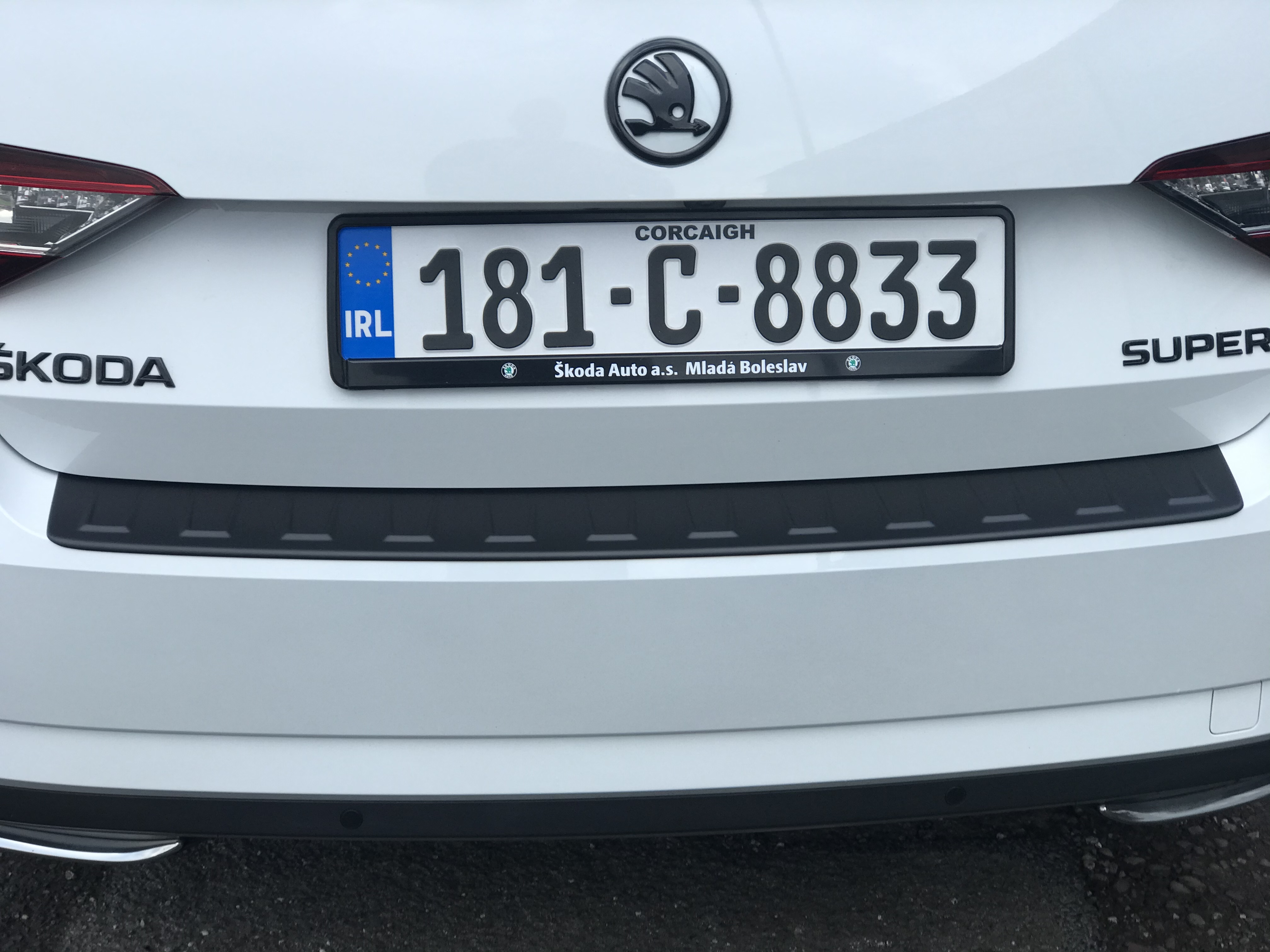

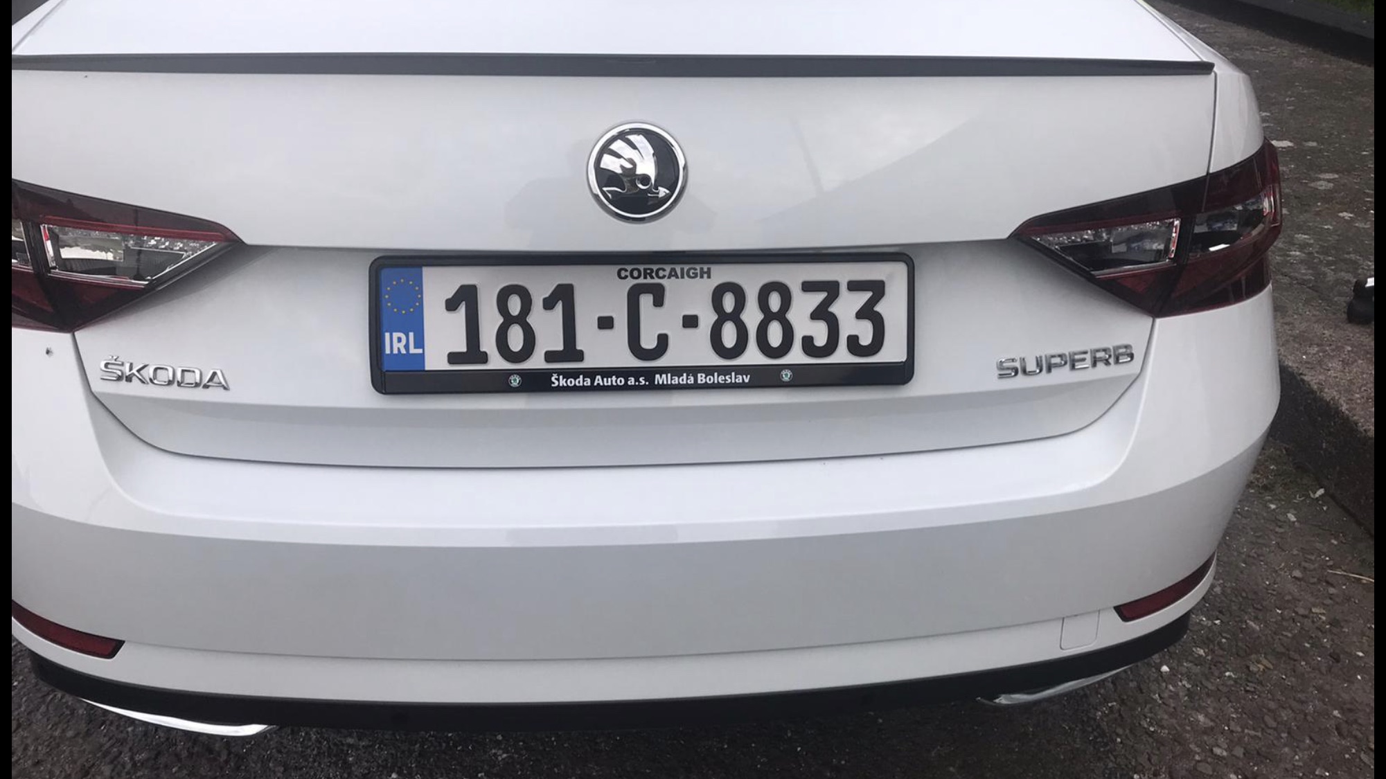

On 11/02/2021 at 22:37, MICKSVRS said:
Before and after pics.
bought from Superskoda.
front badge and back badge both fit just fine.
Where did you get the bumper protector from??

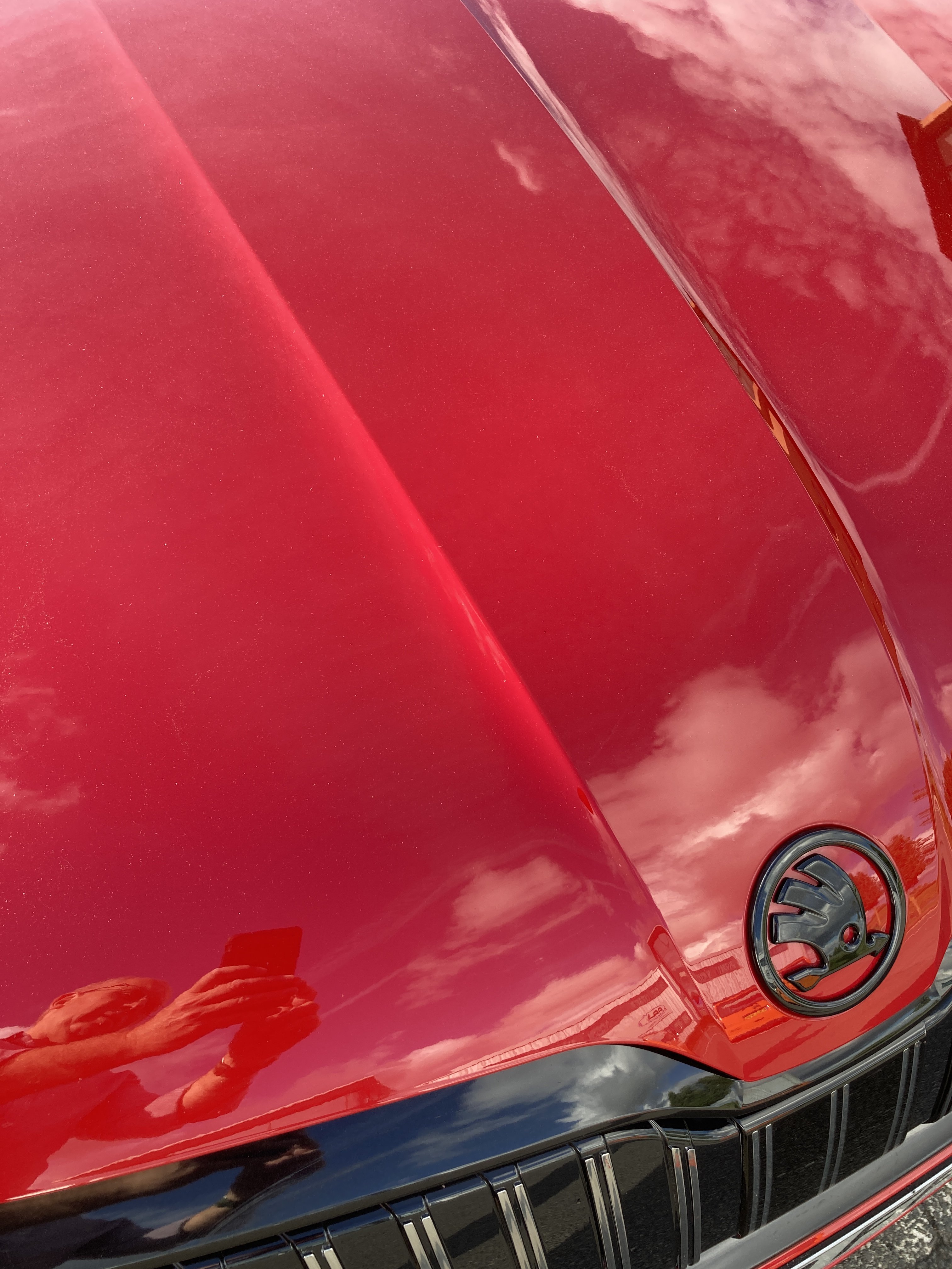

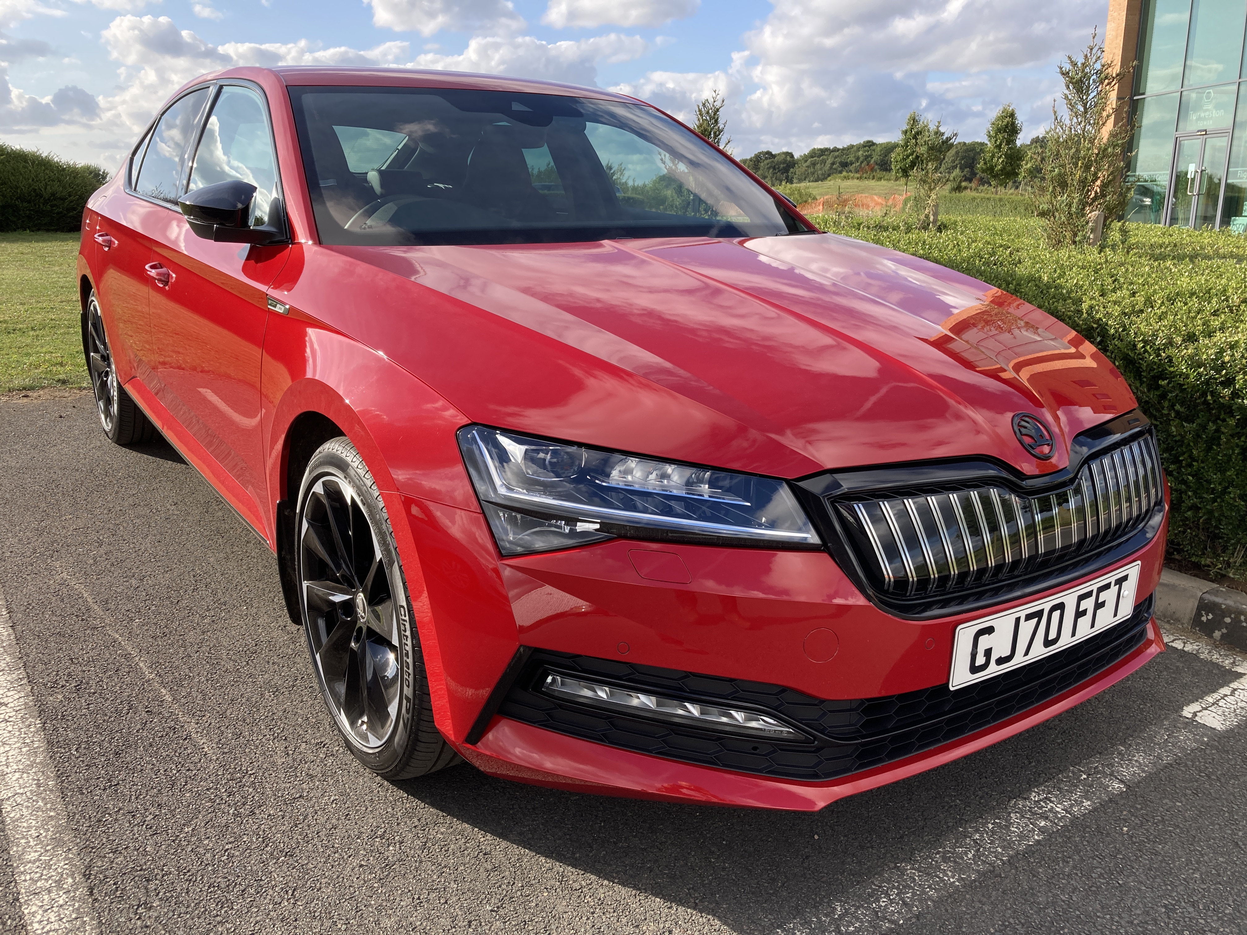

Front and rear Velvet Red colour coordinated badges by SuperSkoda (Kopacek) fitted!
Removed the original badges with the dental floss method then some glue removing stuff and Magnum wooden sticks (reasonable excuse to buy and eat a couple of Magnums...). Good news is that the boot lid for the 2021 Superb III with the S K O D A badging and no recess for the badge has exactly the same curvature as the boot lid with the recess - so the standard boot lid badge fits. I reduced the size of the locating pins as there is no where for them to locate (!) but other than that, no problem.
