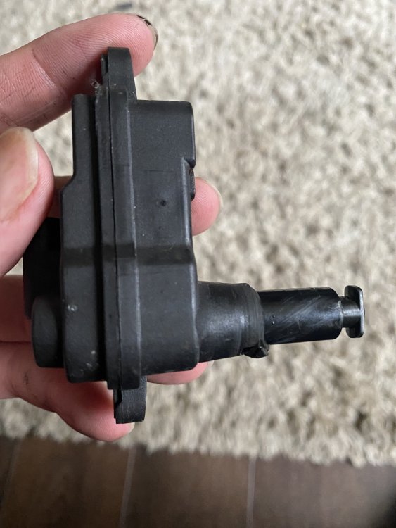

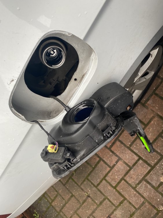

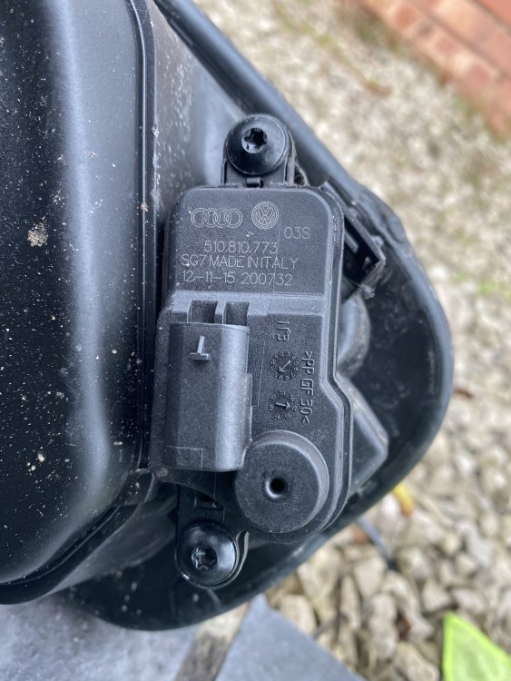

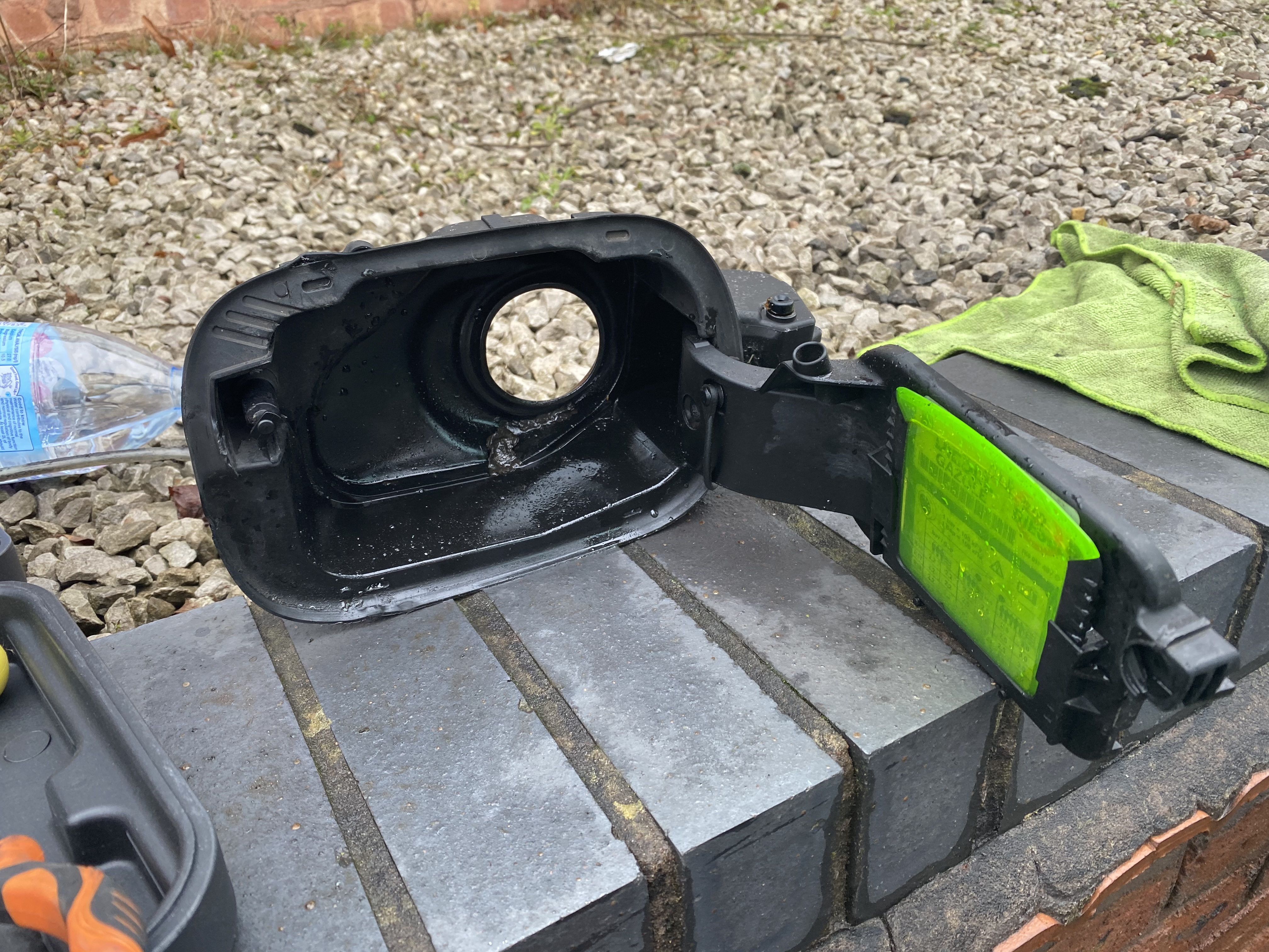

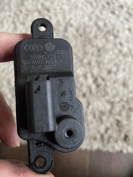

So it appears on our mk3, you have to prise the fuel bracket with screwdrivers, where in the past it’s been a torx bolt. Anyway, after my actuated packed up, I had to figure this out, so in posting it here with the part number so the next guy don’t suffer like I did.
510 810 773 is the fuel flap actuator part number. It also matches an Audi A3.

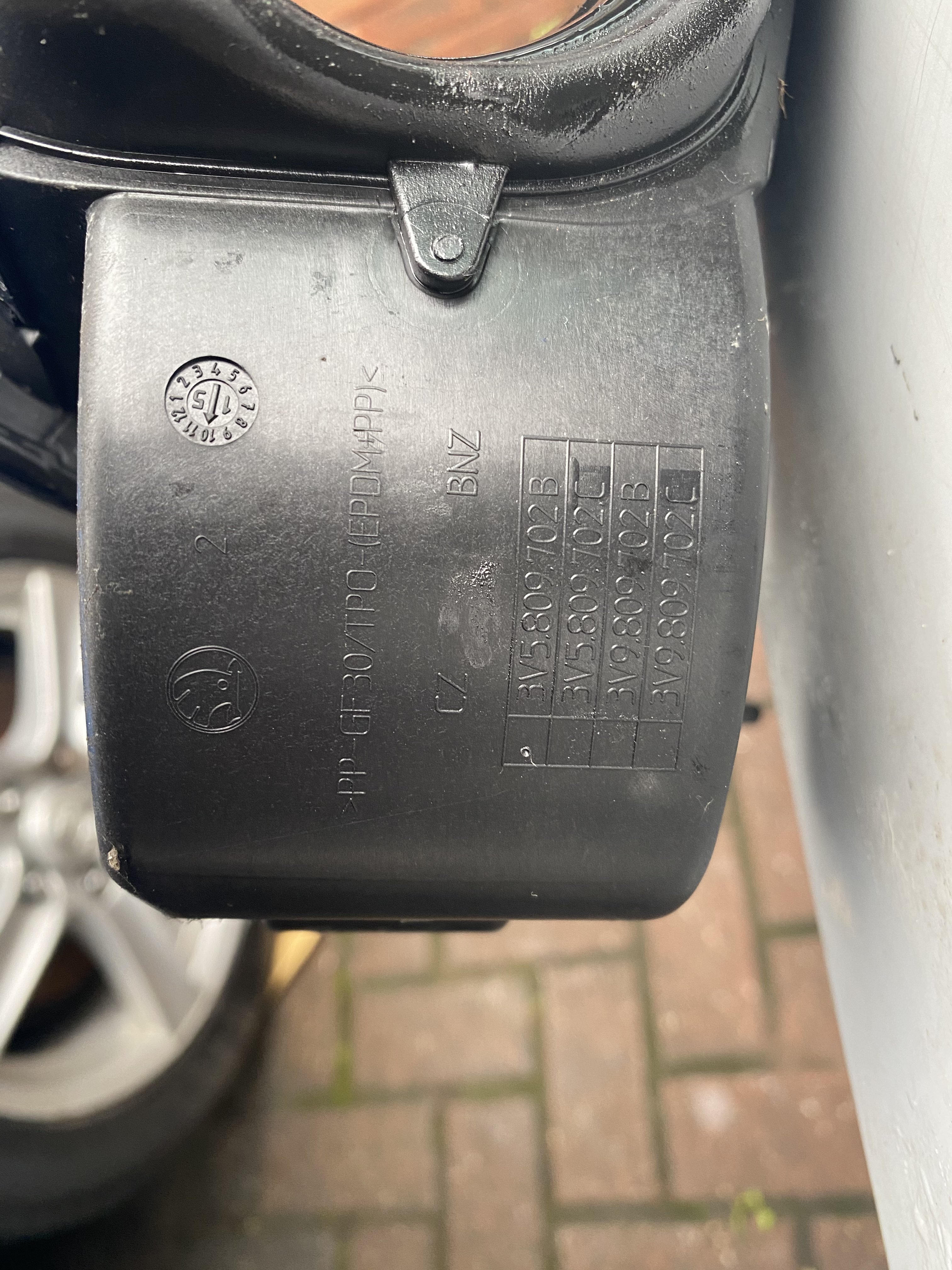

The fuel bracket part number is viewable too if anyone needs one.
