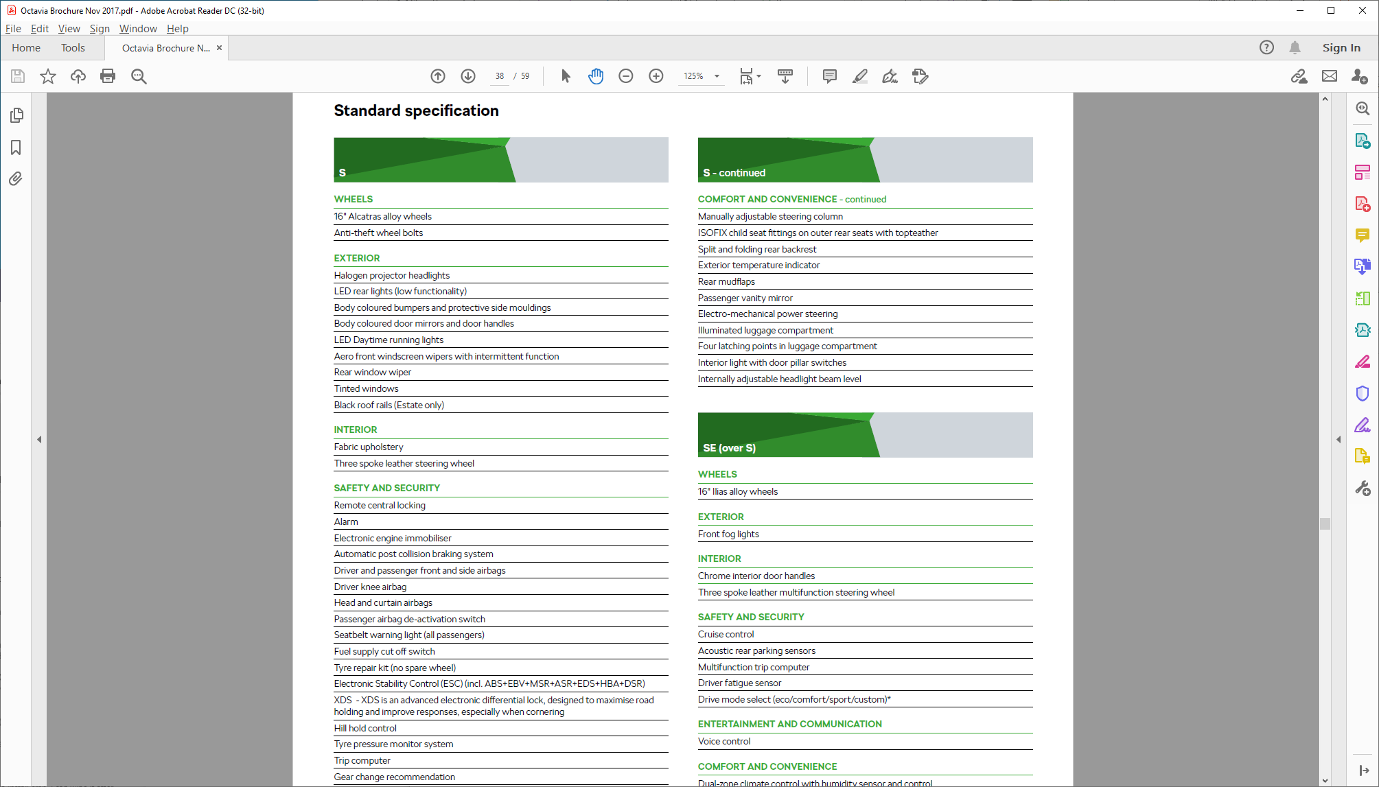

37 minutes ago, nickcoll said:
I have never seen it said that anywhere it was standard on all Mk 3 models.
It's in the Nov 2017 brochure where the S was the base model:
And the Nov 2019 brochure where the SE Drive was the base model:
