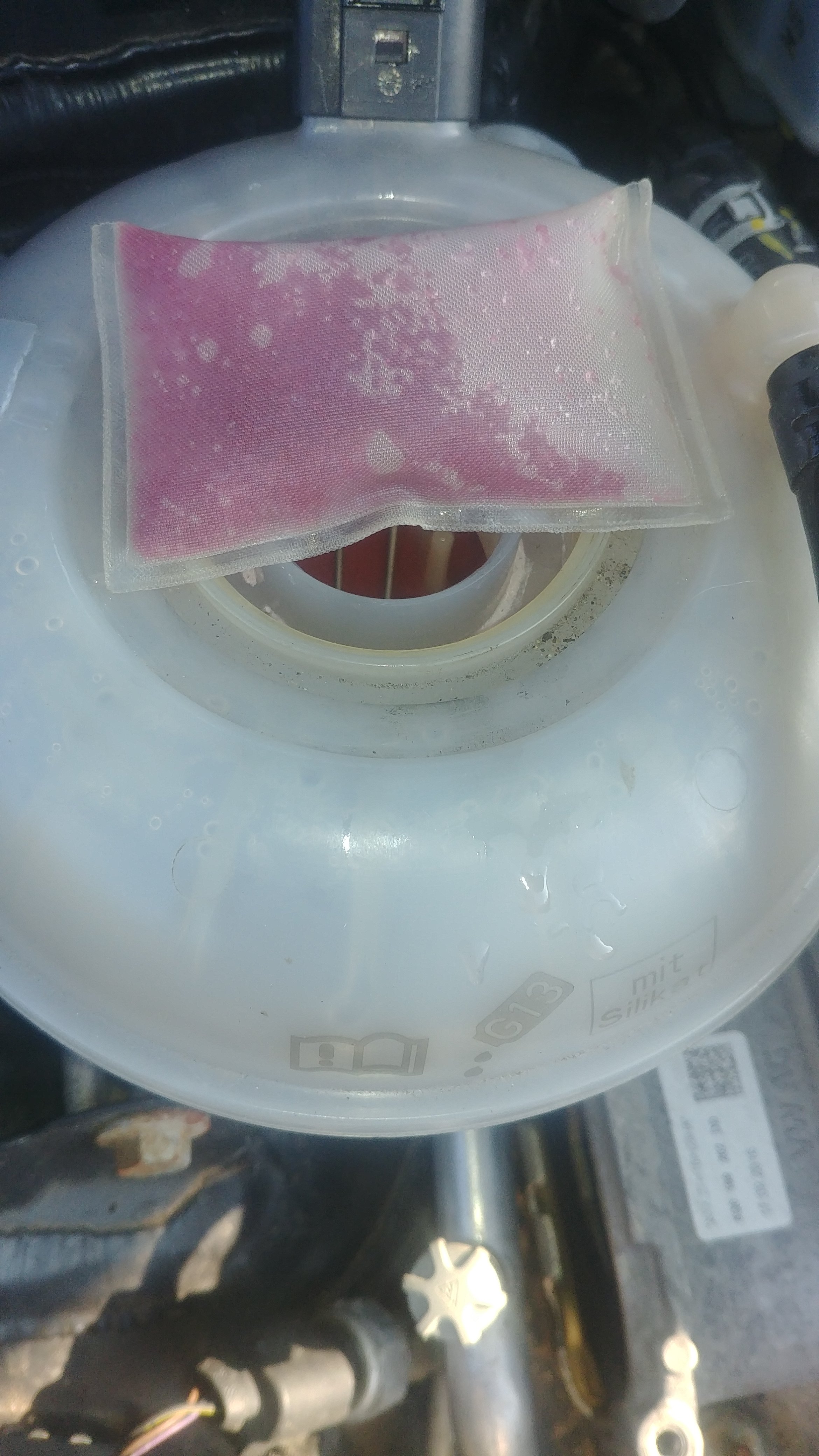

Found an interesting read in the Octavia forum:
made me change the reservoir in my Superb 2.0 diesel.
Part nr: 5Q0121407M is a perfect fit and does not contain the bag.

I’ve one in my TSI unit as well. Disastrous thing if it leaks. It won’t be staying in mine much longer. If you remove the bottle, most of them can be coaxed out intact.

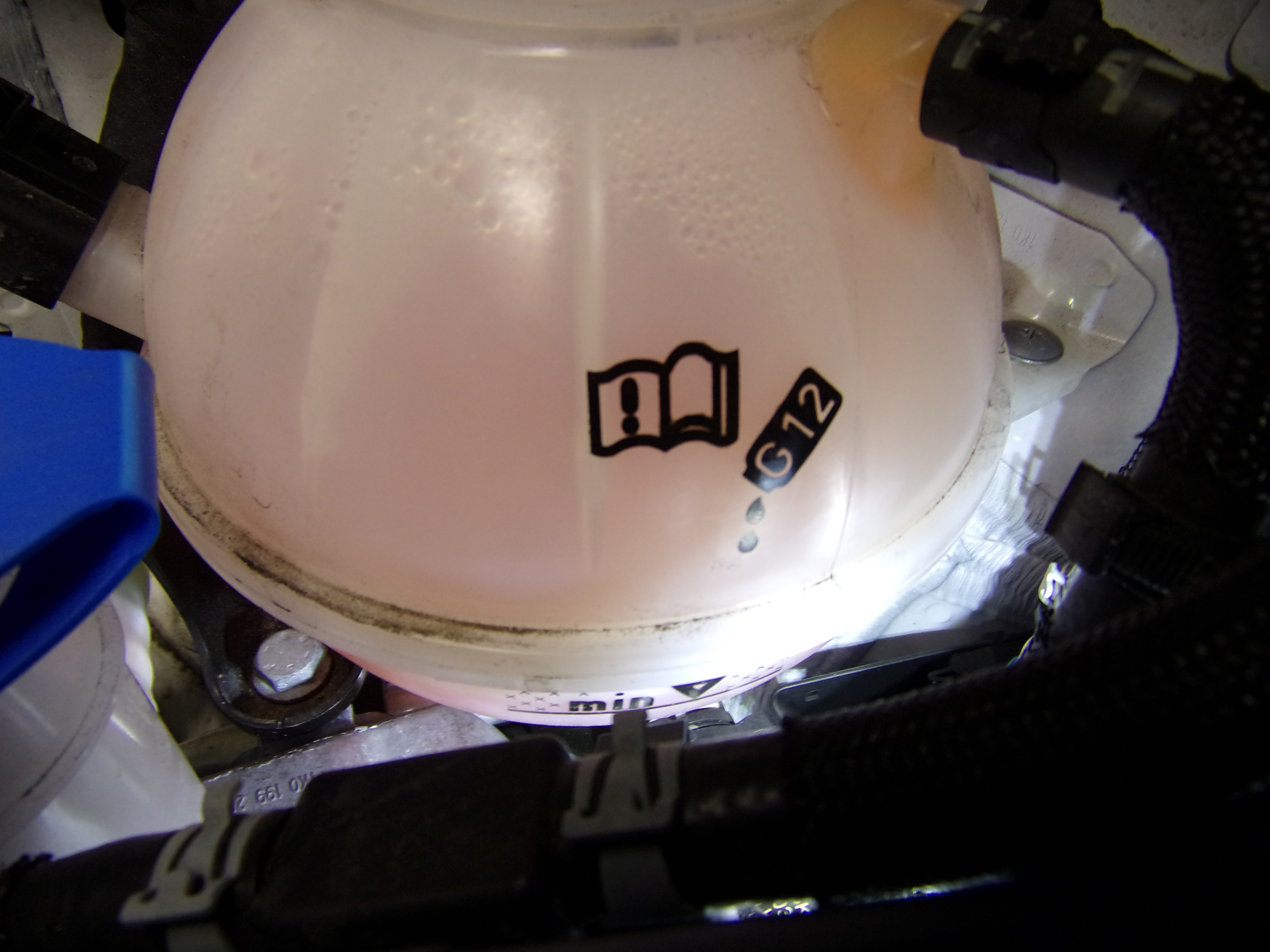

Skoda tried to make the coolant 'for life'.  If you replace the coolant every 5 years when you do the timing belt you don't need to worry.  G13 has since been replaced with G12evo and there's no G13 marking on the new expansion tank.

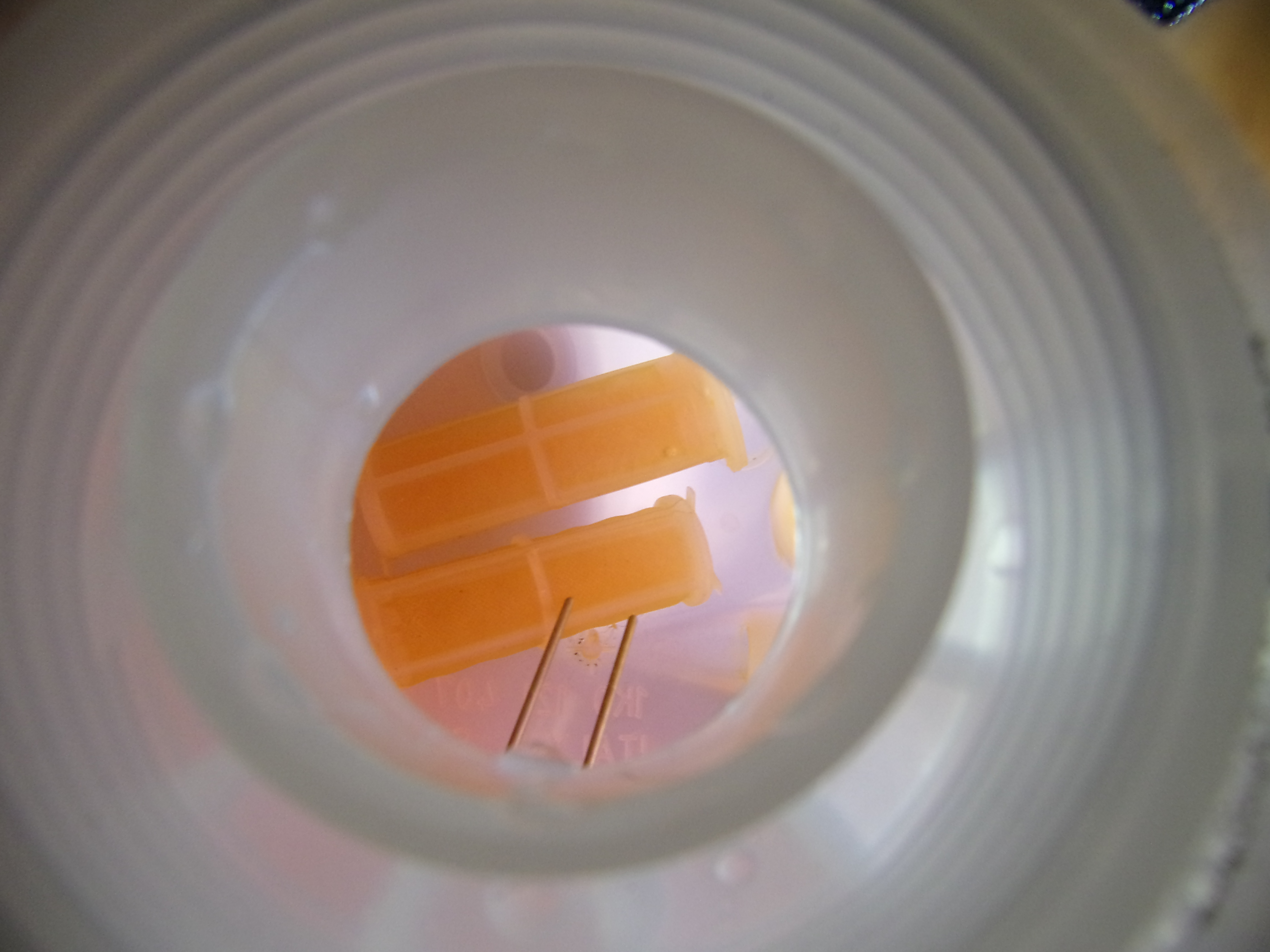

In the double walled version there is a holder for the bag in between the walls. But my bag freed itself from the holder and ended up near the overflow connection.
Replaced 5Q0 121 407 G (5 years 95k Km)
to 5Q0 121 407 M
for minimize risk of silicate bag damage
inside picture of 5Q0 121 407 T, no bag version, similar as M

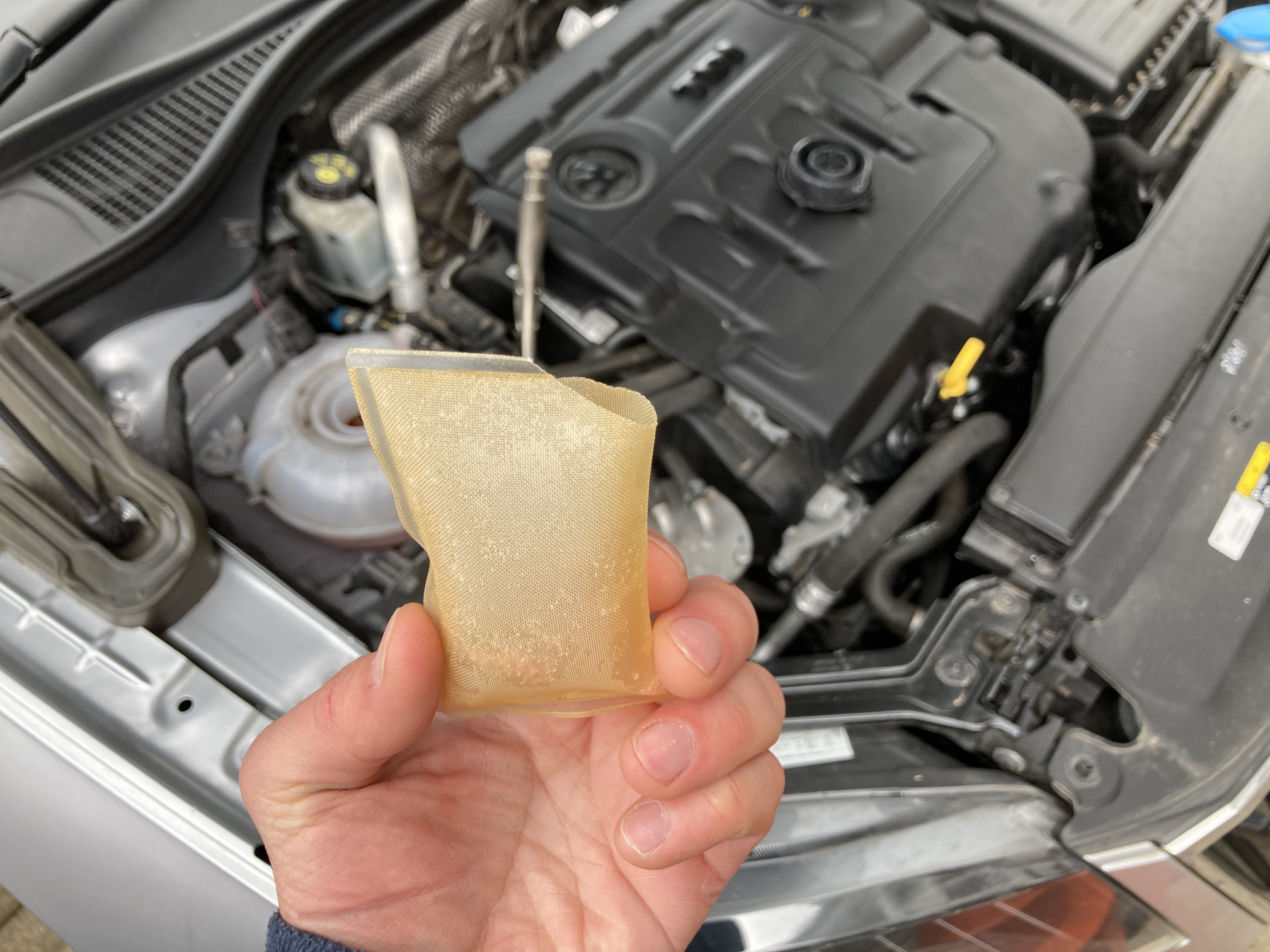

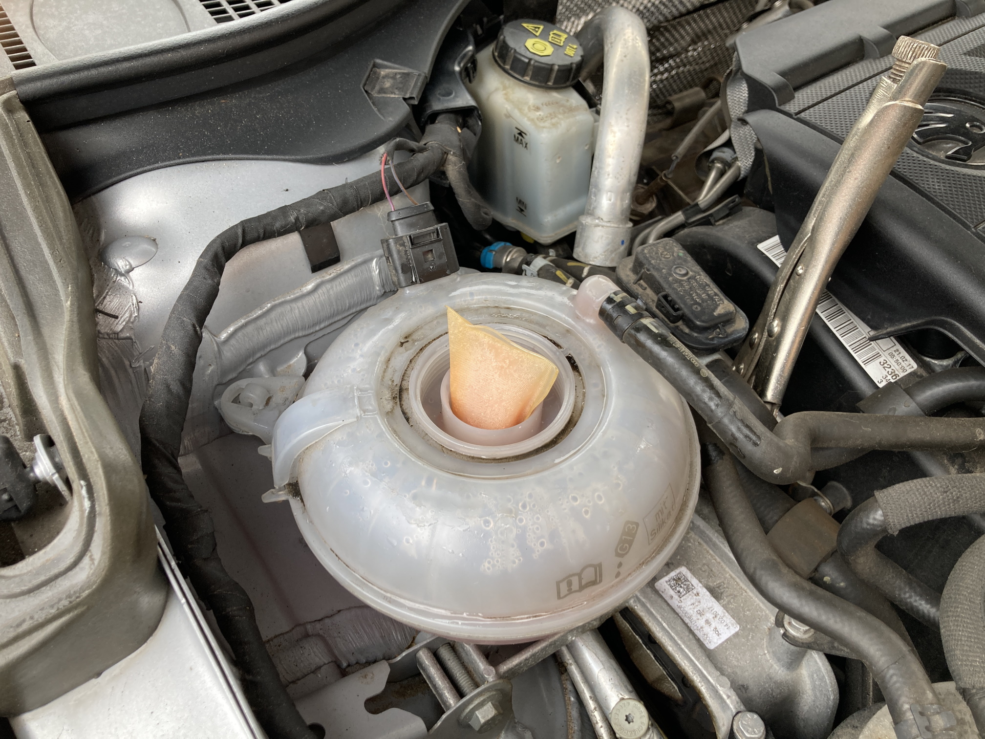

My car has the bag but having felt it with my fingers it appears adhered at one end to the inside of the tank.  Are they easy to remove if they’re adhered? Presumably I need to take the tank off in case the bag splits when I remove it so I don’t contaminate the coolant?
I removed mine quite easily, it is held to the side my two plastic pillars. I bent the one to the front over with a screwdriver and wriggled the bag past it. I could then pull it out carefully with some needle nose pliers.

In the end I had to cut open the bag and suck out the content as the silica was preventing the bottom of the bag compressing to pass the reservoir opening.  I didn't want to rupture it by pulling too hard.  I also found having an extra pair of hands very useful to steady the bag whilst I removed the silica content.
Photographs below.
