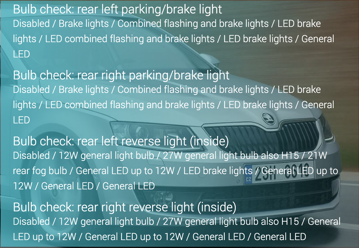

I was looking at the Carista customization software capability, it seems that there are settings for LED vs other bulbs.
Quote
Bulb check: rear left reverse light (inside)
Disabled / 12W general light bulb / 27W general light bulb also H15 / 21W rear fog bulb / General LED up to 12W / LED brake lights / General LED up to 12W / General LED / General LED
Bulb check: rear right reverse light (inside)
Disabled / 12W general light bulb / 27W general light bulb also H15 / General LED up to 12W / General LED up to 12W / General LED / General LED
Does anyone know what the word inside in bracket refer to?
Also, does anyone know if it would be possible to see what is the current setting for this reverse bulb using Carista or VCDS?

It's trivial to check the settings with VCDS. No idea about Carista...
At least on my FL vRS, the reverse lamp check are controlled by:
- channel ENG116964-ENG116404-Leuchte28RFL LC11-Lasttyp 28
- channel ENG116965-ENG116423-Leuchte29RFL RA64-Lasttyp 29

Thanks for your help. I will try to see if I can get a VCDS to check out the settings. Meanwhile, I will erase the errors to see if anything would change.
If you look at a rear light cluster, there are bulbs that are on the outside of the cluster closest to the outside of the car and bulbs that are on the inside (closest to the boot).  Reverse light is closest to the inside.
