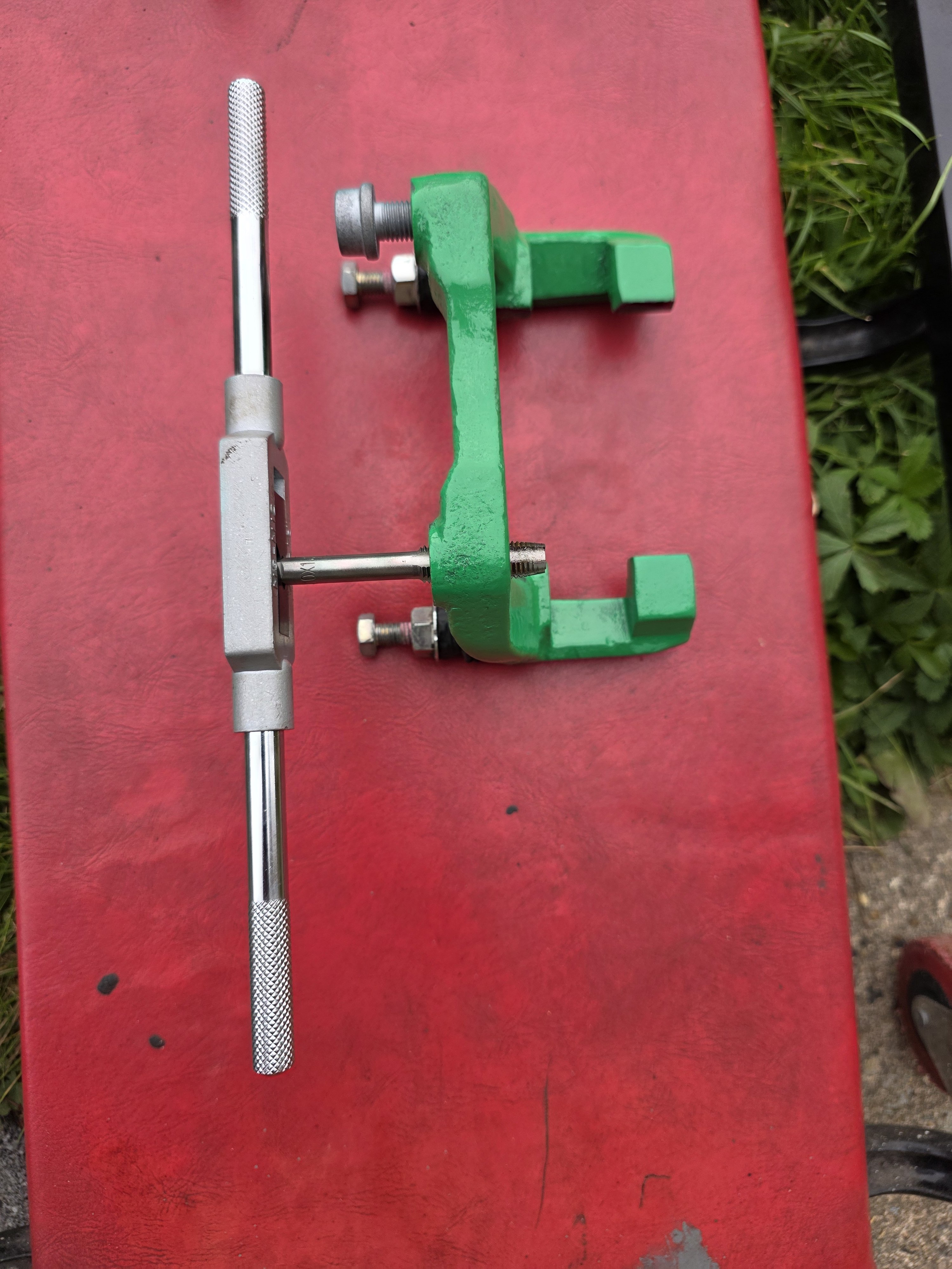

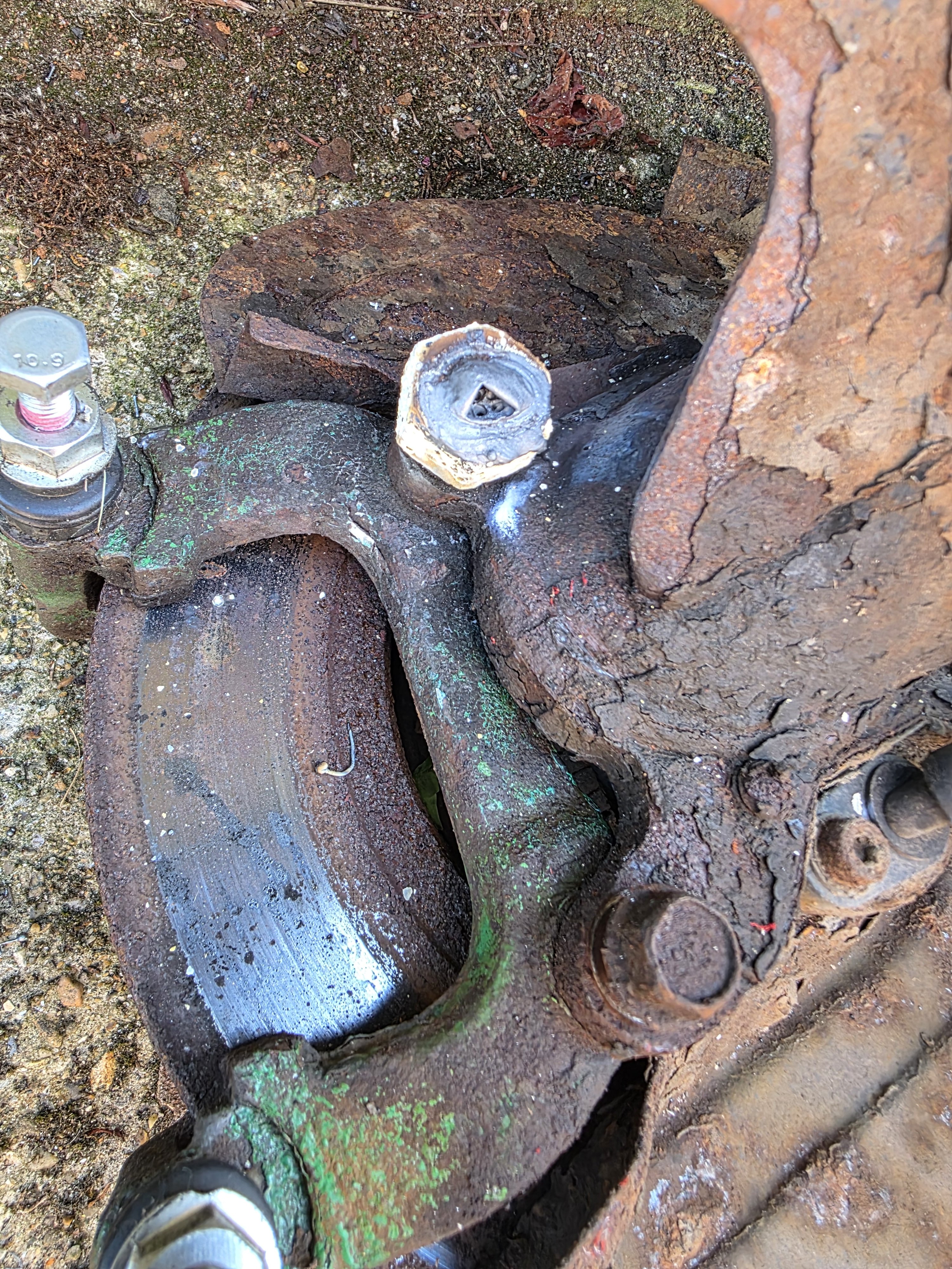

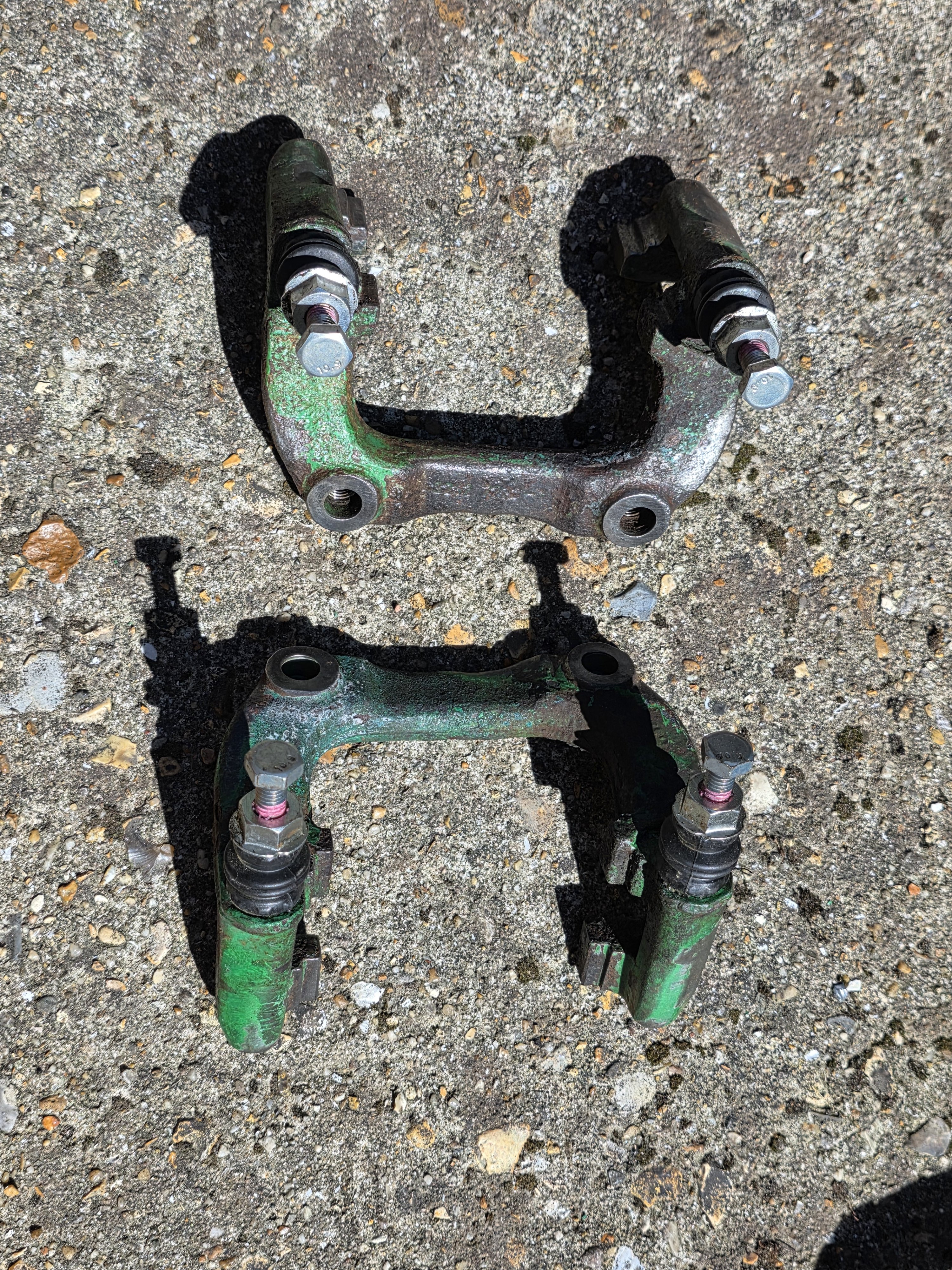

Typical, the last bolt on the caliper carrier wouldn't budget and rounded the hex fitting. Ended up welding a nut on to it and eventually got it out. One of the other threads needed retapping

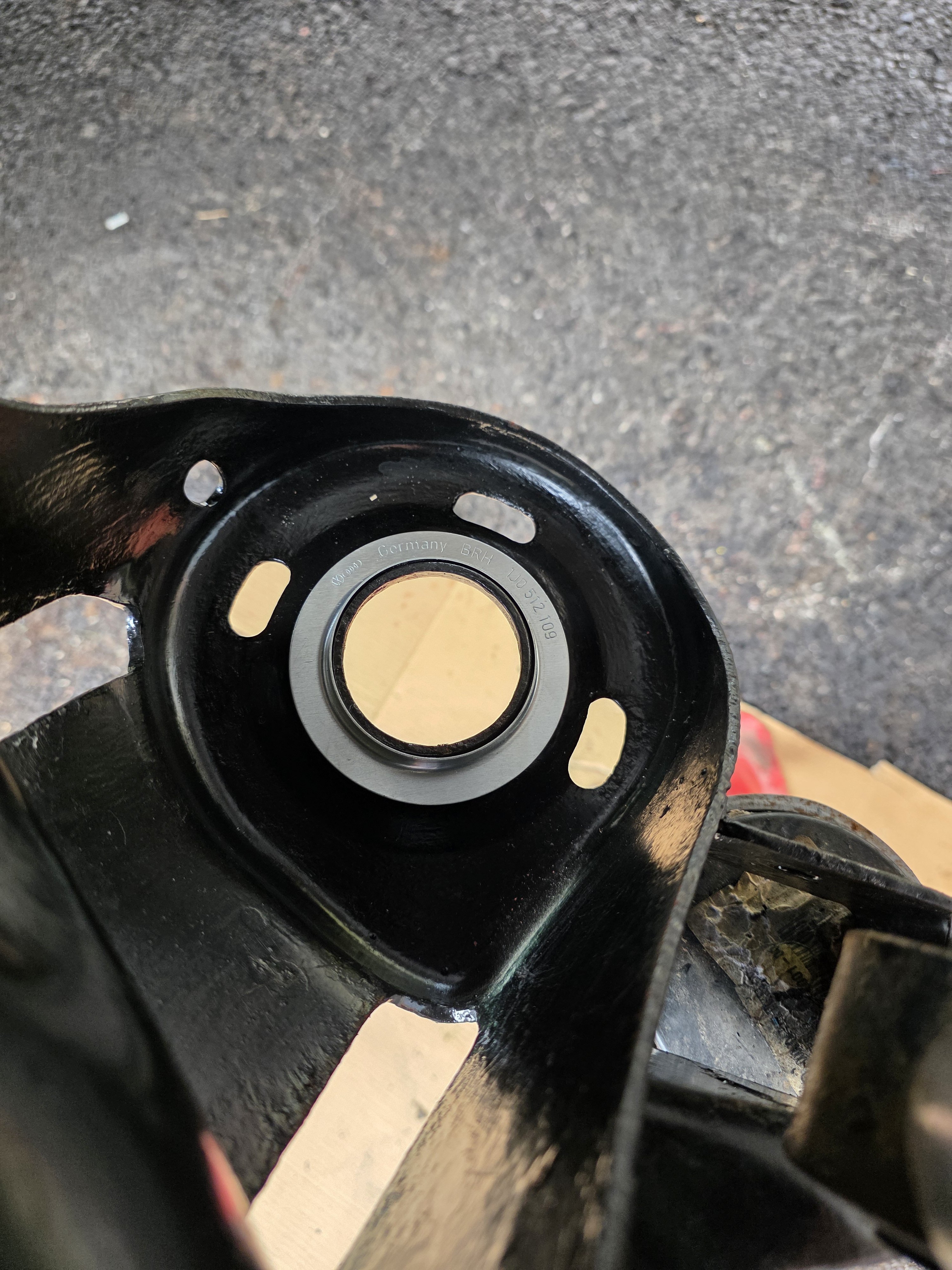

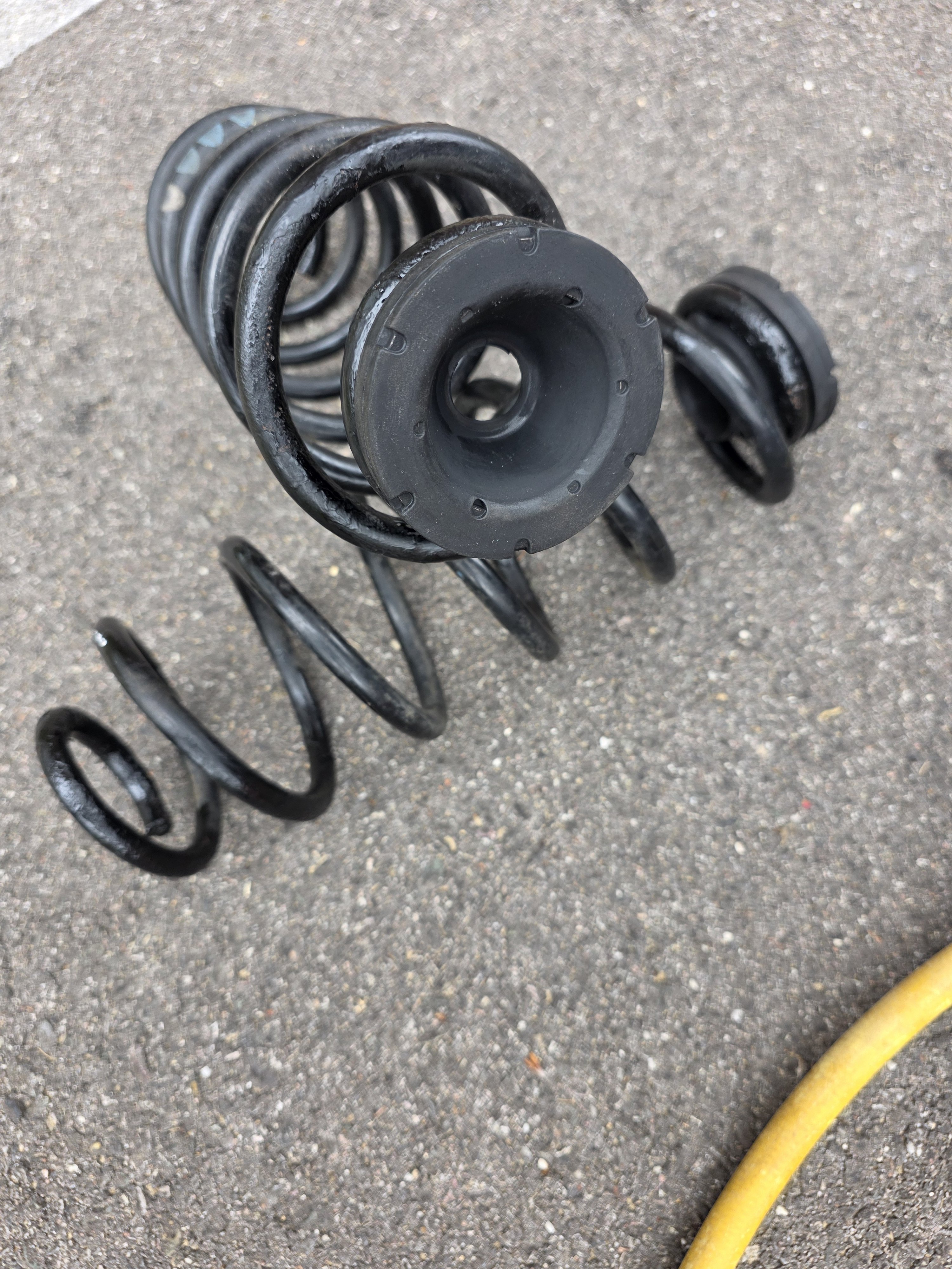

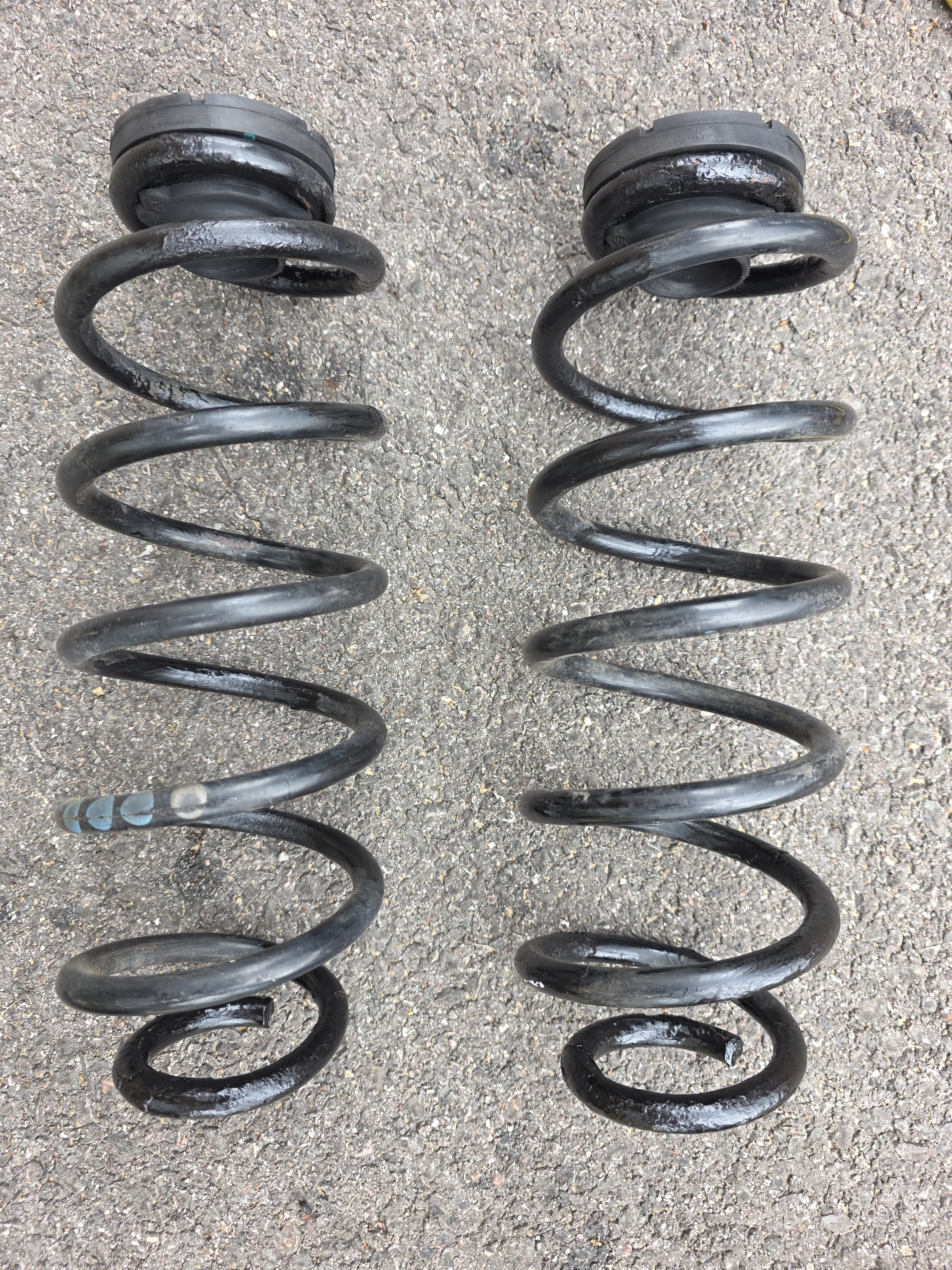

The rear springs look like they had a bit of life left in them. Just cleaned then up, a lick if paint and new top bushes.
Not forgetting the ali washer for the spring to sit on

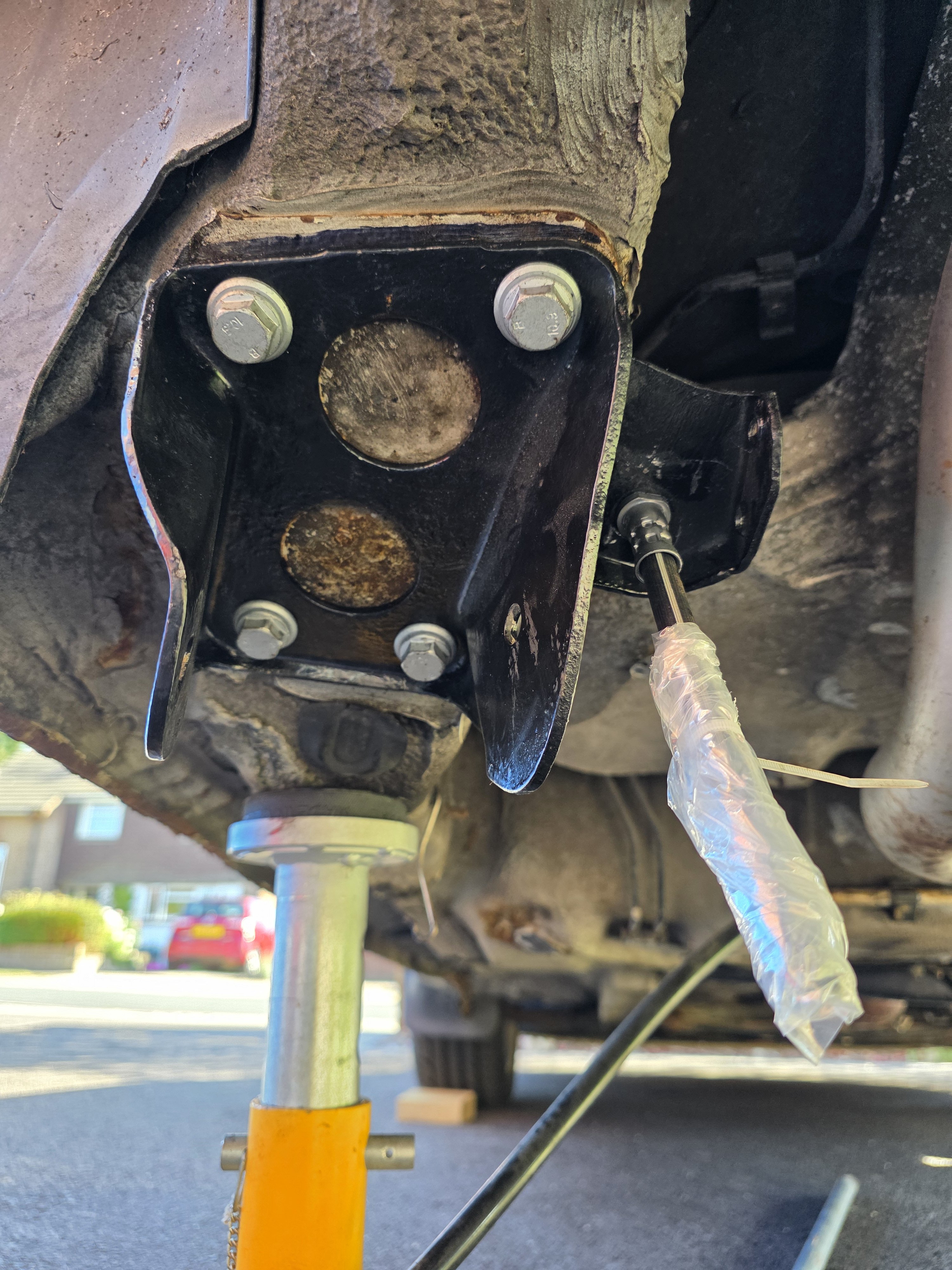

Marked up the mounting brackets so I could get them back in the same position. Just light surface rust / dirt. Picture makes it look worse. Wad very solid

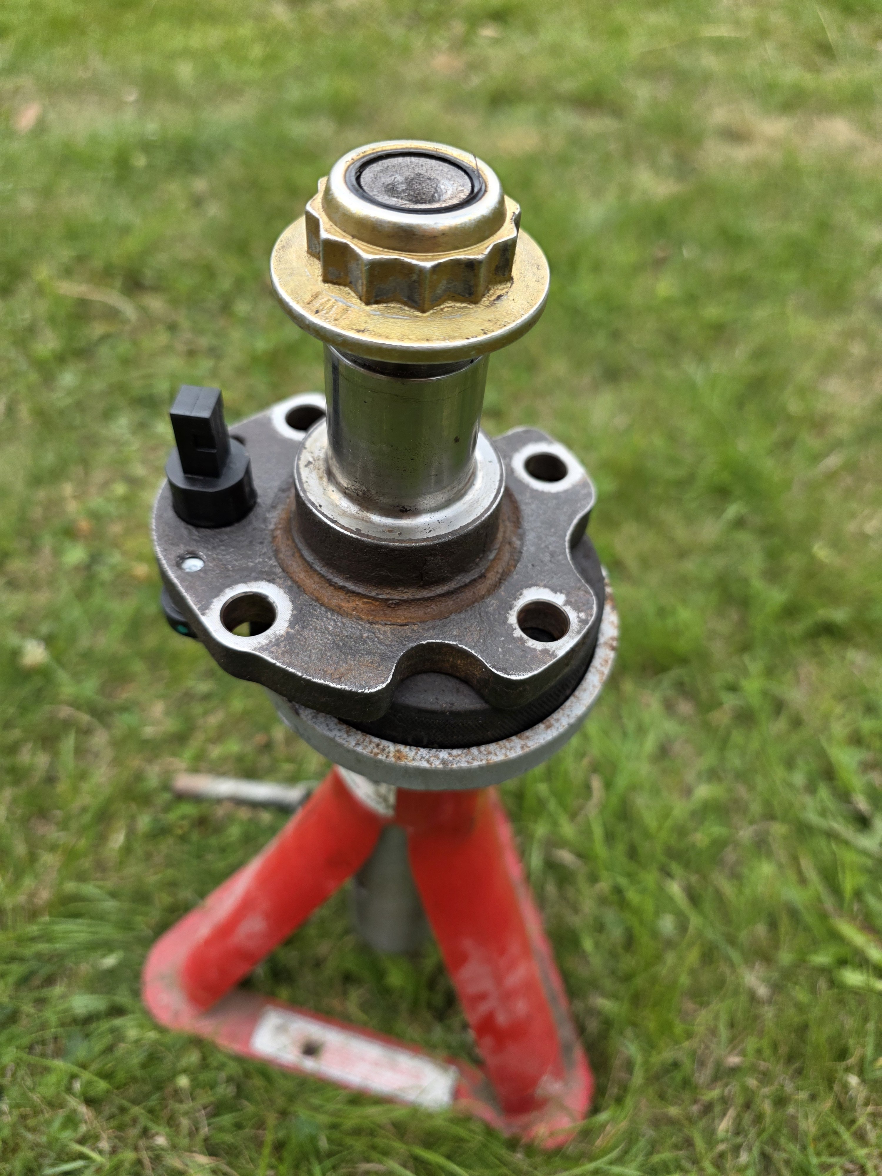

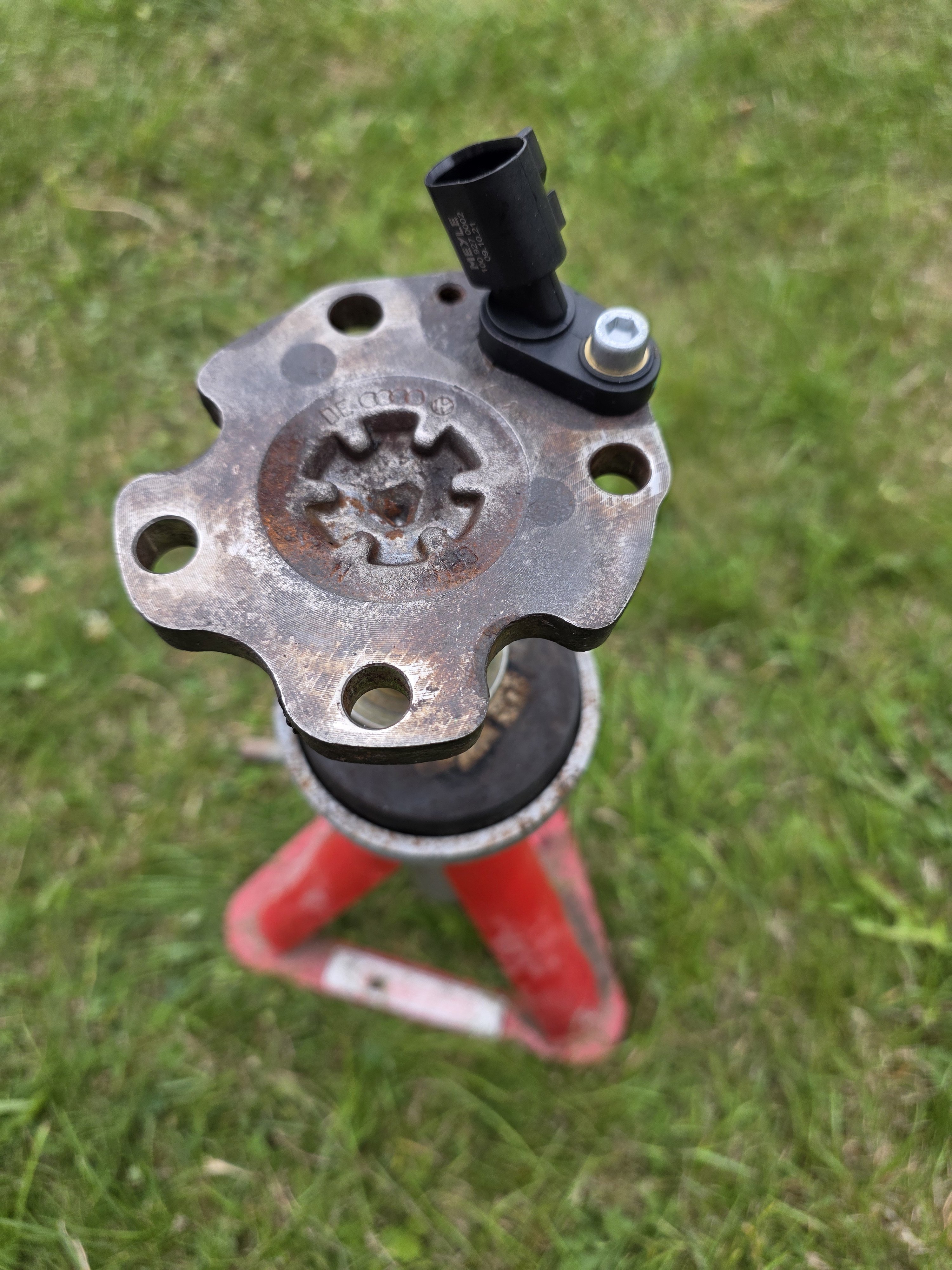

For some reason I assumed the new rear hubs came with stub axles, but they never. Luckily I hadn't binned the old axle, so I retrieved these, cleaned them up and fitted new sensors. Getting the old sensors out was a mission. In the end I had to burn the plastic casing and smash them out. This would gave been impossible to do on the car.

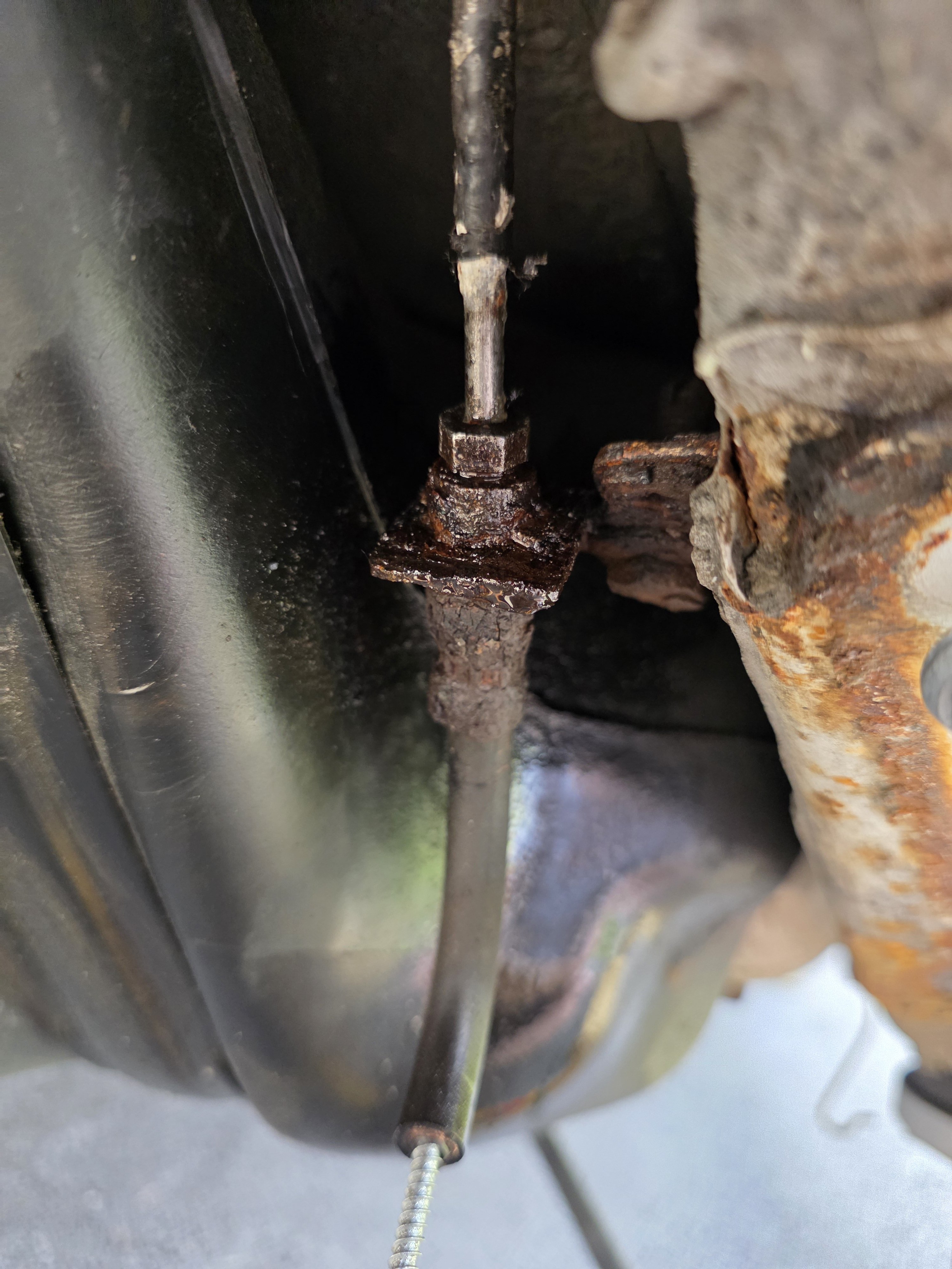

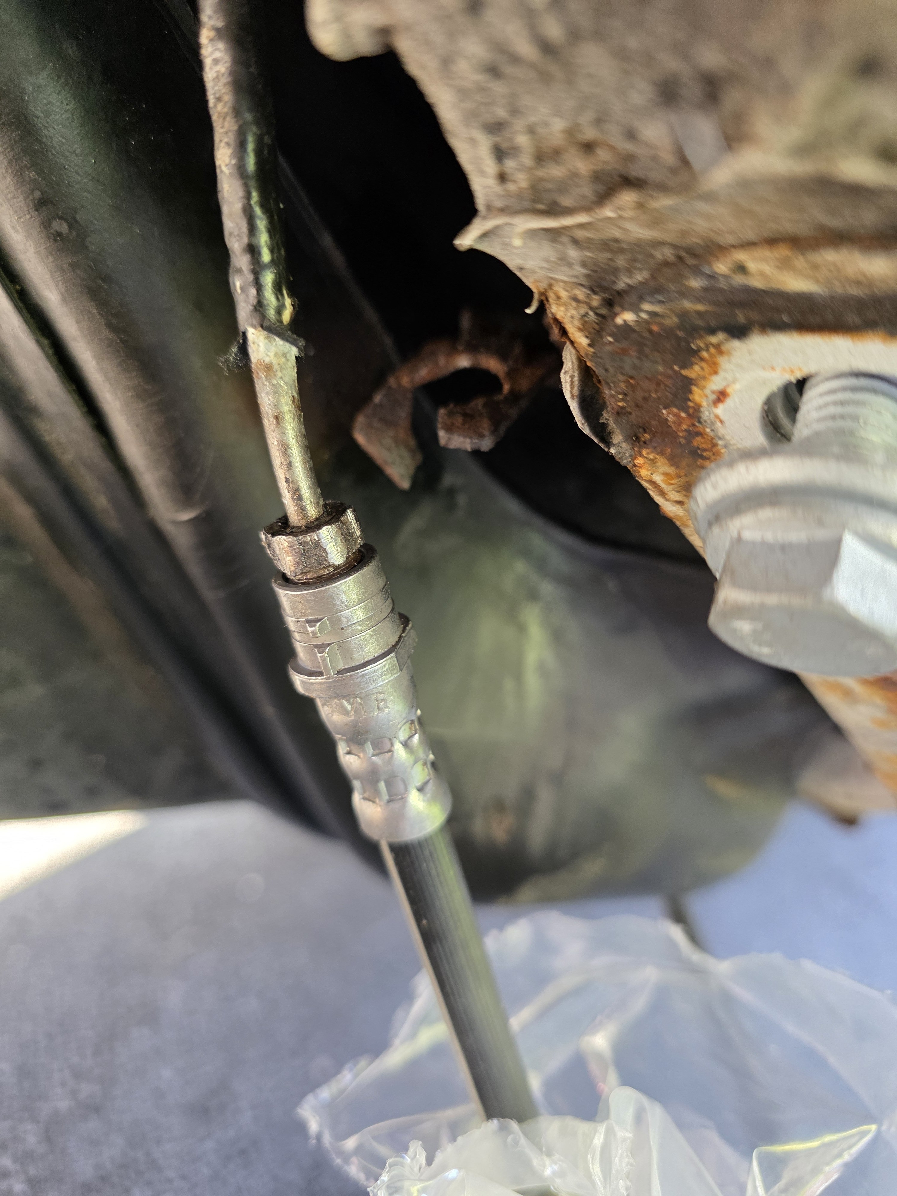

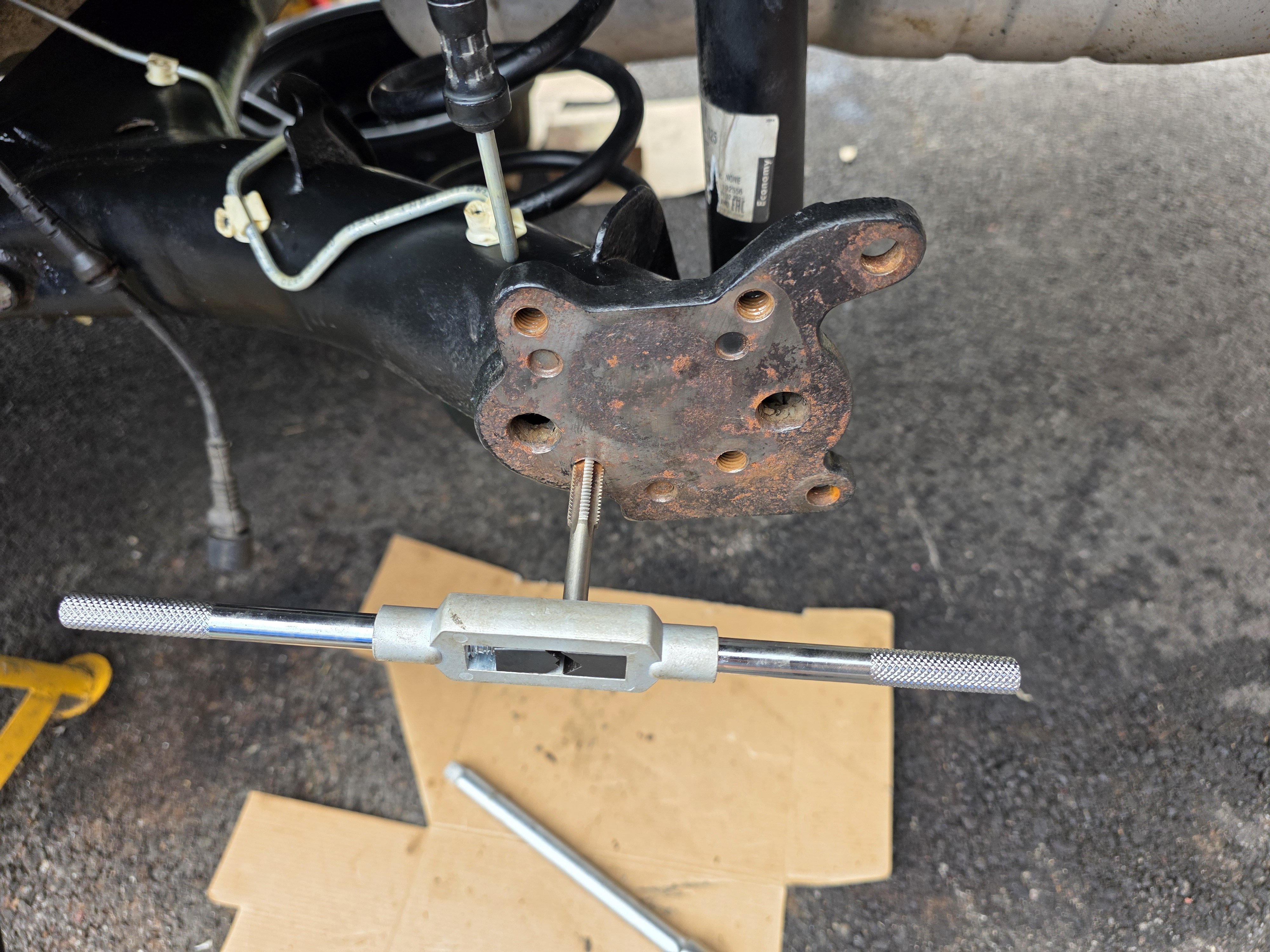

I couldn't undo this brake pipe nut. I tried heat but being right next to the fuel tank i had to stop. I did put a metal shield between, but it was far too risky. I ended up rounding the nut, so I cut the mounting bracket, gripped the nut and then could twist off tge old brake flexi hose. I really should have sectioned in a new bit if hard brake line, but it's all tucked behind the fuel tank, and I was well fed up by now. I think I may regret this later

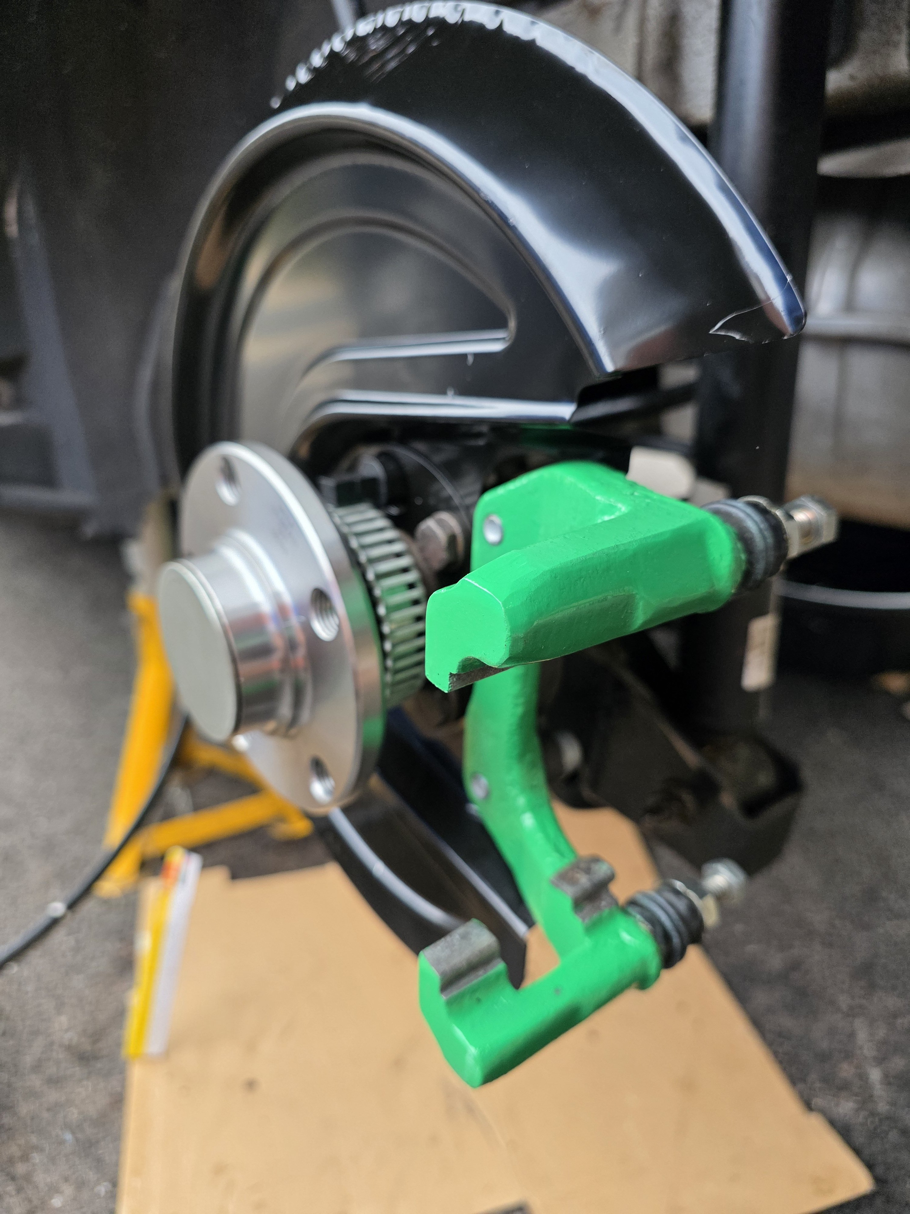

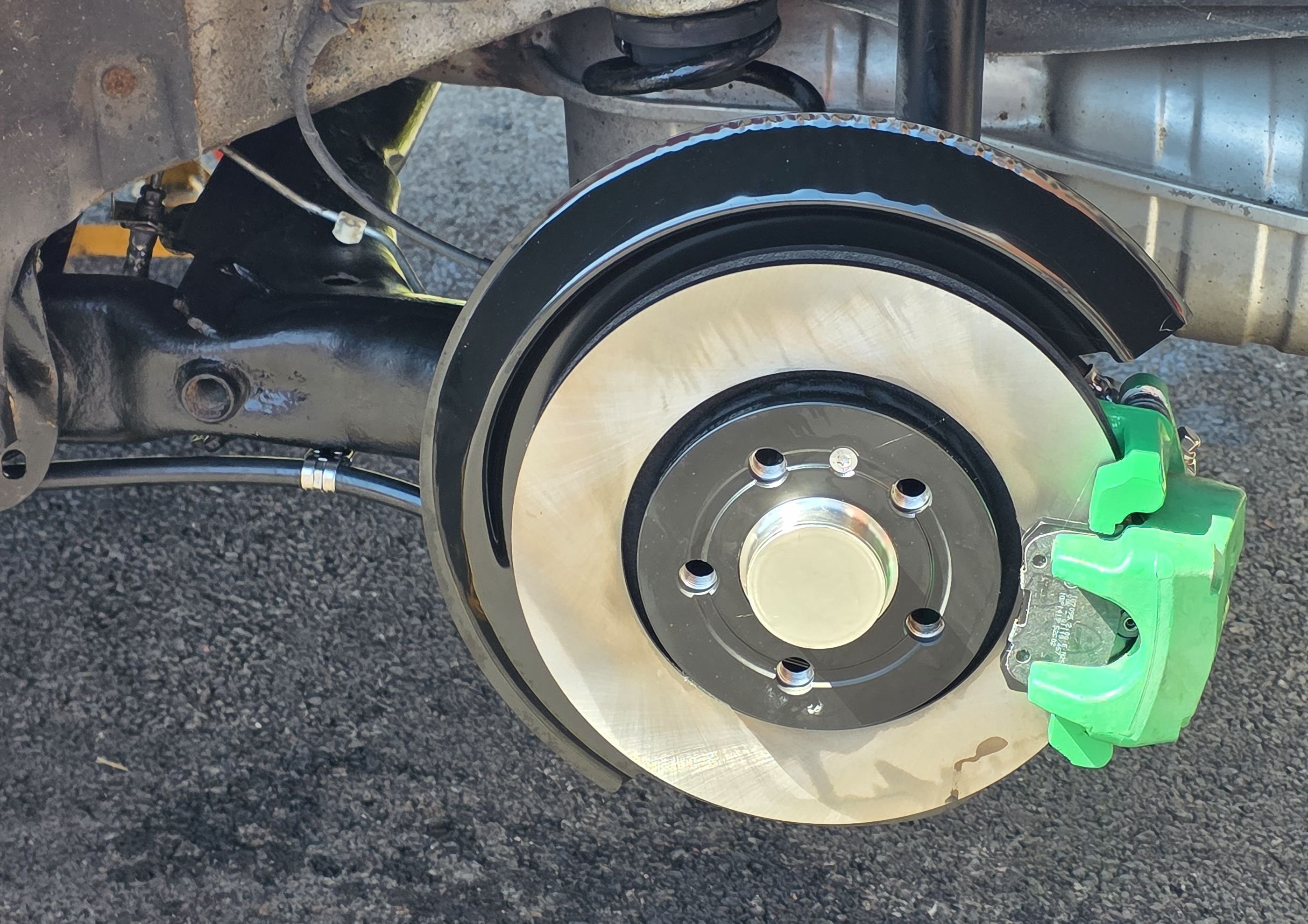

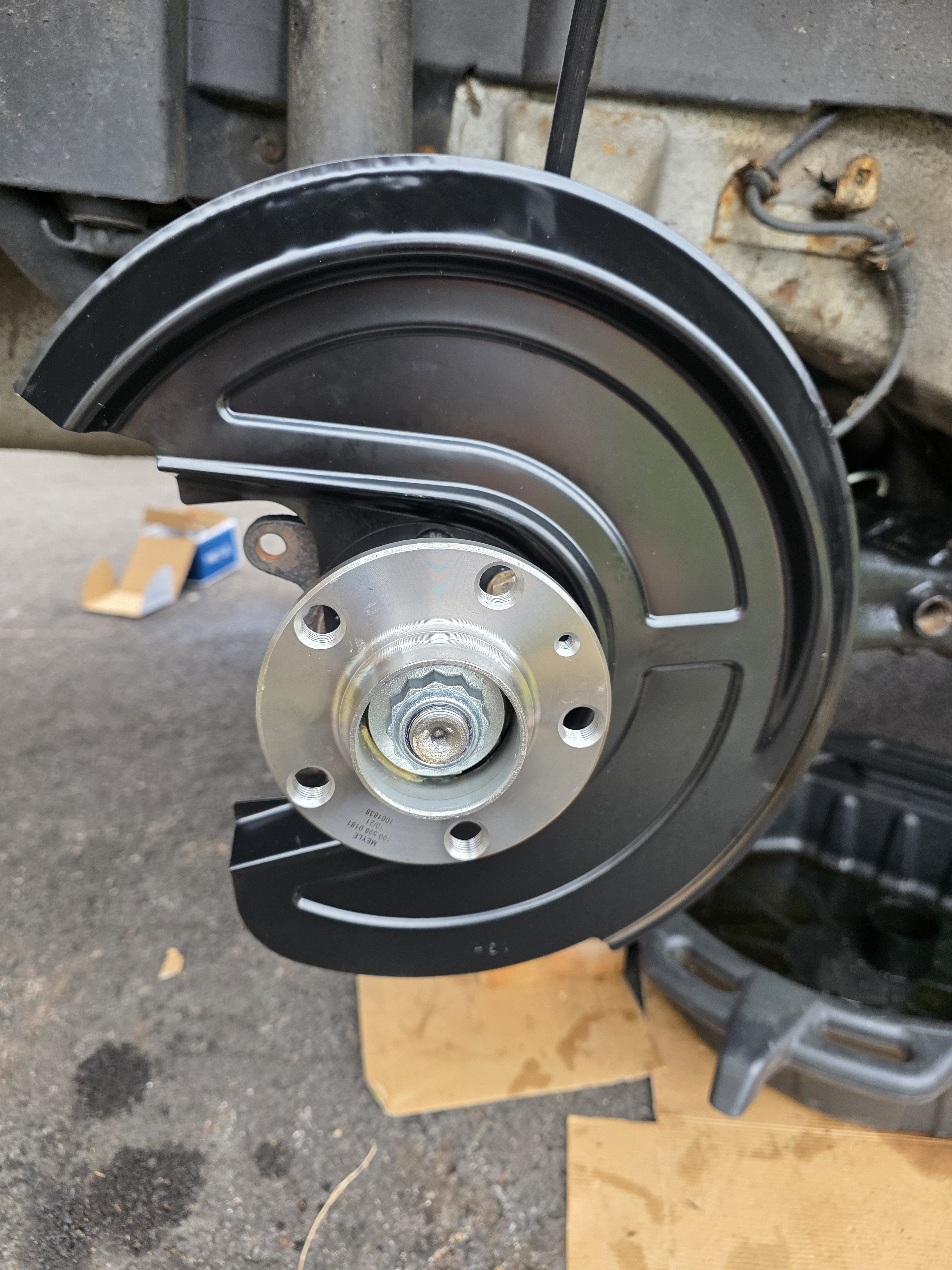

Tapped the stub acke threads and on with a new brake shield and hub.

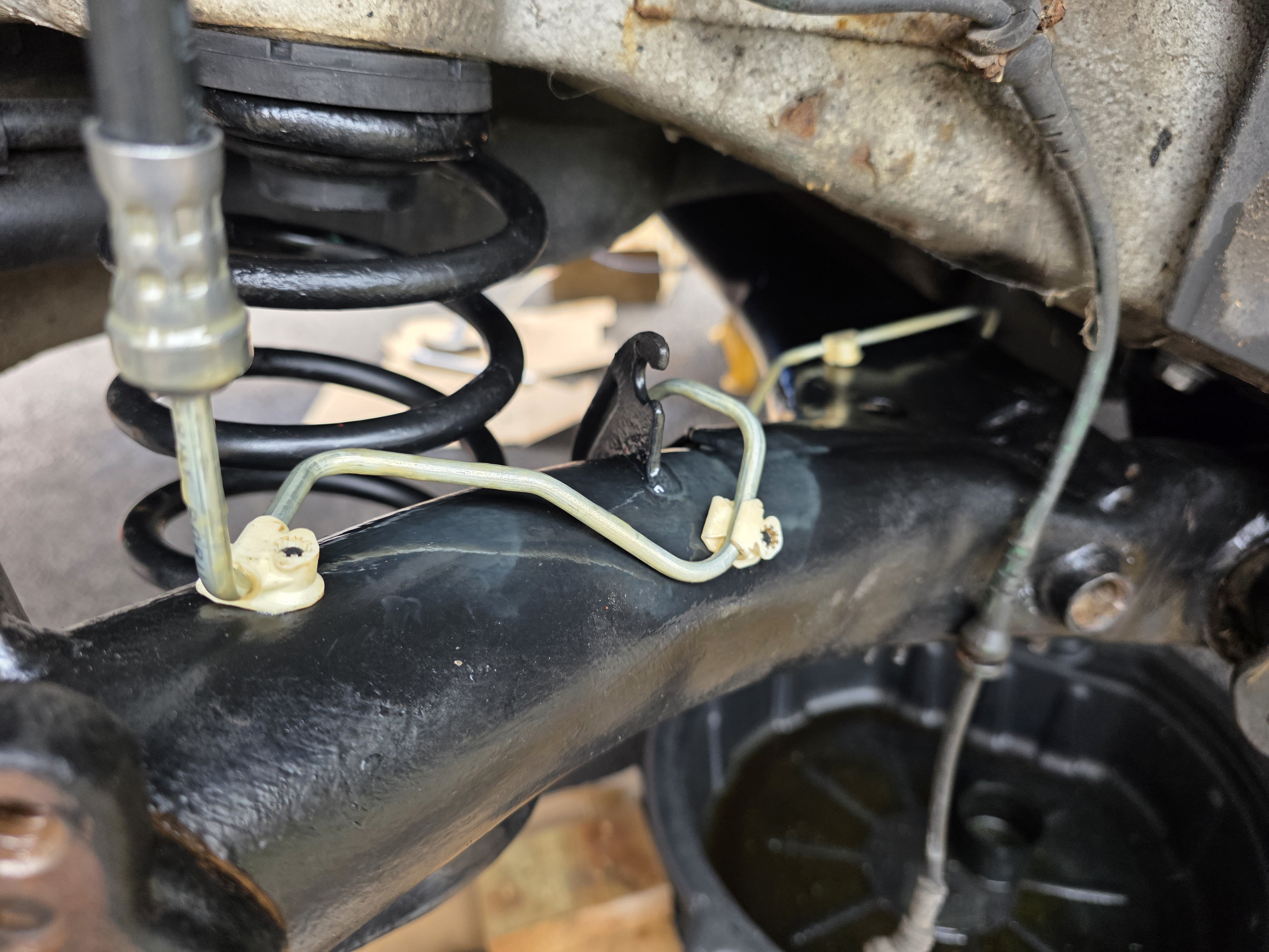

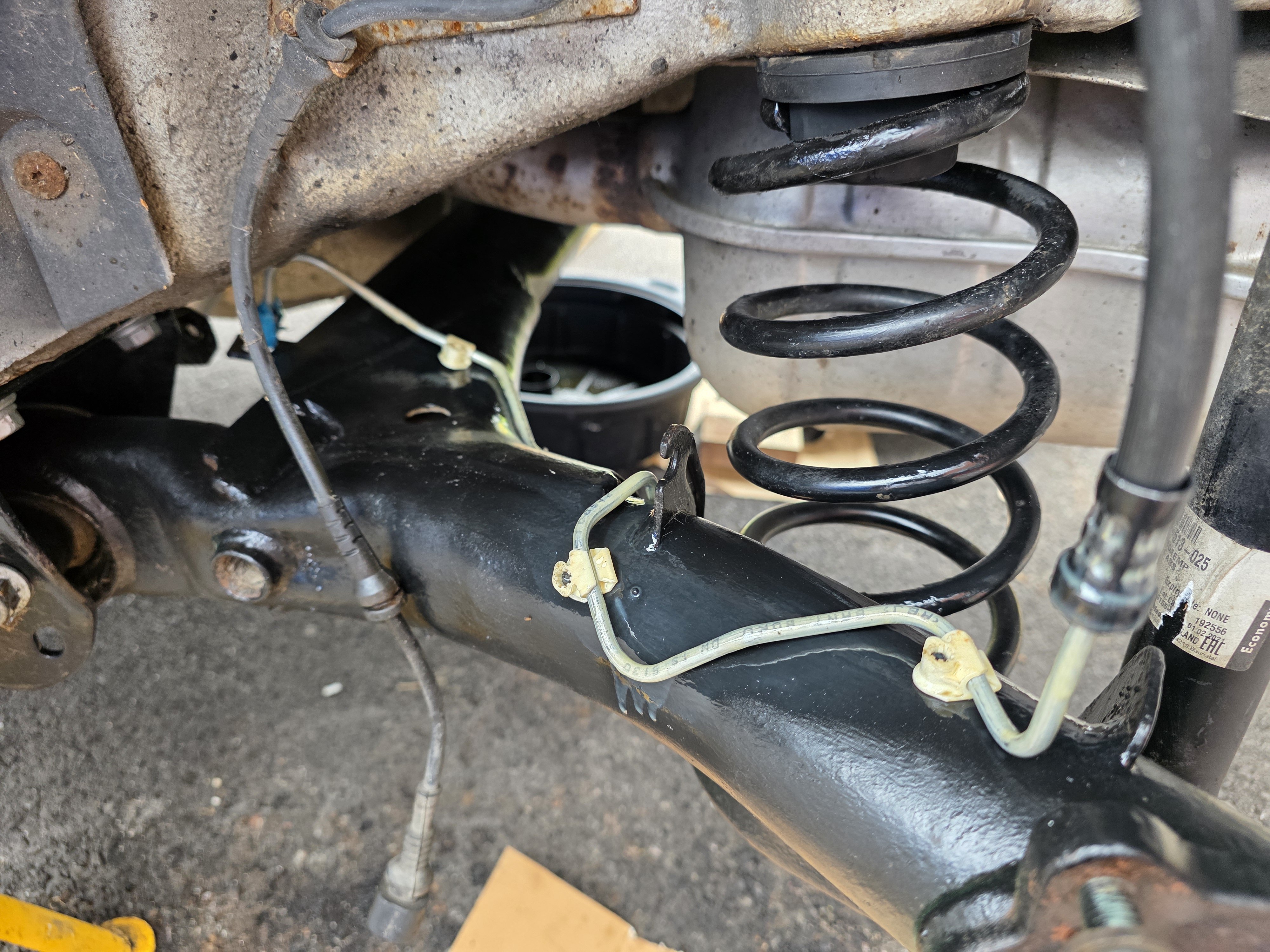

Fitted the brake lines that sit onto of the axle, using new clips. I gave them a coat of clear wax as they are notorious for rusting.
