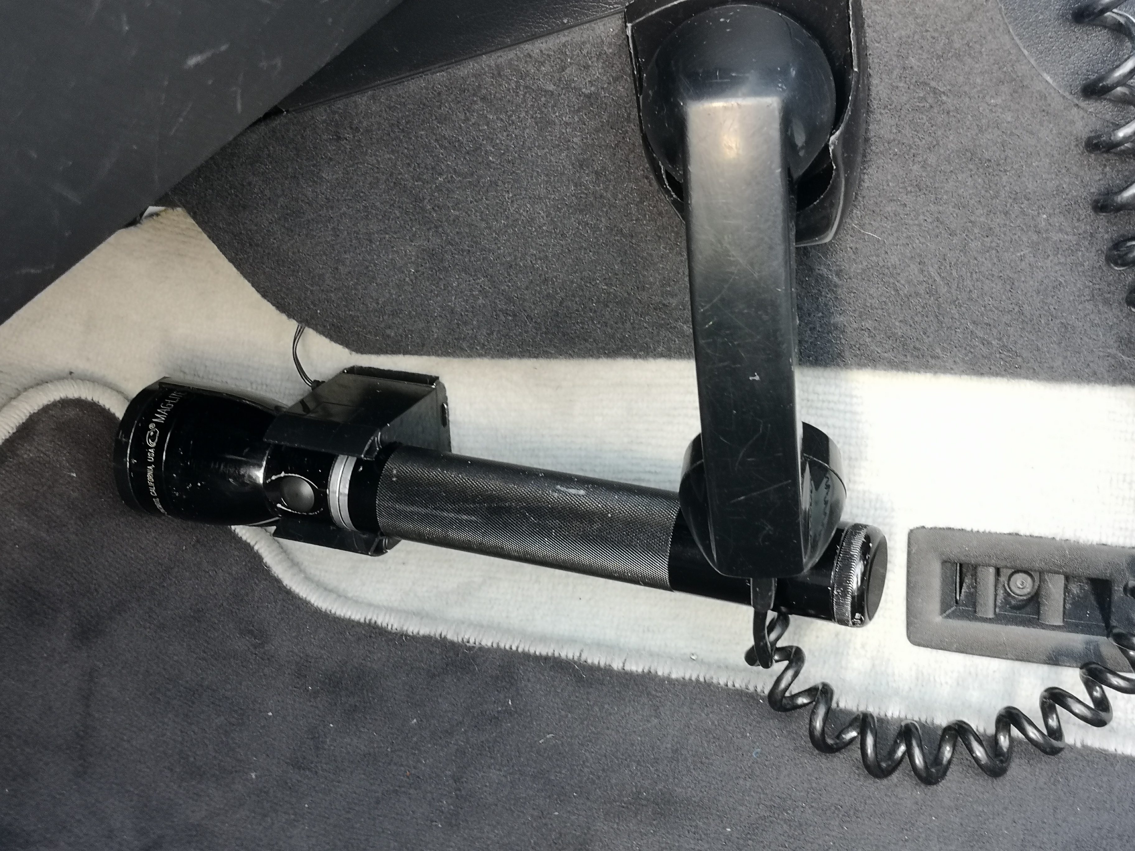

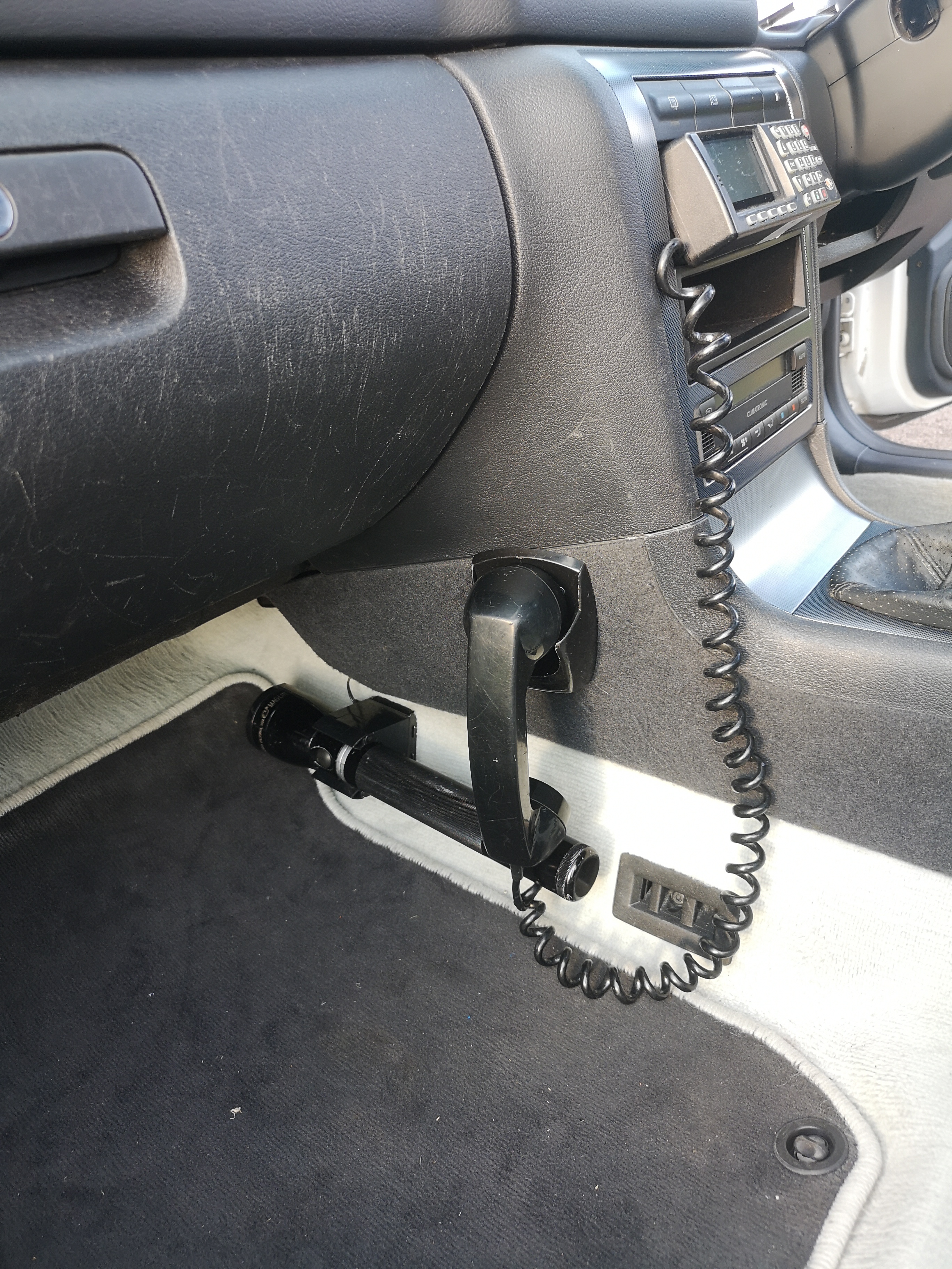

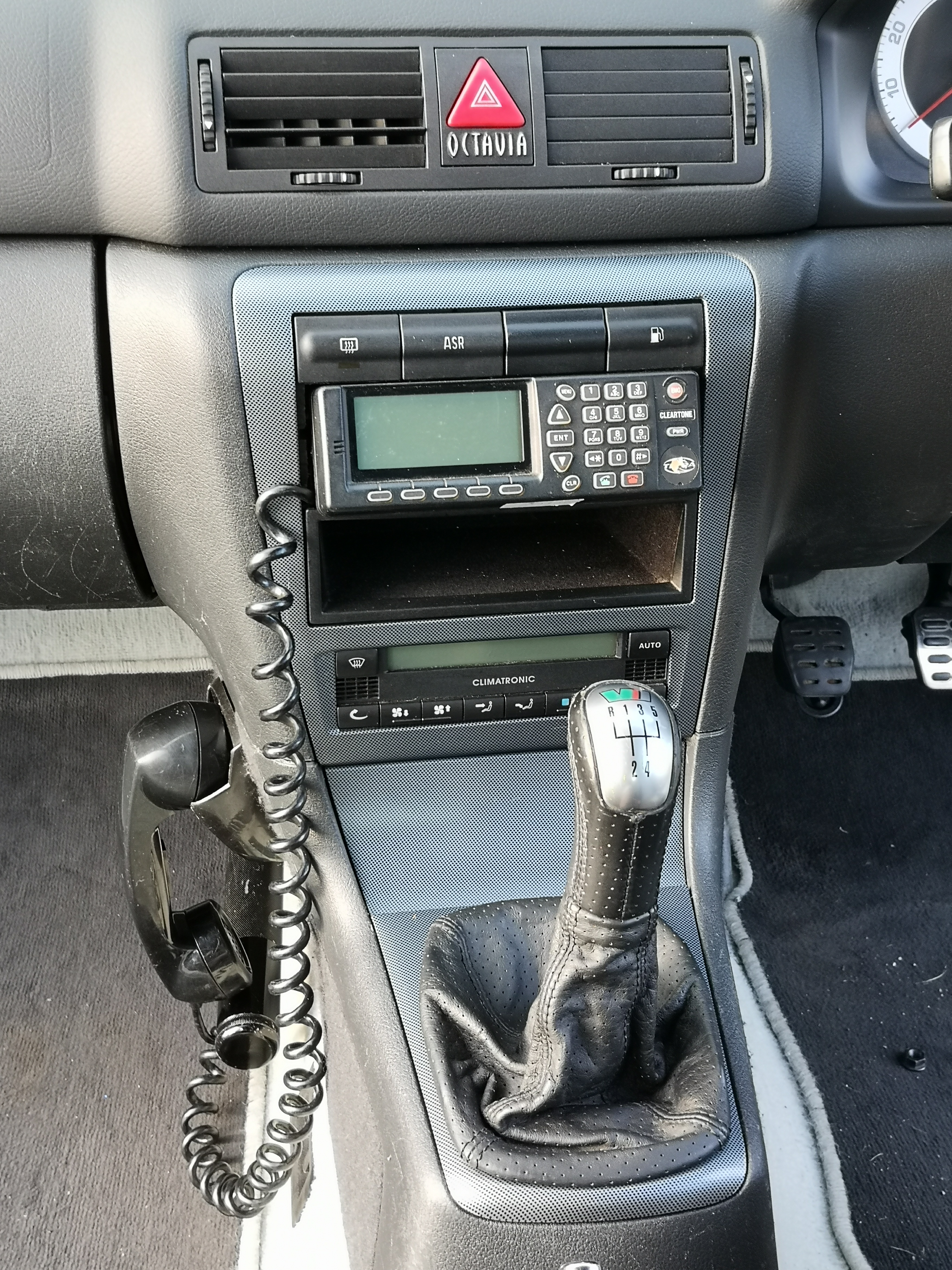

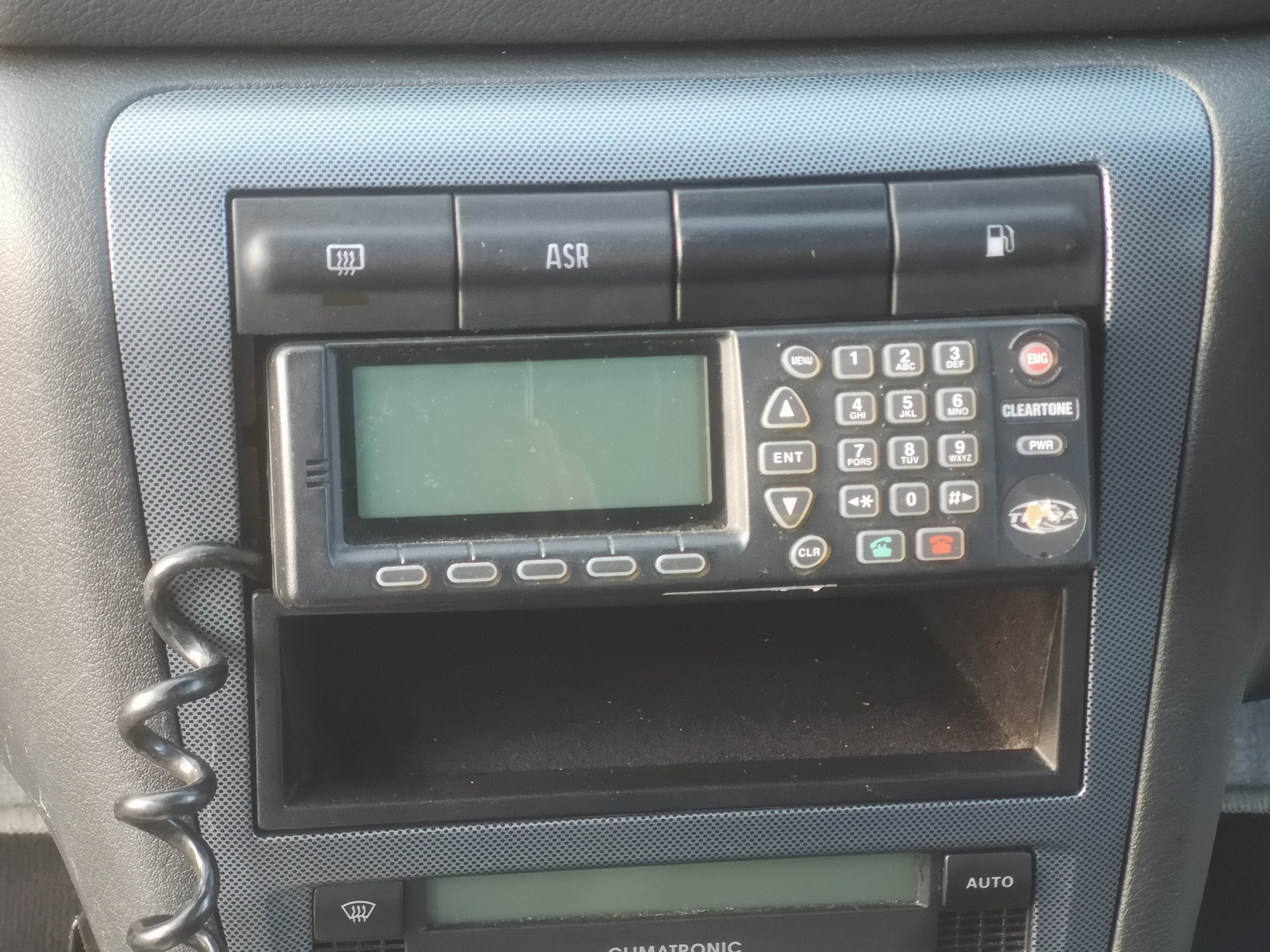

Finished off putting the interior back in. Fitting the original spec mag light torch and charger and the radio handset and cradle. Both mounted back in their original positions using the original mounting holes.
And the original radio, a Cleartone CM9000.  This will not be operational, but I will try to wire it up just so it can be turned on to light up the display.
Its not permanently fitted in these pics as I still need access to the wiring behind it.

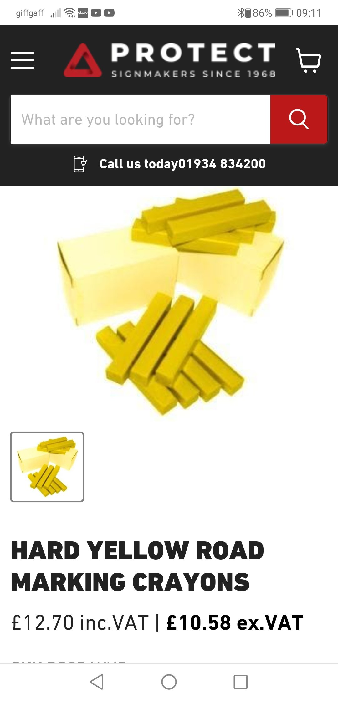

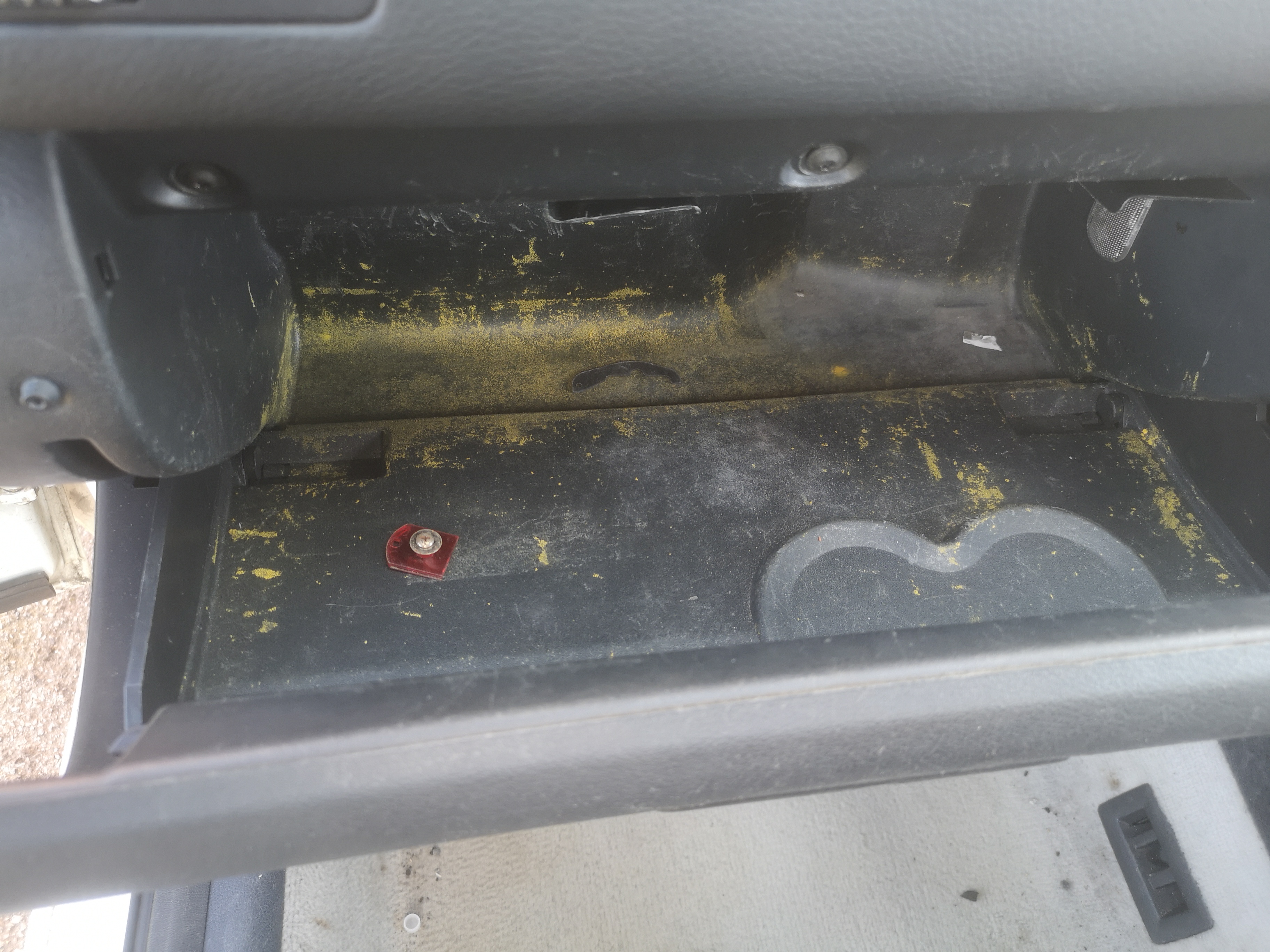

Another mystery was the glovebox. It's covered in what looks like yellow paint. I was going to change it, but then one of the officers informed me that it was caused by the yellow road marker crayon/ chalk that they use when investigating a road incident. So I will leave it as part of the cars history.
Finally managed to track down some of the road marker crayons that caused this mess. That another piece ticked off the list.

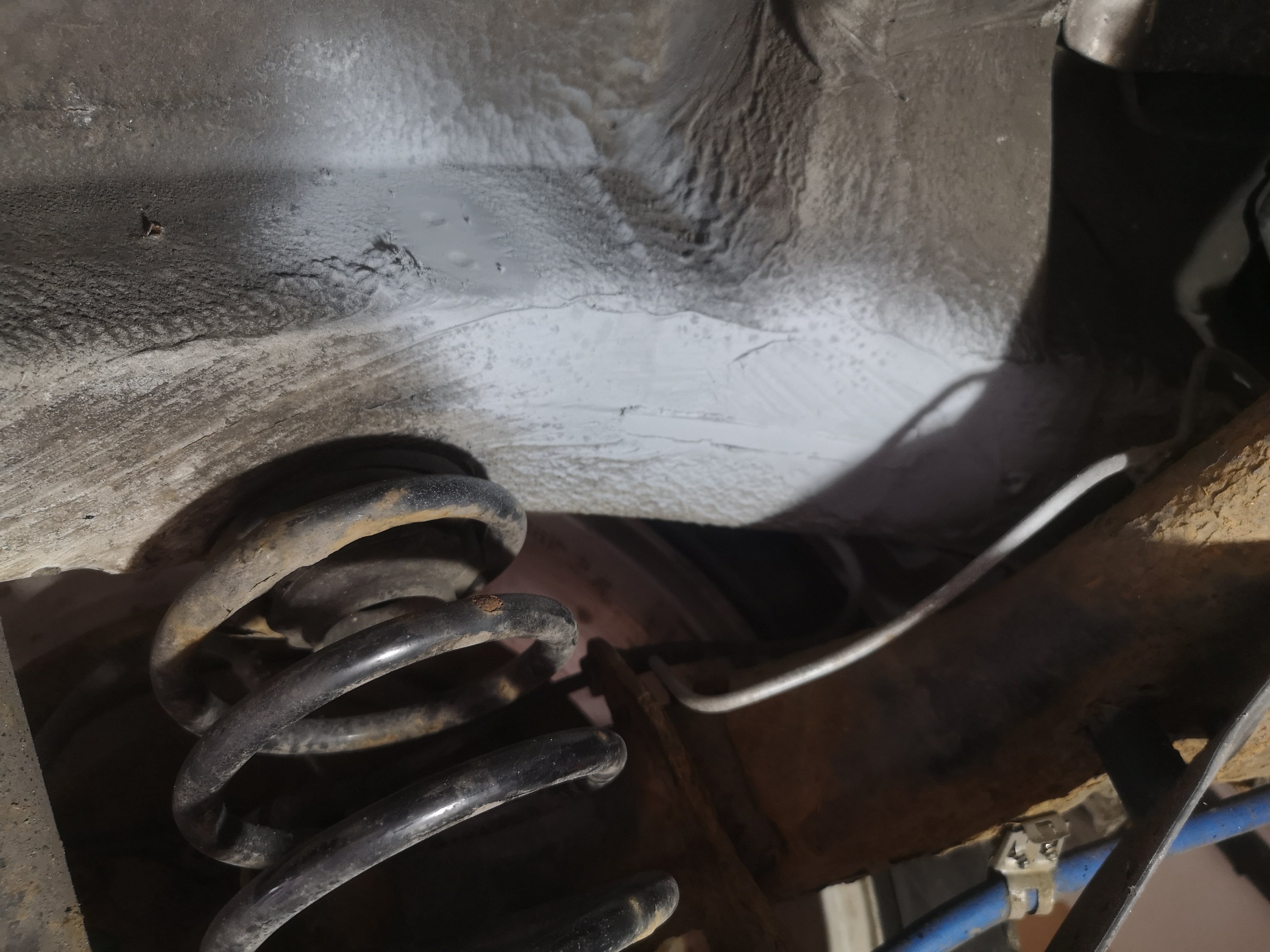

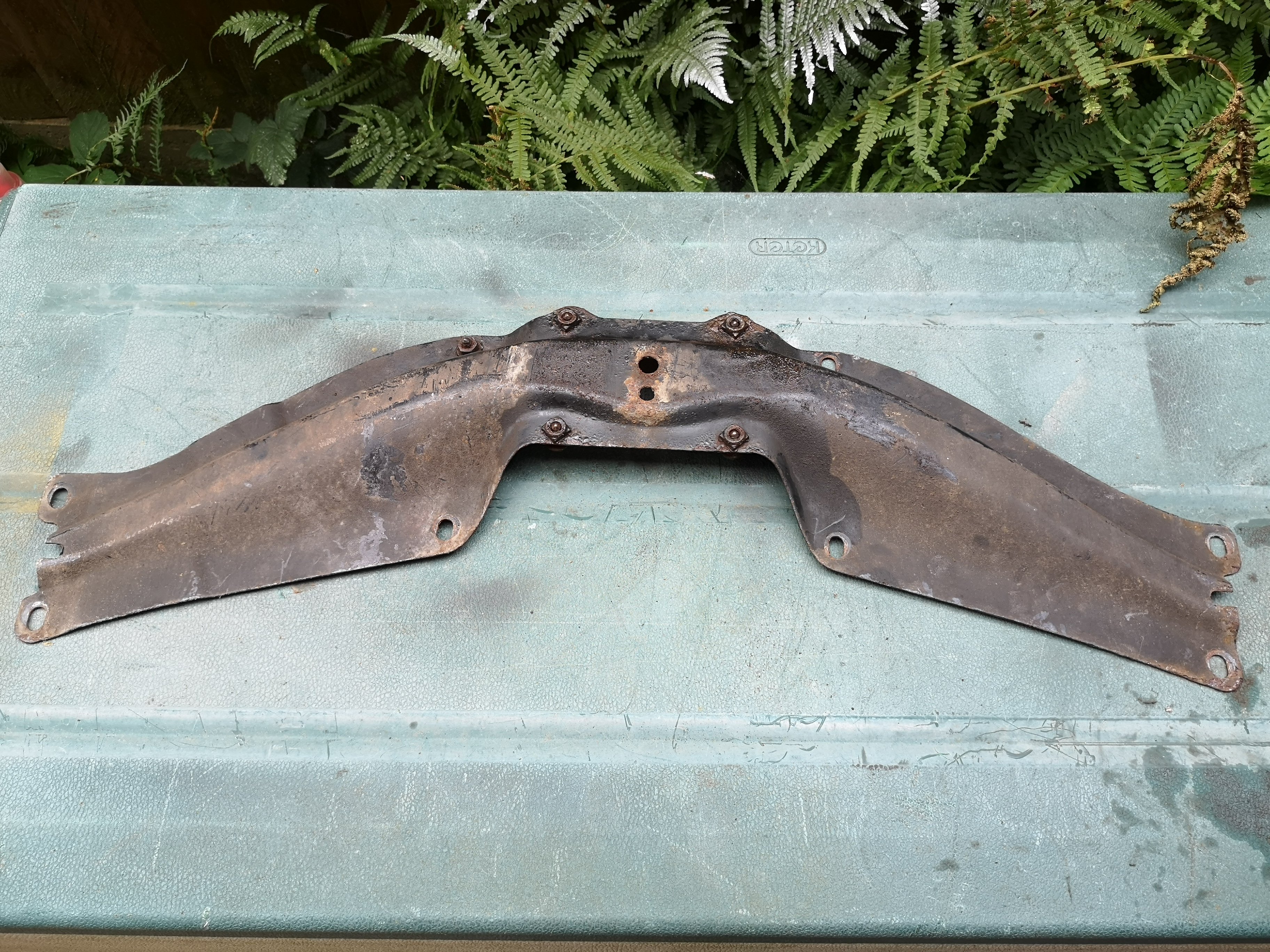

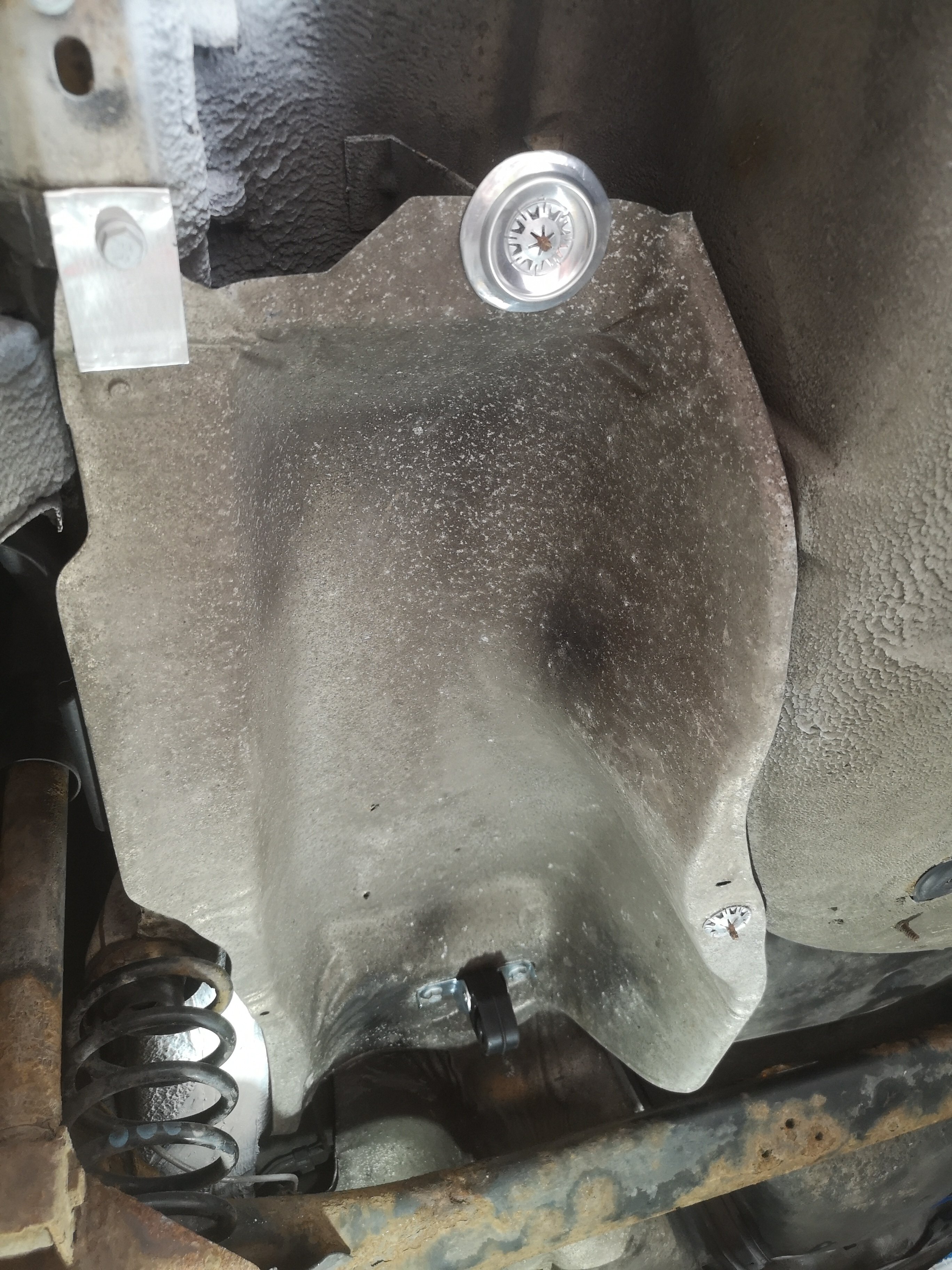

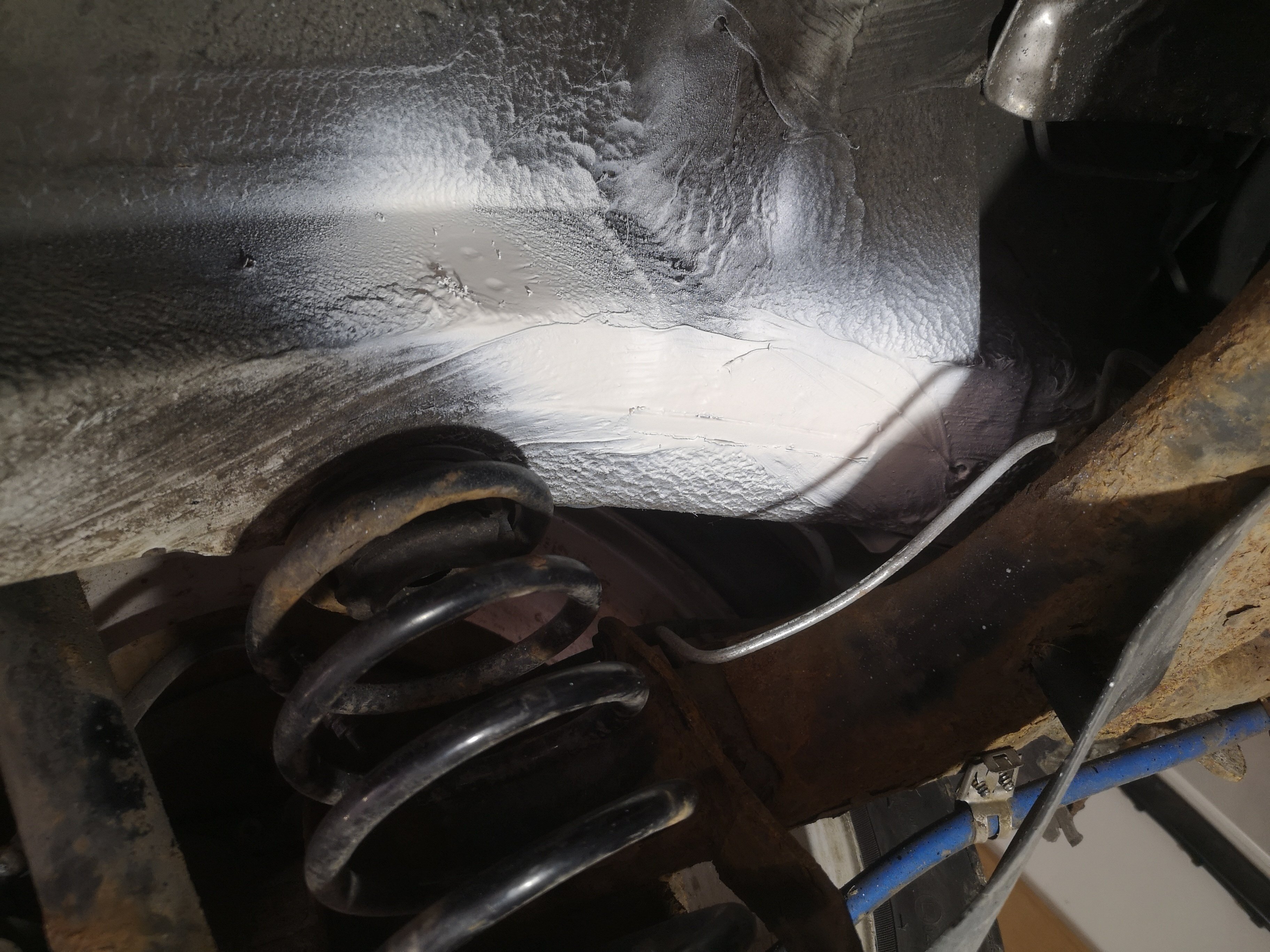

While replacing the exhaust I noticed the heat shields were loose. I removed these to repair then and noticed some light rust in a few spots where the underseal was peeling. (see what I mean about one job leading to another) So I sanded these back, zinc primed the bare metal and finished with a splash of stonechip.
Edited by a1topdog

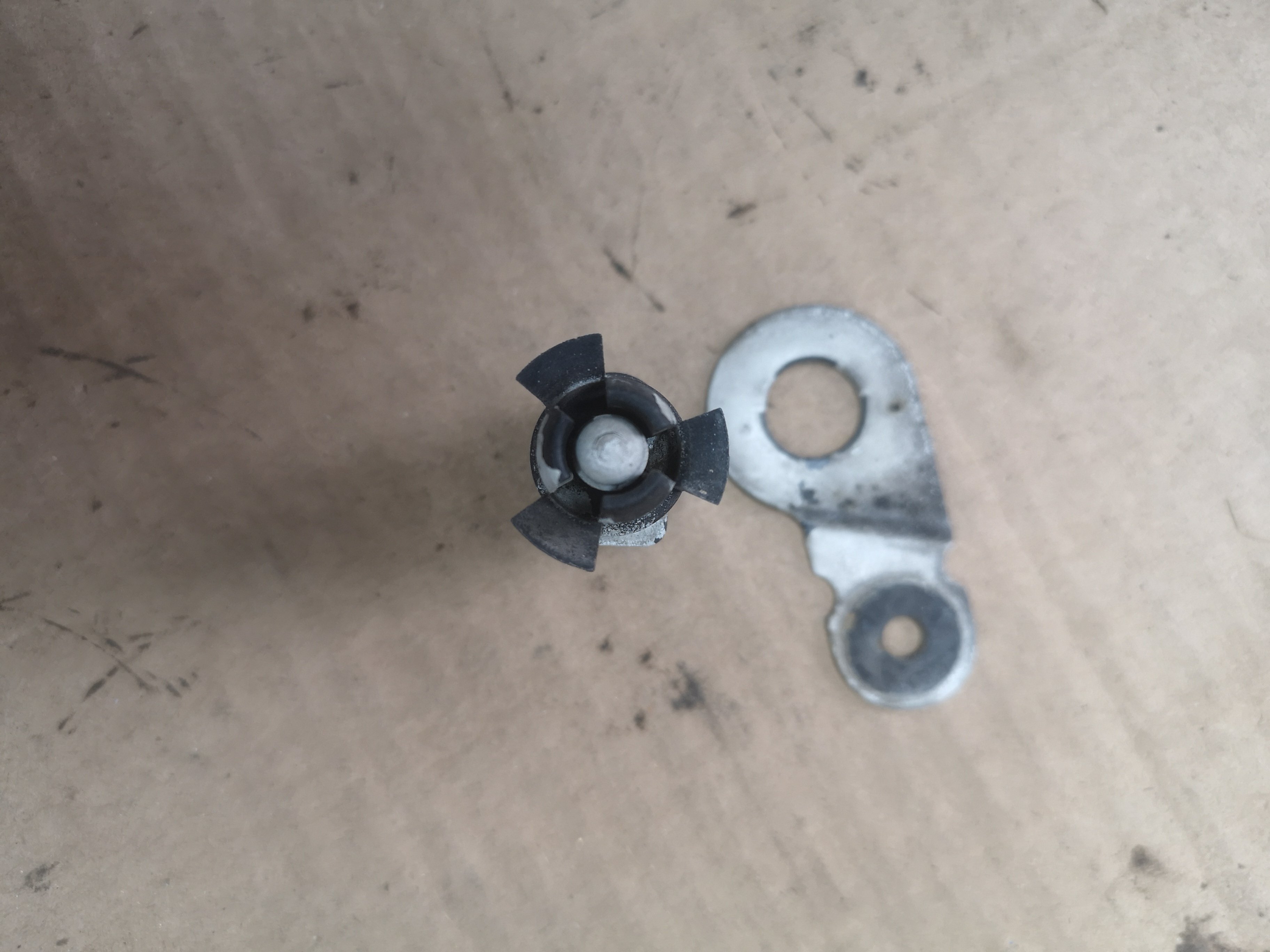

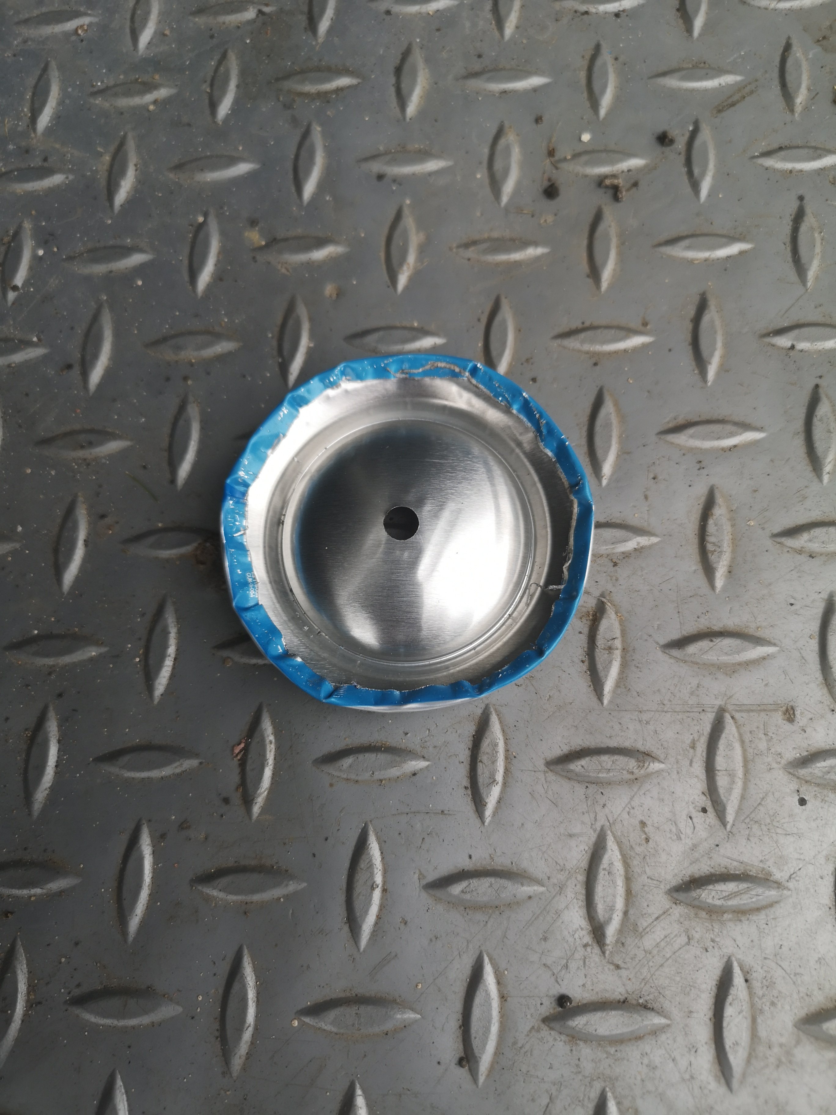

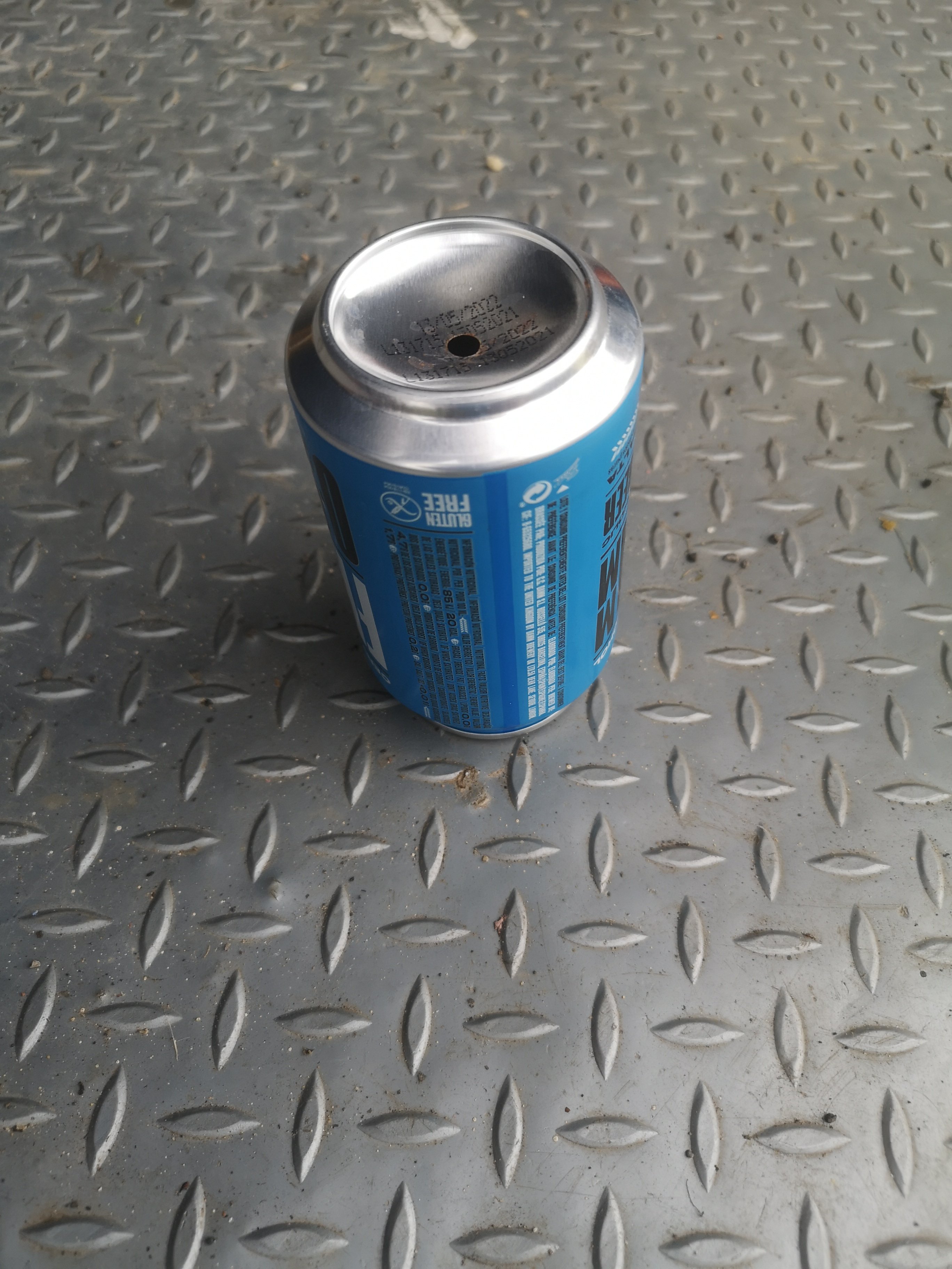

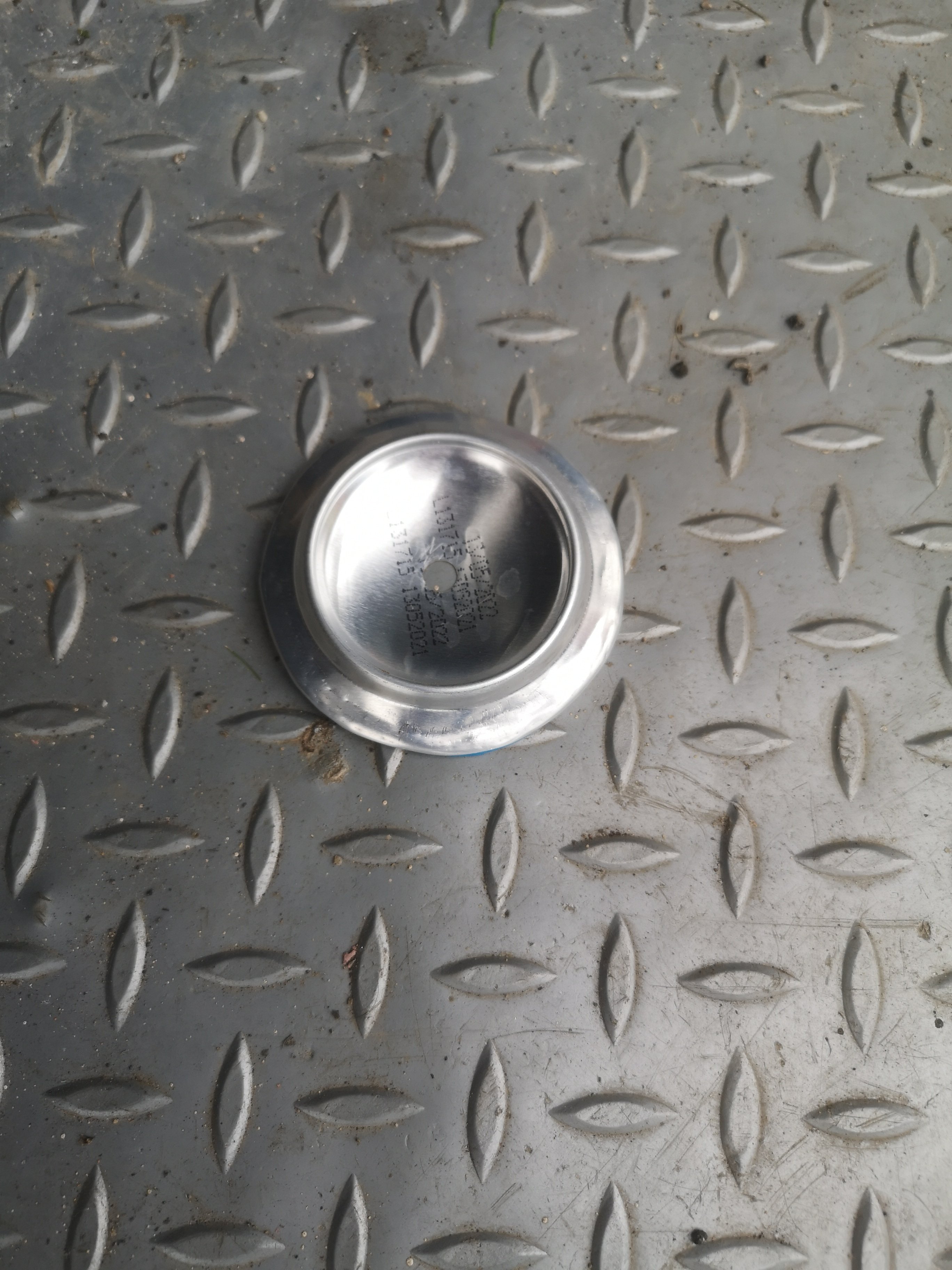

Next was to address the loose heatshield.  They rot out around the steel fixings, leaving a hole bigger then the fixing, hence they rattle and drop down. Using a tip I picked up off YouTube I made a new fixing from an old Ali can. Works a treat.
Edited by a1topdog
The the heatshield fitting back into place ready for the replacement exhaust

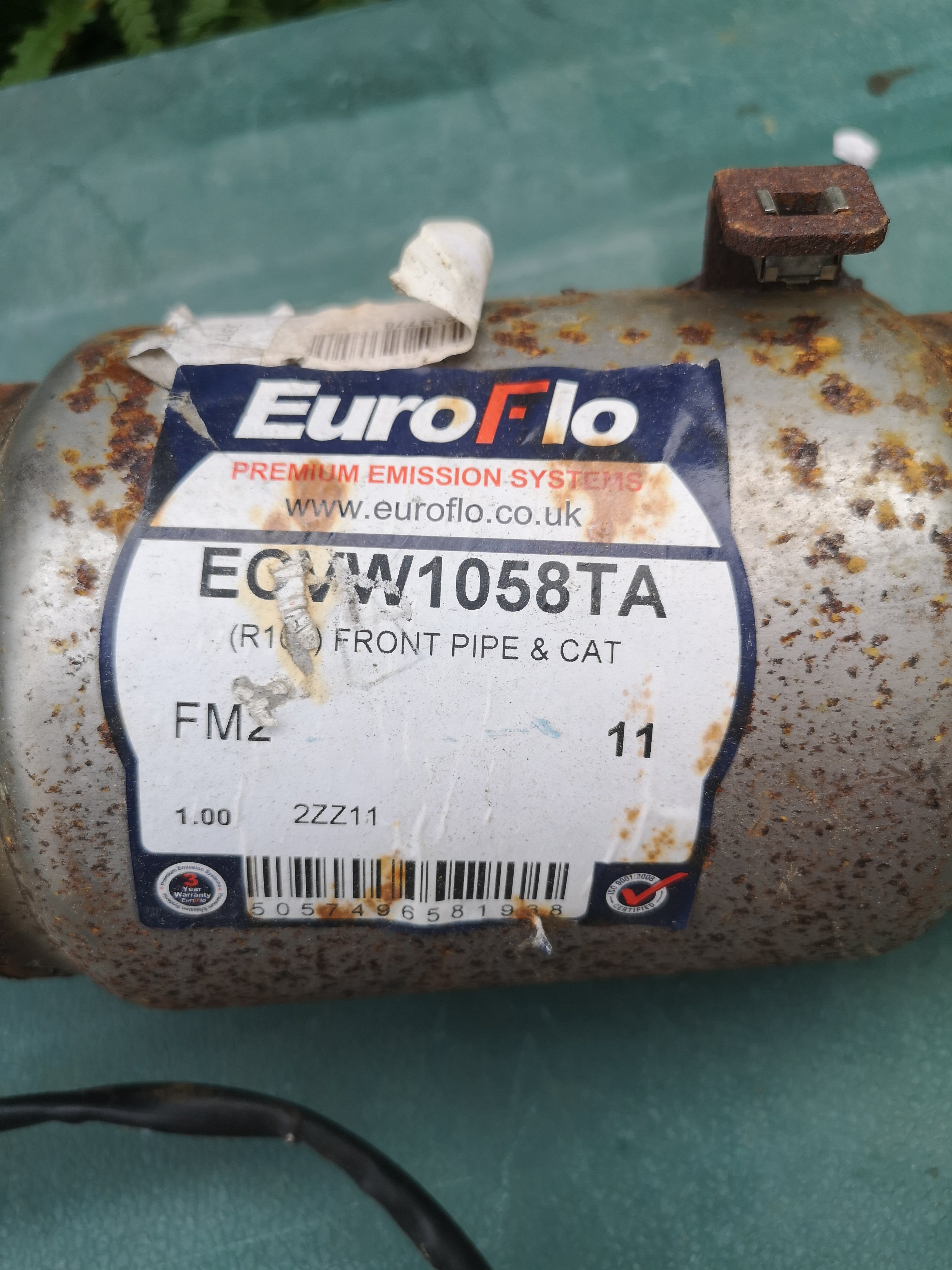

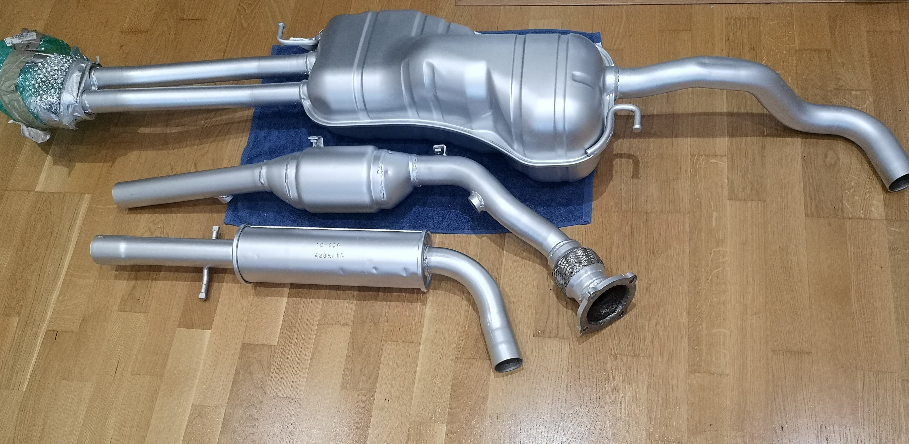

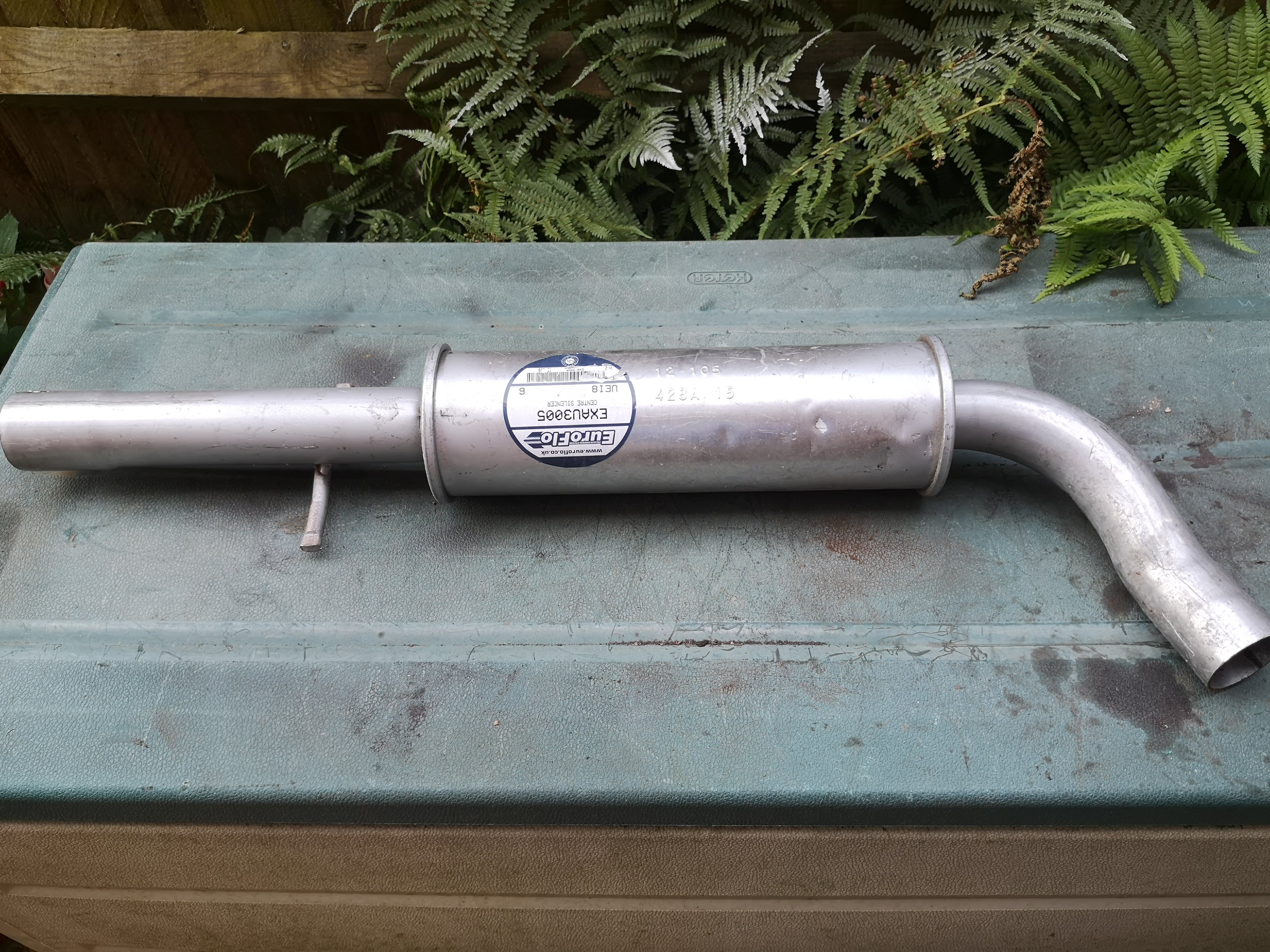

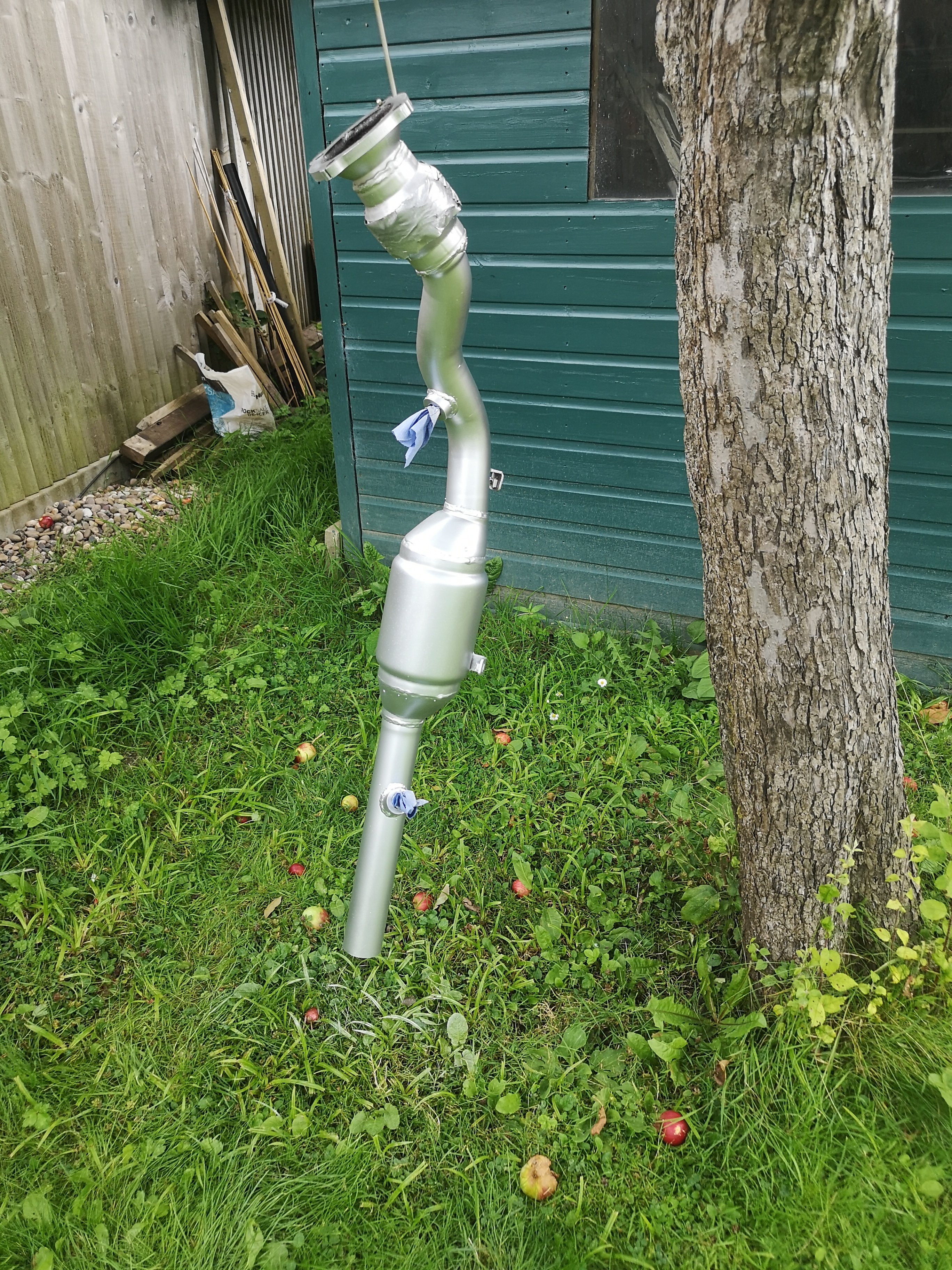

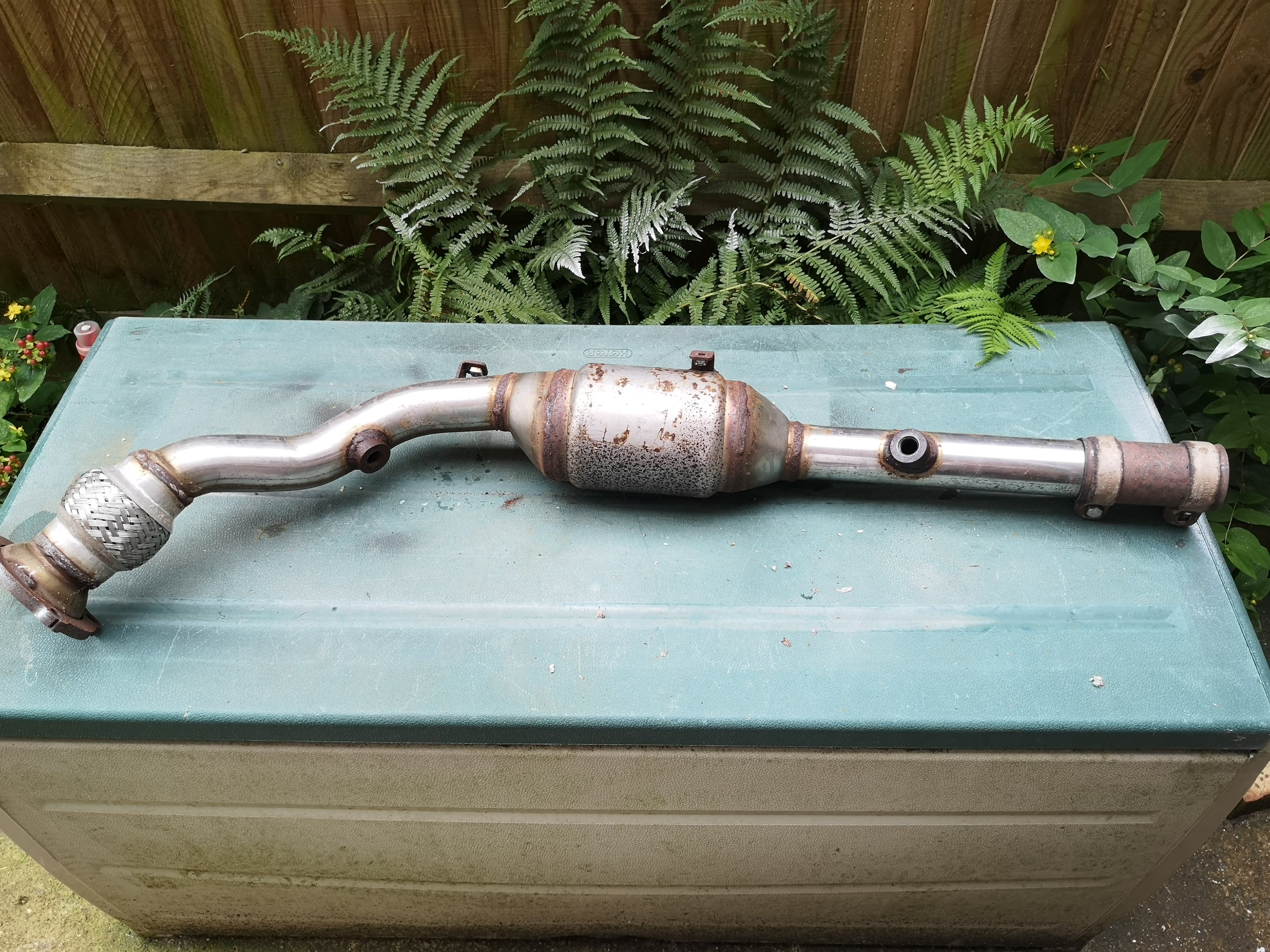

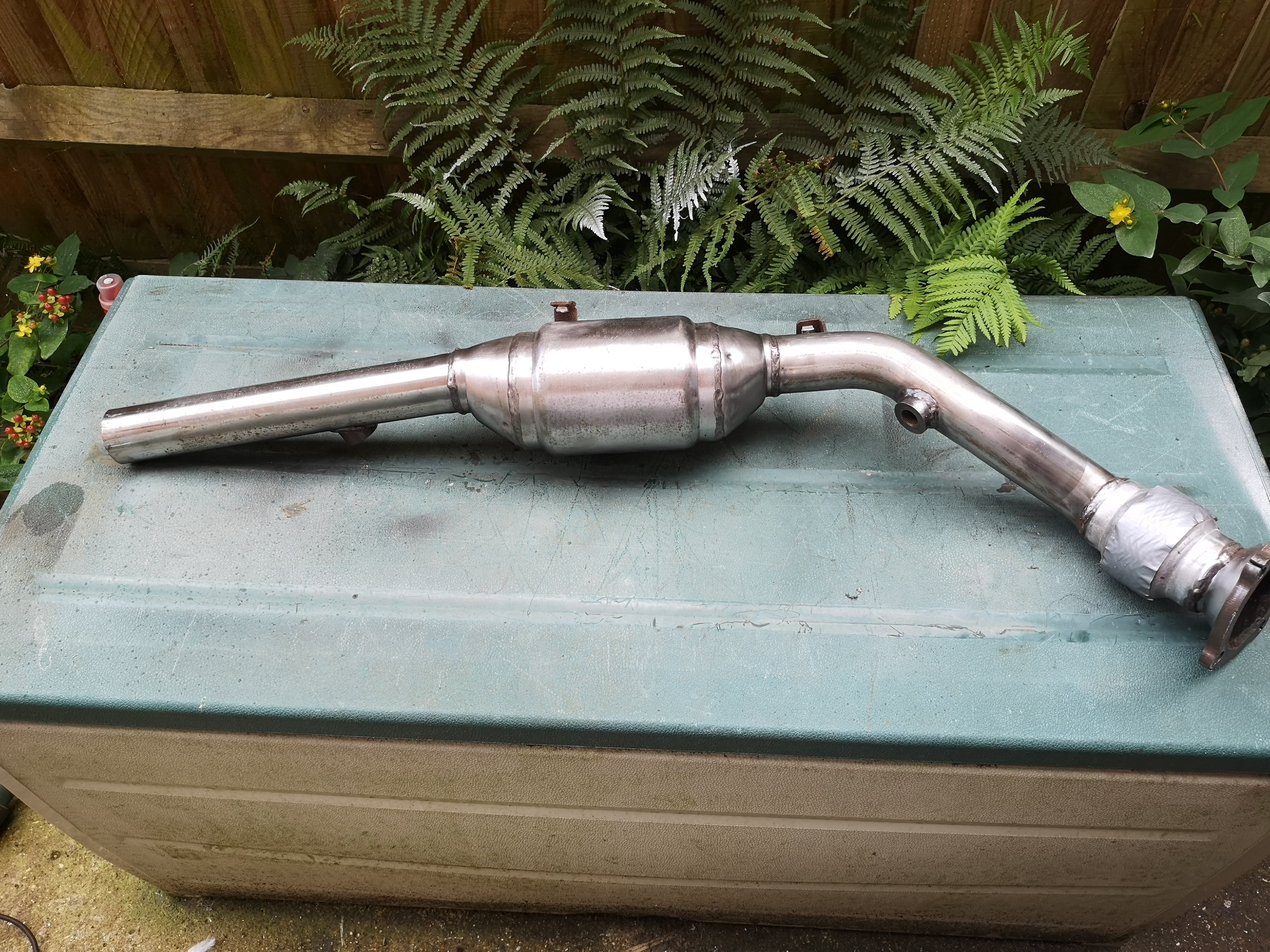

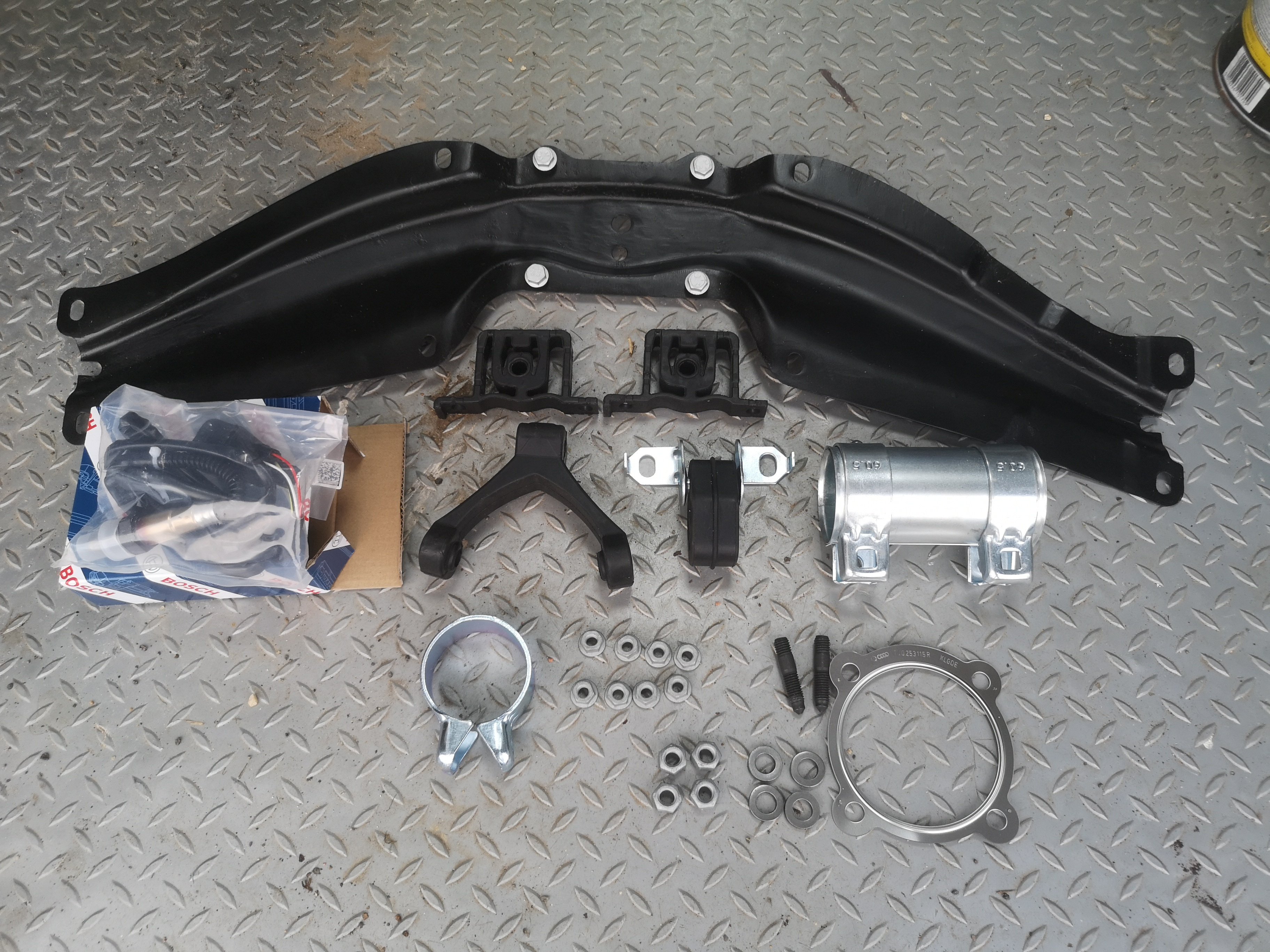

I sold my Miltec as it was too loud and not in keeping with what I was doing with the car. I picked up a lightly used Euroflo front cat. It's not the one they list for a Mk1 vrs, but it came off one, so it does fit. I gave it a clean up and lick of vht paint using my tree spray booth 😁
Edited by a1topdog
Also opted for a Euroflo mid section, but went for a new genuine back box as no-one makes a pattern one. Even though they were both new I gave them a lick of vht paint
I cleaned up and painted the exhaust center mount, and retapped the captive nut threads so I could fit new bolts. These are a pig to remove when the bracket is fitted, so made it easier with the bracket off the car.

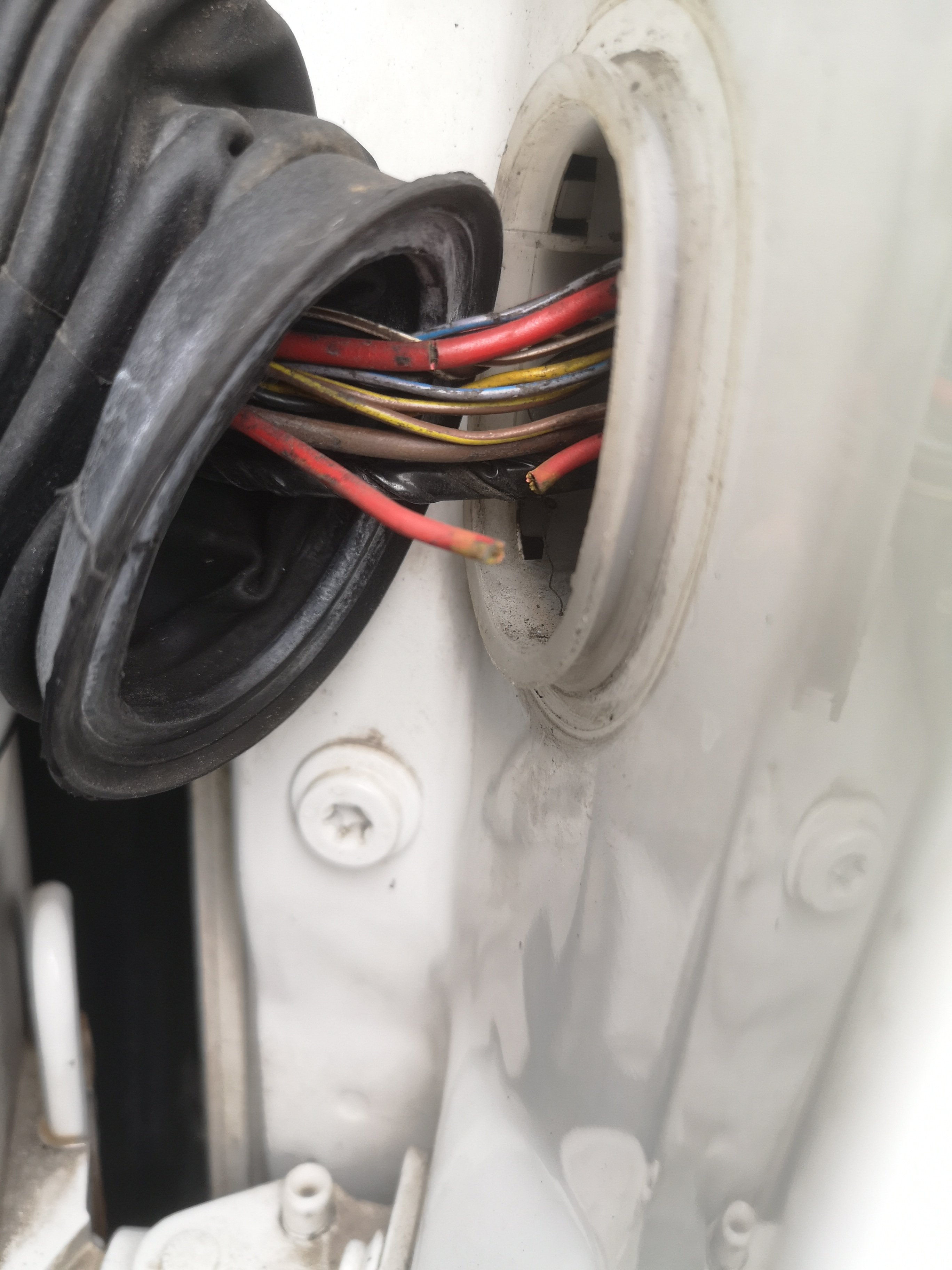

Next up was the drivers mirror not working. That was quickly traced to a broken wire in the loom where it passes through the large rubber grommet on the door. I soldered the wire together and mirror now working.

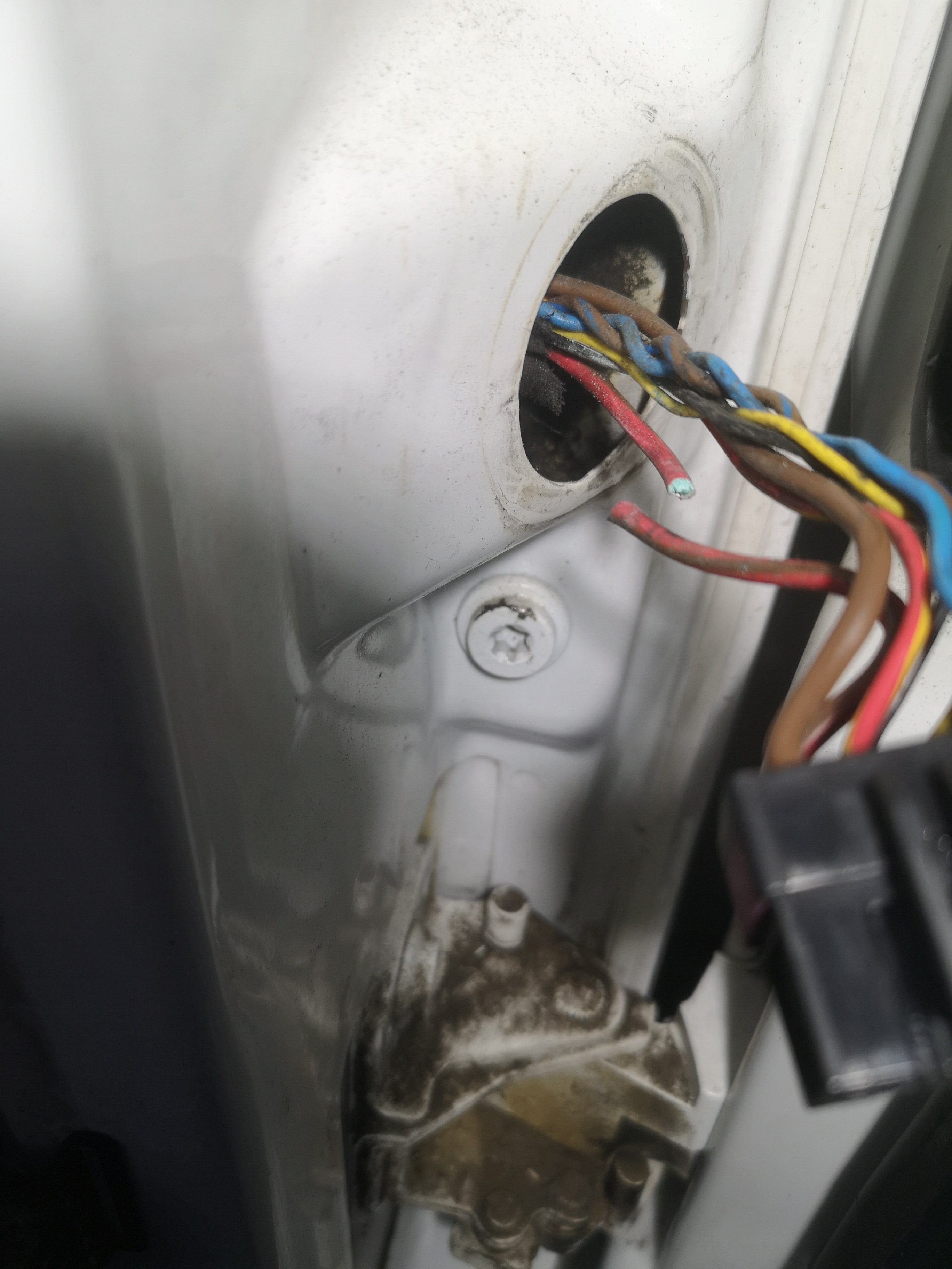

Last up was the passenger side rear window not working. I could hear the motor clicking.  The connector on the module was good, no corrosion. I pulled back the rubber grommet on the door to check for broken wires, all looked good. Next I disconnected the loom at the b Post (that's a pig to do) so I could do some continuity tests.  I completely removed the rubber grommet and pulled the door loom to get better access, and hey preston a broken wire was found further down the loom, inside the door. This nearly had me beat, and I was happy for a bit of luck. I soldered the wire and window now working.   Makes a change to fix things on this car without having to spend any money!

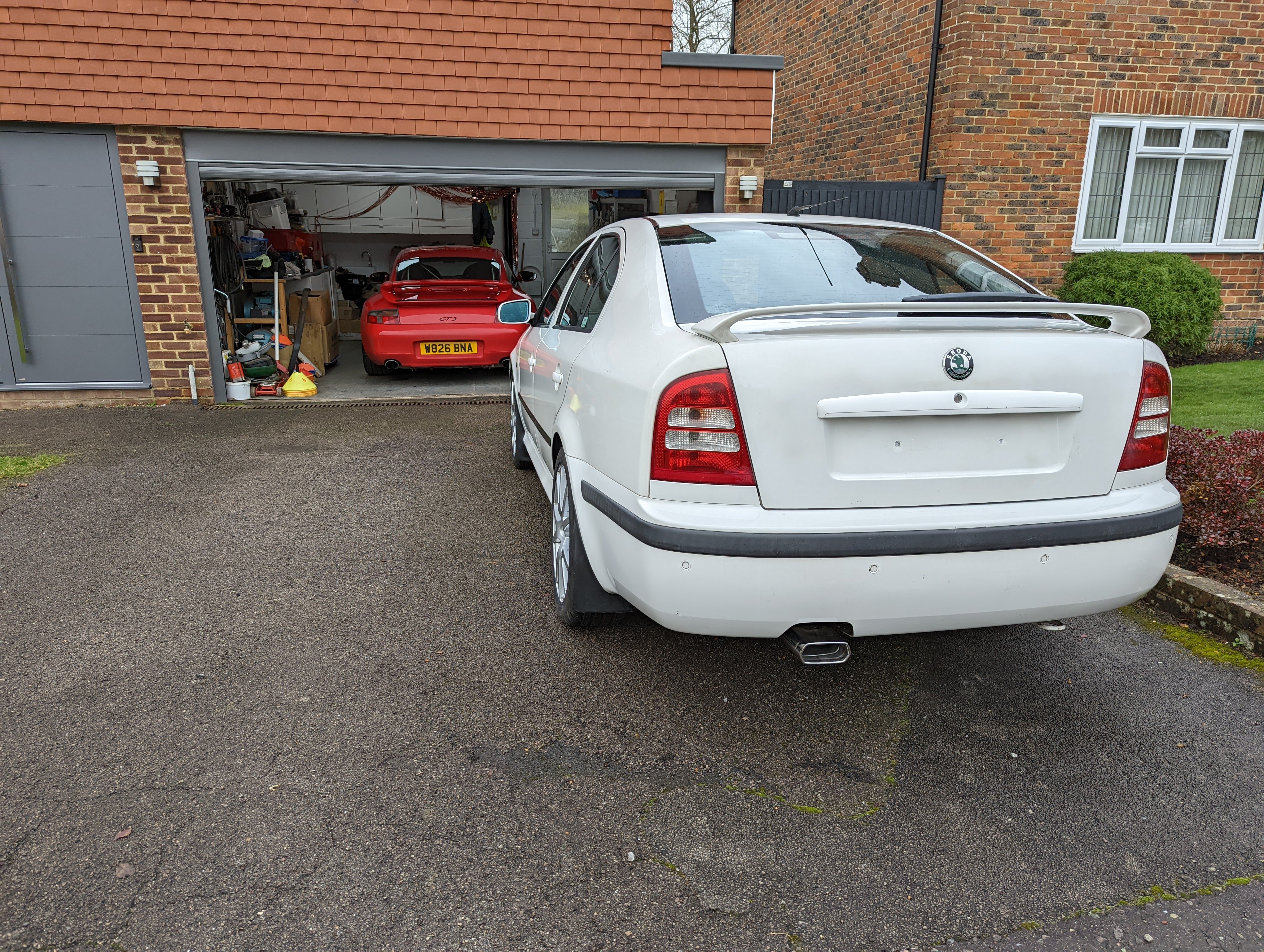

Ive been a bit quite with the updates, but I have been beavering away in the background. I'll get some update pics up asap. But I've had to evict the vrs from the garage as I had a new toy turn up.

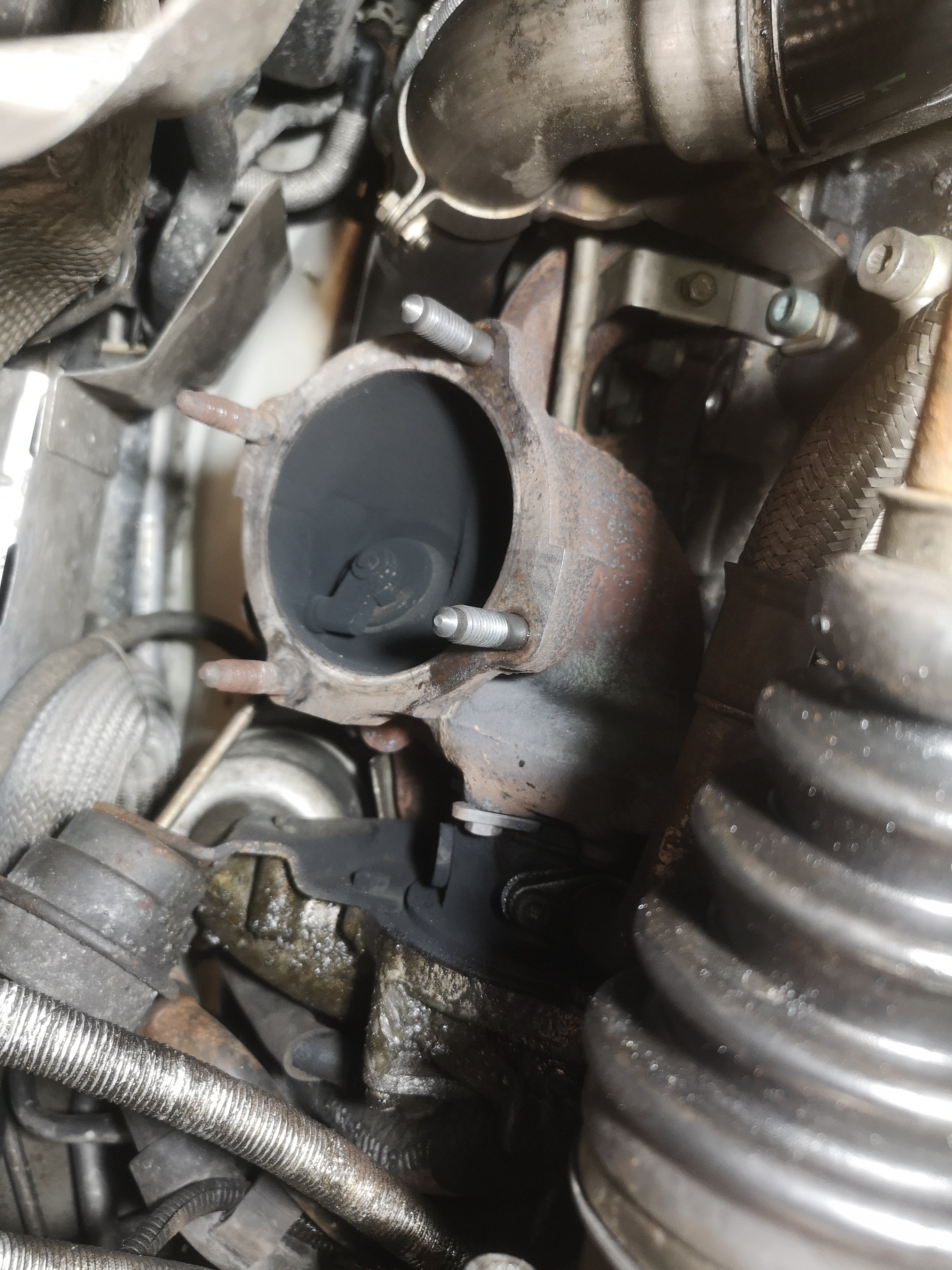

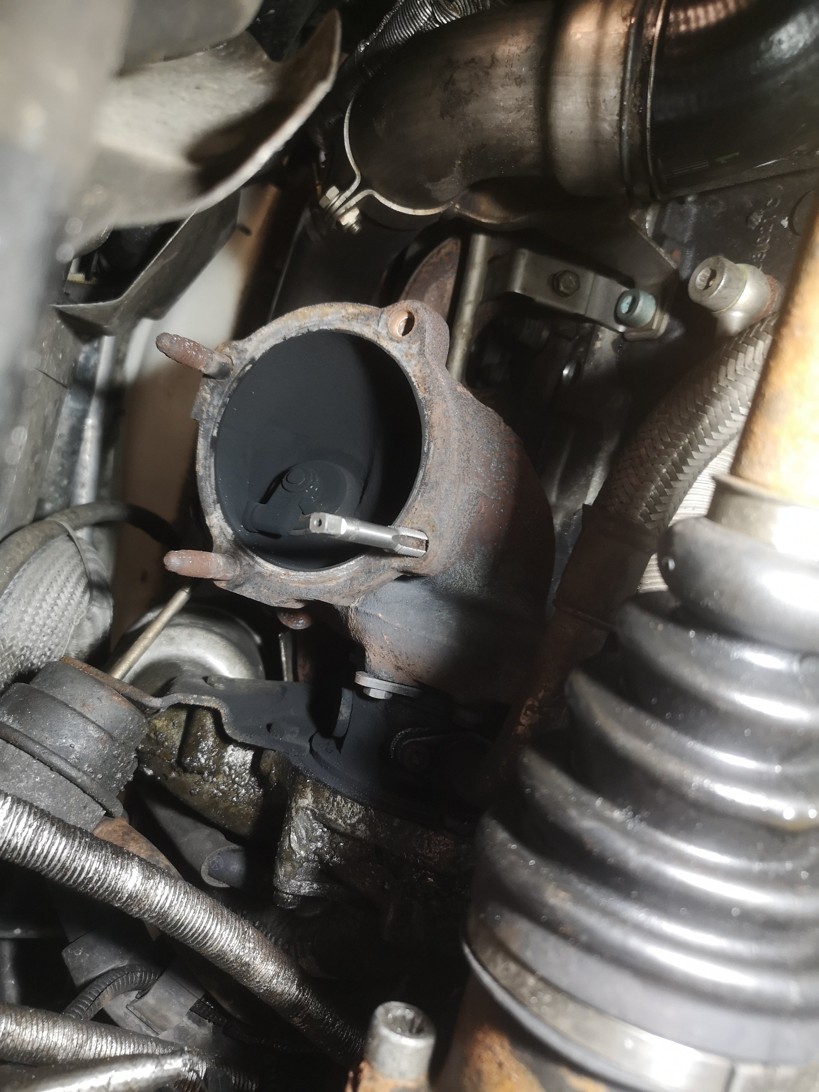

Before I could fit the new exhaust, I had two broken manifold studs to deal with. Luckily access wasn't to bad. I got the broken studs out, tapped the threads and inserted genuine new studs.

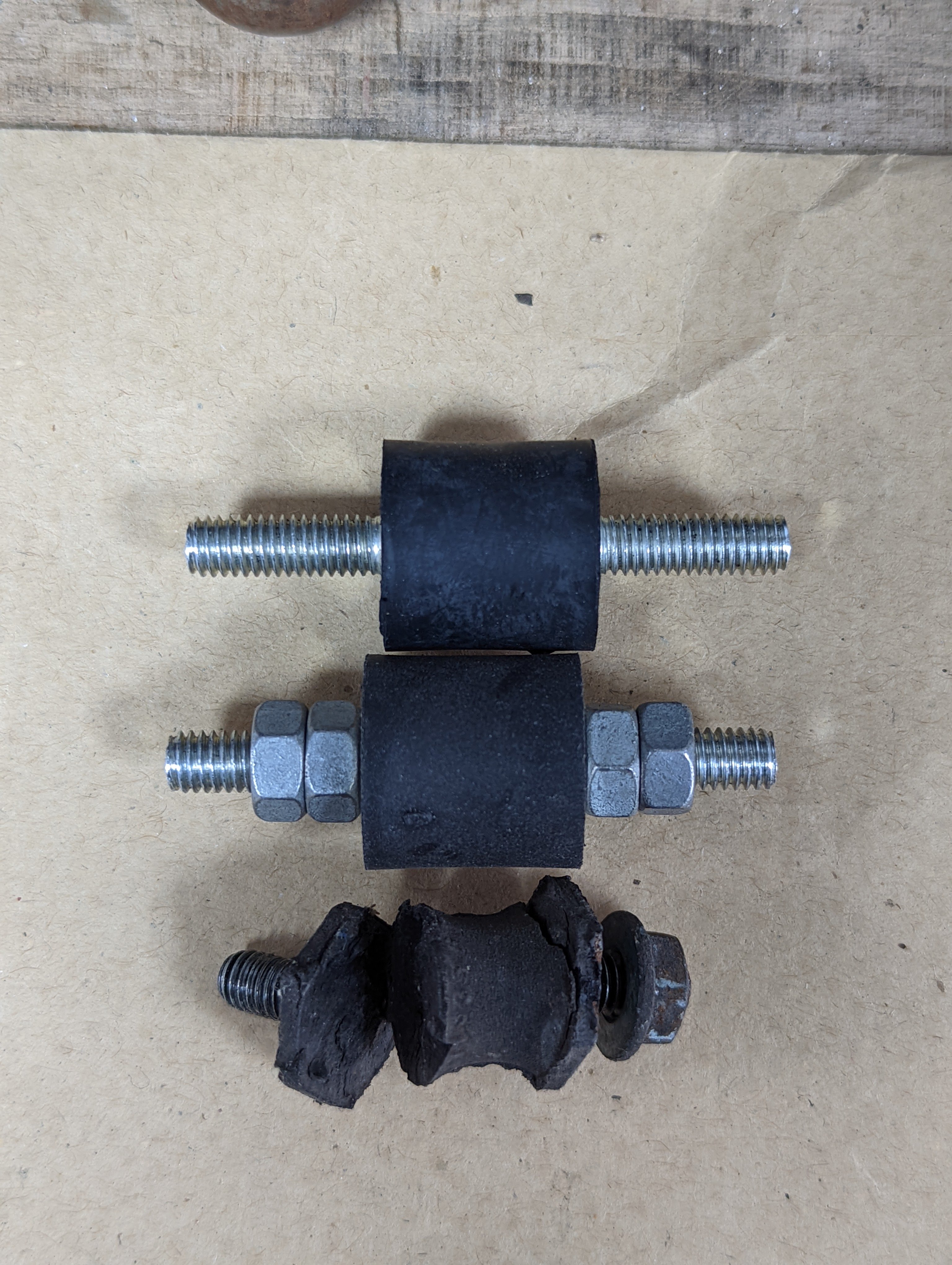

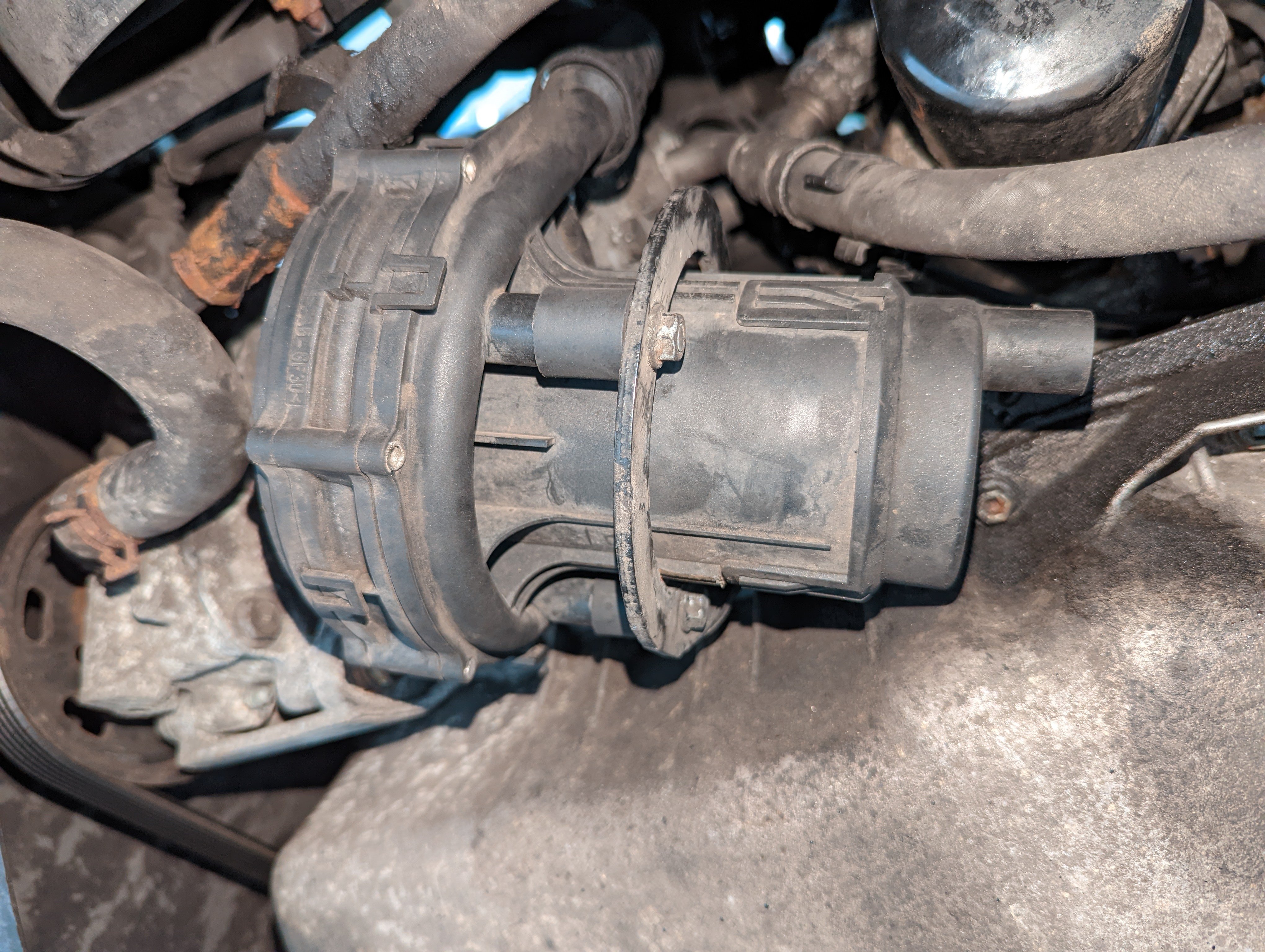

Found the usual problem of the secondary air pump rubber mounts broken. Genuine mounts are a ridiculous price, so I found some cheap alternatives, trimmed down the threads and fitted. I didn't bother to replace the rivets with bolts on the pump housing as it all looked ok.

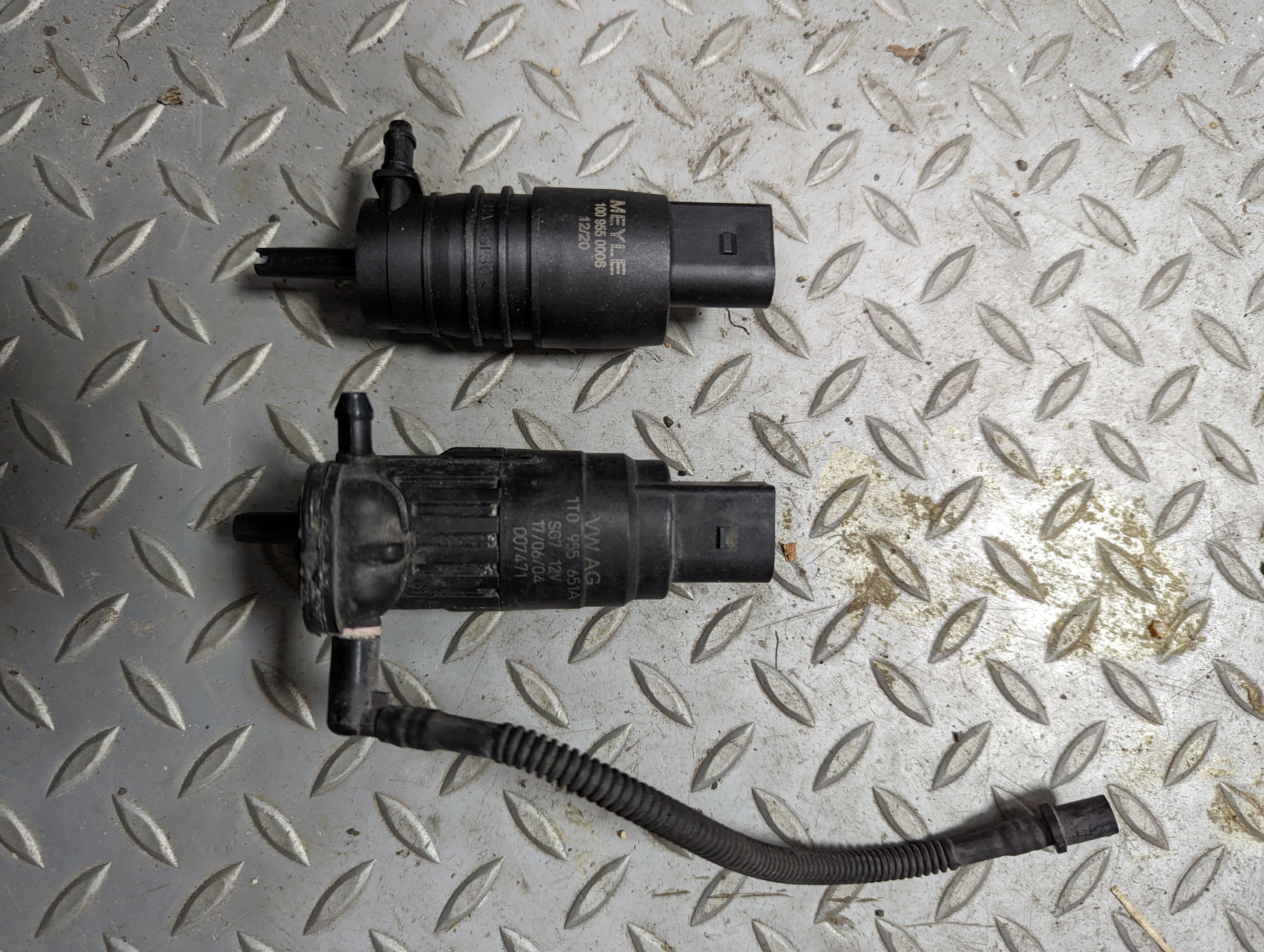

The screen washer pump wasn't working. The factory one has two outlets, I assume one for the front washers and one for the rear. Yet I couldn't find the rear washer pipe in my engine bay, no idea why that would have been removed. I don't need the rear washer so I just used a replacement pump with one outlet.
