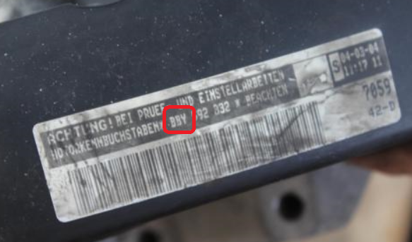

Where can i read the engine code in the engine itself?
  • Sponsor
Usually on the sticker on the upper cam-belt cover. (Example below; different code though, in that case BBY)
It won't be the same engine code obviously, but the core will be the same, the core is the block and head, all the other stuff that bolts onto it makes for a different code because it's for a different application.

All Fabia 1.9SDI engines are code ASY, so that is what you have.
  • Sponsor
Except if there are indeed differences within head or block. For example BBY and BBZ have different cams, I believe.  Need to know the engine code of the Octavia engine in order to look for any such differences.

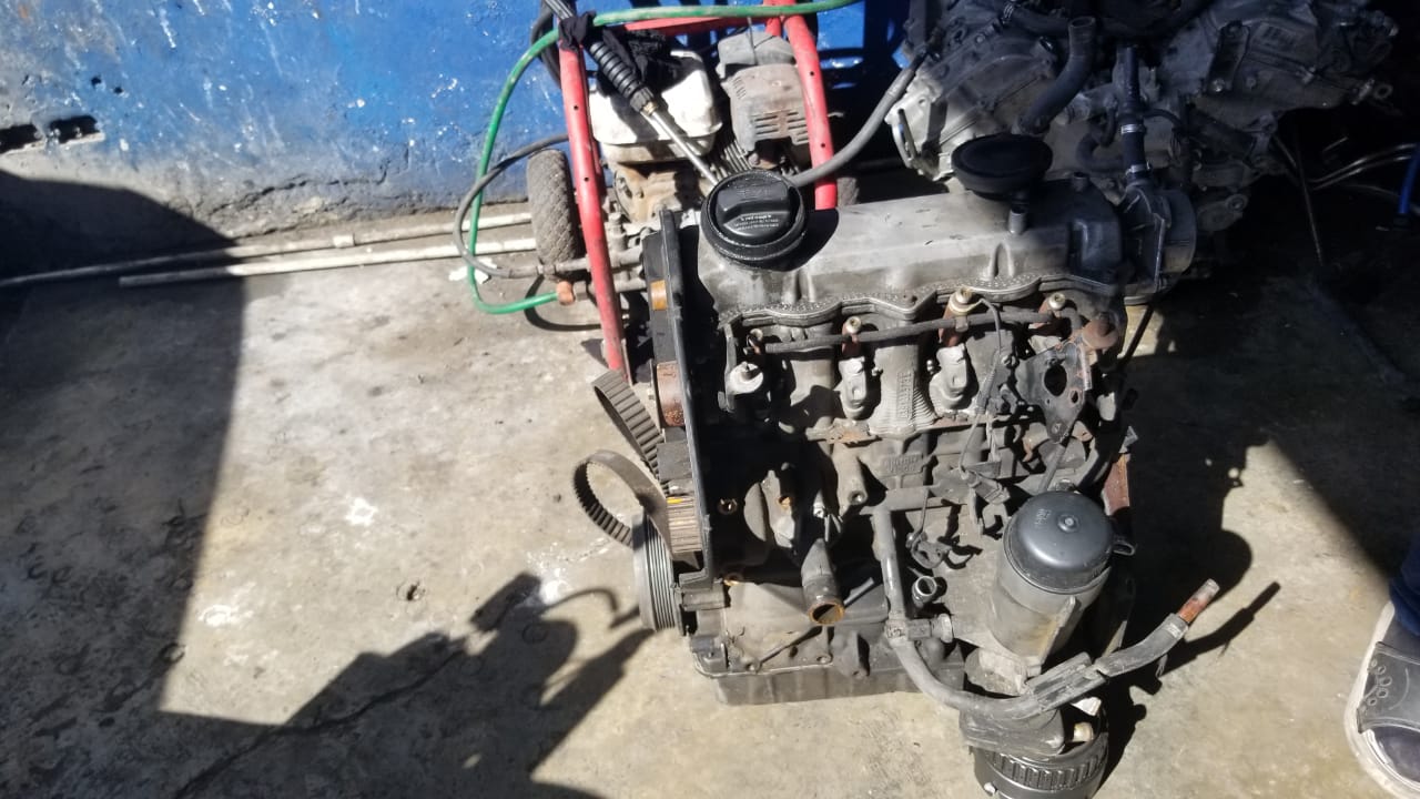

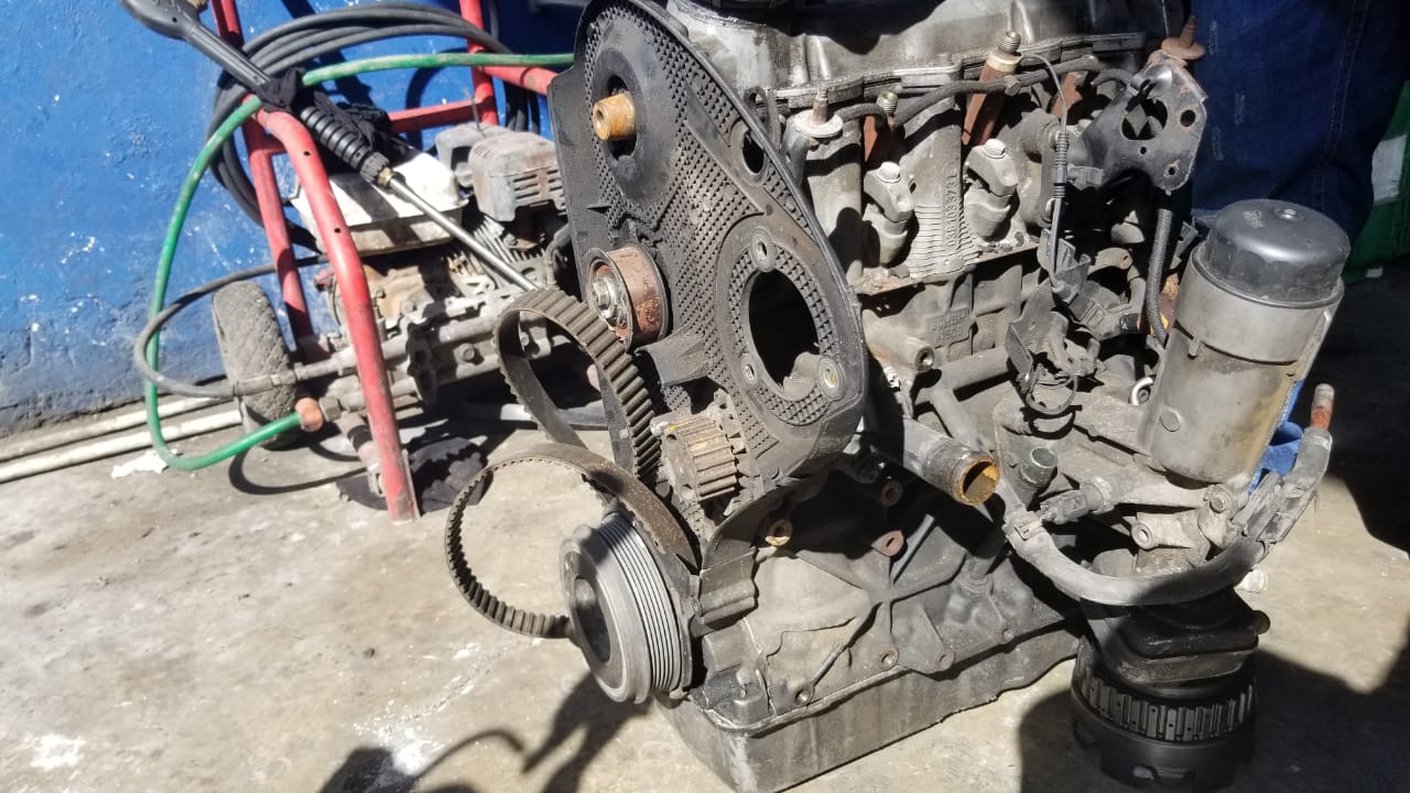

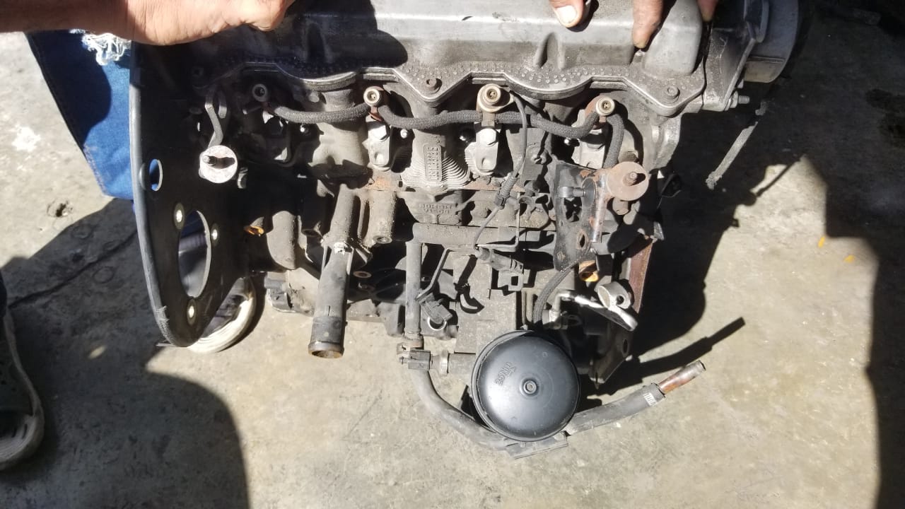

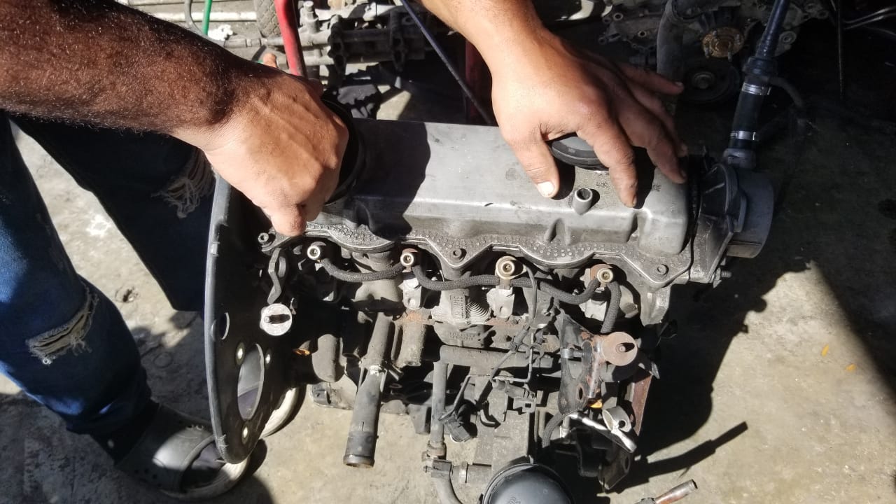

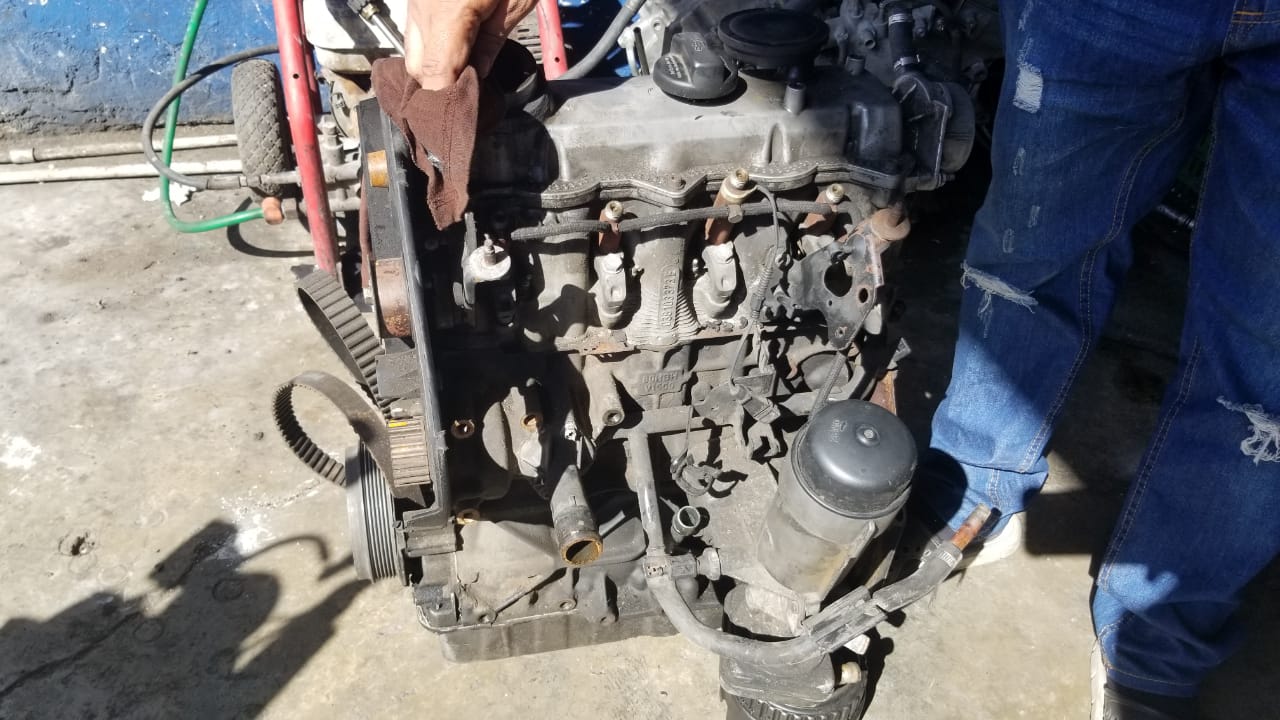

Is that the Octavia engine?
Yes, 2006
Why was the cam sprocket removed for crying out loud, that engine could be dead, you'd never know, it's been sat so long.
I suspect somebody was going to take the head off which suggests the head gasket is blown.
I suspects that too
Don't bother with it dude.
