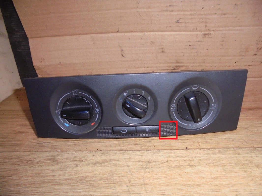

Is the temperature supposed to be electronically regulated? i.e. when set to 20c on the nob it will regulate the cabin temperature to 20c?
Edited by JoeF
It is supposed to work that way, yes, perhaps the cabin thermostat is blocked, there's a little grille with a tiny fan behind it.
Yeah, clean any dust from this little grille....
