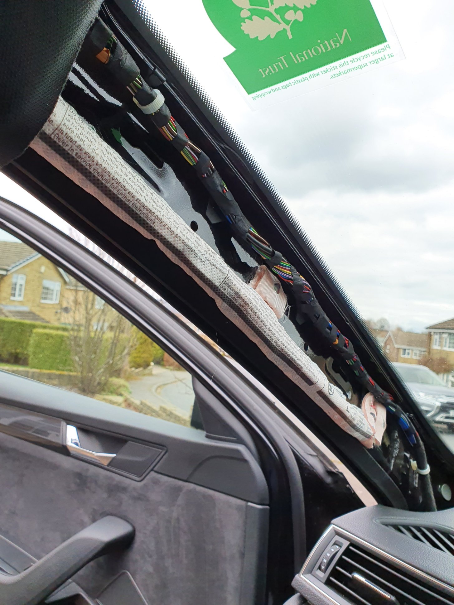

Firstly, don’t be afraid of removing your trim! I was and wasted time trying to avoid it initially. All clips on the trim I removed were metal and none broke. They were a lot easier to work with than the plastic ones I’ve encountered in the past on other cars. Start with your A-pillar trim (the piece running down the edge of the windscreen) and I used the passenger side. Gently pull it away from the top where it meets the roof lining, there are two clips, the top one came out easily and then with a bit of gentle pulling and wiggling the trim, slightly pulling upwards, the second one went with a ‘ping’ and I could then, with a bit more wiggling and pulling up and away from the dash, free the bottom of the trim. The bottom hooks in behind a metal clip fixed to the underside of the dash. You then have the following exposed:
You can now see the airbag, which you want to route your cable behind where you can see the manufacturer cables bundled together, when I had installed the power cable for the dashcam I cable tied it to these cables. Next pop the side trim off your dashboard, so you can get to pull the cable through from above. Just use a smooth flat trim tool in the middle and gently tease it out. It has around 6 clips from memory and it hooks under the door seal and has a hook moulded on the bottom vertical edge to hold it behind the lower footwell trim, remember this when putting back as you need to hook this in first then put it behind the rubber and then push it back in the clip holes. Most pictures I’ve seen show some foam wadding at the bottom of the A-pillar, mine didn’t have any (perhaps they were rushing to build it on a Friday teatime!), so the cable could be easily dropped through from the top of the A-pillar above the dash, if you have foam I believe you just have to poke it through as the other cables go through it. Make sure to leave enough cable to go up the A-pillar and across the top of your windscreen to where you wish to mount the dashcam. I have not hardwired mine (as of yet), but if hardwiring I understand the fuse box is behind the glovebox, so you have your cable in the right place now and can just take it from there. For me I carried on from here with the cable, I took the plug end out over the lower footwell trim near the door and then looped and tucked the cable back behind and under it into the footwell (difficult to explain, but you’ll hopefully see what I mean) and ran it under the inner lower door trim and then under the back edge of the carpet mat / storage unit trim under passenger seat and I currently plug in to the cigarette lighter in the dash. That’s your power cabling done and you just tuck the cable under the headlining across the top of the windscreen. So your cable should now run from wherever you want to mount it in the top of the windscreen across the edge of your headliner and down the A-pillar, all above and out of the way of the airbag.

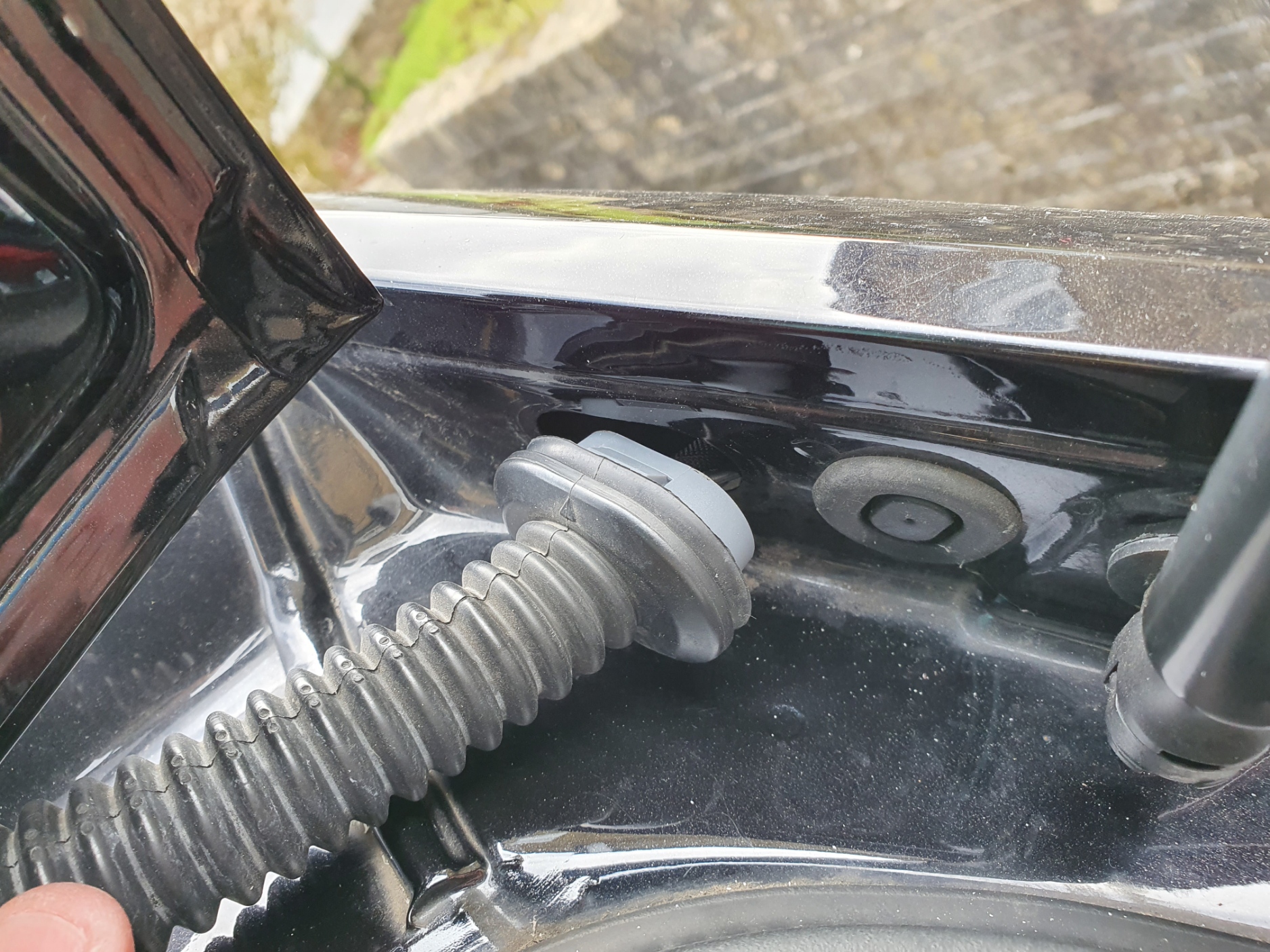

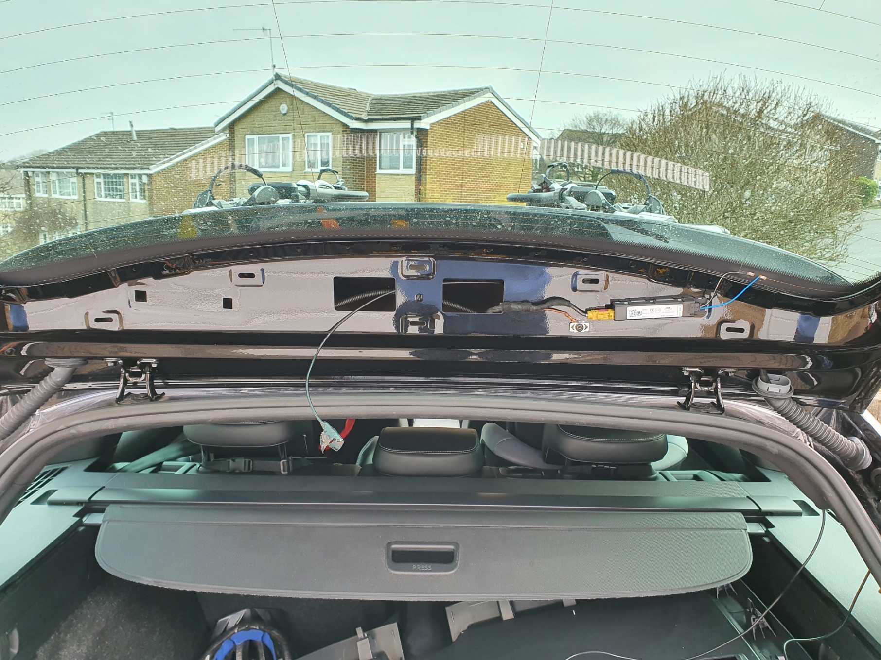

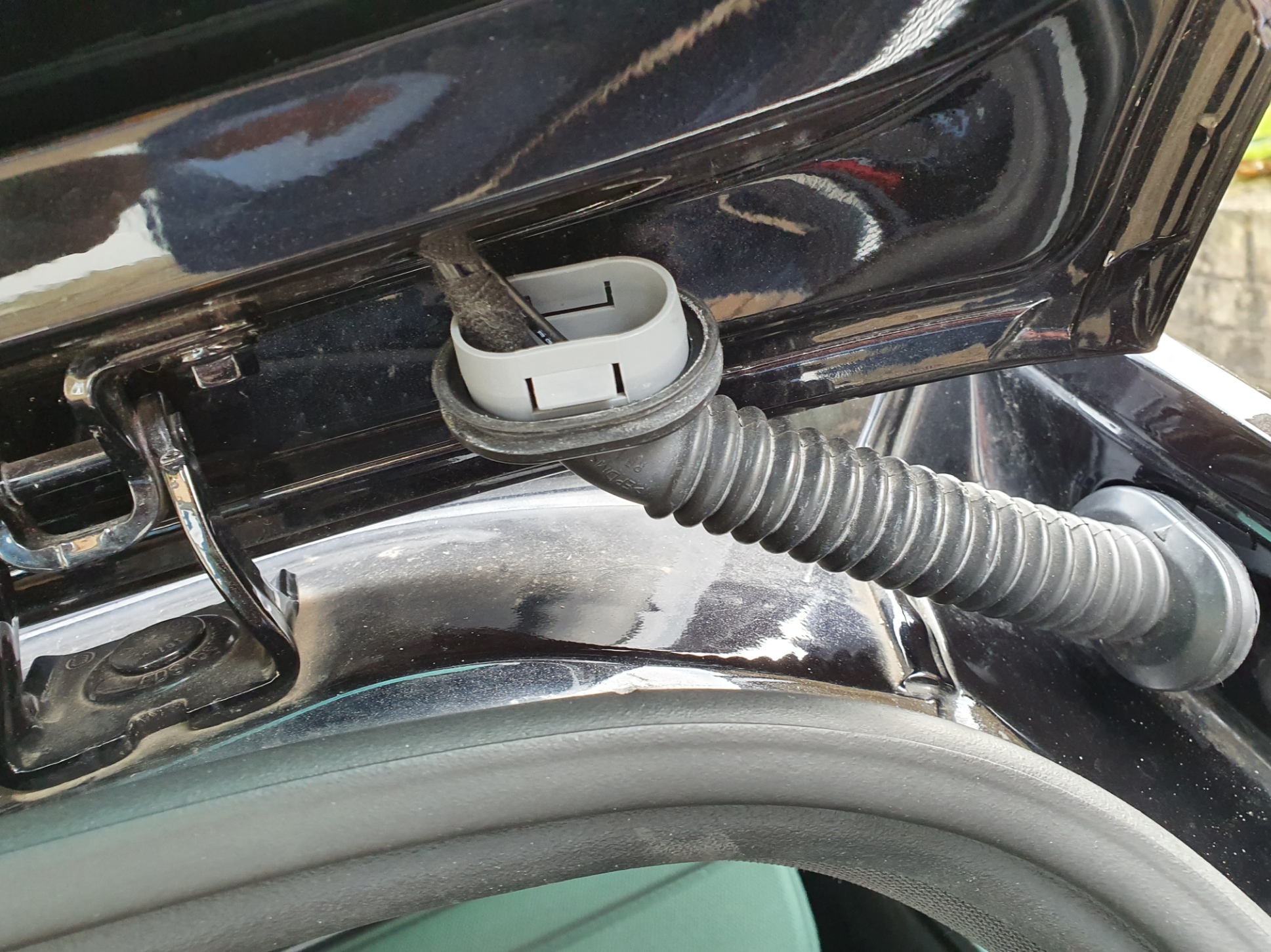

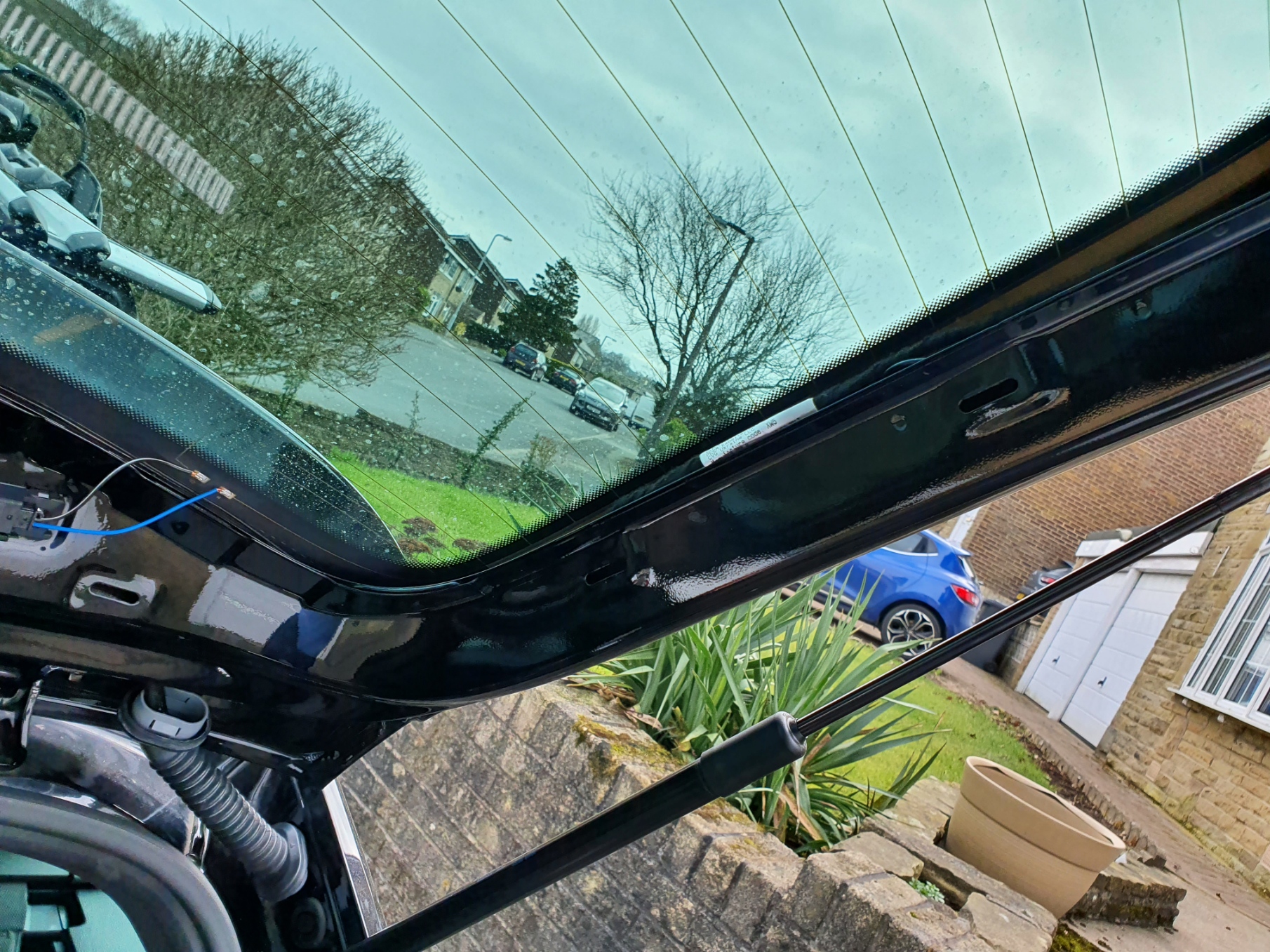

Now what you need to do is get the cable up to that section via the rubber conduit either side of tailgate. I chose the drivers side as a lot less cables in that side, as the passenger side has the rear washer hose as well as cables, so that side is very full. You will need to pull off the opposite D-pillar trim to gain access to the driver’s side and then some more fun begins! You then need to pop the rubber conduit off at both points, just push each end in the middle whilst wiggling and they will come off from the body and tailgate. You then have it like this:
20210307_101247.thumb.jpg.8ca1d3e2cdc23e71f44b387dd79727ec.jpg20210307_101254.thumb.jpg.61cdf8bc9858c3ea42a831e335b423d9.jpg
Then with a long cable tie (or similar) try to route it through from the bodywork end of where the rubber conduit fitted first going down in to the D-pillar, then tape your cable and pull it through. Then you need to get the cable through the rubber conduit, I chose to massage it through as I couldn’t get a cable tie or anything else down as it kept fouling on the rubber. Some videos I watched suggested silicone spray to act as a lubricant, I didn’t have any! Once through here you just use another long cable tie to get it into the tailgate and across to where you want it. On the picture below you can see I have it hanging out of the middle hole:

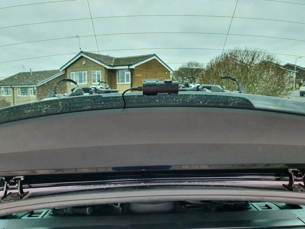

I later changed my mind and moved it over to the left of the two smaller square holes on the left side (the equivalent holes for whatever is mounted on the drivers side, being the heater element control unit I think). From this hole it is a lesser distance for the cable to poke out under the trim and allows the cable to be fed under the trim edge when clipped back on and the trim doesn’t bulge, which I thought it might if I brought it straight out of the middle as the trim clips are close to that. I taped the cable to the washer hose in the middle to secure it. Following this, I clipped the trim back on (bit of a faff, you’ll find a way) I did one side then a slight clip in the middle, followed by the other side, which kind of wiggled in to place, then fully clip the middle and put screws back in. Then slot your lower tailgate trim back on, which glides nicely in to place, remembering it hooks into the upper trim and to poke your lights and tailgate button through (where fitted) and just clip the remaining bits back in and screw in your grab handle and secure your lights and tailgate switch (if fitted). Finally remember to push your rubber conduit back on to the tailgate and body, secure your cable excess possibly in the D-pillar (mines in the roof lining) and clip your D-pillar trims back on and you’re done! Well you then need to position your front camera (if not already done) and rear camera and plug it in. My rear one looks like this and is just within the top of the wiper area:
