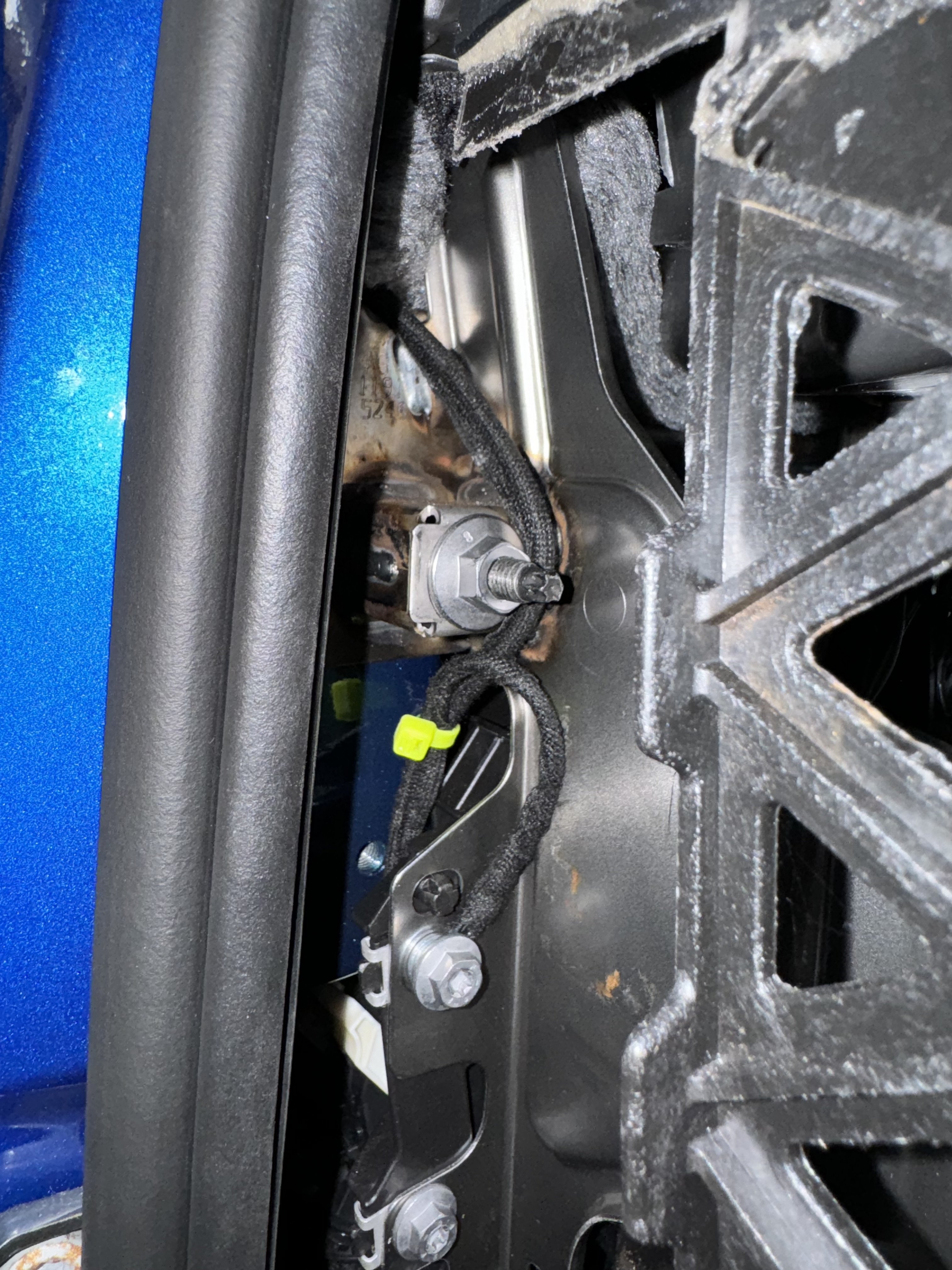

I've attached a photo of the install on my car = it can be a very clean job and only take a couple of hours. I ran it through the front camera housing, and then used a Dremel to cut the hole in the plastic. The part is about £6.50 and it's easily replaceable if you want to reverse it.
In short, you need to find a place on the windscreen for the dashcam, find the right fuse to tap into, find a suitable grounding/earthing point and then run the cable from the fuse box, up to the camera via the headliner and a pillar. The second photo is the grounding location I used - one of the dash bolts.
