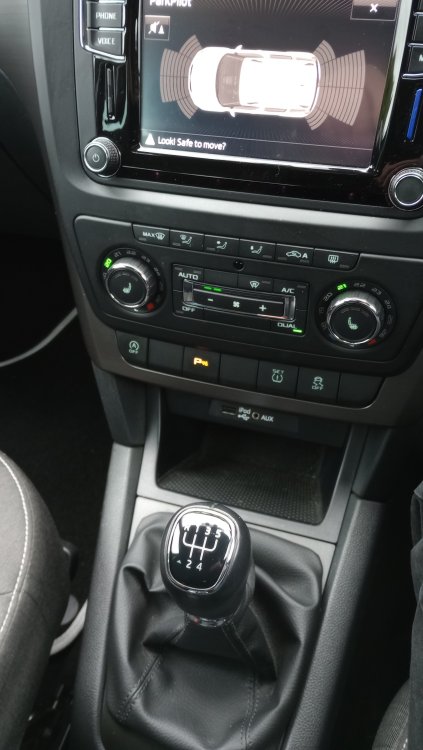

Paul, I have always wired mine up in the fuse box, with a live only when the  ignition is on.
That way it won't drain the cars battery.
If you want the camara on whilst parked up, I would suggest a battery bank.
Just remove the cable from the satnav, and replace with the cable from the battery bank.
You can then recharge the battery bank via your charge point below the radio.
Maybe best to go back to Halfords and ask then to check it and maybe move it to ignition live only.
