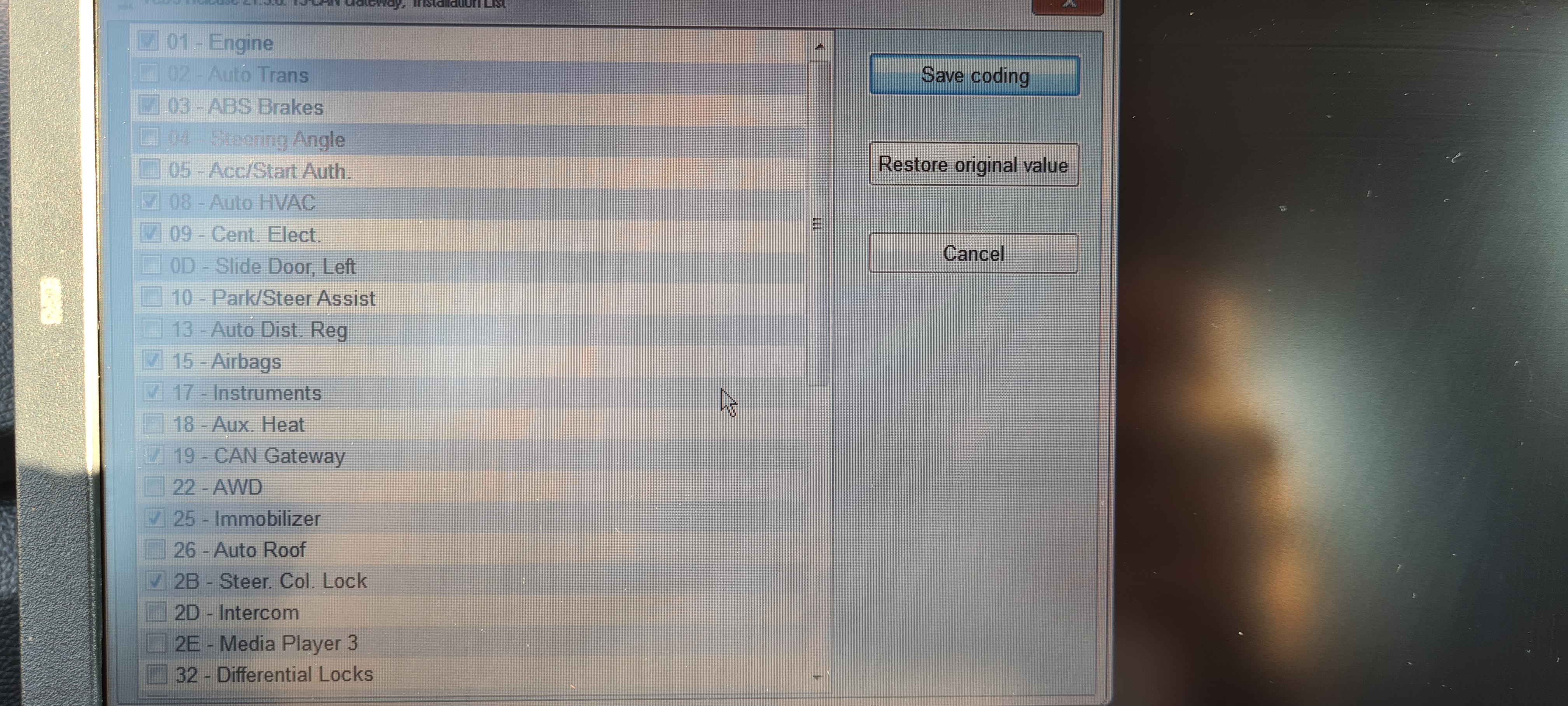

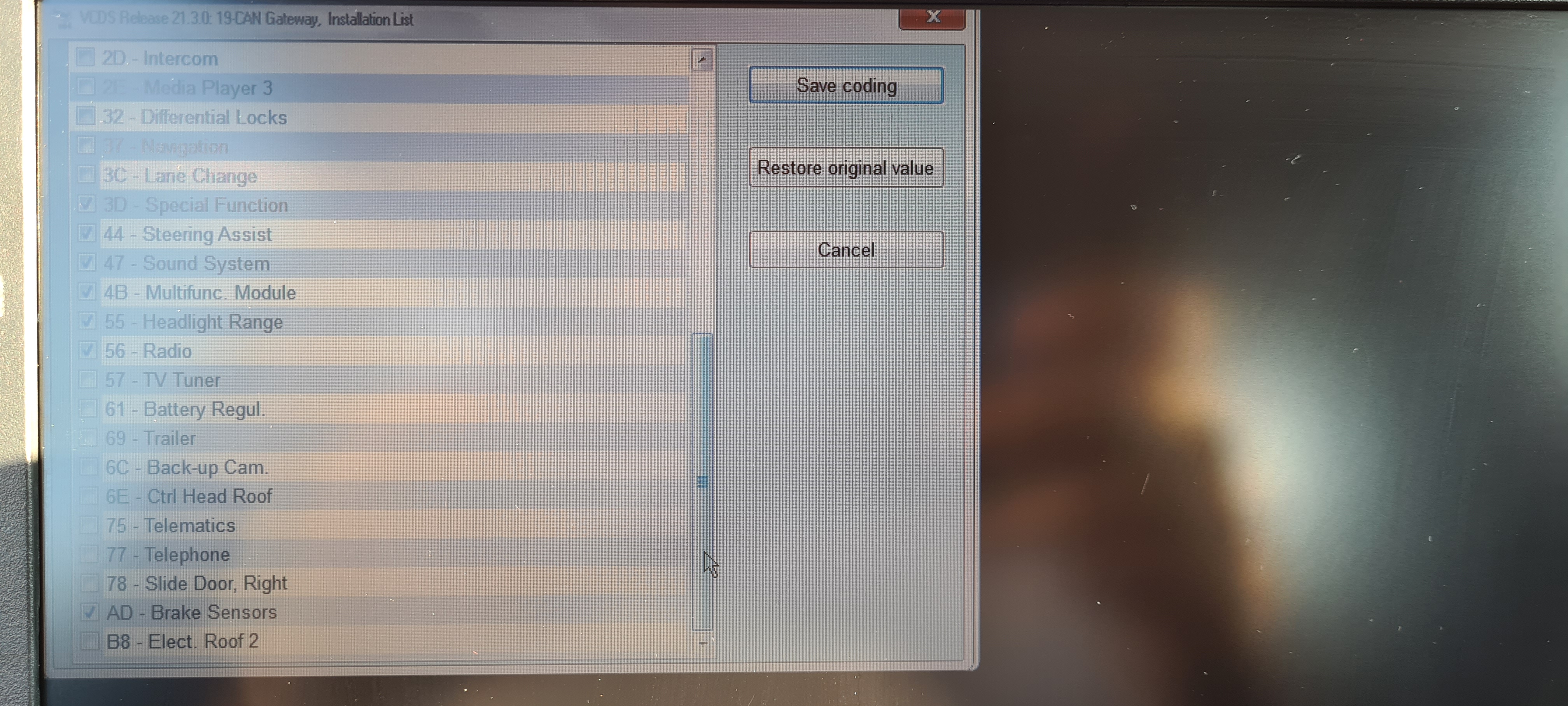

When you get to this screen:
 You need to tick:
04: Steering Angle
You need to untick:
2B: Steer. Col. Lock
3D: Special Function
47: Sound System
4B: Multifunc. Module
55: Headlight Range
AD: Brake Sensors
Then press 'Save coding'. You can make all the changes at once so it should only take 5 minutes.
Once that's done, clear all the DTC's and make a new autoscan and post it as you did previously. Hopefully, that should get rid of most of the remaining errors :)
