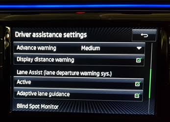

The Superb has two levels of lane assist.
The normal bouncy bouncy version that ping pongs u between the lane markings.
This is just "Lane Assist" active.
Or
The adaptive version that keeps u in the centre of the lane markings.
This is both Lane Assist and "Adaptive Lane Guidance" active.
I've always had my ALG active for TJA, hence I don't know if it will work with just Lane Assist.
TSR is not enabled by default.  U need to enable it using VCDS or ObdEleven11.  Provided u have the necessary A5 Camera.

Lane Assist - this gets you lane assist for nudging you back into lane if you start to wander AND adaptive lane guidance which keeps you centred.
