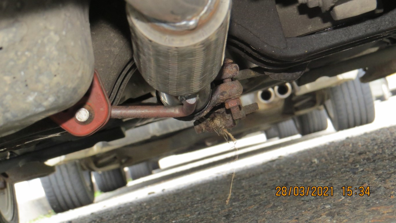

got the front exhaust changed for new one just over a week ago. at first it sounded quiet but yesterday it sounded like it was blowing in the same area.

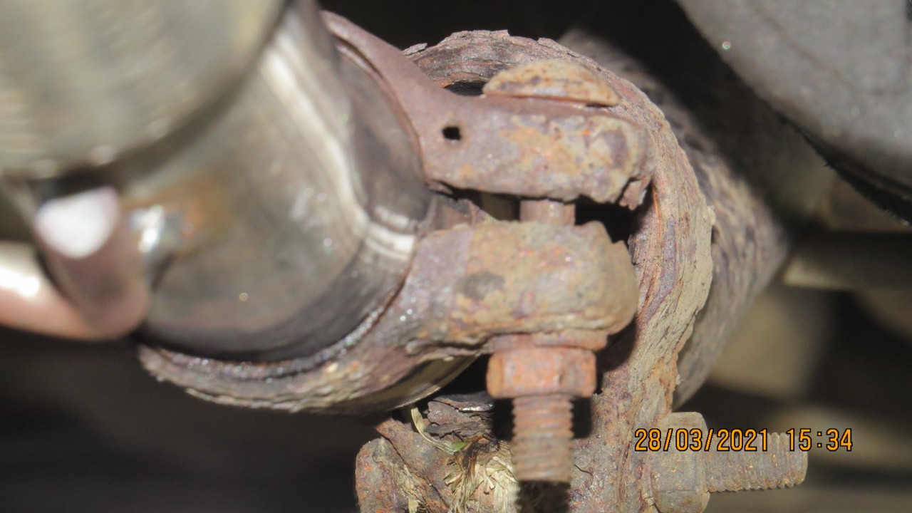

    Re-using that original clamp was very, very optimistic if a leak free system was intended.

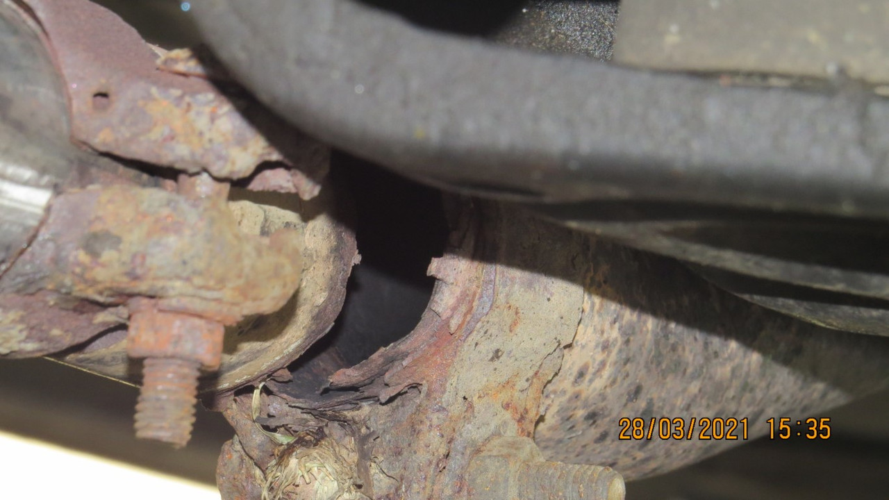

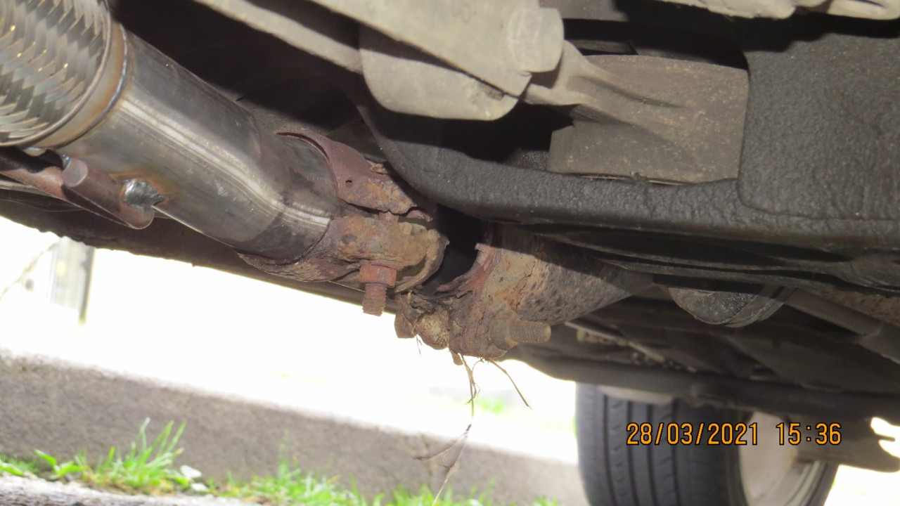

i maybe looking at this wrong..................but is it not the connecting part sheared off the next section of exhaust.....it's been "stressed" since fitting the new bit and has given up the ghost.
You need a new "next" section going back.
Edited by UrbanPanzer
  • Sponsor
They butt end to end within the clamp if both parts are original design. Isn't it the sleeve that's snapped in half?  Will look at some more of the pics.
Edited by Wino

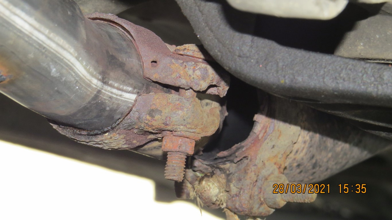

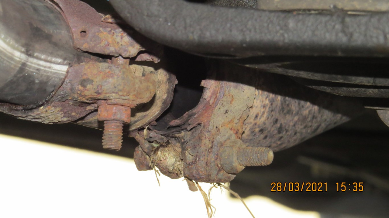

Pretty sure the last few pictures posted by the OP show a massive hole in the exhaust?
In between the two parts of the clamp.
  • Sponsor
Yeah, cos the clamp isn't holding the ends together any more!
On the plus side, looking at the last few pics I would say you have definitely found out why the new exhaust is loud :D

The way I see it, for that hole to appear/happen, something more than a joining sleeve has failed, as said already, the pipe inside these joining sleeves should have almost butted up and these sleeves are extremely strong, it is only the 2 clamps that rust through.
So, again, as said earlier, it looks very much like the next section of exhaust has failed, I'm surprised that your mobile spanner swinger left your car in that state, advise your friends to avoid him and take that car to an exhaust place because that job looks like to be well out of the scope of a new joining sleeve and a tube/tub of Gungun.
