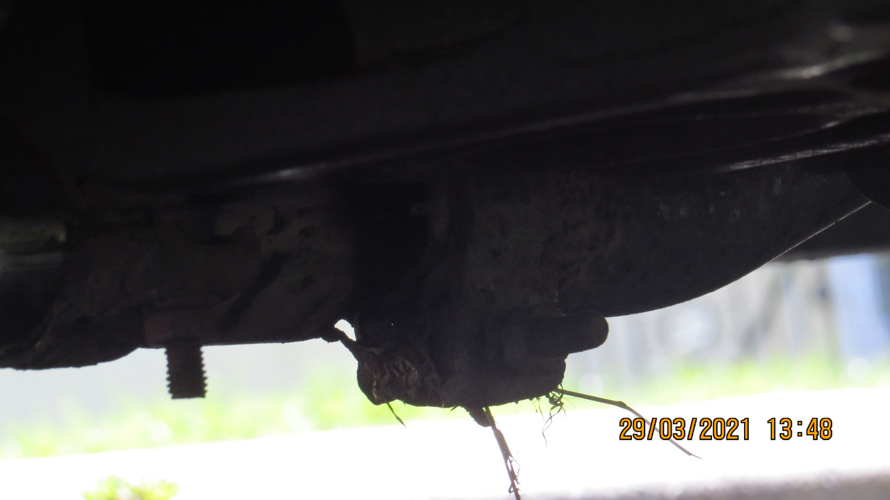

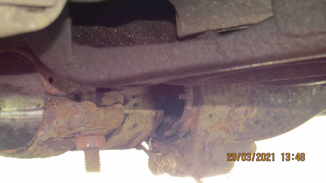

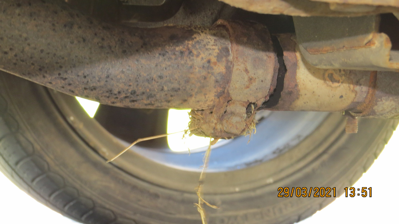

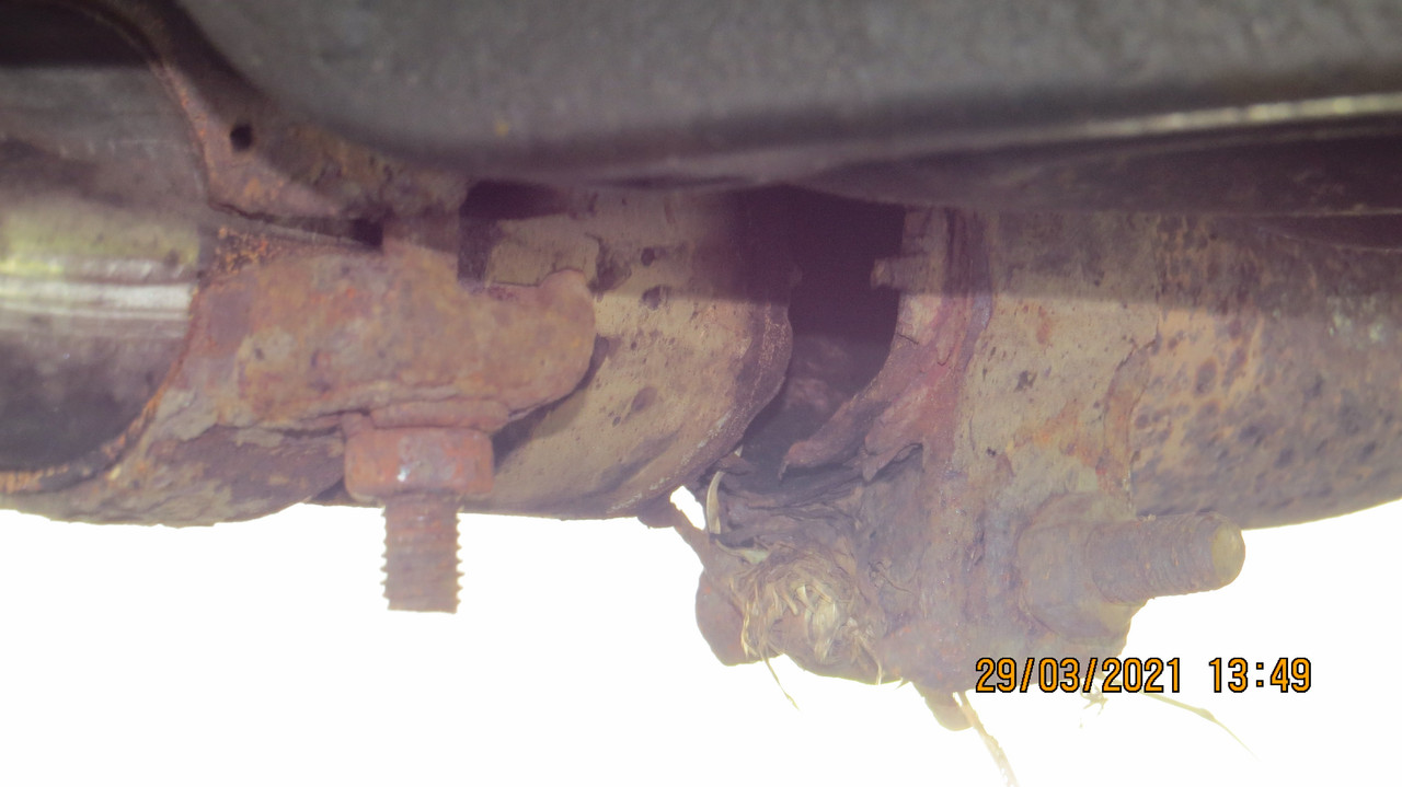

Can you see the end of the pipe that's in the back half of the broken sleeve clamp? I can sort of maybe see part of the end of it in one of your later photos, but none of them show it clearly.
Trying to clear up this debate about whether it's just the dual sleeve clamp that's sh@ itself or if the front end of the middle exhaust section also has some damage.
If the mid-pipe is the original I'd expect it to be much more solid and intact than the sleeve clamp.  Try to get a close-up photo with flash on.

here you go
pictures as requested
didnt jack the car up so its best i can do, hopefully you can see what you need to see

Still not 100% sure from those.
Will have to get the old sleeve clamp bits off completely to be sure I think.
The collision with the ground that picked up the debris may have been involved in the destruction before your mobile fella got involved. Why he didn't suggest replacing the sleeve clamp I have no idea.
