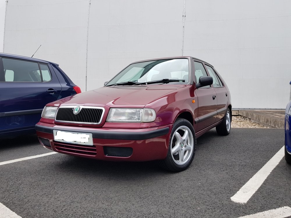

Well looks like I am going to spend more than the cars worth but like I said it is worth a lot to me any way when did you see a nice Skoda Felicia on the road pic was taken a few years ago but it still looks very good. 788882730_MySkoda10-sep-2017.jpg.81d1090217497f417c1ac11b7a5e54c5.jpg

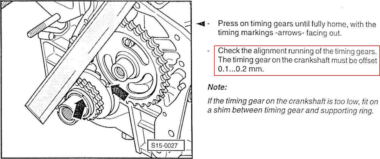

VIKA chains last about 15,000 km. It is because the poor quality of the steel they are made of. Typical cheap Chinese stuff.
Use whatever chain you can get your hands on (except VIKA) and don't forget about the two sprockets being level. It is very important if you want the chain to last about 70,000 km.
