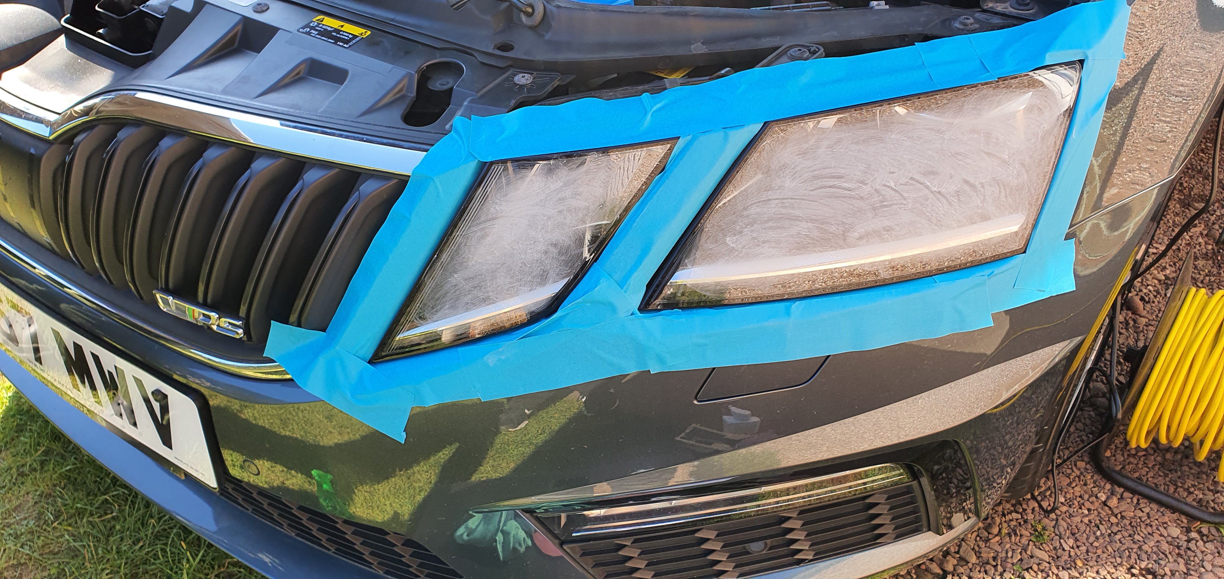

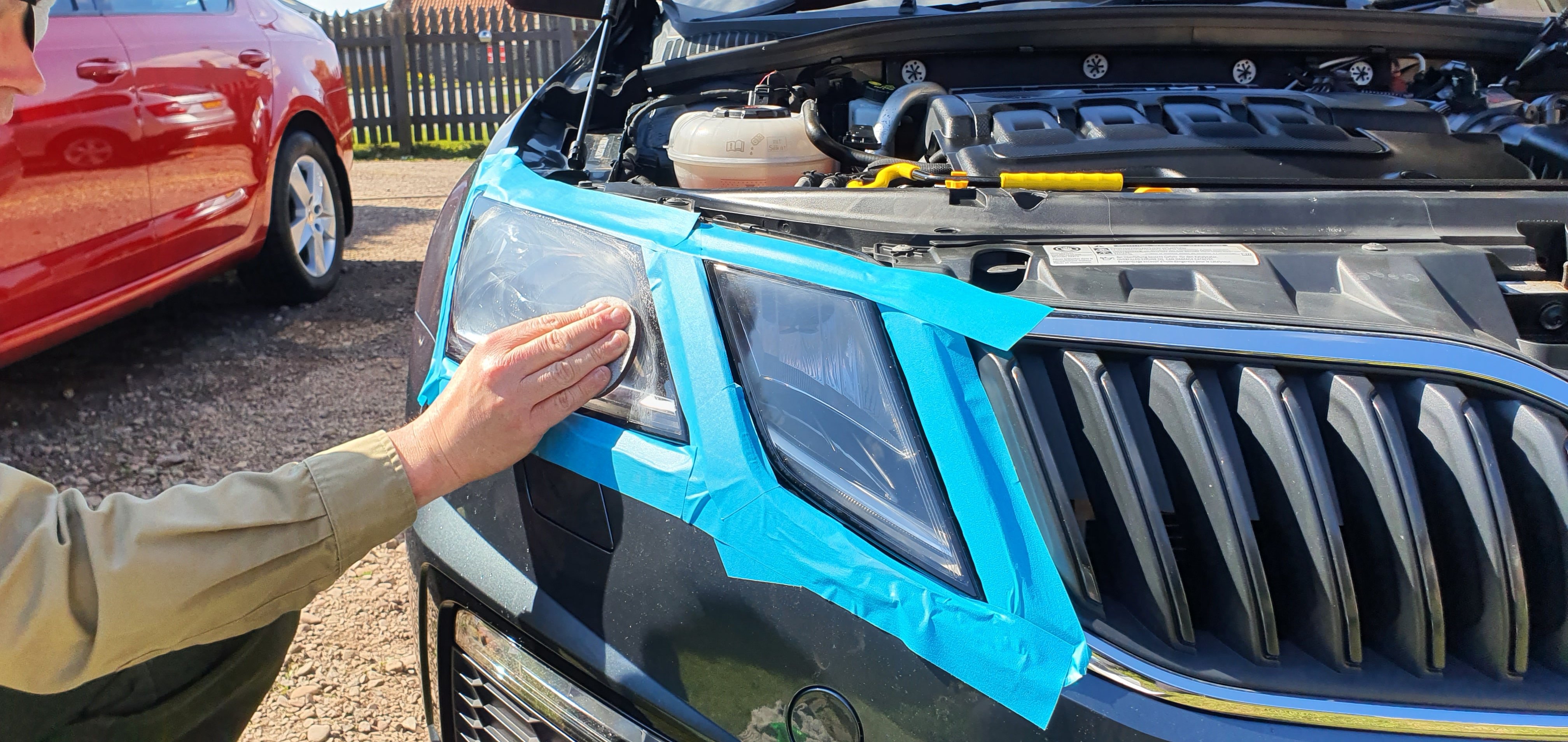

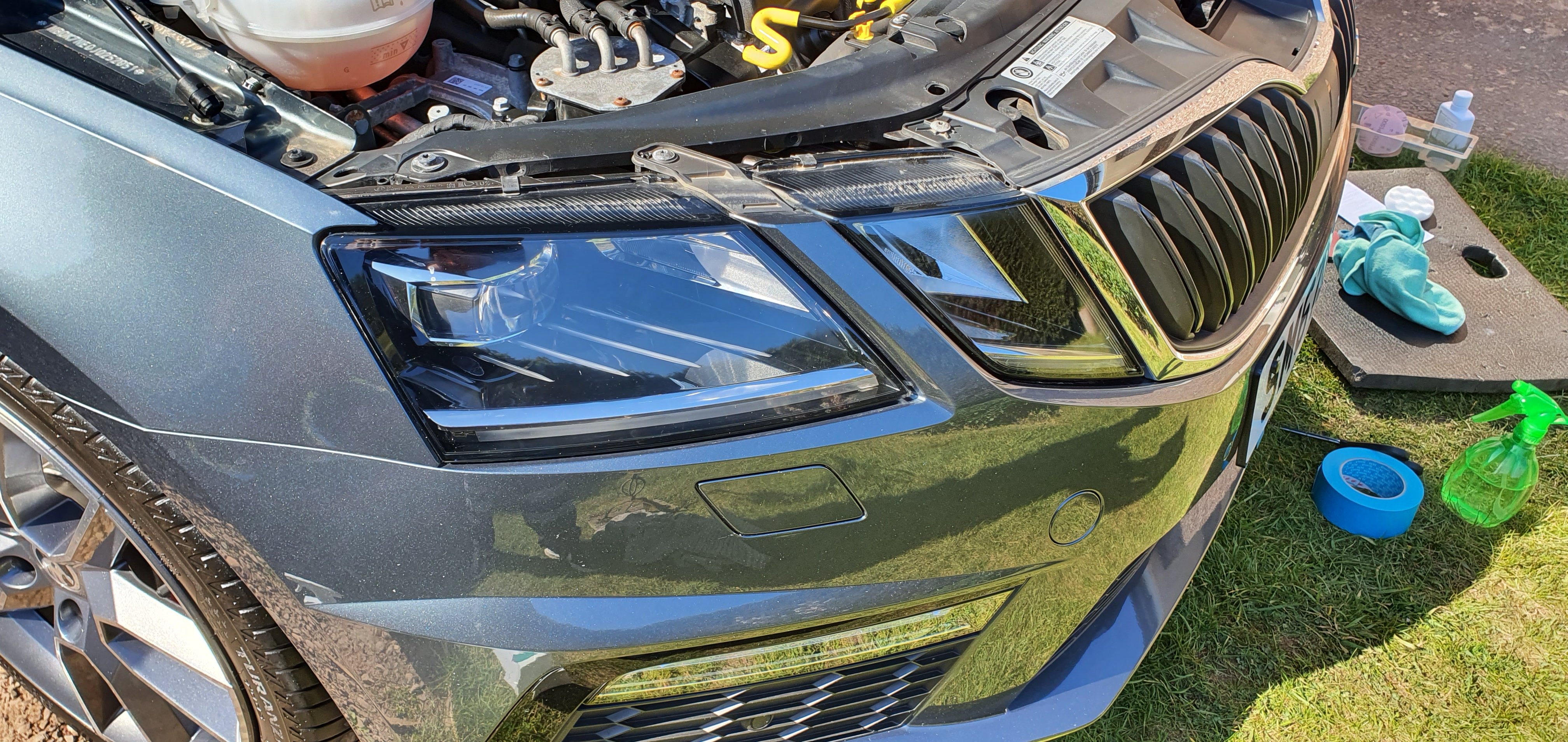

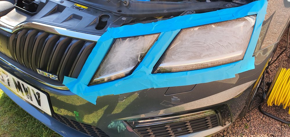

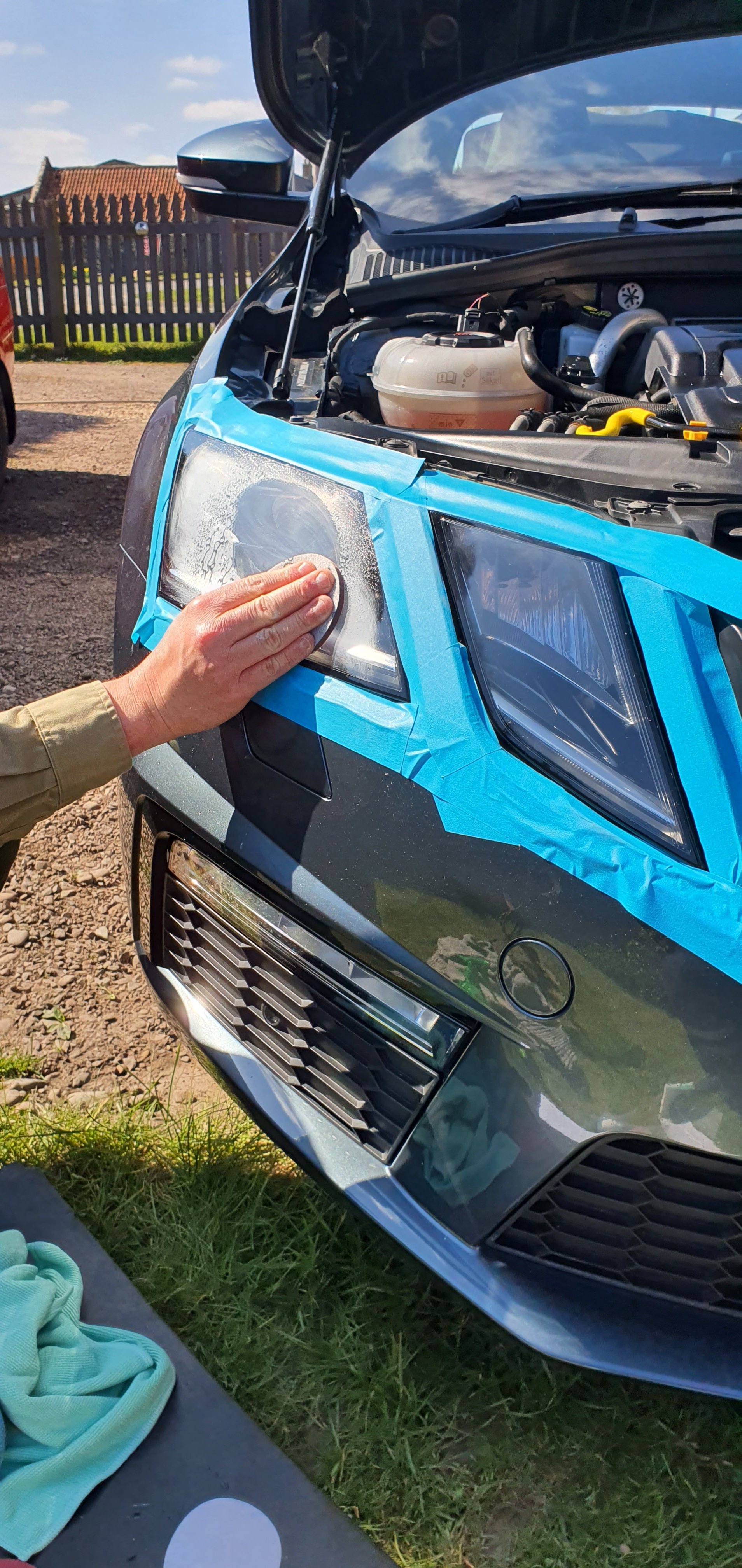

Headlight Restoration
As usual, I'm using Autoglym products and their Headlight Restoration kit. You don't need a drill especially on a FL MK3, but you will also need plenty of masking tape.
Husband decided to try it out. It was hard for me to photograph this but the headlights seem to have suffered from one too many Car Washes.
The principal is that you have to use low grade sandpaper first working up to a very fine grade/grit sandpaper.
Most of the fine scratches are now gone on the headlights. Here are some (scarry) photos whilst it was being done.
