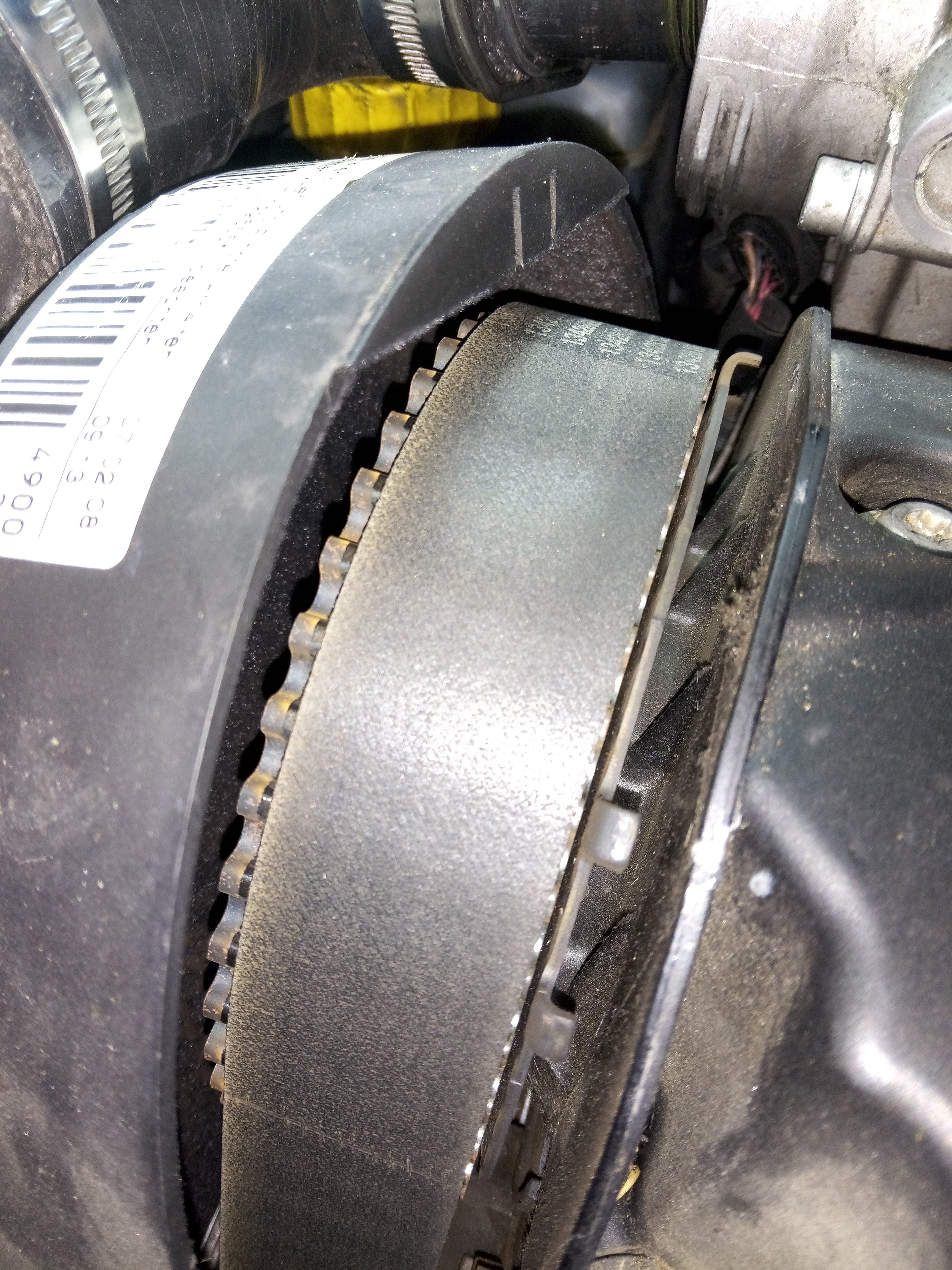

No one's going to go against manufacturer's guidance. This image is a 7yr old Fabia pd cam belt about to be changed, 38k miles after last change. Overdue on time (by 3yrs) The belt is smooth, no cracks, fraying as yet.

Its the underside of the belt that should be scrutinised, preferably where it takes a reverse curvature around the tensioner, any cracking at the root of the teeth is more apparent that way.
Exactly this, I see the image is of a 7 year belt on a pd that is a bigger risk as pds are know to be harder on timing belts.
Could someone post a guide, image or video about how to be able to see the top of the belt like in the pic above? Is it simply a case of pulling the cover to one side in the octavia?
