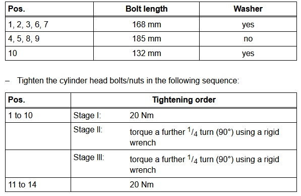

Haynes has this to say about the cylinder head bolts and nuts:
Cylinder head bolts: Stage 1 .............................................................................................. 20Nm
Stage 2 .............................................................................................. Angle-tighten a further 90°
Stage 3 ............................................................................................... Angle-tighten a further 90°
Cylinder head nuts................................................................................ 20Nm
So the bolts get two sequential quarter-turns after the 20Nm stage.
The nuts just get the single torque to 20Nm.
I seem to remember there are different length bolts in some positions too, so be careful not to muddle them up.
Thanks as always for the advice guys :)
Yeah, and washers under certain bolts.

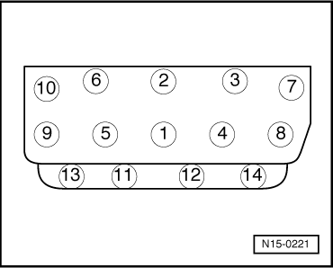

Tightening order....

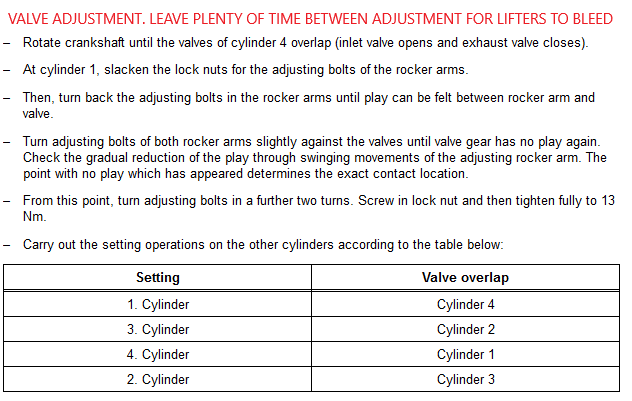

Tappet settings (they are hydraulic but have an initial setting procedure)....

Yes ive got it booked for a head skim on the weekend must admit though im a bit concerned about this setting the valves im worried its a bit past my skill set lol :(

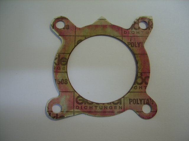

Cheers tmb ok last question i promise lol any idea where I can get a new throttle body gasket from cant find one anywhere ???
If you are stuck I have a very good genuine used one you can have for nothing. Just let me know.
I cant find one anywhere mate tbh I wanted to do it straight off but could not find one let me know bud I don't mind paying you for it 👍
