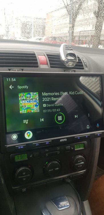

I have seen a few posts about Chinese head units and if they are worth it. Because of this I wanted to tell you about my experience. I own a Skoda Octavia 2 (2008) and last year I bought a Chinese head unit "ATOTO SA102" for 160€ off Amazon. This year a new generation was released, and I wanted to give it a try. The head unit is called the "ATOTO F7 PE" which stands for Pro Edition. It was about 225€ on Amazon DE (https://www.amazon.de/gp/product/B08V5G4PBB). The Standard Edition is available for about 200€. I really wanted to try out this head unit, because it was one of the cheapest ones out there which had Android Auto and Apple Carplay. I personally only have an Android phone, so I'm only talking about my experience with it. I have used it for about a week.
Installation:
The installation for me was okay. I needed to get new holding brackets for the head unit as the ones included in the box were not compatible with my vehicle. After getting the holding brackets my next challenge was getting the USB cable from the back of the head unit to the front of my car. I needed to purchase a separate frame to fit the head unit after I had removed the original one. The head unit included a few wiring harnesses which could be used. Unfortunately I needed to buy a separate one for Skoda. After a little bit of drilling and taping the USB looks great. (Check the picture above) The ATOTO F7 has a floating display which looks awesome. My old one had the display embedded in the frame. Installing the floating display to the head unit was very easy as it had a lot of adjustment options. The display can be moved forwards and backwards and it can also be tilted easily. This felt much simpler than I expected.

- The USB wire attached cannot be removed from the head unit. This will make the installation quite a pain in some cases. In my car I needed to take the whole front plate off and push the wires out.
- The holding brackets included in the box did not fit my vehicle at all and I needed to get new ones on my own.

In conclusion the touch screen feels responsive and fast. Also, Android Auto feels a lot faster while changing apps compared to my old head unit. If you have any questions let me know. Many people only trust the most popular brands, but after my experience I would fully recommend trying the Chinese ones as well. I personally like it a lot more than the original one I had when I got the vehicle ;)
Not exactly integrated is it?
Looks like most new cars that have a tea tray stuck to the dashboard, was there not one available with a VAG faceplate to replace the stock unit?

Hello, thanks for your reply! :) I attached a picture of my old head unit. Personally, I like this "floating" display a lot better but of course it is just a personal preference. Great to hear that you also had a nice experience with your Chinese head units.
