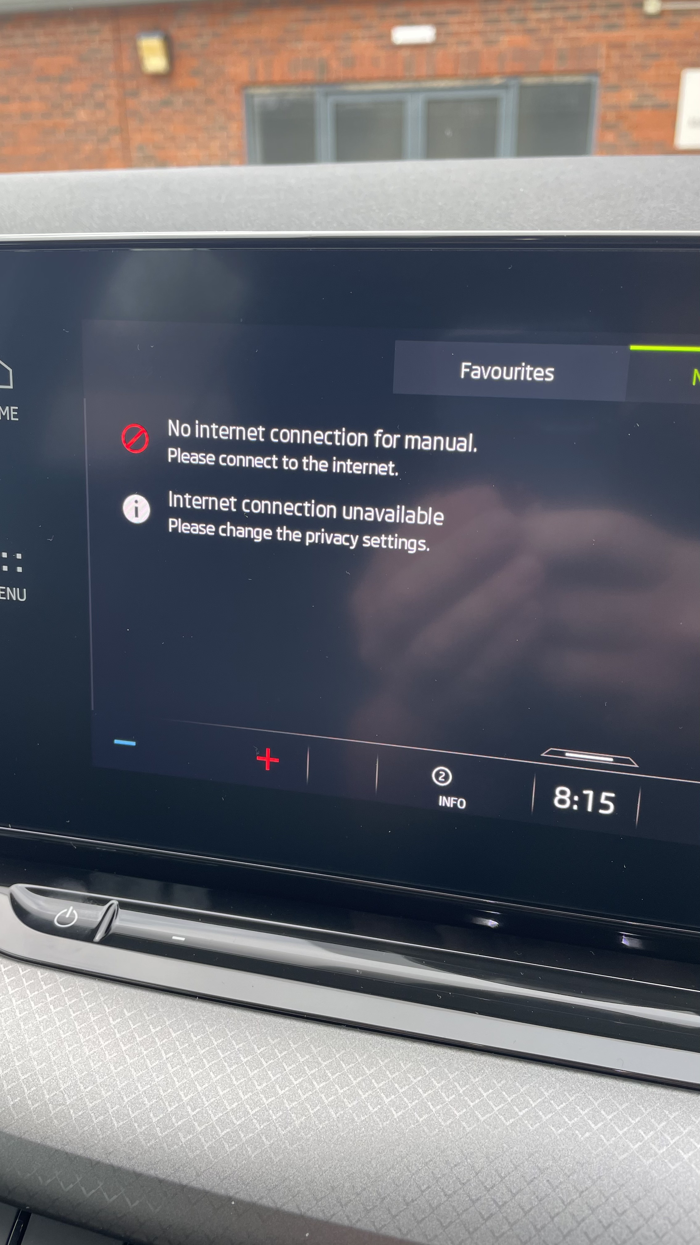

Any one else suffering from the car not having an internet connection? I have tried everything and looked at every ‘privacy setting’.
I even resorted to messaging Skoda UK who even after a few suggestions couldn’t help.

My isn’t syncing with the phone app, nor is it allowing me to use the online Satnav functions.
I'm in then same situacion. In the car, the skoda connect icon has been gray for 6 days and the mobile app does not refresh the data.
I wonder if it's a problem with my car or with the skoda connect servers.
