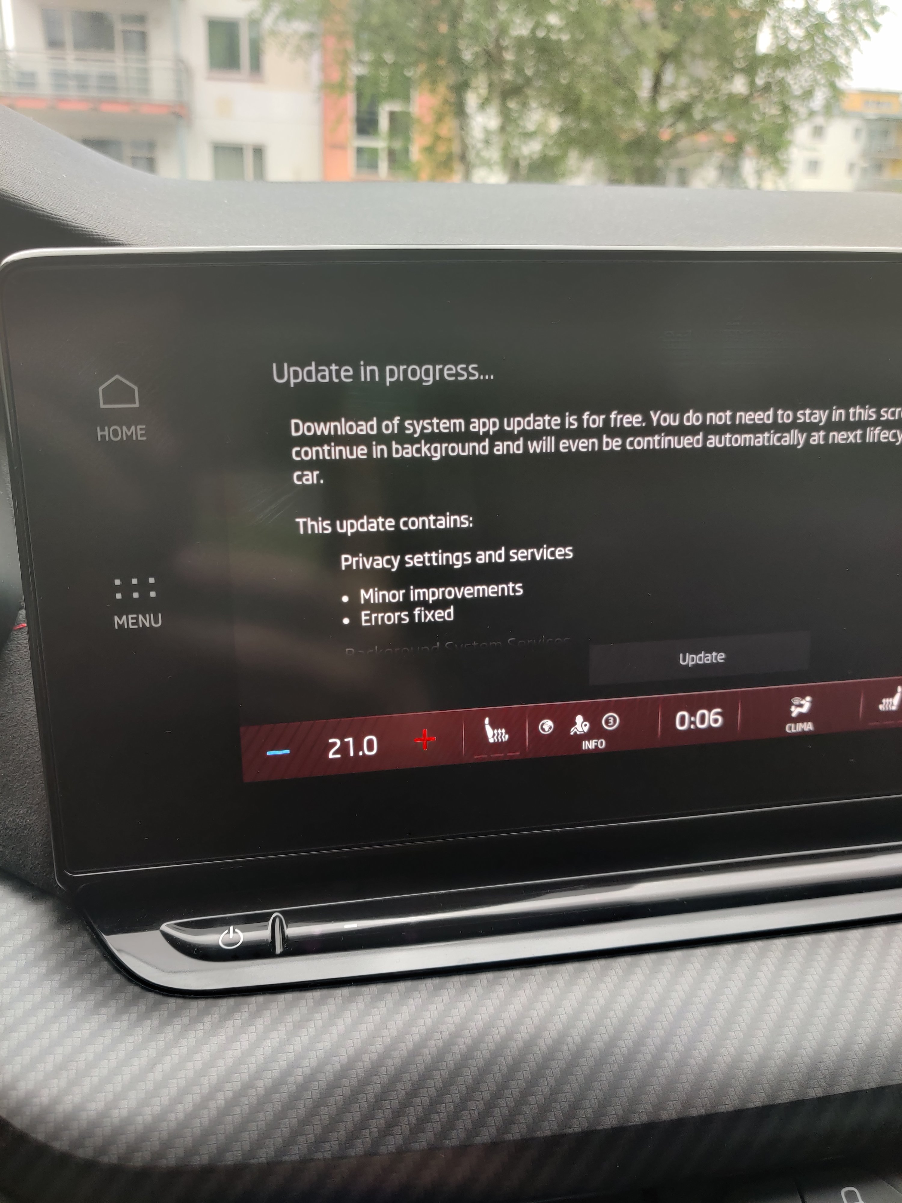

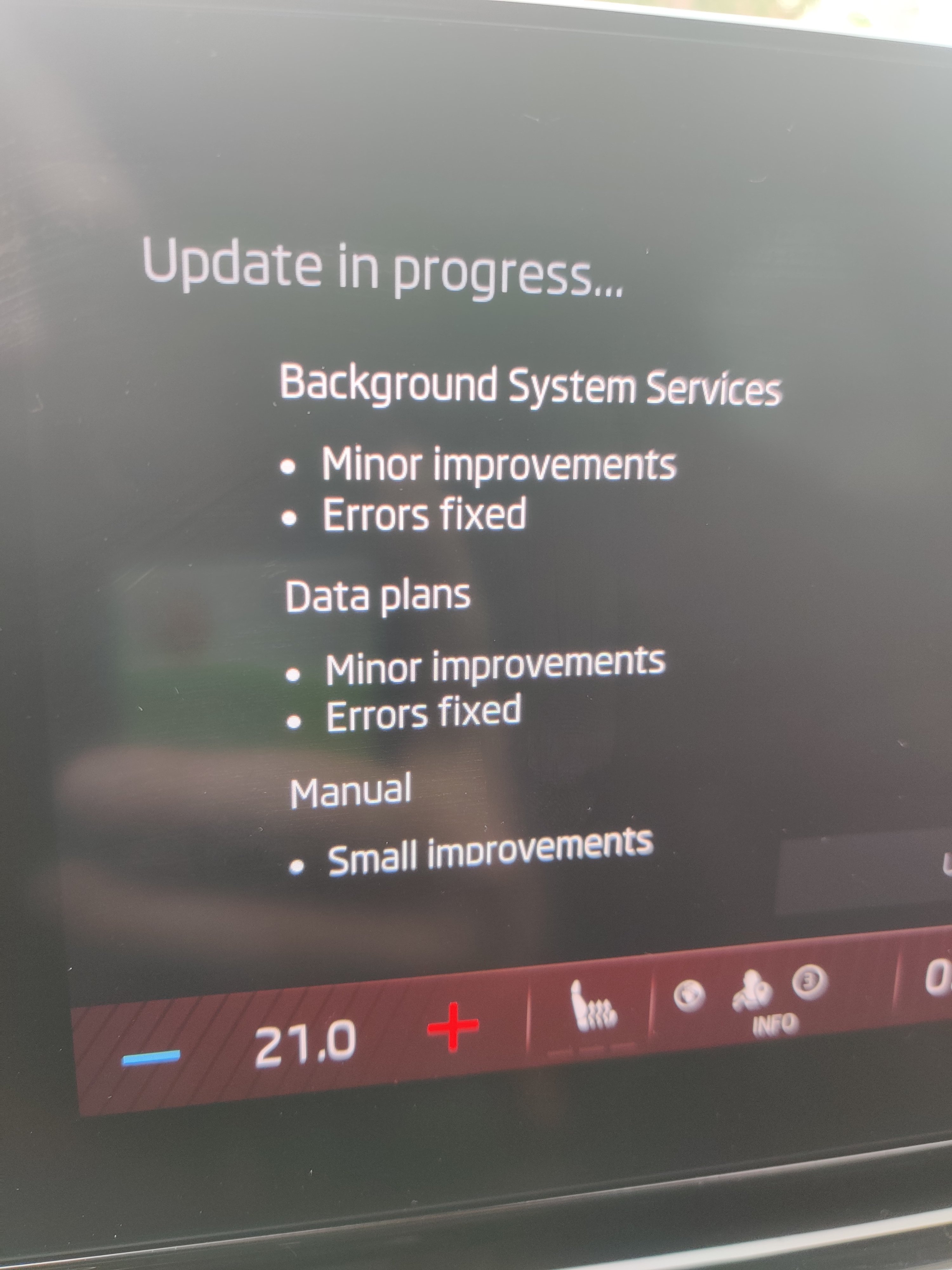

got some update straight away, details here:
If i will lose internet again i will share that, hopefully this fix will solve internet issue
