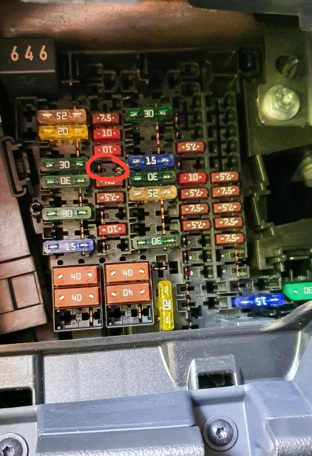

  • Hi.   As I received no reply from the dealer I pulled the fuses this morning. All ok now and back to normal. Greetings from Portugal and thanks for the love for the Costa Vicentina from

    Good morning,   I try to take out fuse nr. 19 again and wait till SOS went offline (red). I put it back and on start it didn't change anything (garage) then I took a ride around the town and

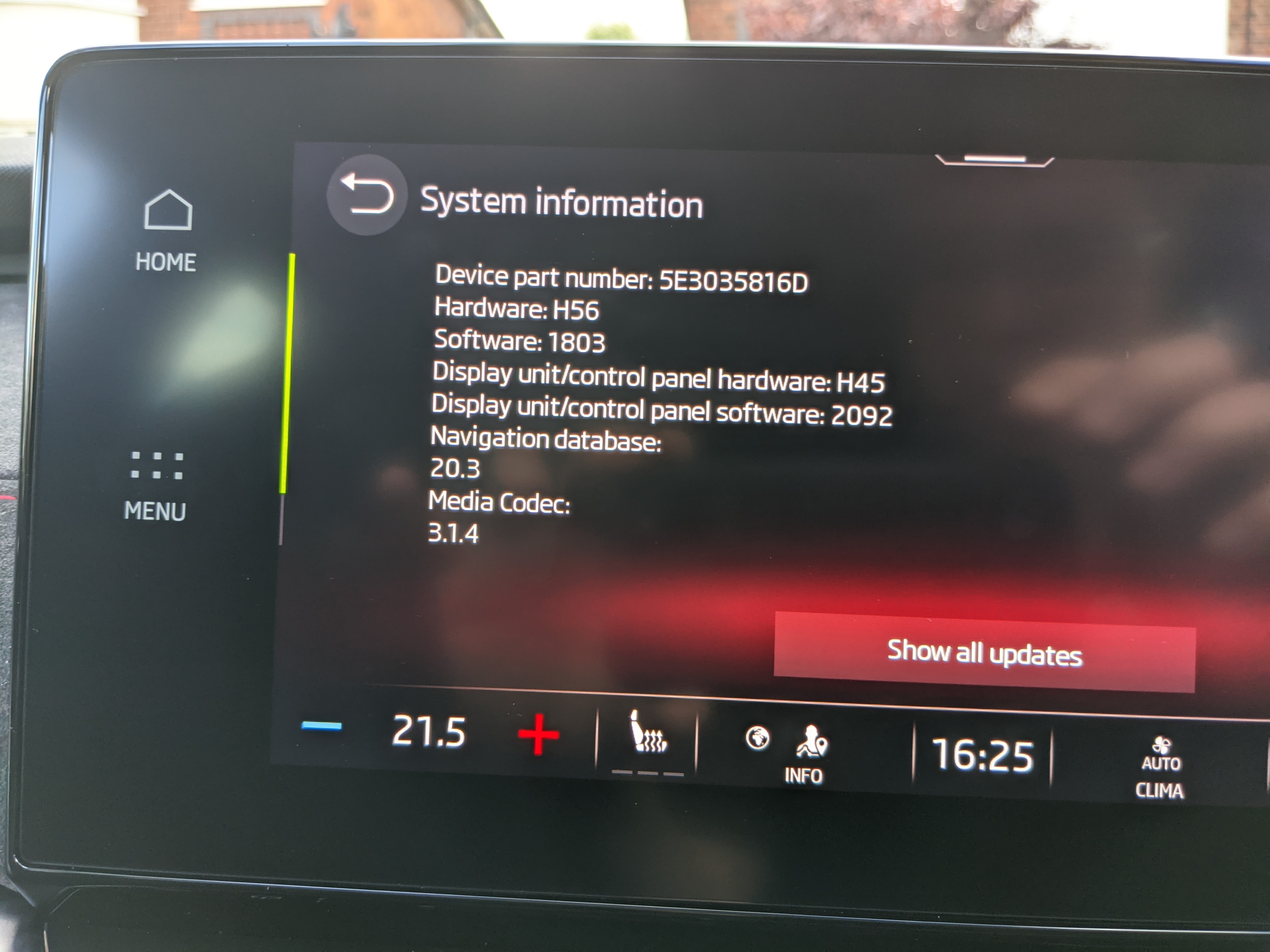

I got in touch with my dealer regarding my connection problems (do not have any other problems for the moment), there is a major update registred for my car/infotainment. Booked in for upgrade on May 28.
I have a D version with software 1788, however, the dealer said they never know what faults it will correct, the just do the update. Fingers crossed...

Most probably you will get the 1803 version. :thumbup:

I picked up my new vRS a few days ago, where internet connection was greyed out, SOS was red I think and Skoda connect didn't work either. I left it a day or so to see if it was minor and whether OTA updates could resolve (didn't obv). Courtesy of this thread, fuses 19 and 30 were taken out for 10 minutes fixed the connectivity issues, but now I have a airbag warning light on lol!

Hi, back from the dealer. Huge dissapointment. They had done some research and my update was only for Clima. Update is called 90Q9 and it did not included any firmware updates, still on 1788. However since the FW 1803 seems to have the same problem with connection to Internet I have to wait.

I would says this internet issue has nothing to do with the general SW version of the cars. I have the 1788 version and since the last fallout about two weeks ago, my internet connection has been just fine.

Had the same problem.. after 2 days I decided to remove fuse and re-atach back and problem is gone..
There is no need to wait for 10 minutes - I waited about 30 seconds..
SW version 1803.

My car was only a month old when this first happened but I wouldn't worry about taking fuses out, you replace fuses if they blow anyway so it's not like you're not supposed to access them.
I've now had to do this about 4 times, neither Skoda or the dealer give a ****, they simply tell you there's not a problem, the servers were probably down blah blah blah!
The connection drops so often that I'm even considering adding an extension so the fuses are in the glove box itself and they're easier to pull when needed.
