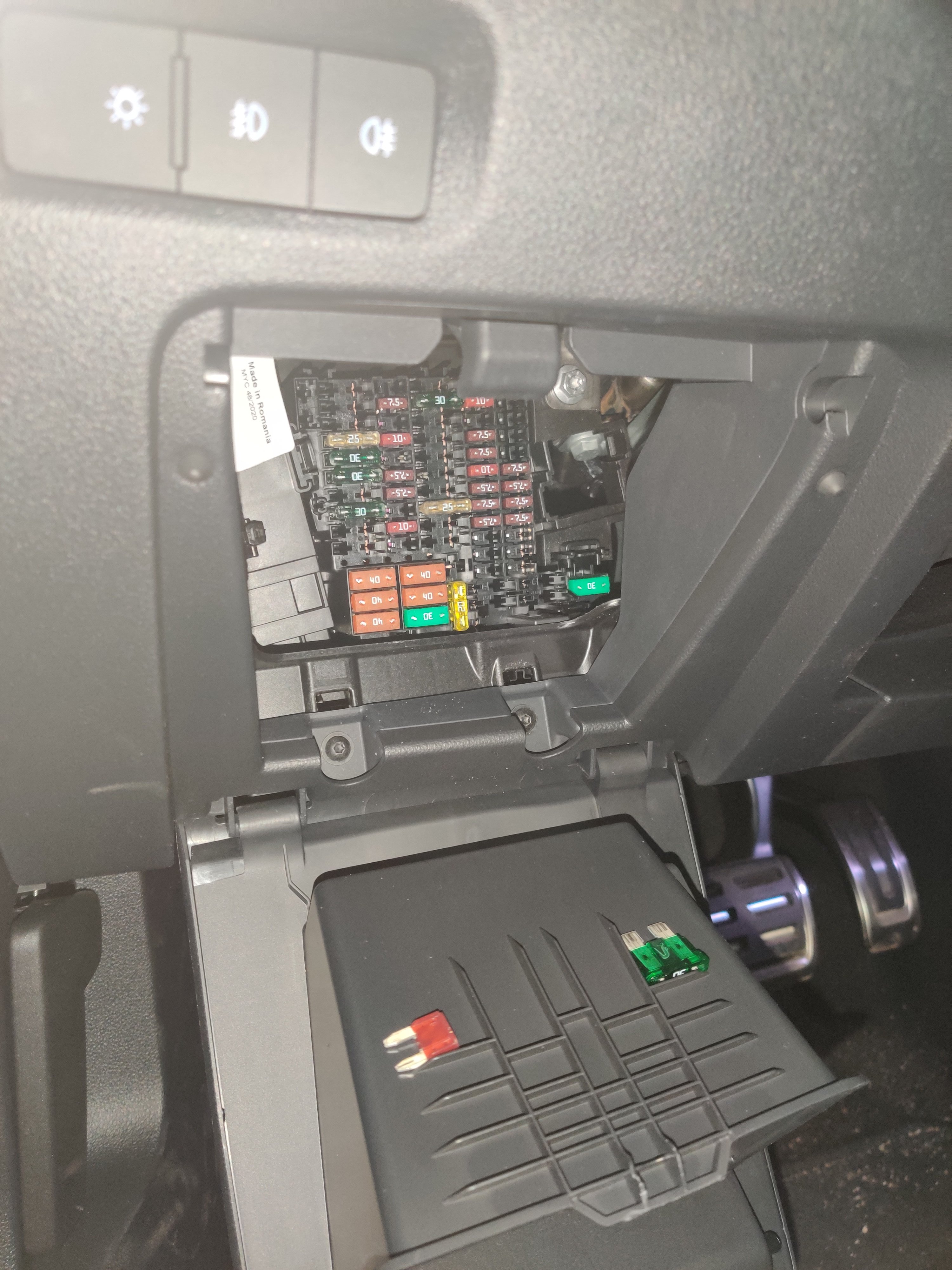

  • Hi.   As I received no reply from the dealer I pulled the fuses this morning. All ok now and back to normal. Greetings from Portugal and thanks for the love for the Costa Vicentina from

    Good morning,   I try to take out fuse nr. 19 again and wait till SOS went offline (red). I put it back and on start it didn't change anything (garage) then I took a ride around the town and

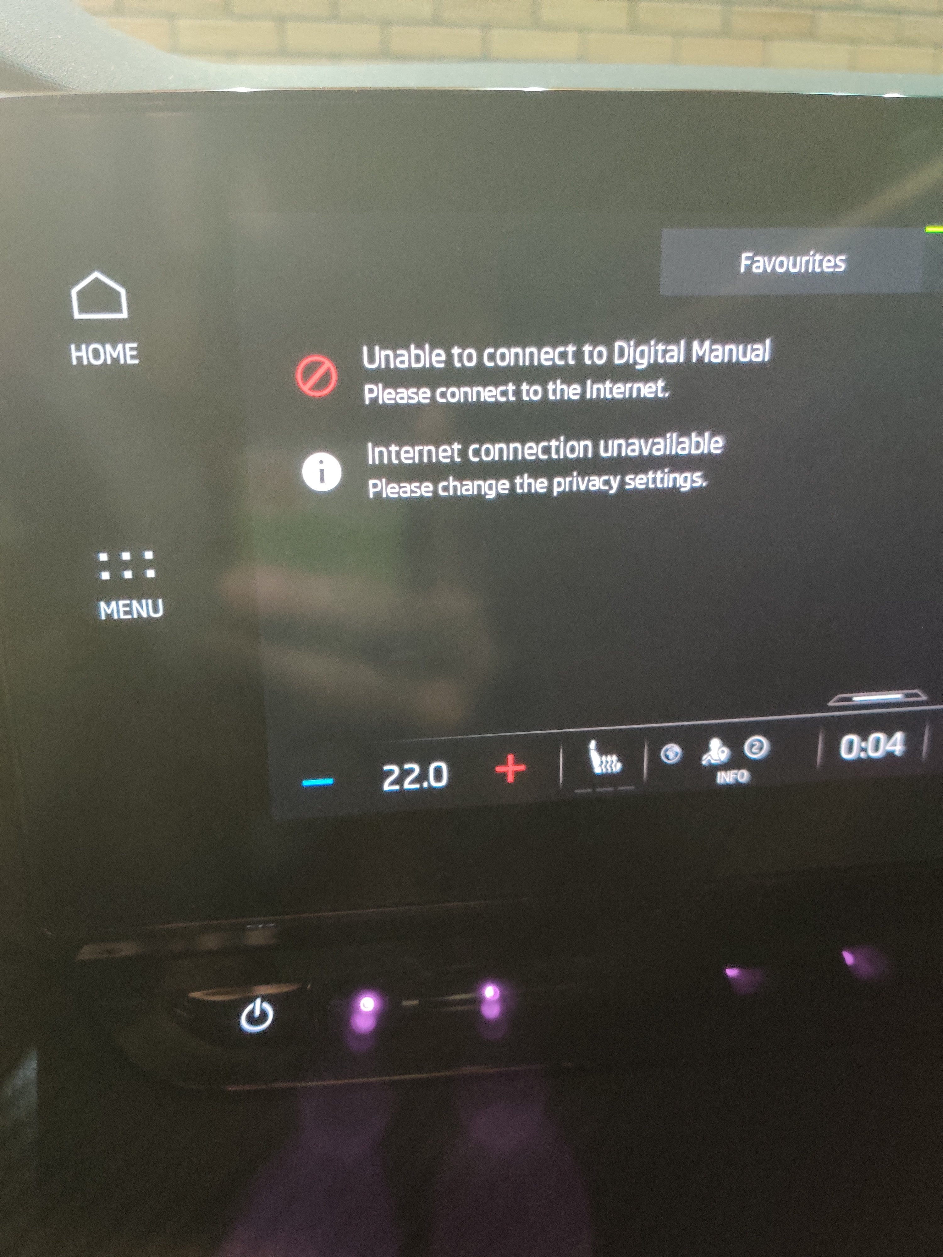

Same problem again with me, plus cannot load primary user... Probably, this is some Skoda server issue, as some other forum members suggested in some ither threads...
Let see when it starts working again
I also have problems with grey logo aswell, so i have no traffic data on may nav.
Also had to log in as primary user yesterday so i think this is something up with Skoda servers.
Didnt try yet to unplug the fuses though
Same situation in Spain.  It's the second time it happens to me, first one a couple of weeks ago was fixed after some days. Then it's been working for a week and yesterday I've got the same consecutive steps you seemed to have, first the primary user didn't load, no internet.  After a couple of hours I was able to load my primary user but still no internet. I did open a case towards Skoda Spain since the first issue, no official response yet, though.

Same here. The globe icon is grey. Couldn't login with my skoda account. But I don't have any messages about "no internet connection" or similar. So looks like a bit different issue than last time.
Normally I get the message if I try to synchronize my user or do something that needs internet connection, otherwise it's just the grey icon.

How do you do the process? Meaning as far as I remember every time I'm at the car something is switched on in the virtual cockpit. Do you force a switch off or wait for "x" minutes before pulling the fuses?
I removed the two fuses (position 19 and 30). I left the car for about 10 minutes, replaced the fuses and the infotainment restarted.
I was then able to log in to Skoda connect
I was referring before pulling the fuses as normally the car is all lighted up (virtual cockpit, the display) as soon as you get in and stays like that for quite some time (I've never waited long enough for it to shut it down)
As soon as you pull the fuses the dashboard and display are disconnected.
