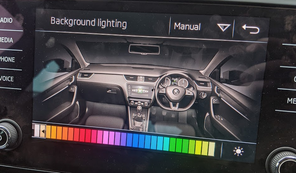

The goodies that you can unlocks sound interesting! What's comfort entry? I'm assuming the 30 colour lighting allows you to utilize a wider array of colours than the standard predefined ones?
It slides the seat back when you open the driver door and brings it back when you close it.
30 colour palette
ahh no way! that's pretty cool, I like the idea comfort entry too. Shame you're so far from me.

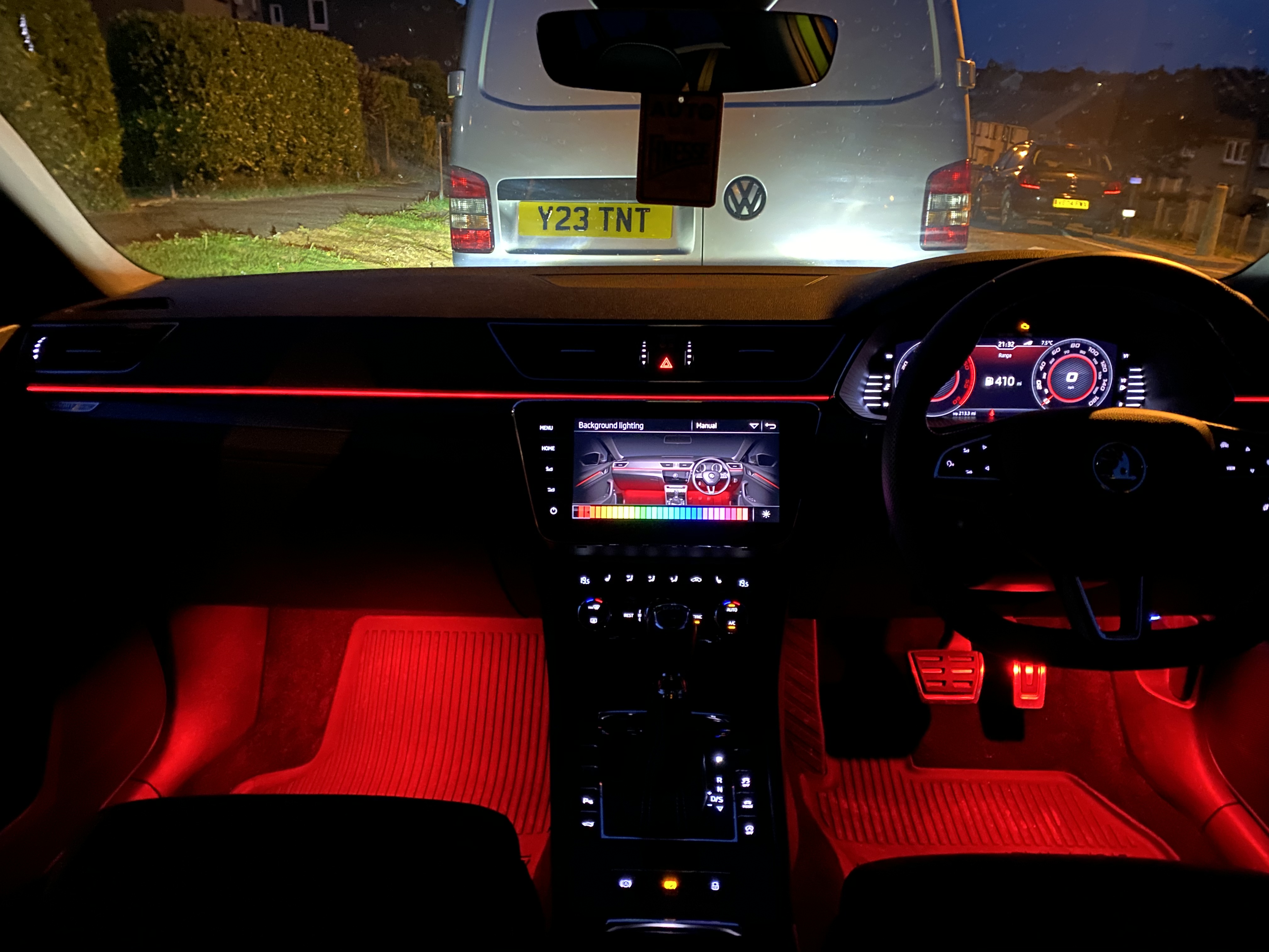

30 colour palette
Are your footwell lights the same colour as the led strips?
Or is that just an effect on the display?
From memory I can only change the brightness of the footwell lights, not the colour
I'm pretty sure they're just standard lights. Mine has the LED pack, so has white LED's as opposed to halogen bulbs, I can change the brightness but that's it.
I am able to fit colour changing floor lighting. That is a clients car, mine is being pulled apart to fit tomorrow. Pics and info to come.

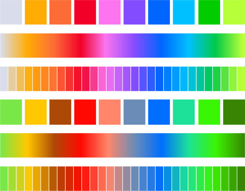

VCDS is what VAG-COM used to be called. In LIN 2 some of the greens may need the blue toning down so make sure they are set by eye.

Thanks @SashaGrace
Ahh right, every day is a school day! So by amending/adding these entries, you'll be shown the 30 colour pallet instead of the default?
I'm assuming these above are specific RGB values for each colour option?
Edited by Hdsn555
Yup and yup :)
Assuming you have 10 colours at the moment, the 11-30 adaption channels will be set to 0. As soon any are non-zero, it should use all 30 rather than 10.
TBH, it's a bit of a pain to do this via VCDS as you need to change each adaption channel separately
- If you just want the colours on the headunit, that's ~90 changes
- If you have ambient lighting and want them to match, that's ~180 changes
If you have the 'automatic' option, that's another ~5-8 changes to correct the preset for each driving mode too.
When I did this, I made my own colourset by interpolating the extra colours between the stock values:
I think I used VCDS scripter to help my sanity but it still needed a little bit of hand holding...

Thanks again @SashaGrace, a local member has been able to create a script to implement these changes, similarly to what @langers2k was able to do.
@Ivan8192 kindly provided me with the 10 original values, I pulled the values into Illustrator and built a gradient from them, I then took a sample at incremental points to create the 30 colours. I understand there are different colour values for the ambient light and the screen, hence the two gradients.
I'm waiting to hear on how Ivan gets on testing on his car to see how they look but hopefully they offer a wide spectrum of colours, that are balanced. Will post back once I hear back.
