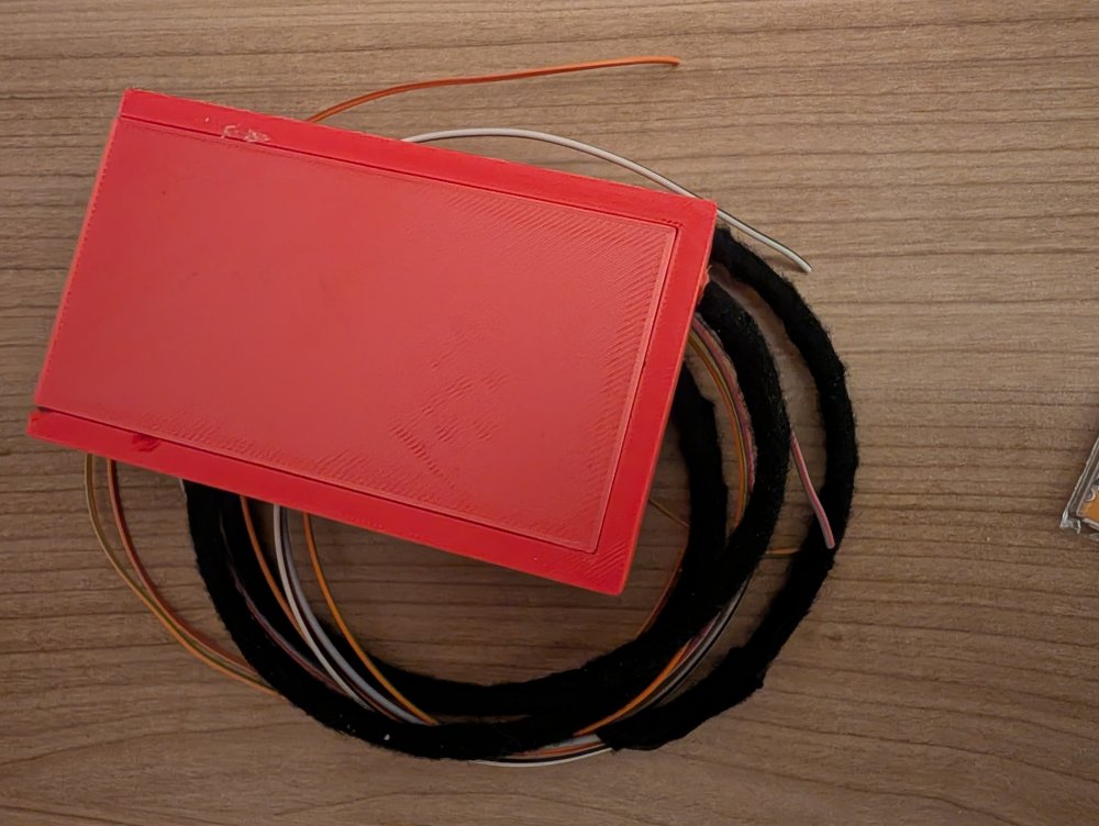

I built my own module which is freely configurable. I also deactivated the start/stop function. Material costs were €15-20.
