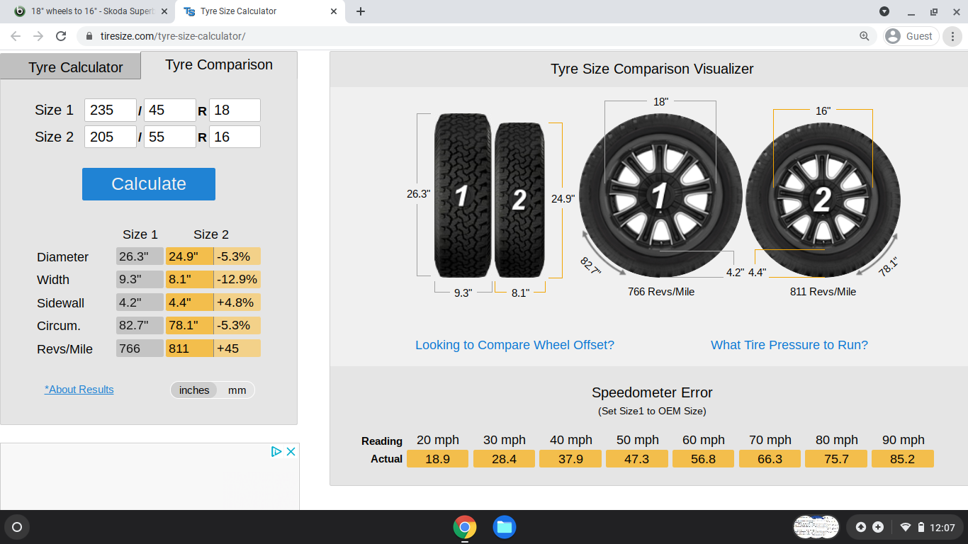

By fitting the correct tyres to have the same or very close to the same Rolling Circumference / Diameter when the wheels are different diameters / widths.
https://tiresize.com/tyre-size-calculator
Edited by e-Roottoot
