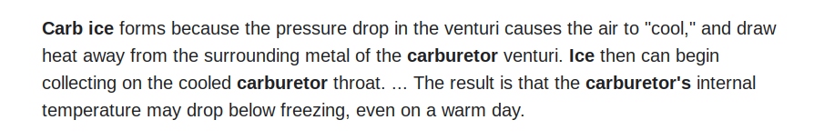

Why carburettor icing occurred on cars.
Latent heat of vaporisation and pressure drop across a venturi.
The same could happen with headlight washers, not so much the pressure drop but the evaporation of the volatile screenwash cooling the liquid. Any nozzle in an airstream will act as a venturi, its how a pitot static tube works and the freezing of them have been responsable for aircraft disasters.

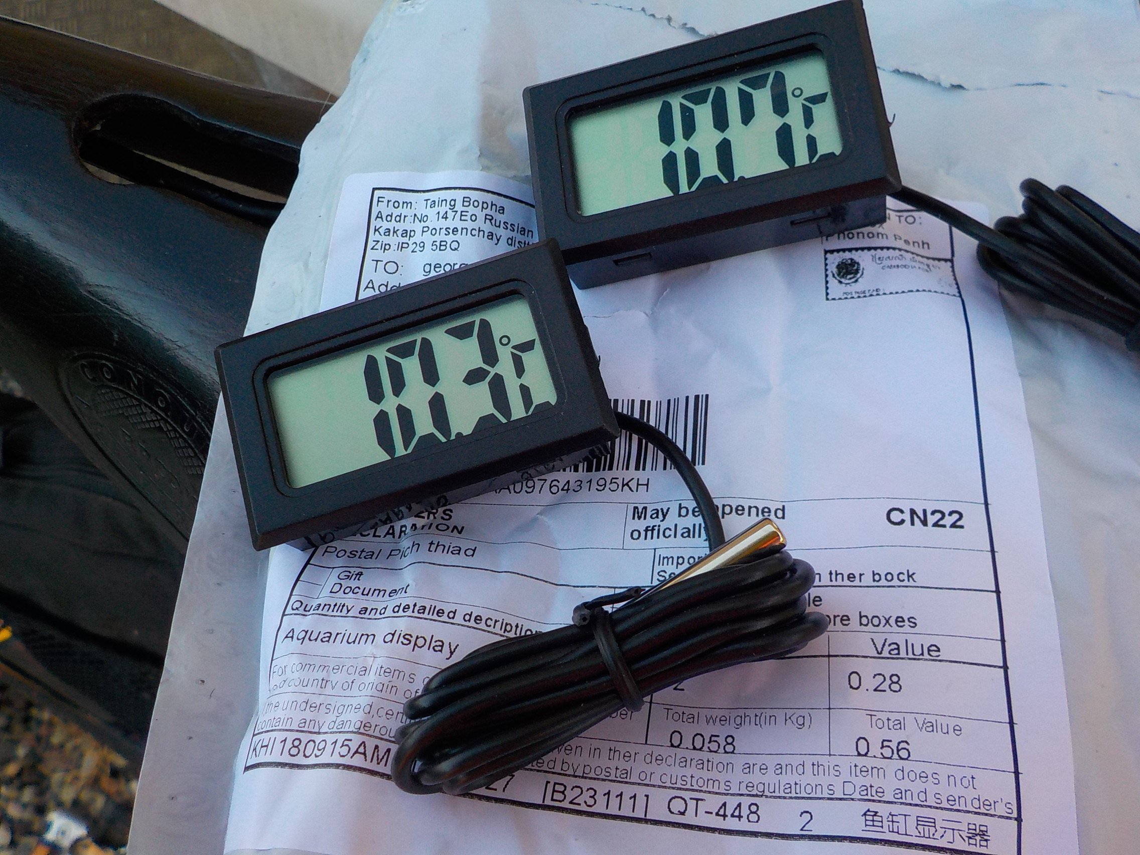

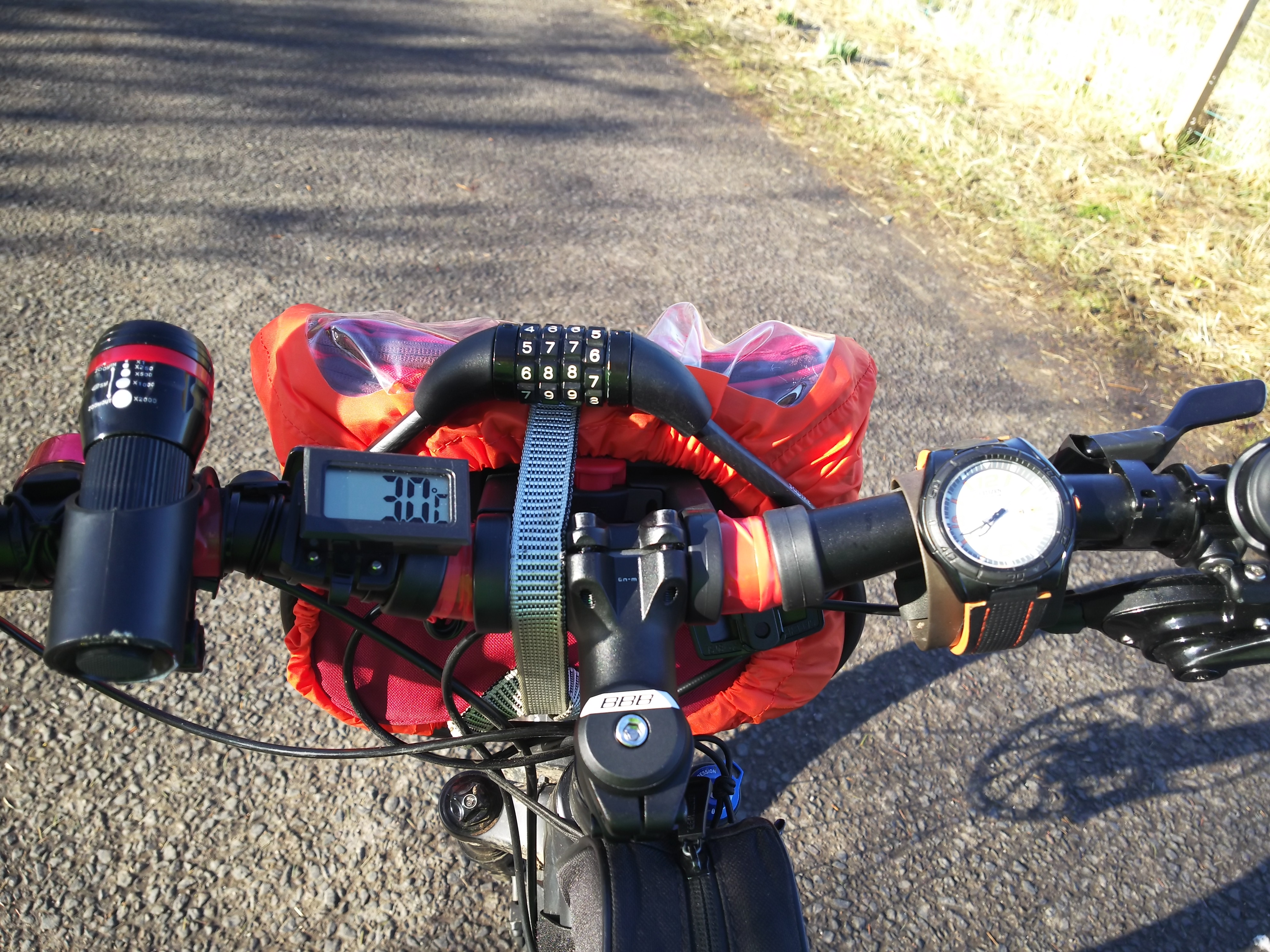

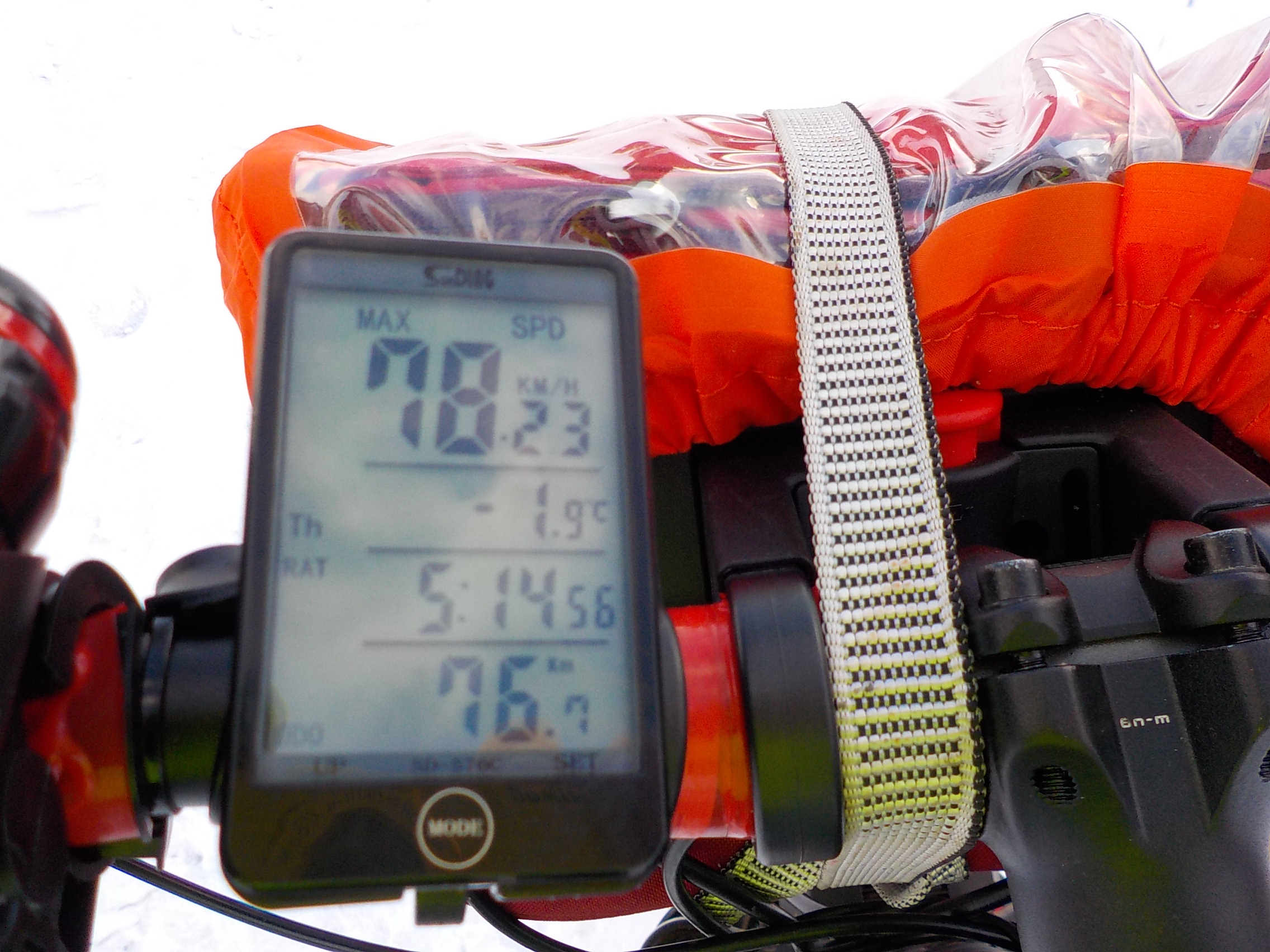

@KenONeillThis winter or even before i would like you to get a thermometer, take the air temp, and fasten the thermometer to the front of your car or bike.
Then drive, drive or ride as fast as you dare, and stop and read the temp on the thermometer.
Done it, and you know what - The gas laws don't apply to thermometers. They do apply to liquids and gases though.
