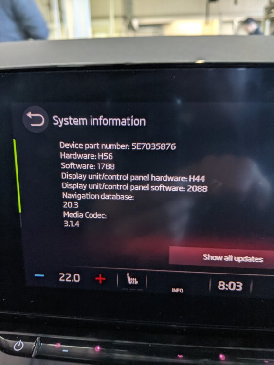

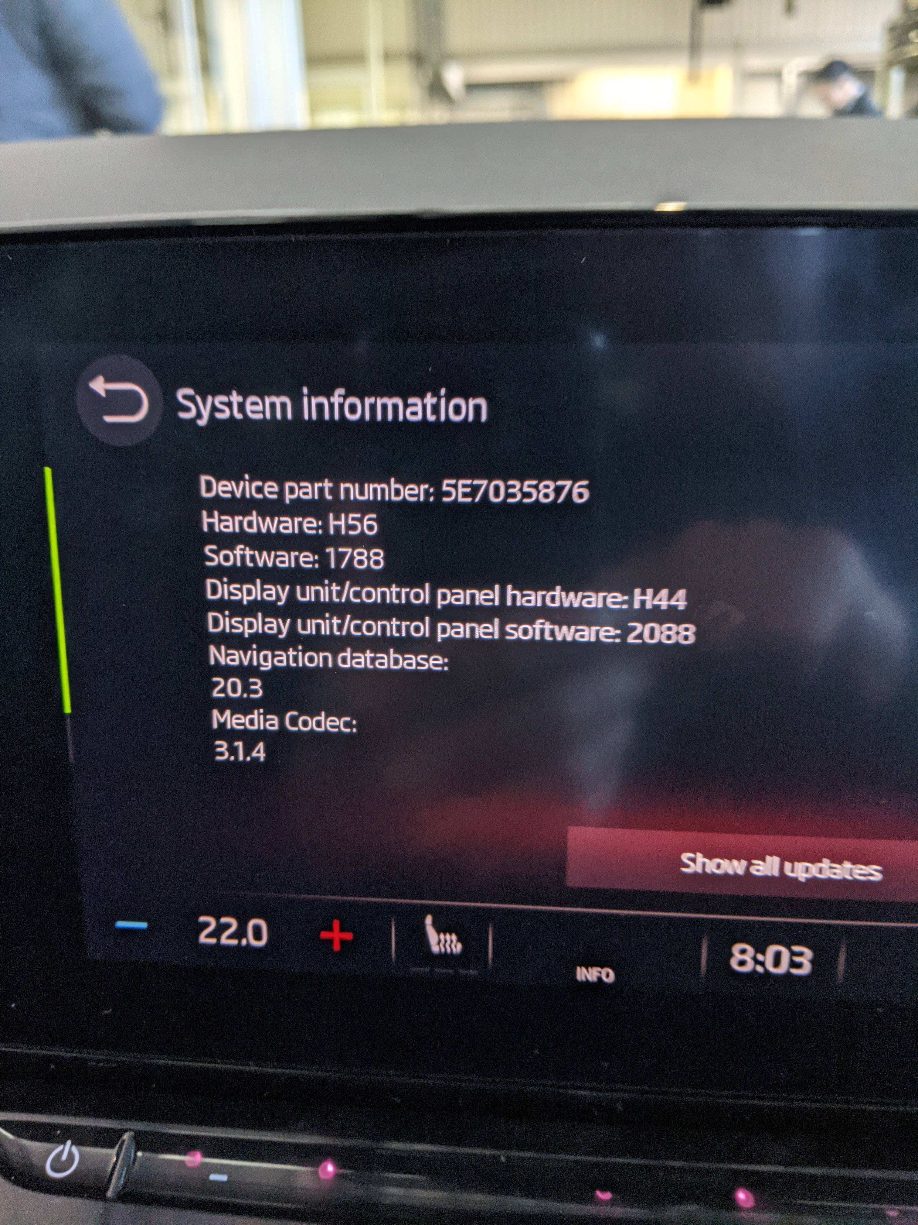

The car is now in the service department and I am waiting to see what gets fixed. They said there are some recommended software updates so here's hoping.

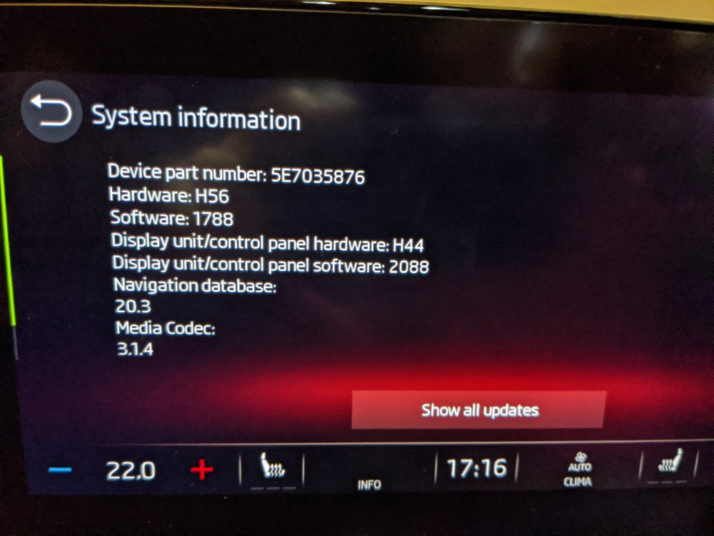

I took a picture of the System Information before going in so I can see what gets changed.

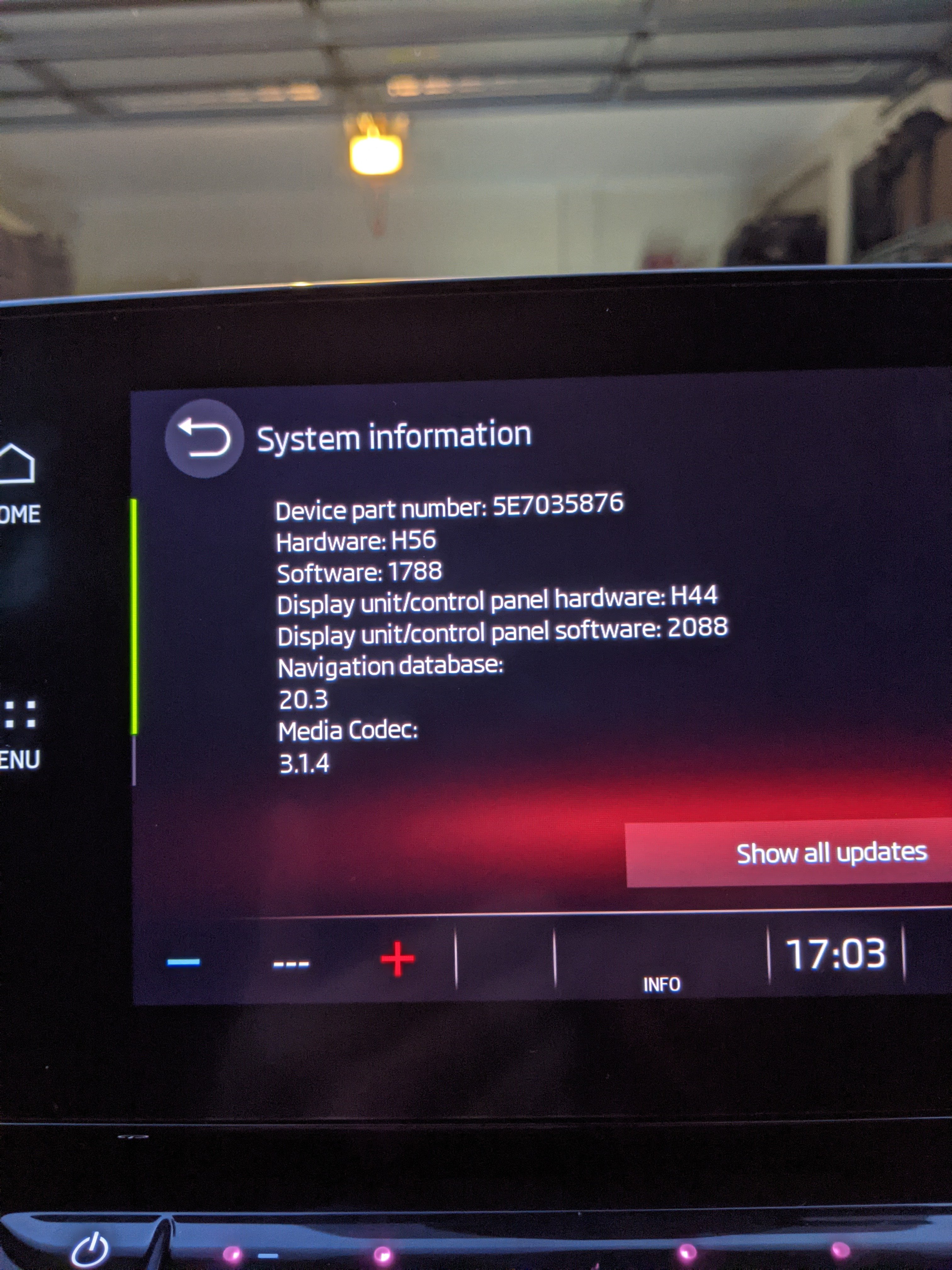

And here goes my theory. :doh:  Till now all cars without a letter at the end of the device part number had software version 16xx.
It's interesting that updates are available.
I've checked the Skoda update portal which says my car is up to date.
My software versions are attached and identical to yours.
I'd be interested to see yours after the update.

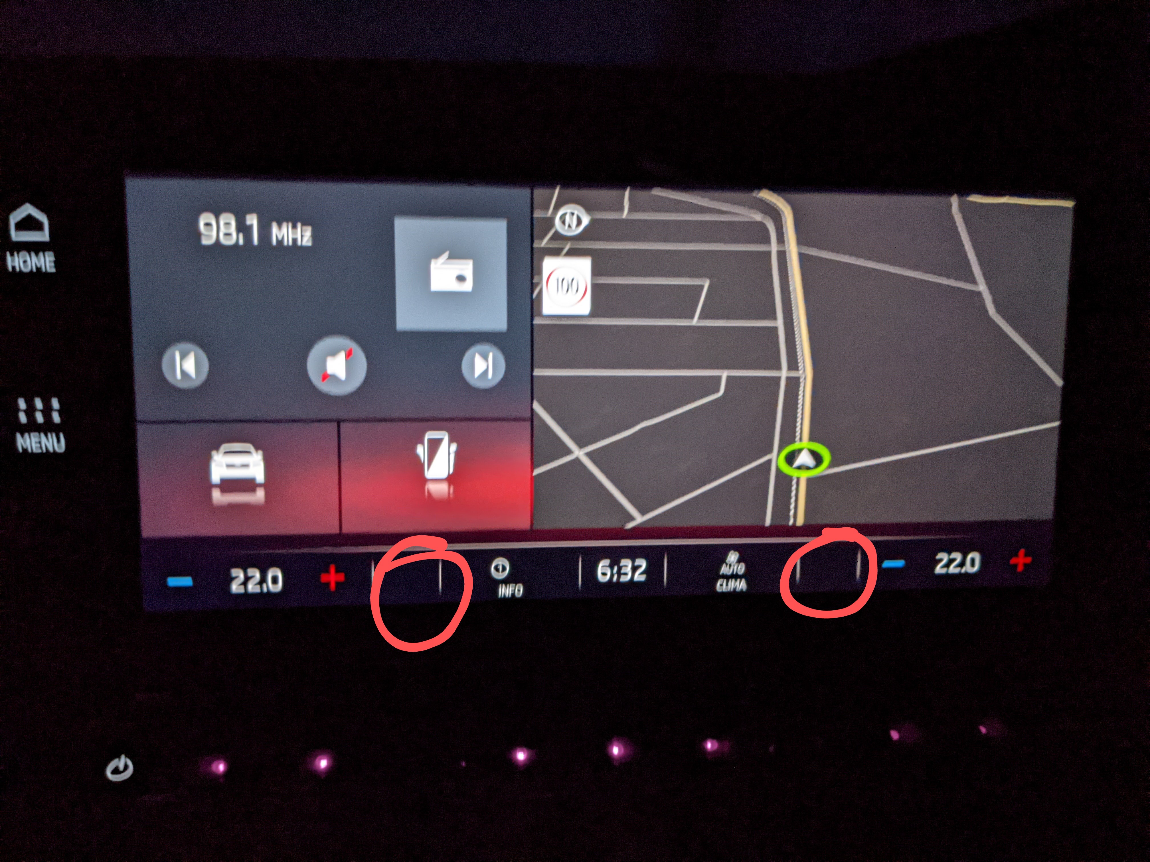

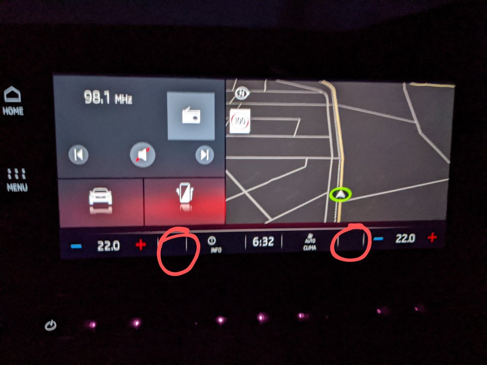

Jumped in the car this morning after work and found the seat heater buttons had disappeared from the screen.
it's the first real issue I've had with the infotainment screen.
Luckily I'd turned on the setting to heat the seat when it's cold on startup, but it seems this only applies to the drivers seat. My wife arrived home with a cold bum.
Will leave the car powered off for a while and see if it re-appears.
@DropBear next time smth like this happens try to press and hold the infotainment power button for 15 to 20 s for the system to reboot. It usually helps.
Thanks for the tip @TheUltraRunner.
The problem fixed itself and was gone the next time we drove the car about an hour later.
@TheUltraRunnersame here. I did not think this version was available < D versions.
Could be an Aussie special. :biggrin:
But again....would be really nice to know how these things correlates. I also thought (till now) that device part numbers are unique. The above pictures clearly disapprove that.
Yes. It is hard to know what the device part number is supposed to mean. DropBear and I have cars delivered at the same time in NSW but his is an RS sedan and mine is an RS wagon. Yet the device part number (and all of the other numbers) are the same.

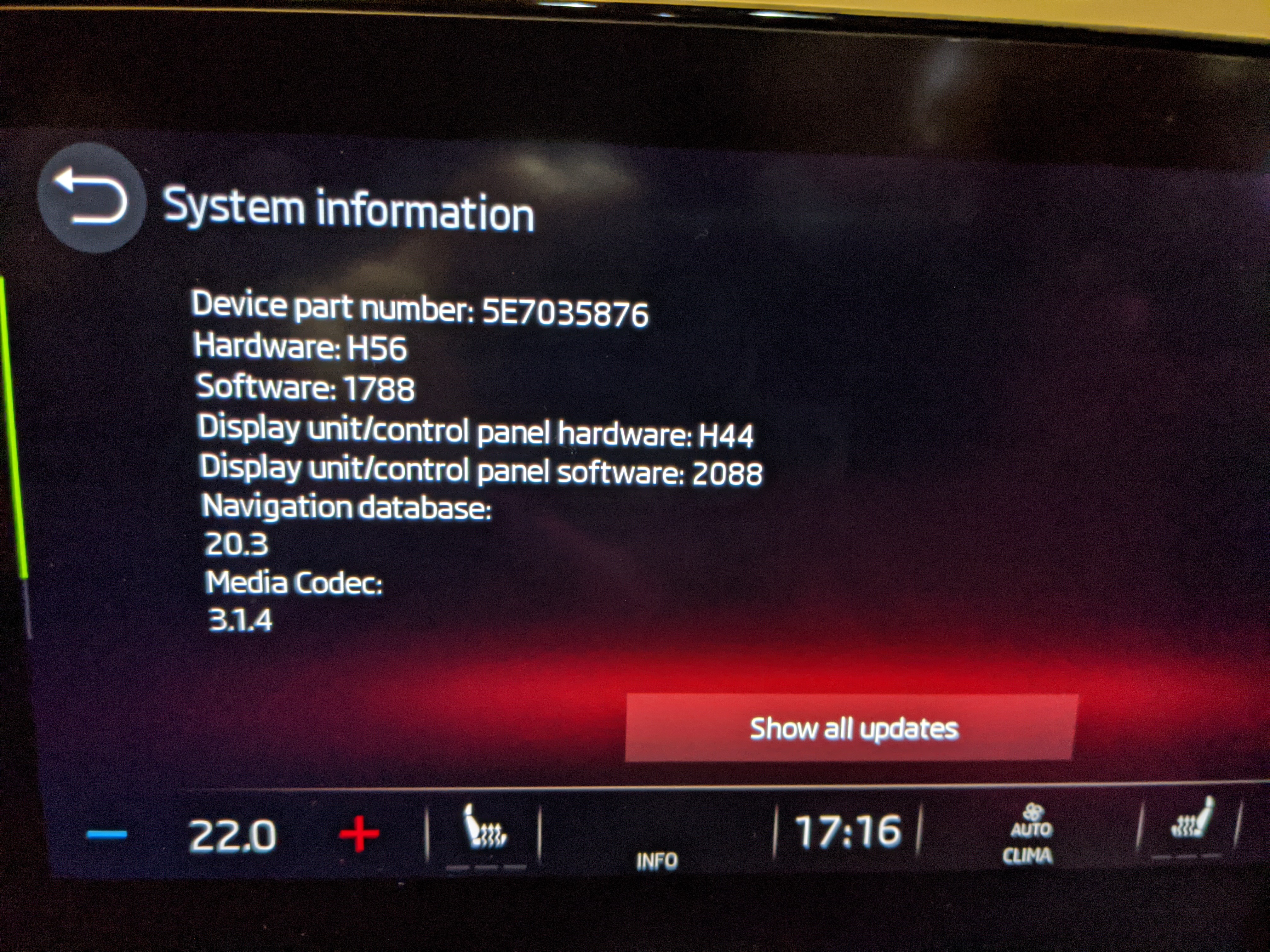

So I got my car back for the weekend. The dealer kept it from 8am Wednesday to 5pm Friday.
They said they performed various "updates" after contacting Skoda CZ on the first night - some taking hours which is why they kept it the second night - and they also took it for a test drive on the final day.
However not one of my issues above has been fixed.
#1, #2 and #3 are acknowledged to be real and they say they will contact me when Skoda CZ  gets back to them with a fix.
#4 they say is an unfortunate case where the brochure offered on the Australian website at time of purchase shows a feature that is not present in Australian models.
It DID say "Overseas model shown". I guess if you want to be sure about features you need to ask a salesman or verify yourself each and every one of the hundreds of features!
I took a picture of the System Information screen again and attached it to this post. In spite of the updates performed the data on the screen is identical to the data before I gave them the car, as shown above.
I conclude that, regardless of the speculation on this site, there is more to know about the software revisions than is displayed in this screen and we should not try to draw conclusions that tie observed behaviour to the numbers in this screen.
