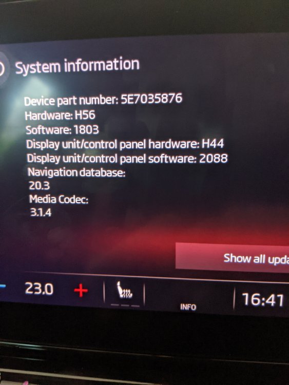

    And here goes my theory.   Till now all cars without a letter at the end of the device part number had software version 16xx.
  • It's interesting that updates are available. I've checked the Skoda update portal which says my car is up to date.   My software versions are attached and identical to yours.

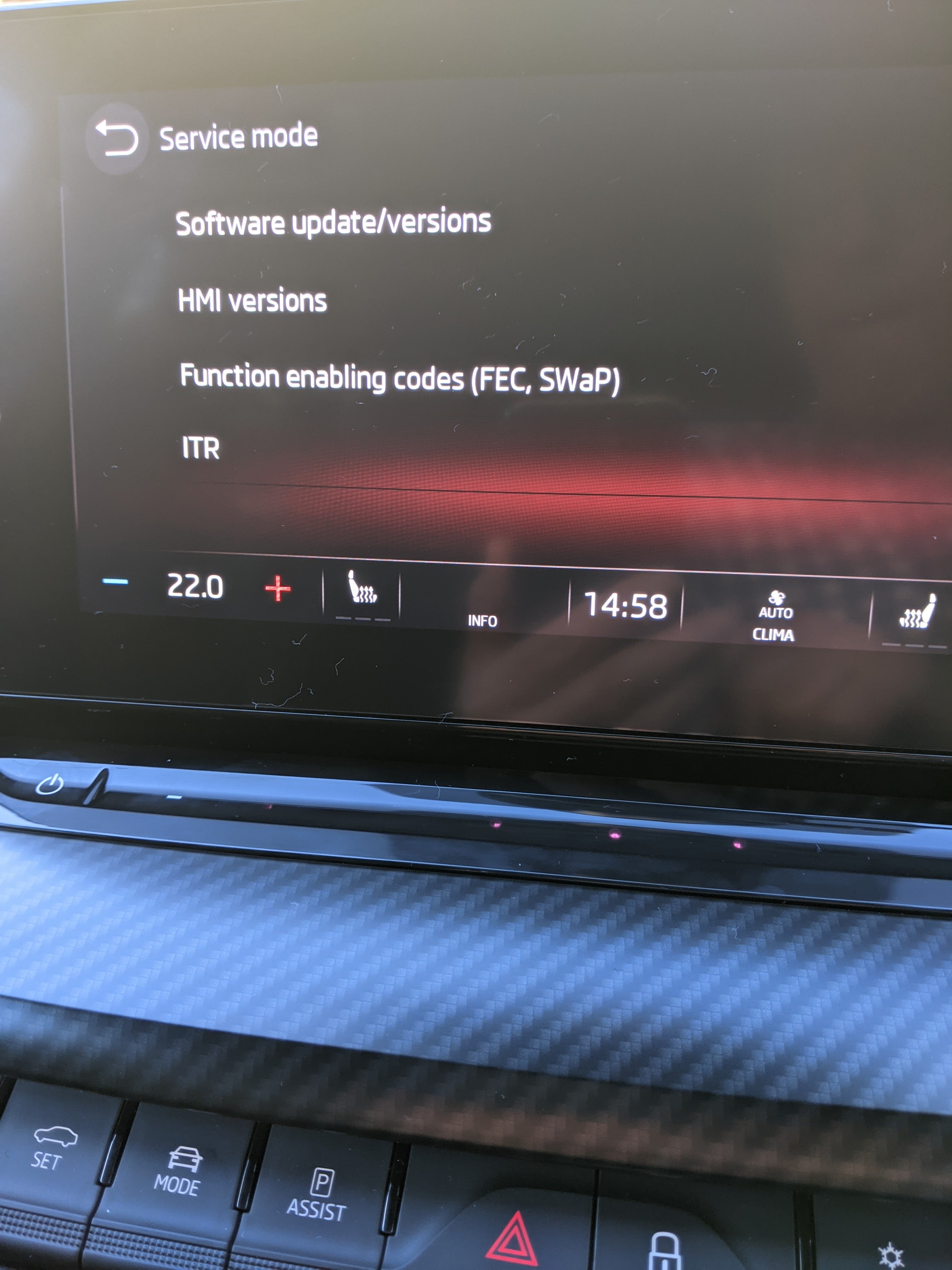

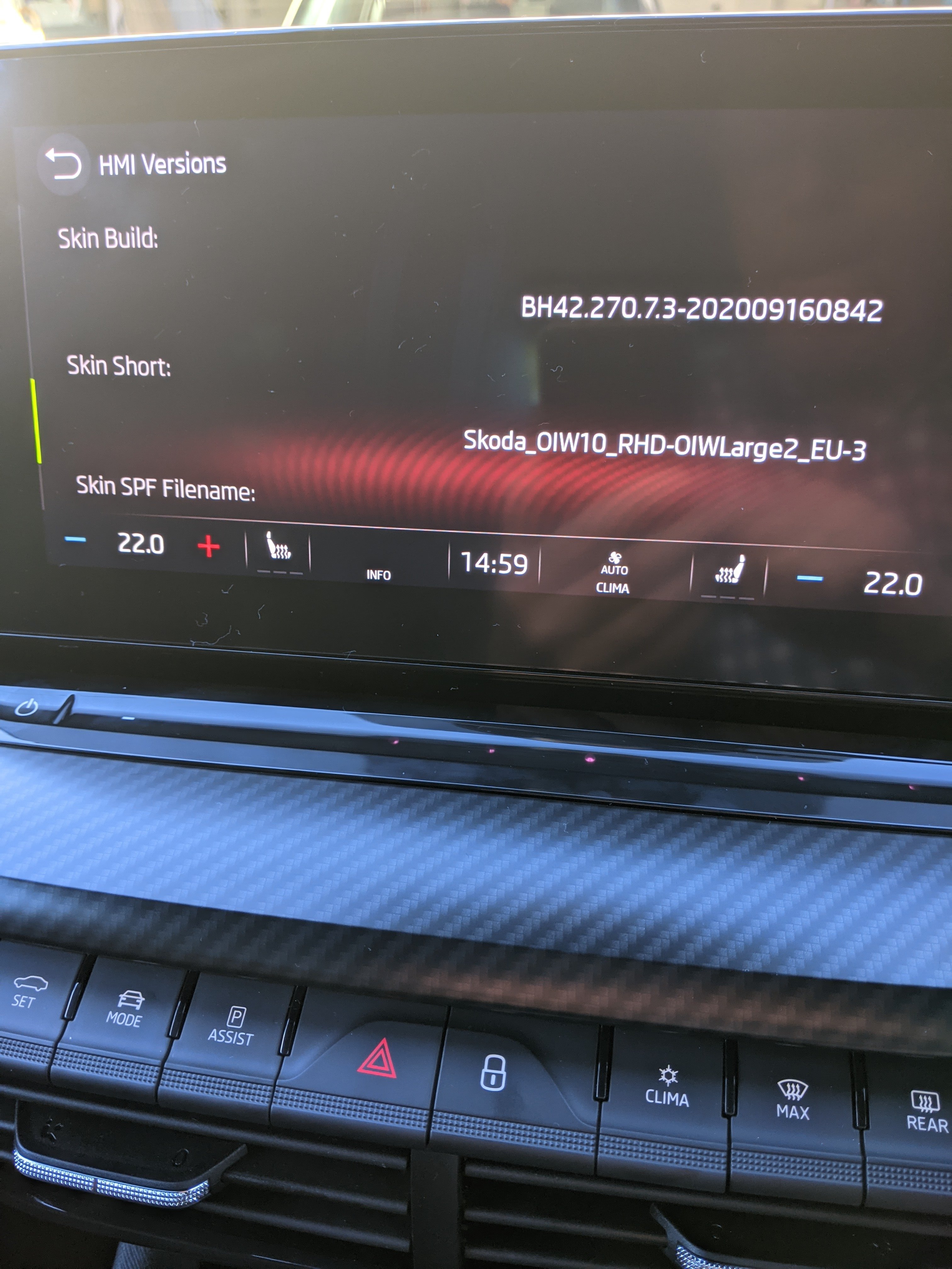

I've read if you hold the Home and Menu buttons for 10 seconds you can access the service menu.
There might be more software versions that can be checked there after updates.

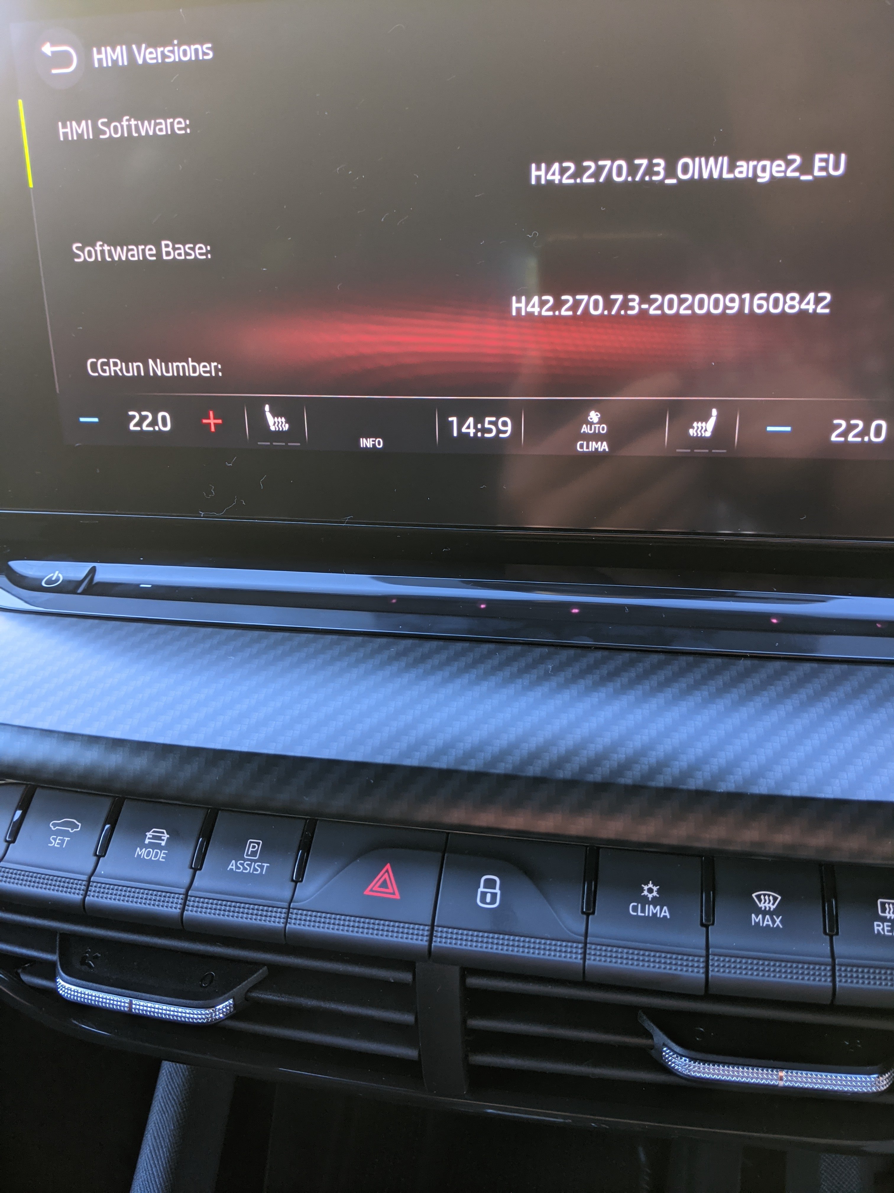

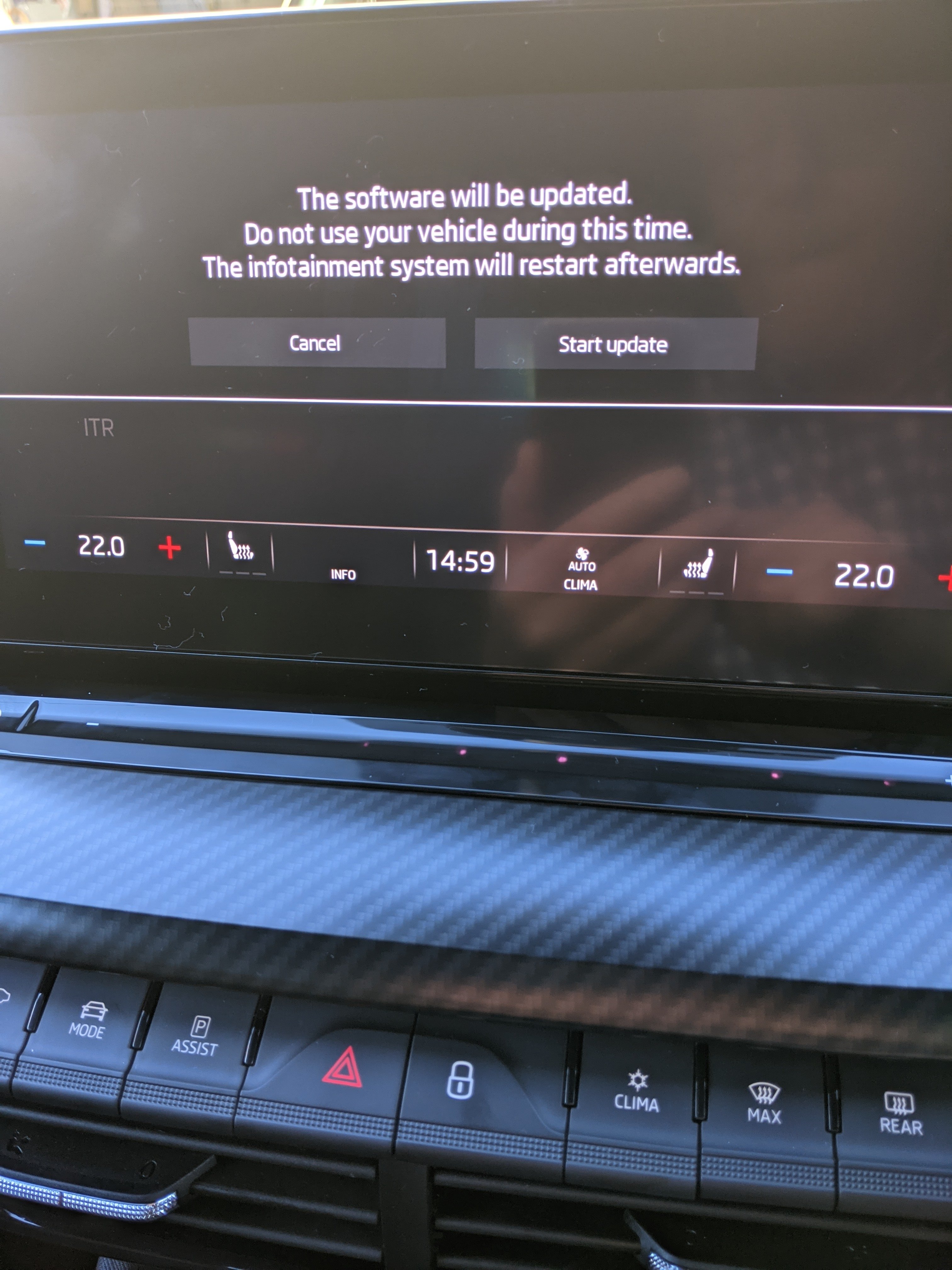

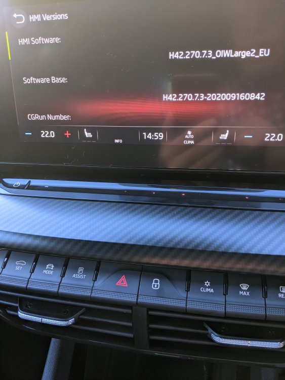

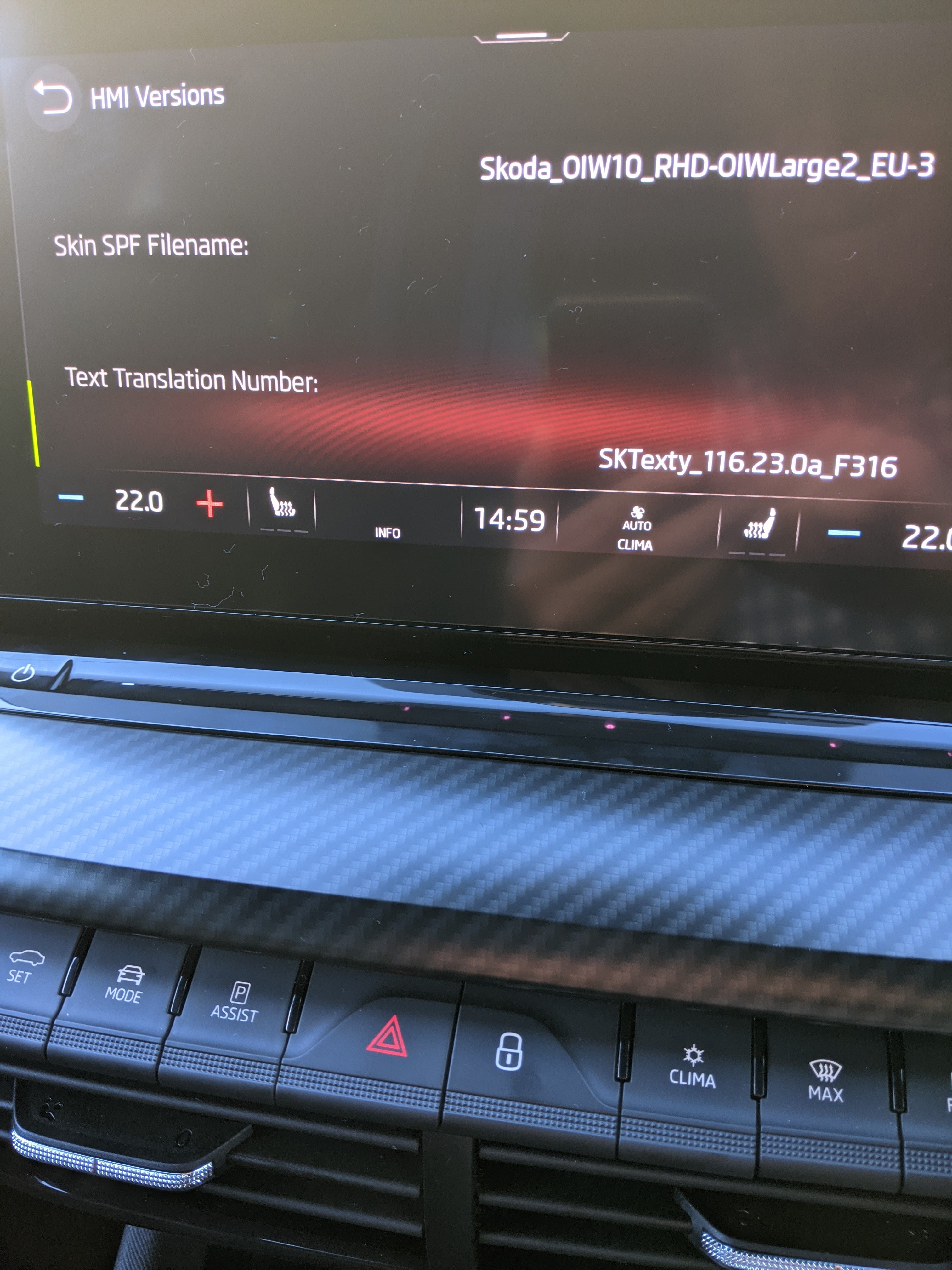

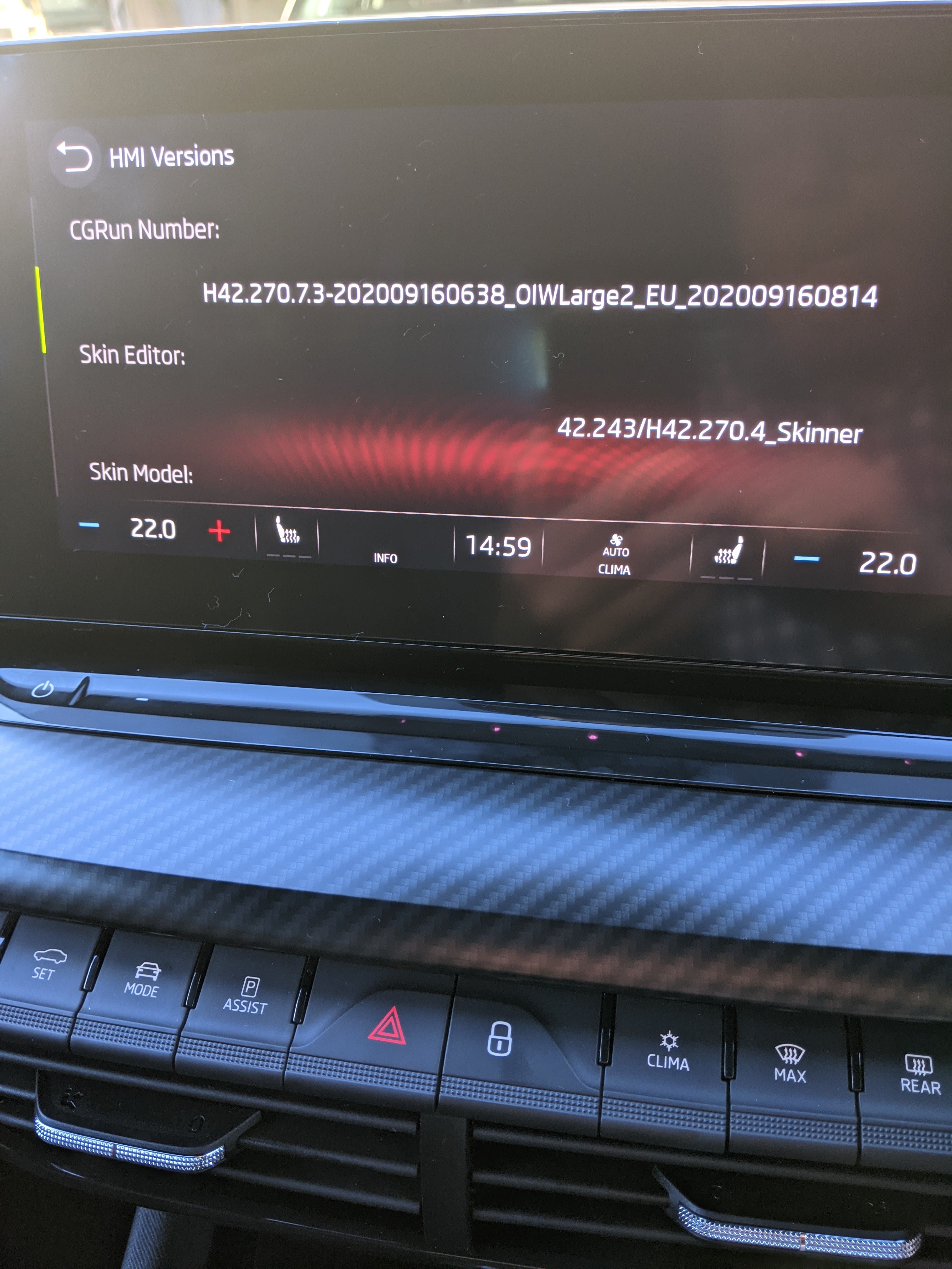

I tried that. The results are attached. Not that there is much I can do to interpret them.
I noted there was also a possibility of a software upgrade. Not sure I should do that, if it would even work.
