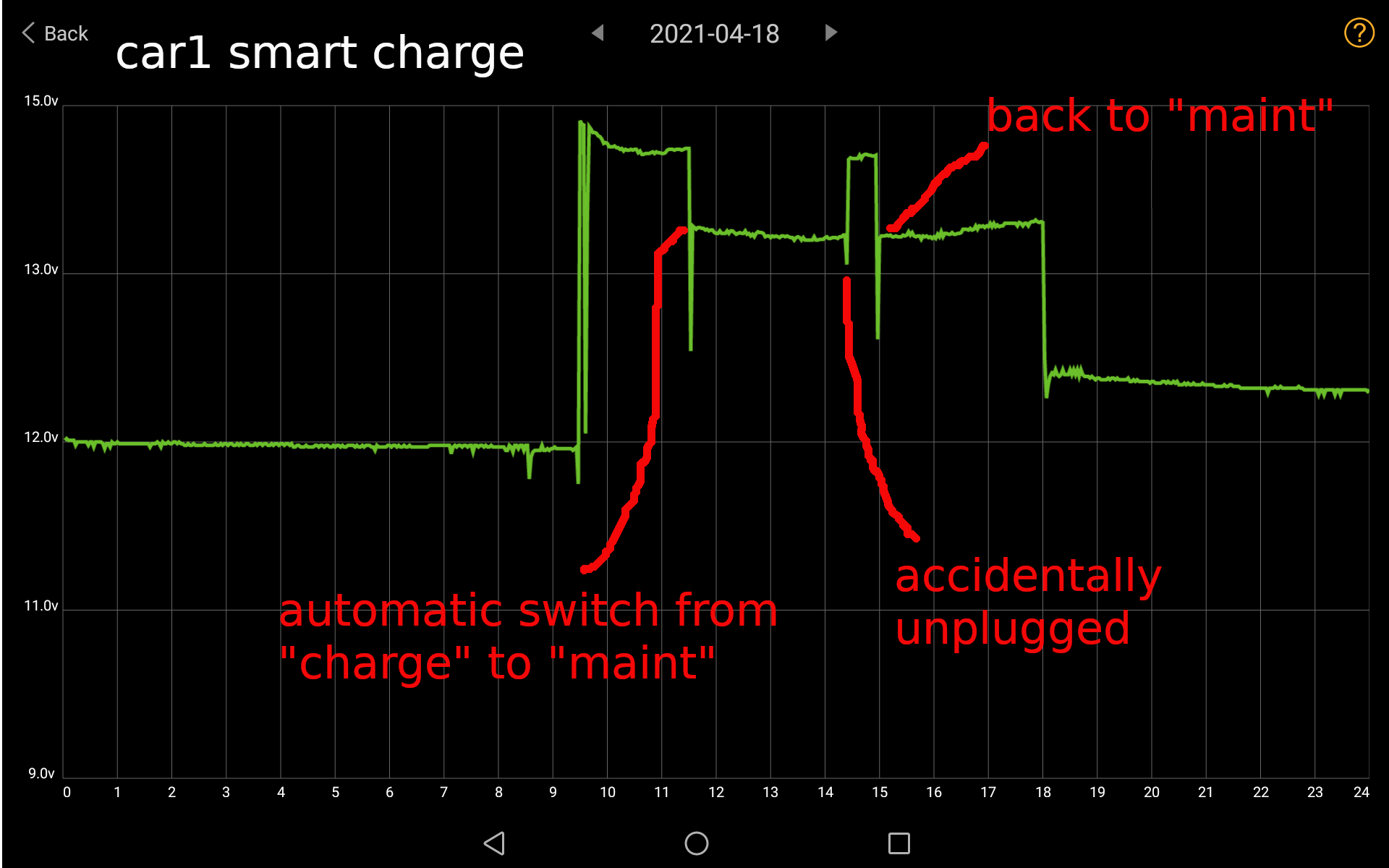

Regarding "pulsed top up stage" the BM2 I used to show the battery voltage only samples once every 2 minutes and it doesn't show anything interesting happening.

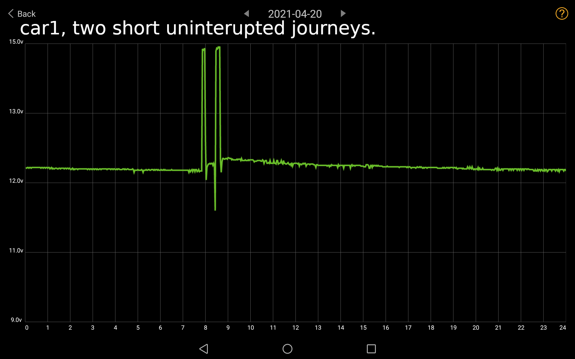

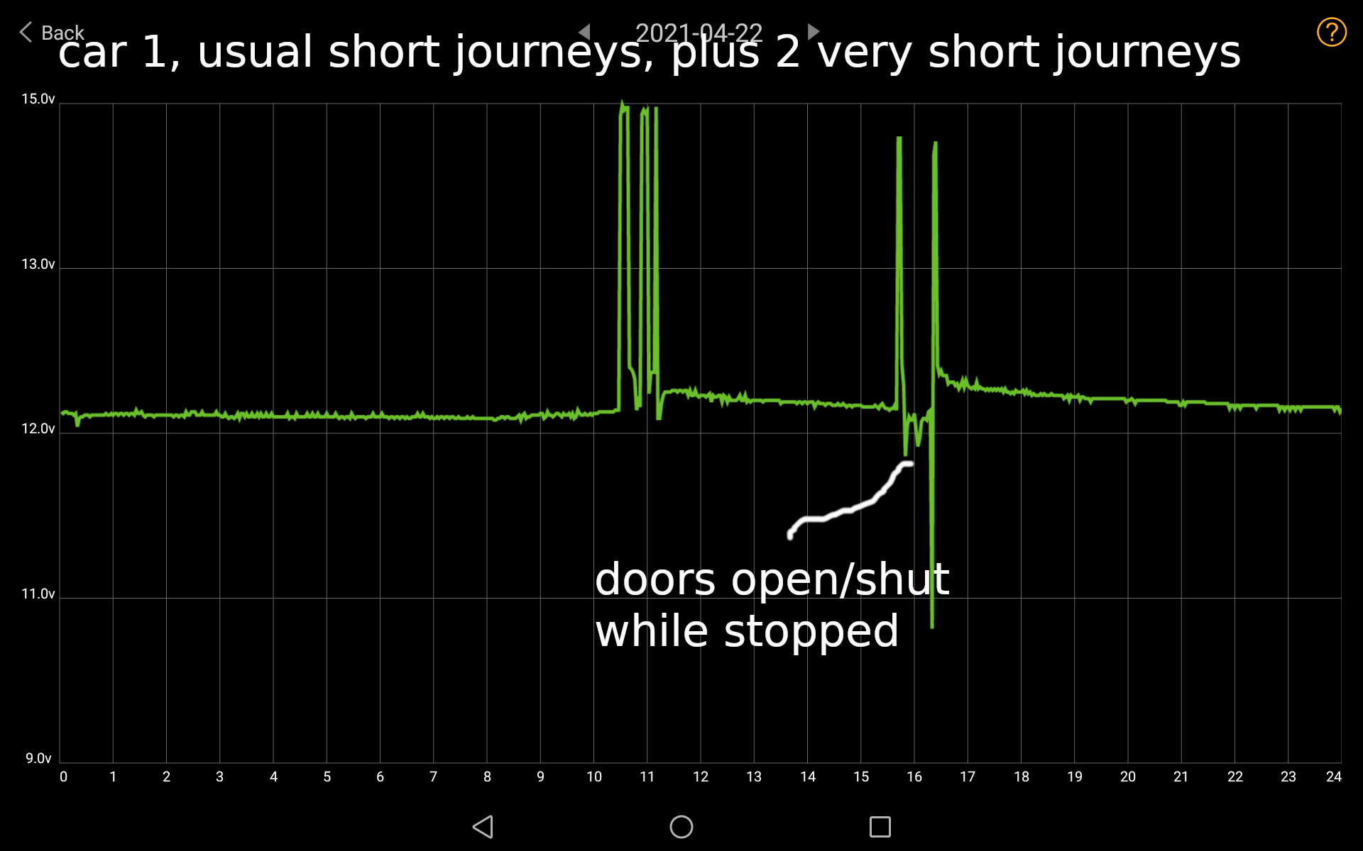

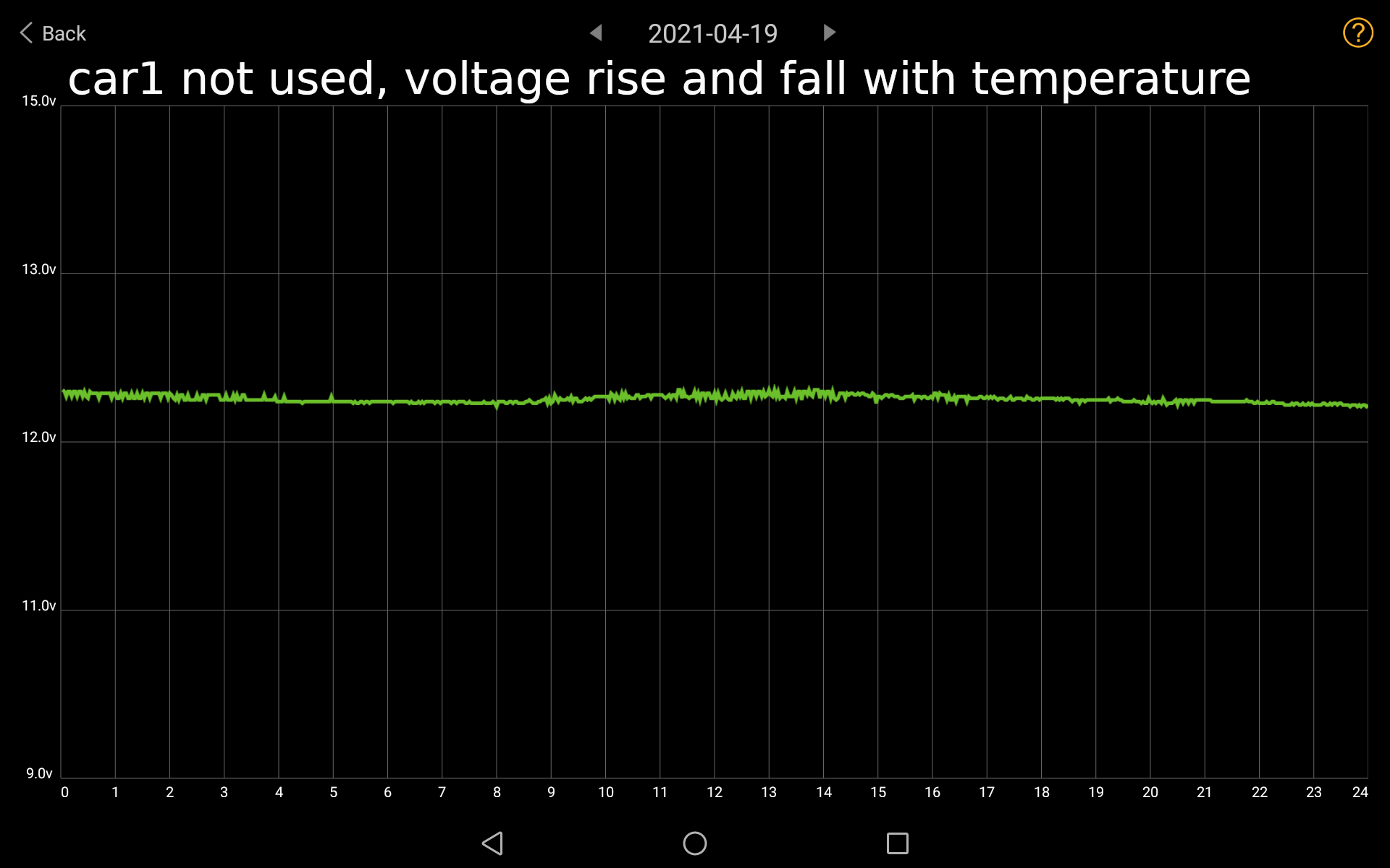

Attached are some BM2 charts from when the battery was still in the Fabia, with some comments.
With hindsight it should have been left on "care"/maint charge for a lot longer as the voltage never used to get high enough to stop the warning bong - battery low, charge by driving.
Or just driven the car a bit more.

I love the accidentally unplugged, did you use to work in a hospital until "the incident". :)
My Accumate is also just a plug in and no more, three LEDs red, green and you've put the clamps on the wrong way round on the battery.
Apparently it's a 4-stage, I think modern types are 7-stage now and programable, probably the programs confuse the users (they would me) and possibly confuse the machine itself sometimes.
