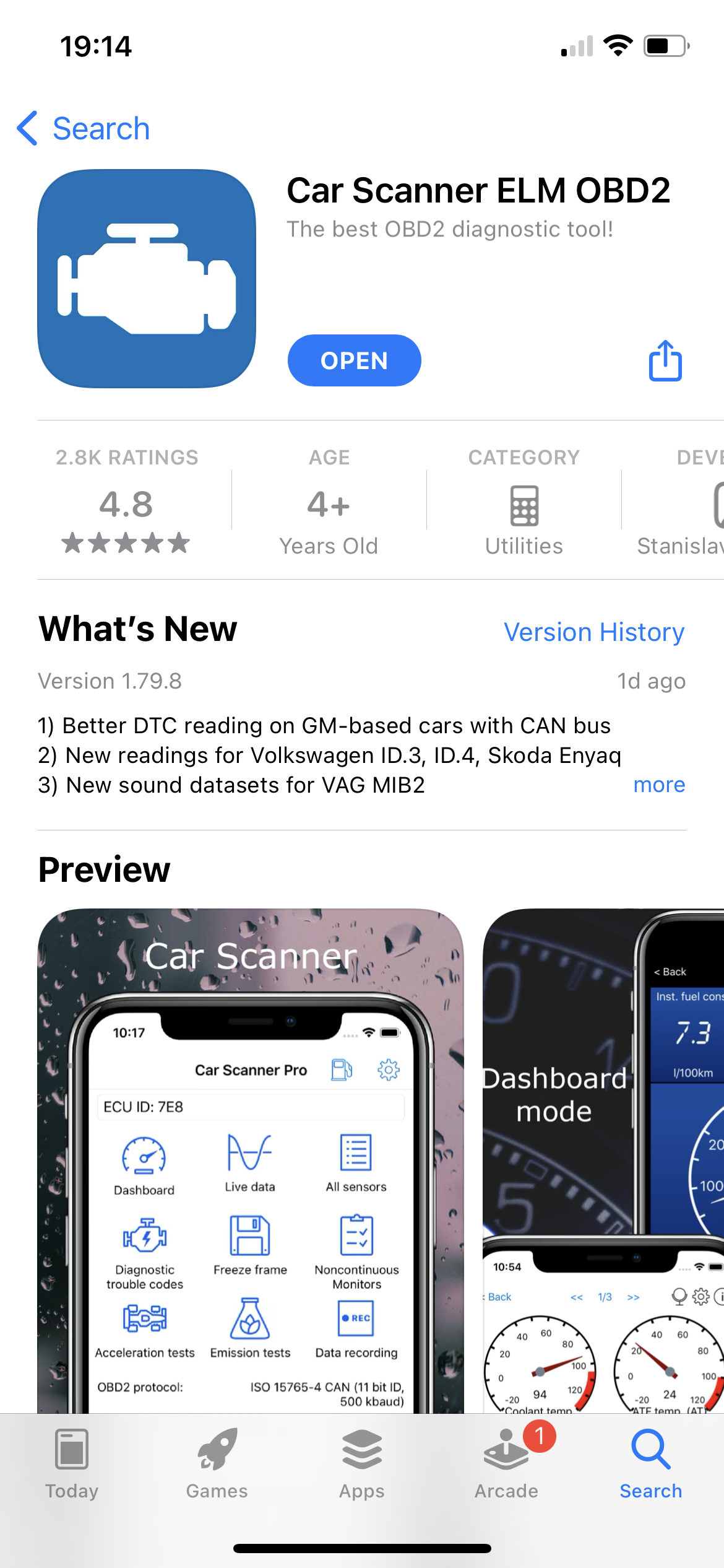

I used a bluetooth obd dongle called "VeePeak OBDCheck BLE+" it's available on amazon for around the £40 mark.
As for the app, i used the following one (im on iOS i dont know if it's the same on Android);
Thanks for that, I've added that one to my iPhone,  and will check if it works with the Carista dongle - I'd think it will, the more the better, maybe not!

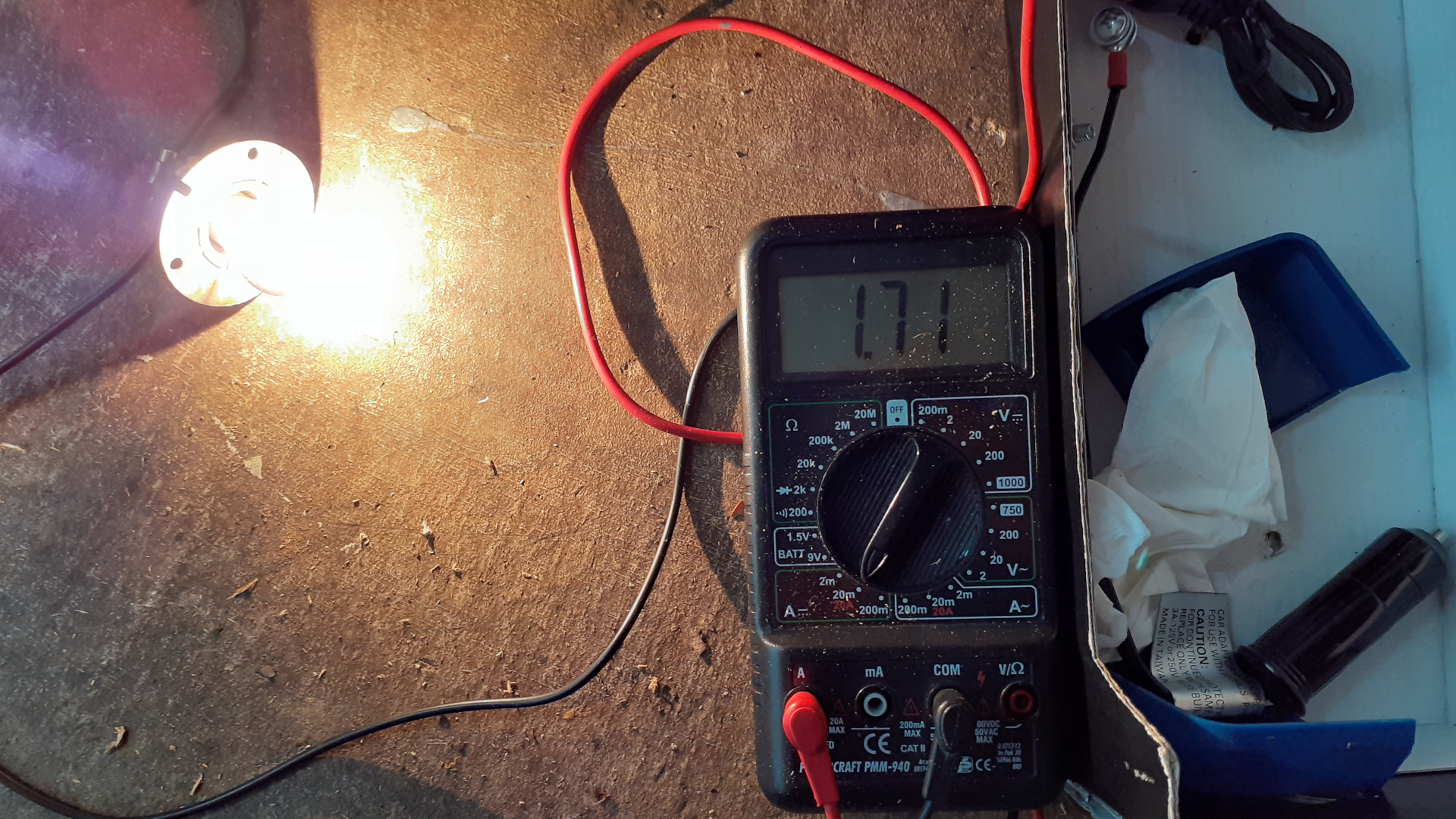

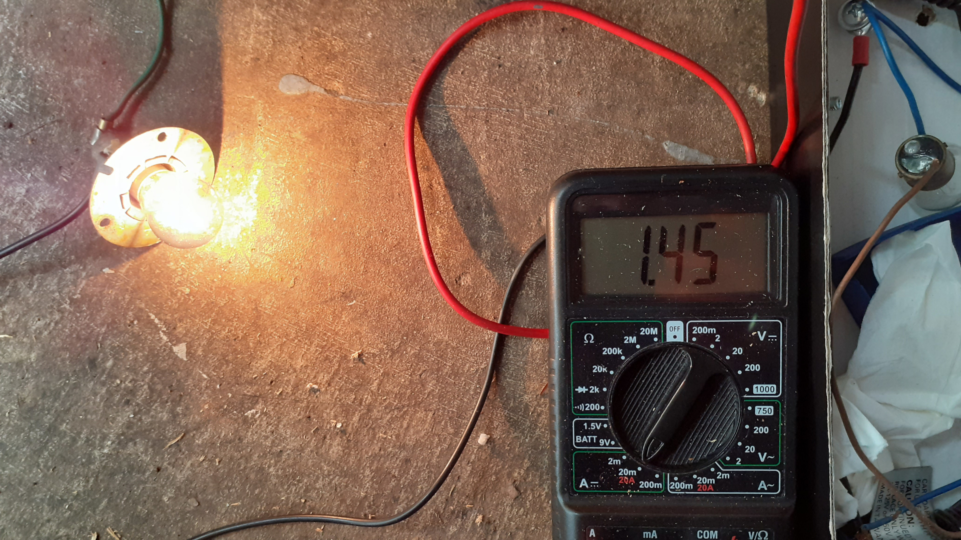

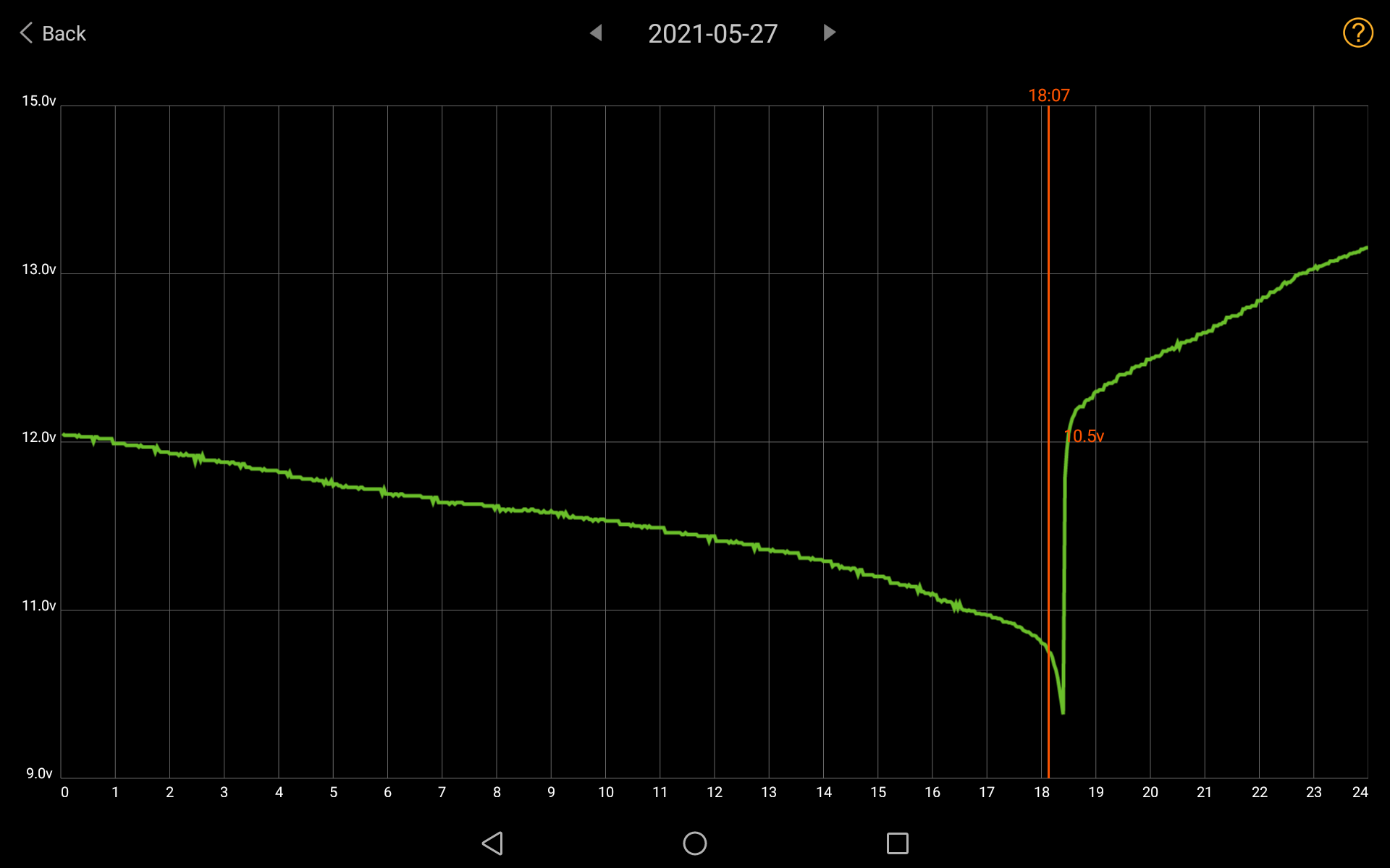

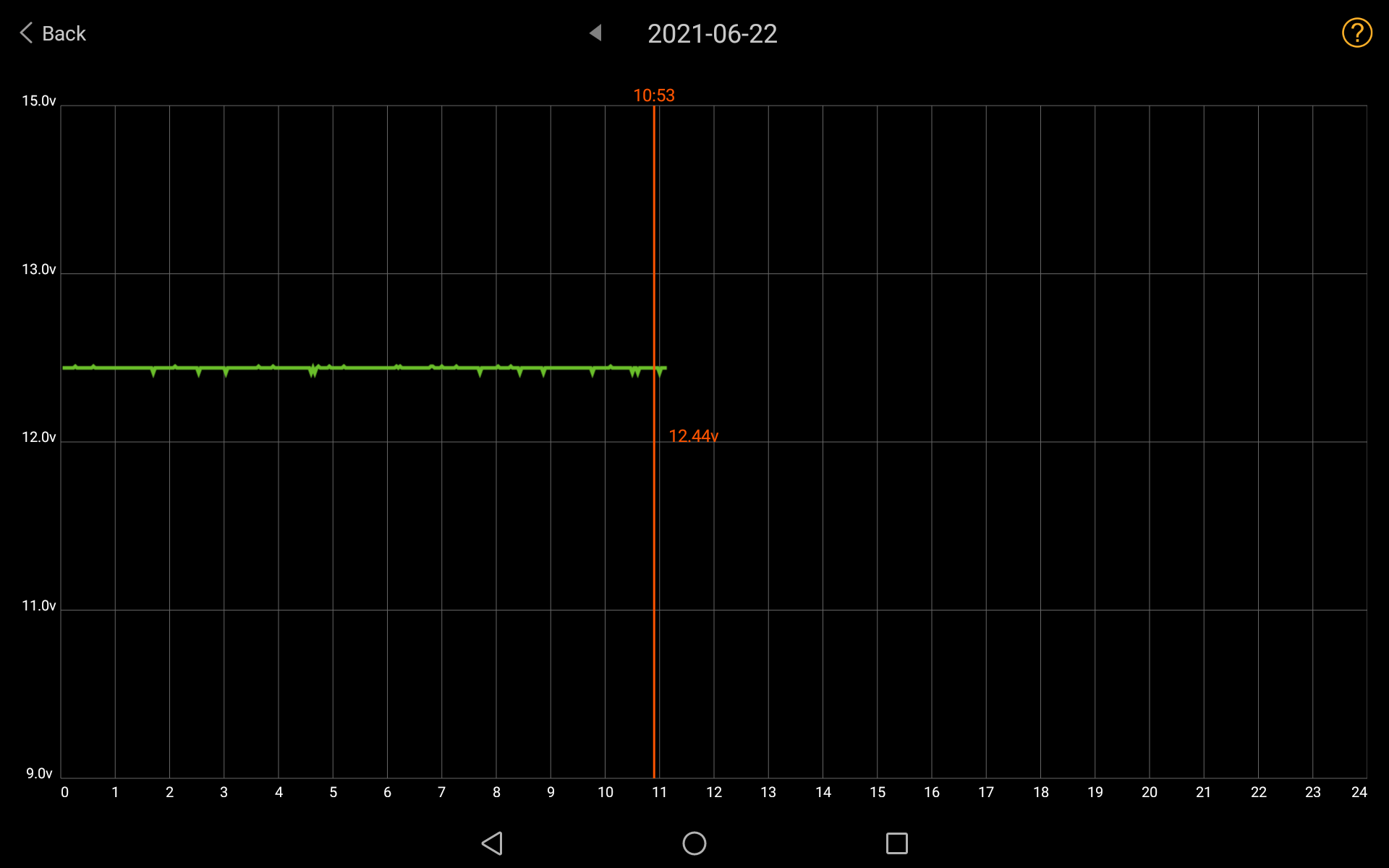

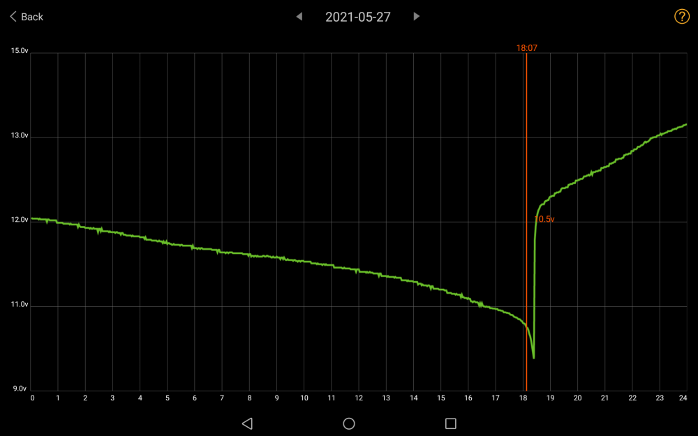

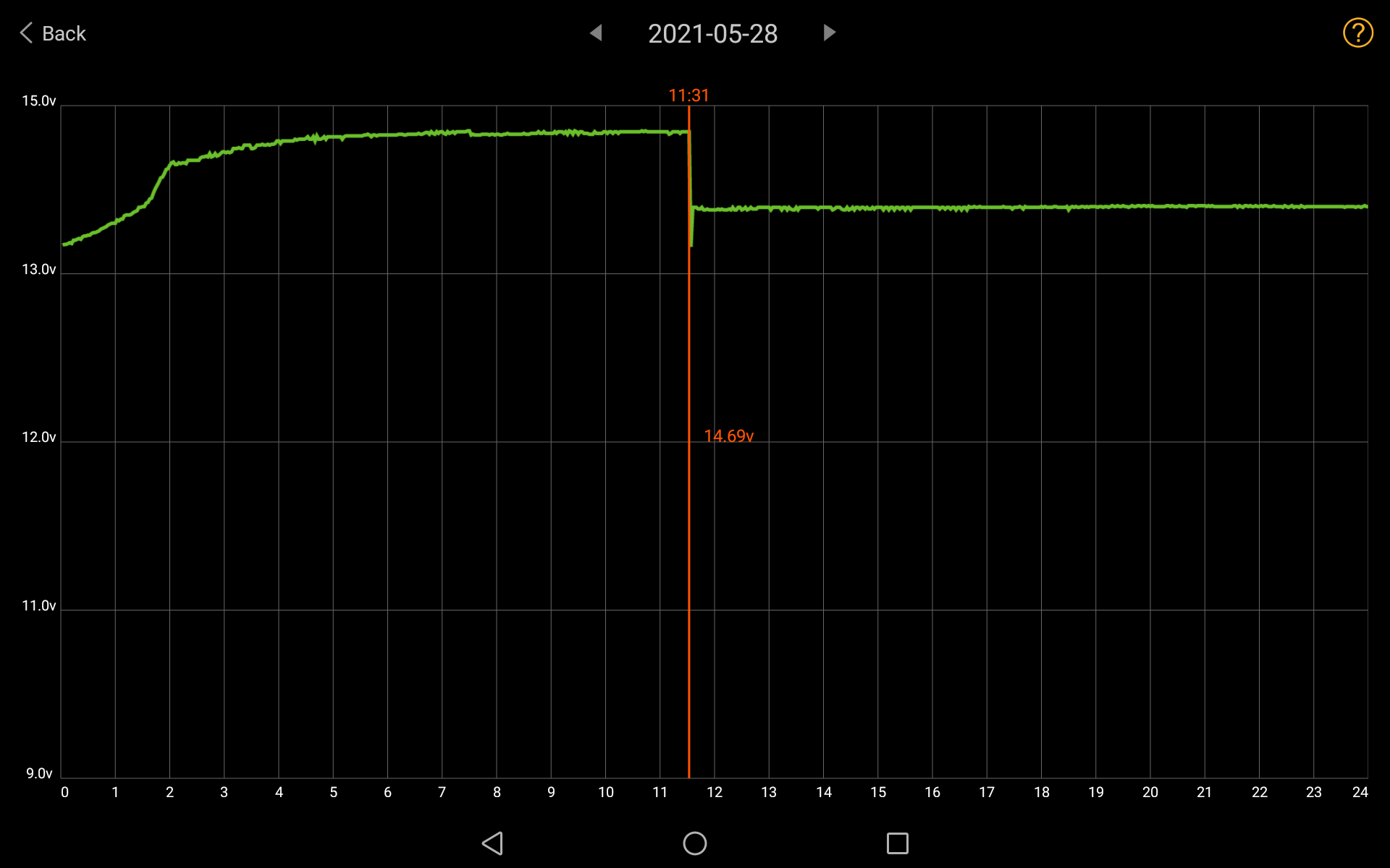

I put a Bosch EFB battery on our 2015 Fabia this April (to avoid changing the type from the Moll 59Ah) and during a chat with The Batteryshop I was told that Varta and Bosch batteries are made in the same factory in Spain.
(It seems Moll went bust about a year ago, so exact replacement was not possible)

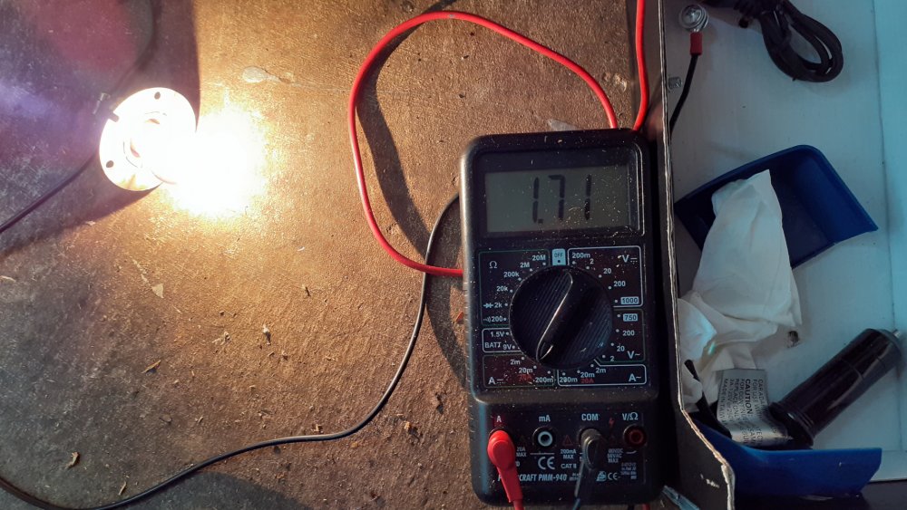

Out of interest I put the old Moll battery on a CTek CT5 a few times and tried various test on it: charged up voltage was initially 13 volts, but was down to 12.5 volts in a couple of days, then It seemed to self discharge much more slowly after that - in 15 days it was down to 12.25 volts.
The next discharge was into a 21Watt lamp - 1.71 Amps to start with - to get some idea of what the battery capacity was at "end of life".
According to the internet the nominal Ah figure for a battery is a 20 hour discharge down to 10.5 volts, and the 21Watt lamp got it down to 10.5 volts in 23 hours.
The current had reduced to 1.45 Amps by the time I stopped the discharge at a voltage a bit below 10.
So maybe 1.5 or 1.6 x 23 about 33 to 37 Ah remaining, give or take, from an original 59 Ah

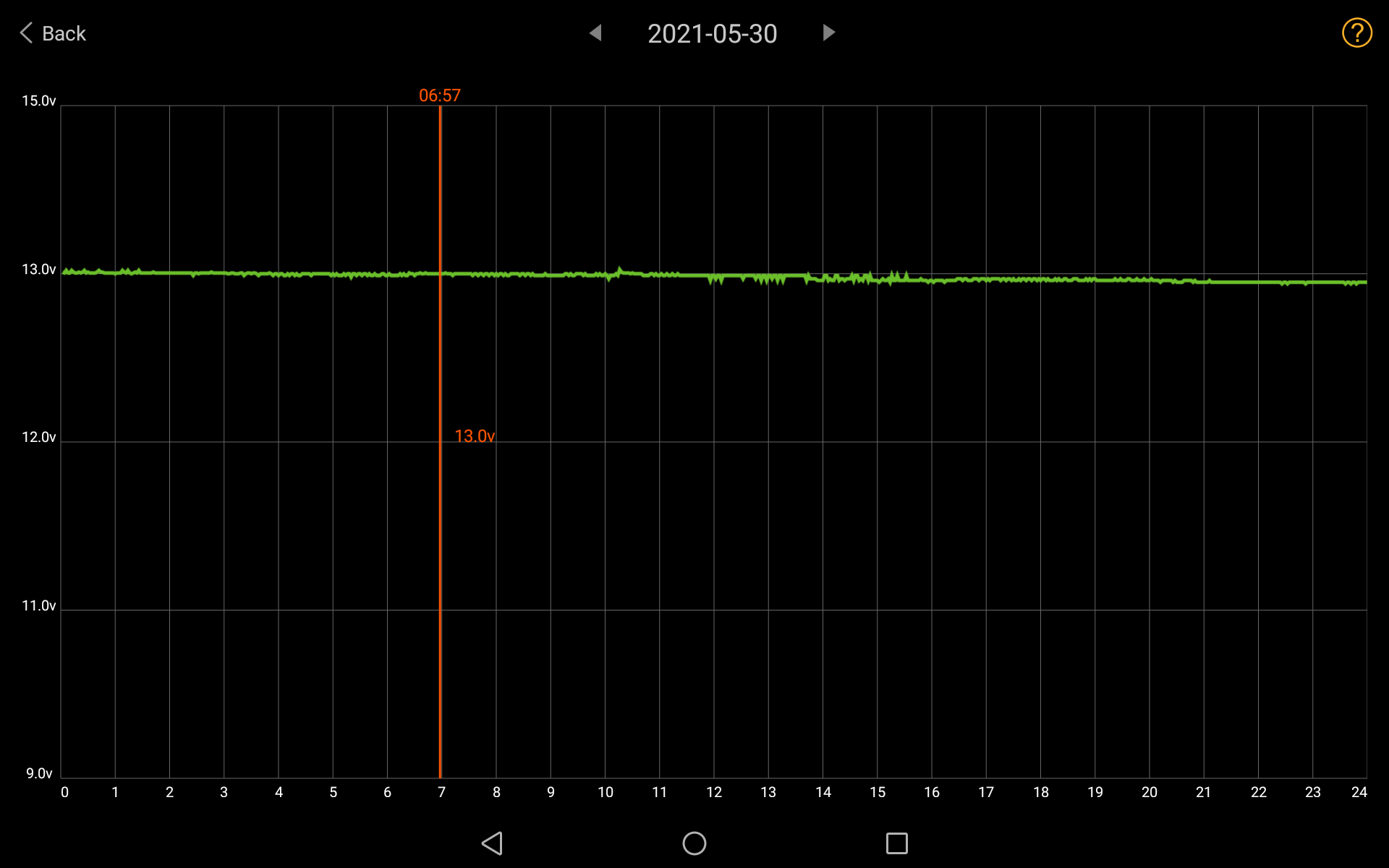

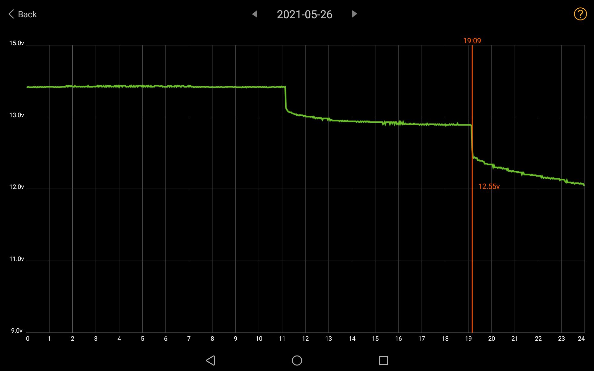

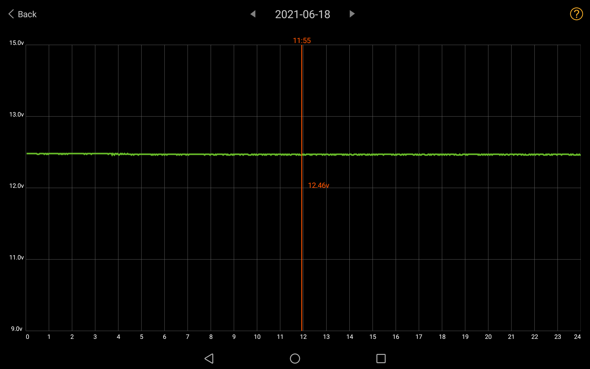

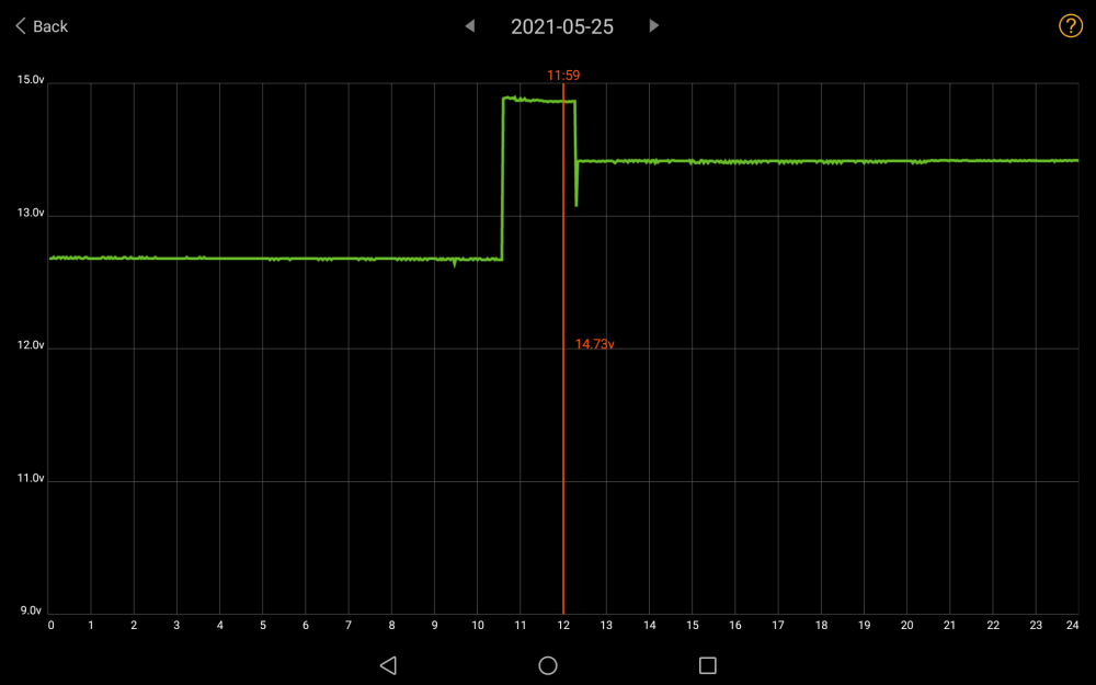

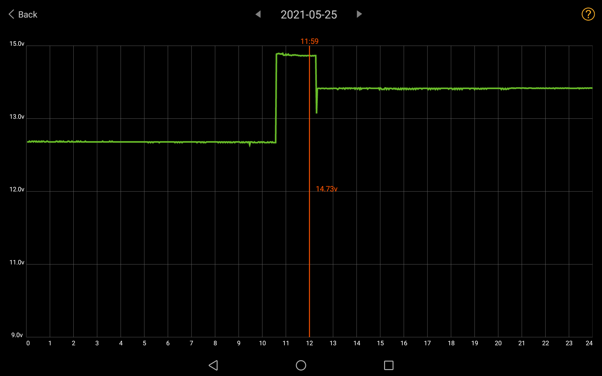

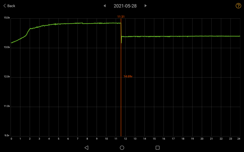

After a very long charge - 48 hours - the battery voltage stayed up at 13 volts on a self discharge test and 23 days in the voltage is still up at 12.44
The voltage measurement charts were from a "BM2" battery monitor, and the current figures are timestamped snapshots of a digital meter.
Battery voltage is affected by temperature, but it hasn't been very hot or cold lately - you can see it on the charts in the afternoon sometimes after a cold night.
Draw your own conclusions - I don't know if the really big discharge helped it, or the longer than usual charge, but it does seem to hold voltage better now.
When I was charging the car during "lockdown" it was never left on "care" for long, so maybe the battery would still be happy in the car if it had been given longer in "care".
(comments from the Skoda garage on the last two services were "battery OK but needs a good charge", or words to that effect.)

Thanks.  It all suggests I panicked and done what I suggest to others not to do and changed the battery too quick.
But I console myself with the fact we don't know about the car's first 18 months of use and the car is too much in use to be unreliable plus I don't want to be farting about with any car in winter especially as both our cars sit outside 365/6 as we only have hardstanding and no garage.  I literally hurt myself last week undoing a nut on my old banger and bruised my back on the concrete and that was on the hottest day of the year.
