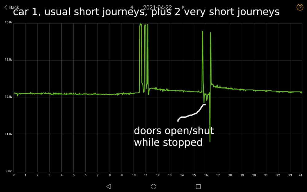

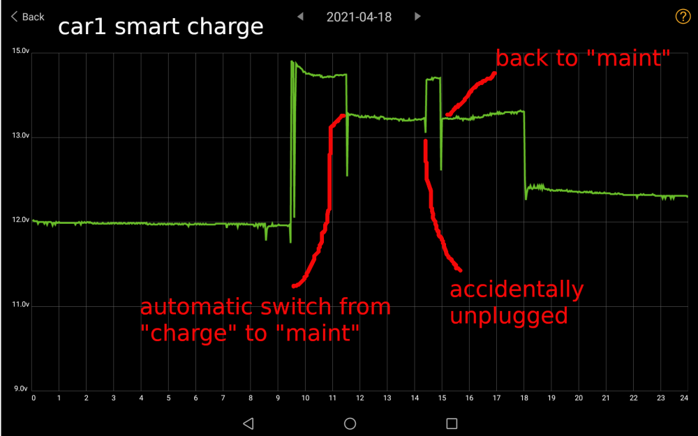

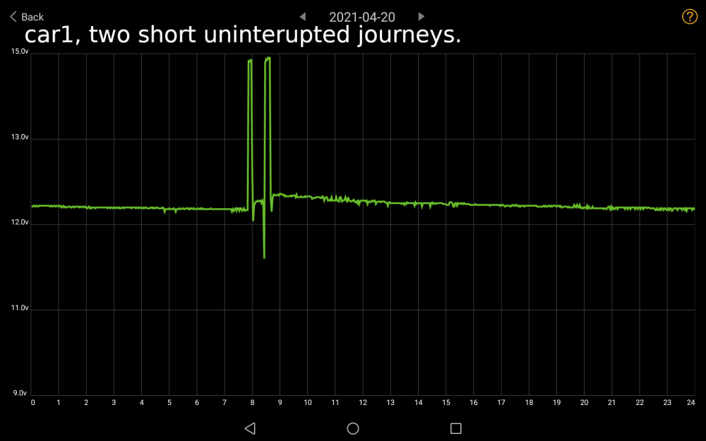

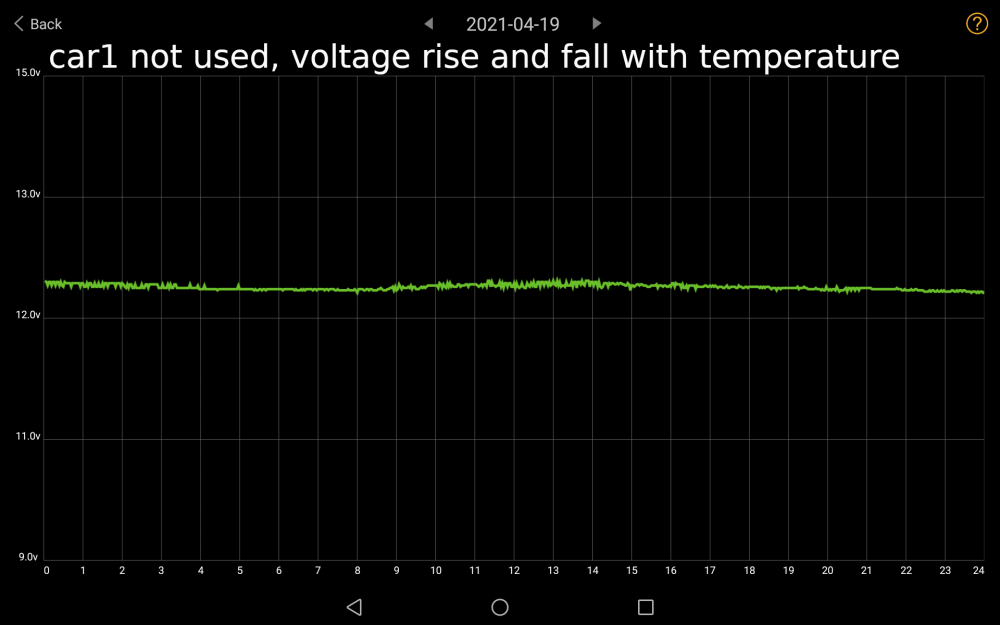

That is a strange thing, though when I've dug deeply into things/facts, I have a couple of CTEK smart chargers and while at least one of them has a dedicated AGM setting/program, when you read the owner's manual fully, this AGM setting is only for "other" types of AGM and not for AGM drop ins as most people tend to be using if changing from EFB to AGM.
I still have a nagging feeling that I should get an ex-work mate to bring his 2018 Audi A6 TDI out to me so that I can have another look at the settings, his friendly all makes garage replaced his dying EFB VW Group battery for a Yuasa AGM but did nothing else, so after finding that out, I offered to make any other necessary changes - on his car like my 2011 Audi S4, there is no easy dropdown menu to be looked at that includes battery technology, as I said earlier the car gets that info from the battery's VW Group part number that has been inputted,  now I did not think that Audi fitted EFB batteries to TDI cars, especially the bigger cars, but I might be wrong. So the options are that if I look at the channel that has the battery part number listed, I can work out from built up knowledge, if that car was set up at factory for EFB or AGM and alter to an AGM part number if necessary, I did alter the serial number though to alert the BMS that a new battery had been fitted.
I do understand while there are "facts" there does seem to be, at least to the enquiring mind, a certain amount of smoke and mirrors - basically to protect the motor trade, most cars on their second battery get "moved on" soon after so nothing really matters to the owner changing the battery, but for the rest of us, why on try to maximise the new battery life if only to do, or try to do what is meant to be done.
