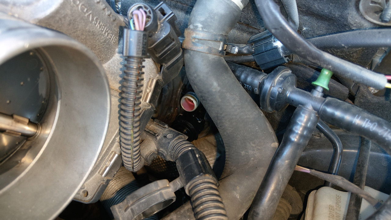

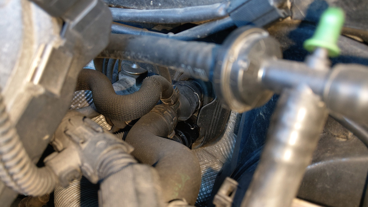

Well, the hood (bonnet, for you brits ... :D ) was up once again, and I tried to find the source of leakage, and this time it couldn't be a small one judging from the amount of the coolant that leaked within minutes. After some time under the hood, the issue was found - the radiator coolant hose adapter which connects to the cabin from the engine bay (under the windscreen).

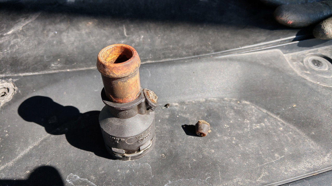

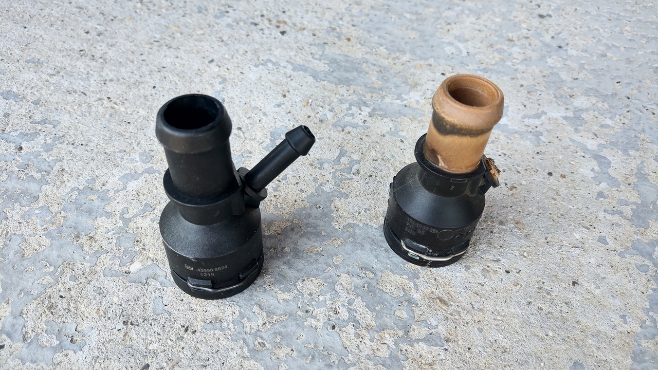

The culprit was the plastic connector, which, over time, failed to properly seal, due to various whatever-it-was that was slowly accumulating over the rubber o-ring inside. The connector is a Y-shape element, and luckily, it structurally failed on the smaller hose when dismantling (literally fell apart), which meant the adapter definitely had to be replaced (without that failure, I'd probably just replace the o-ring, without paying much attention to its general condition, which was concealed with the hoses).

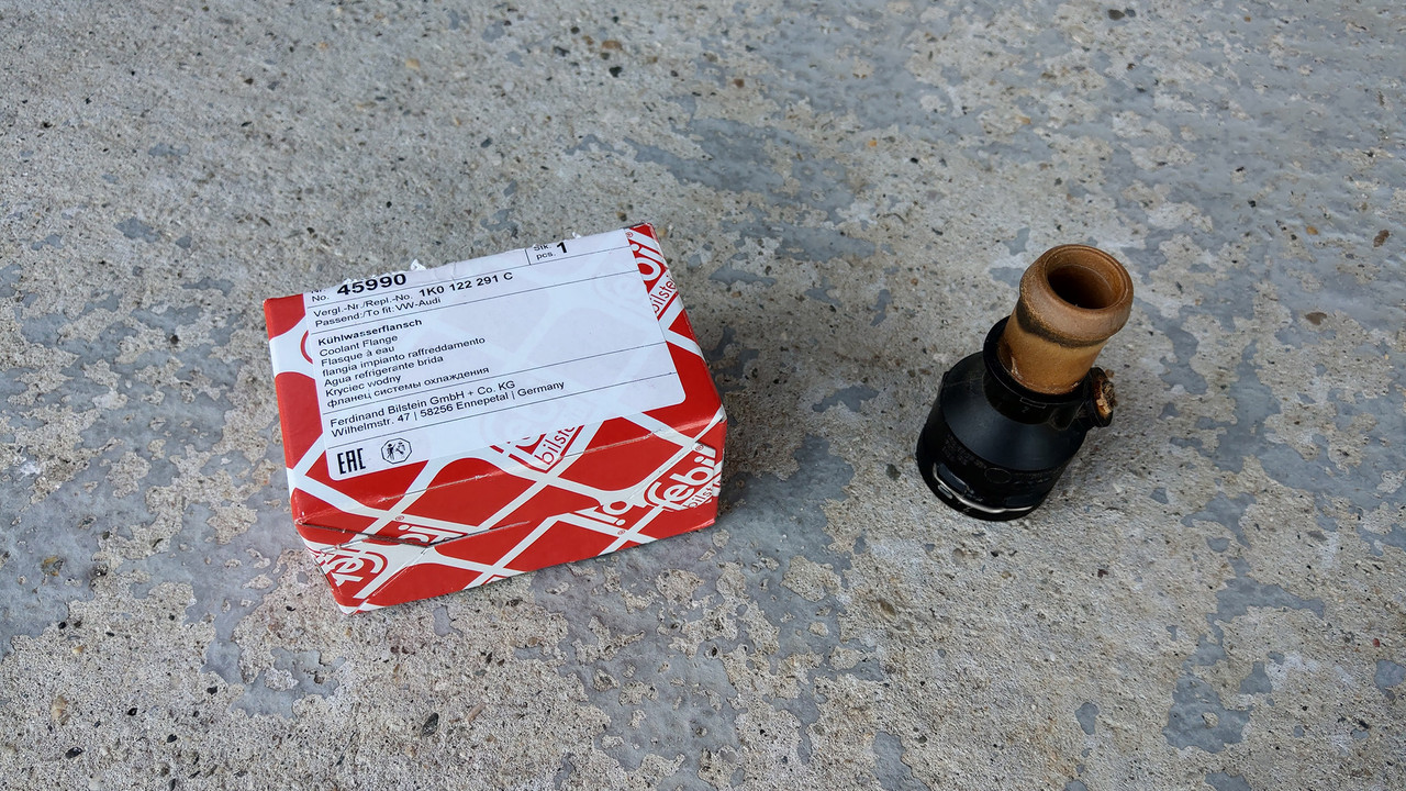

I've managed to figure out the OEM part number by doing an online search (the connector is widely know as a "pa66 gf30", which is imprinted on the adapter body, although you'll hardly get the proper part by that alone). The part no. in question (mind you, a 3.6 CDVA engine) is 1K0122291C. Prices vary, I've managed to obtain a new one (Febi Bilstein mfc.) locally for roughly 4 GBP (you'll find a MSRP up to 20 or 30ish GBP at some online shops).

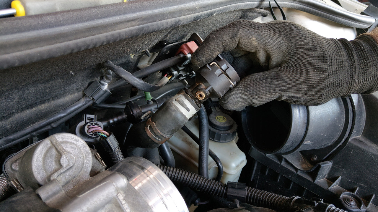

It helps for the procedure if you have smaller hands and proper tools. The only thing that was taken off under the hood was the air inlet hose that goes from the air filter box over the engine to the air inlet valve/flap. The car is now 13 years old, with 223.000 km on the clock. Not sure if these adapters are known to fail/degrade as it was in my case, but I'd suggest to anyone having a similar age car to inspect this part before it disintegrates/melts/crumbles/whatever in the coolant hoses, making the repair that much harder.
P.S. The smaller, missing head piece of the Y- element was still stuck in the thinner hose (which connects to the coolant fluid container on the upper left side of the hood), and was successfully pulled out with a screw that was screwed into it while still stuck inside the hose. The thin cylinder part was basically dust/gunk that was stuck to the sides of the hose, and had to be dug out.
