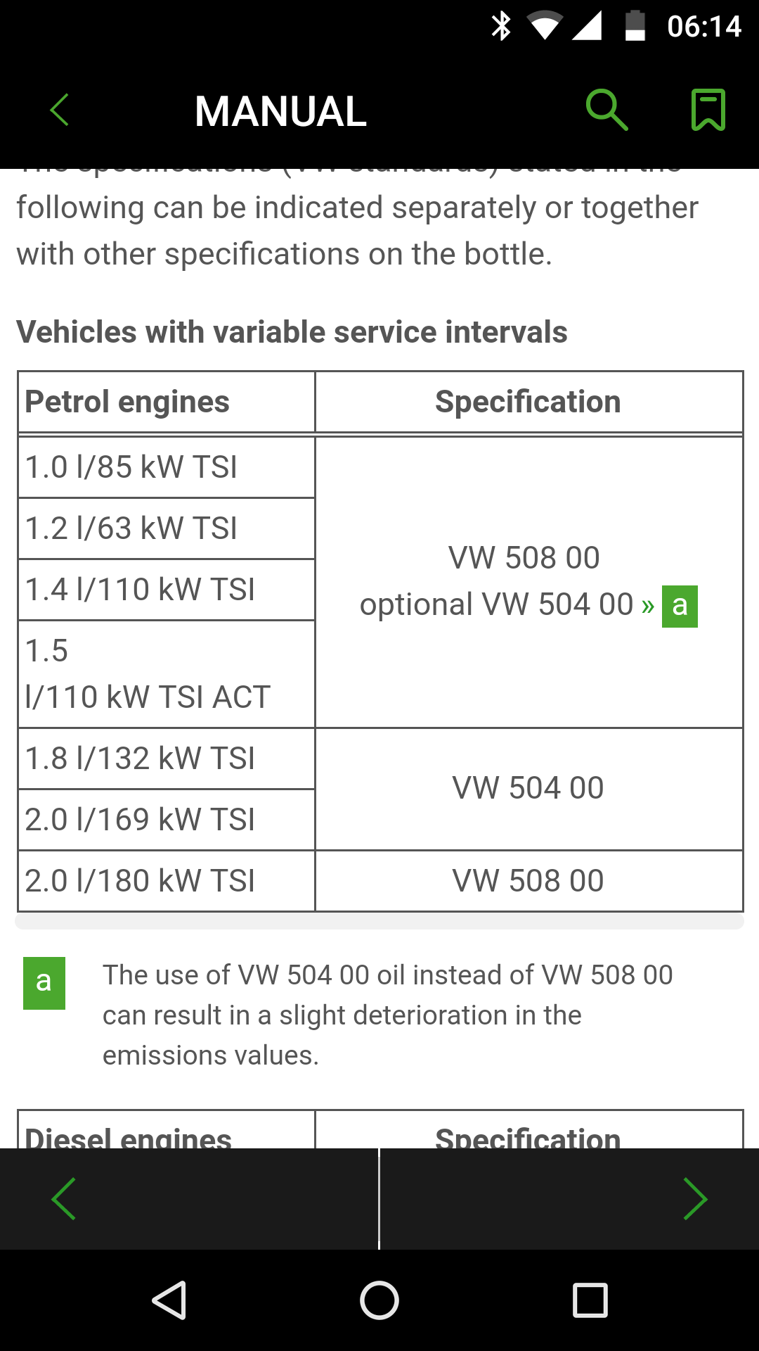

Just wanted to chime in here in case it’s any help to anyone. My 2017 1.4 tsi Kodiaq registered in the UK in Sept 2017 says in the owners manual that the recommended oil for variable servicing is 508 00 (504 00 optional) as it seems to be the case for all 1.4 owners.

What I find misleading is that VAG recommend 508 00 in the owners manual for 1.4 tsi engines, and the 1.4 tsi kodiaq was only manufactured up to 2018.
I still want to believe 508 00 is the correct oil as stated in the owners manual but I’ll play it safe with a 504 spec since it’s what the dealers are recommending.

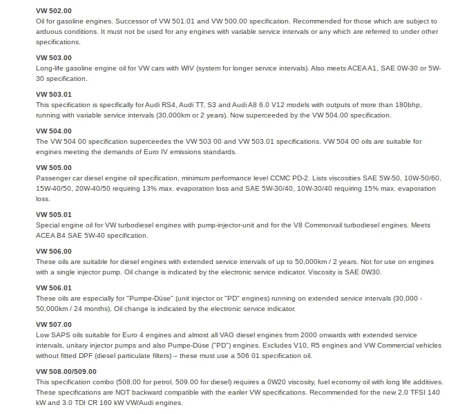

VW 502 00 can be used for fixed service regimes with a TSI.
But many dealers stopped stocking or using it because the would use VW504 00 / 507 00 for fixed or Variable.
Used to be commonly 5w 30 FS III and now often 0w 30 FS III.
(When not ones needing or recommended to VW508 00 / 509 00, 0w 20 FS IV.  &  Some are using 0w 30 FS III instead. or were )

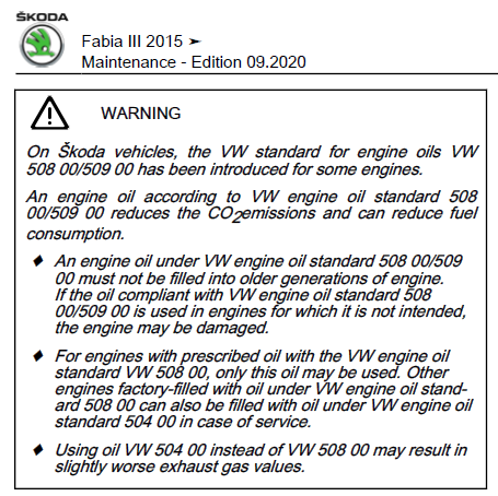

I got the impression that the Skoda dealer parts rep I was speaking to didn’t know much about the 508/509 spec. He basically just said 0w30 504/507 is the recommended oil based on my reg.
I’m still keen to switch to 0w20 508 as it seems like a better option for mostly city driving / short trips, but on the other hand 0w30 504 seems like safer option where I can’t really go wrong.

It is no better option for your 1.4 TSI.
0w 30 FS III will be perfectly fine.  You will not reduce emissions with 0w 20 FS IV or fuel consuption.
If doing fixed servicing oil and filter i would use the 5w 40 FS so not long life oil in a 1.4 TSI or a 1.4 TSI ACT.

I wouldn’t go by the manual, they’re only accurate at the point they’re printed.
I am also a believer that the wider use of 0W20 and 0W30 oils are primarily to improve emissions and / or economy, not engine or component longevity.

@kodiaqsportline fair point on the servicing interval. My intention was to mainly find out what oils are factory recommended for the engine and then decide on the best oil for the driving habits. My logic is a lower viscosity long life oil will be better for frequent cold starts and short trips, although I’m aware it’s terrible for the engine either way.
