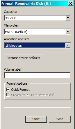

1. download 7z/zip archive from direct link
2. extract content to SD Card or USB
3. insert memory device into slot of Columbus
4. start of update usually is offered automatically, manually can be found under Navi-> Settings
!!! note for MAC users
On 29/07/2018 at 20:55, ZaphodB said:
Macs are a bit more problematic as they put some 'hidden' files on the card which confuses the head unit
-> https://www.briskoda.net/forums/topic/452002-direct-download-links-for-ece-20182019-maps/page/2/?tab=comments#comment-5095042

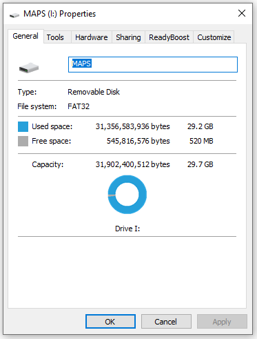

I see the standard maps have now come out from both Seat and VW. 1730.... pop over to see whether MartiniB has got them. People are moaning about they can't fit them on the SD card now for all of Europe... perhaps that day has arrived.

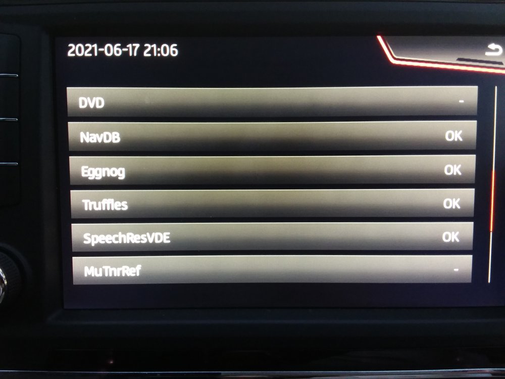

The Seat solutions lays here, it's Chillout with his toolbox
https://www.drive2.ru/l/589815971363982212/
Been monitoring boards to see how quick they pick up on it. I see MartiniB picked up on the map link being available on that link but not Chillout had the fix since it probably wasn't known that it wouldn't load up on Seats.
More on the SeatCupra site.
I haven't tested it yet. Requires one of three firmware releases to be on the infotainment unit (on a prior one). Navigation FeCs to be valid (think the normal Seat ones). I believe you then edit the Seat part number back in which got left out of this release (covered in the German board looking at the file). The toolbox tells the unit to ignore validation errors with toggles set as I understand it as per the link above. They will be the signatures not matching since the part number has been edited. I'm told the screen then looks just like normal. Magic as the youngsters say.:dull:
We still don't know whether it's a big mistake or whether Seat has done the dirty on those people with Mapcare.
Looking for MartiniB to flag up when Seat puts a link up (presume corrected) or no link = the dirty. The RoW link suffers from the same issue for Seat / Cupra owners. Had a look.... two accidents in one.

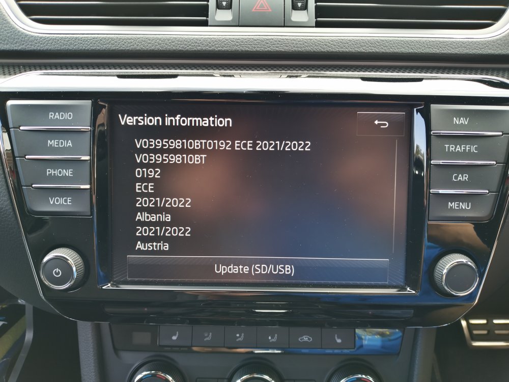

14 minutes ago, Tell said:
is the same release
exact content in \Mib2\NavDB\DBInfo\0\default\DBInfo.txt
PartNumber1="V03959802TM"
PartNumber2="V03959809P "
PartNumber3="V03959810BT"
PartNumber7="V03959804ER"
PartNumber5="V03959804QF"
ApplicationSoftwareVersionNumber="0192"
SystemName="ECE 2021/2022"
Variant="ECE"
ReleaseName="2021/2022"
DevVersion="P192_N60S5MIBH3_EU_NT_Q3.20"
but for Amundsen Škoda yesterday placed one year old files on their server - 1510
