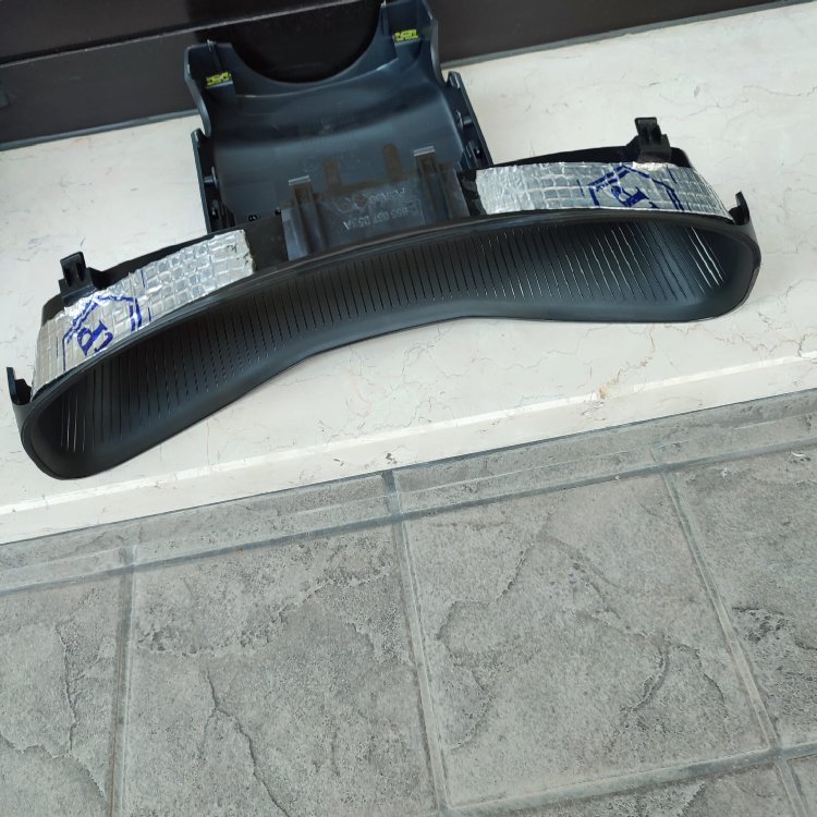

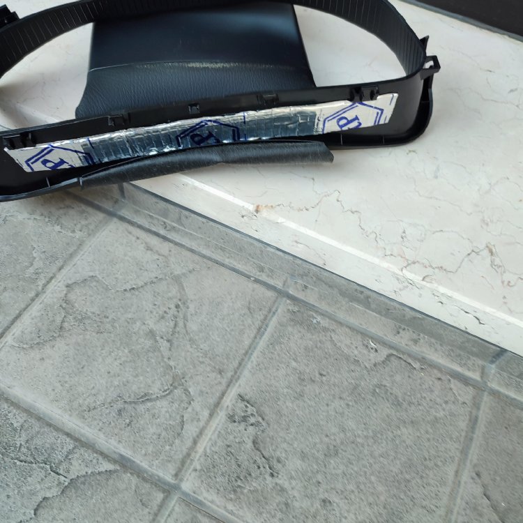

Funnily enough I did nearly the same thing just yesterday, had some spare rubber door draught proofing, and squeezed it into the top left and top right of the plastic surround of the virtual cockpit. Doesn't move at all now, and no tiny little clicking rattle type sound. But as you have aswell, on the passenger door somewhere there is a slightly similar light rattle, it's the only one to try and find.

Photo attached top left of plastic surround
