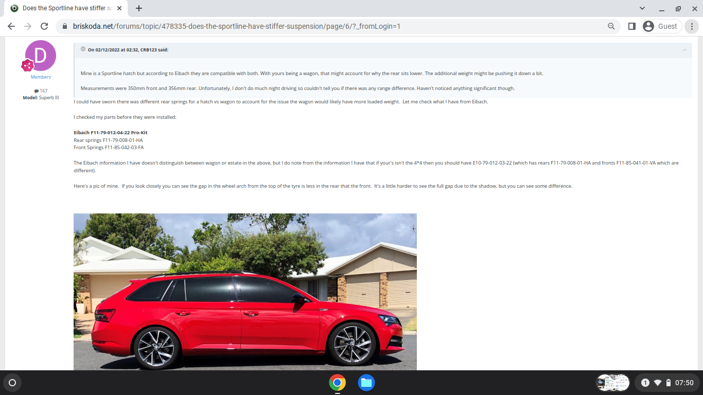

Is nothing being said about your Non Factory Suspension or is it Factory Approved when fitted by a Skoda Dealership?
Edited by toot
Yes mine is 5 year warranty but all new Skodas are 7 year in Oz now.
What’s my suspension got to do with my crunching DSG?  BTW suspension is only a month old whereas DSG has been crunching for at least the last 18000km.
Edited by Donweather
The crunching DSG will be nothing to do with the suspension then, and neither will the Haldex or anything else.
