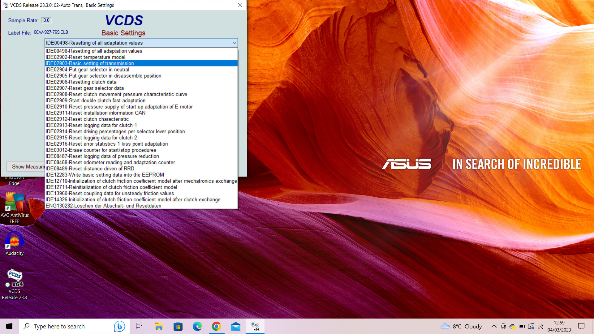

Without wishing to hijack this thread, I'm having trouble accessing expected screen options for a clutch reset/adaptation using my VCDS.
I get as far as Selecting Control Module > 04 Basic Settings > at which point I should get a drop down box with options such as ' 02294 Main Pressure Valve Calibration',  ' 02295 Clutch Valve Calibration' and '02298 Clutch Engagement Point Adaptation' amongst others. Unfortunately I get none of these.
I've queried this on RossTech forum but answers have not been particularly useful. It appears that many of the tutorials are based on old tech versions of the VCDS whereas my modules use UDS protocol ( whatever that is )
If anyone has successfully carried out or could advise as to how I can perform a clutch reset on a DQ200 with UDS protocol transmission I would be eternally grateful.
Screenshot below is as far as I've got. Could anyone suggest which options I should select and what I might expect to see /experience when I do?
Additionally, should the engine be running when these adjustments are selected?
