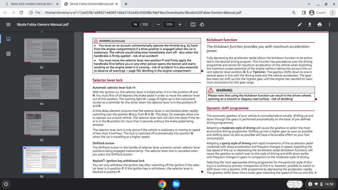

You will find in a 2010 on Mk2 Fabia Owners Manual the bit about 'Dynamic Driving' with a DQ200 DSG and how you change how the box does behave when driven in different manners.   So the sharp pedal actions and the way driven has it matching the spirited driving.
When you lend your car to someone else it can come back driving like ****e, as can cars from a dealers forecourt.
It does not take many miles of giving one going like a slug to behave as you expect.

Kick down could be on full down accelerator pedal, or a sharp acceleration it is at 1/3 pedal on a DQ200 DSG on a 1.4 TSI Twincharger.
But then the DQ200 was used in 48 applications /VW Group vehicles, they do not have the same mapping / management from those with 70 ps, to those with 180ps / Skoda.  (192 ps. this was with DQ200 7 speed in Polo GTI 192 ps 2015, limited to 250Nm.)
Programmes are there, pre-set.
They could become forgetful and needed a kick up the backside to remind them who is boss.
Edited by toot
That does not describe a learning system. It simply adapts to the required throttle input. It may have some level of retention, maintaining a moderate style, dynamic style or any combination in between for a short while until it recognises that you want a different output from it. This again is not a learning system like people think it is.

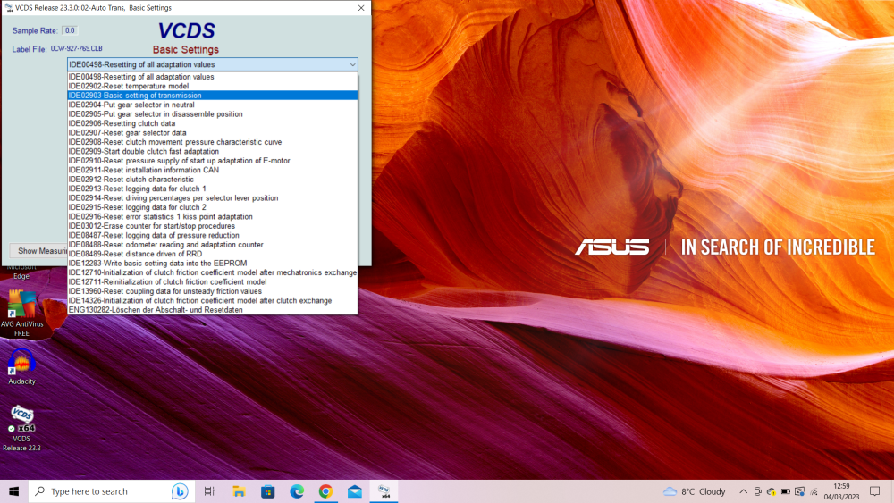

The dsg reset is mainly used to recirculate oil and to let the system re-adapt the clutch bite points. This can have the affect of making the box feel different and many comment that it then starts to relearn. All correct apart from the relearning bit.

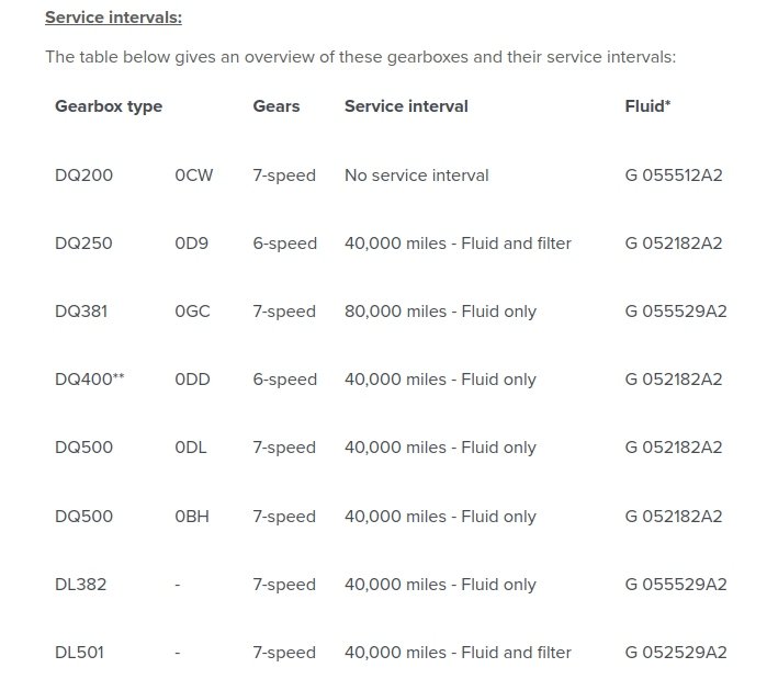

http://actronics.co.uk/news/the-evolution-of-the-dsg-gearbox
20 years of use and a Master Tech or Fitter in Australia needs to do more looking into these new fangled things.
Edited by toot
